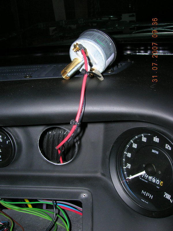

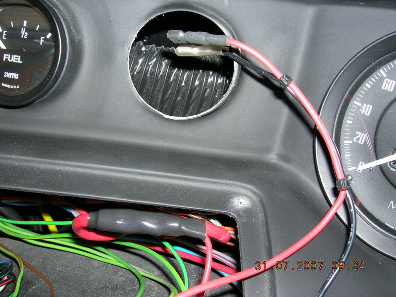

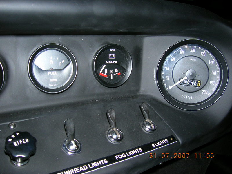

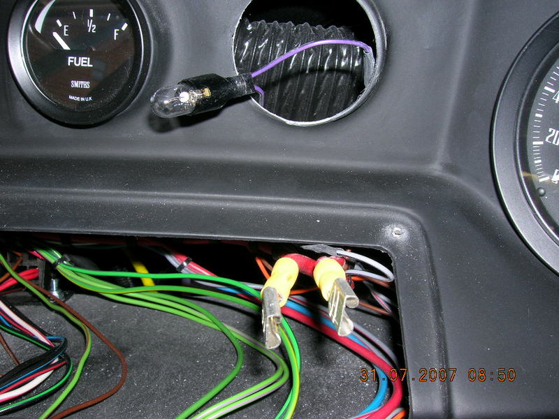

I replaced the ampmeter with a voltmeter. You can find black face Smith gauges on some Cobra supply sites. I got mine from the GaugeGuys.com. If you want to put a amp meter back in I have one I'll let go cheap. If you put in a voltmeter you'll have to put the two wires that go to the amp gauge together. Those wires are always hot so you shouldn't use it as a source for the volt meter (your battery will go dead). You'll have to find a voltage source off the ignitions switch.
IMHO the voltmeter is the way to go. See pictures.

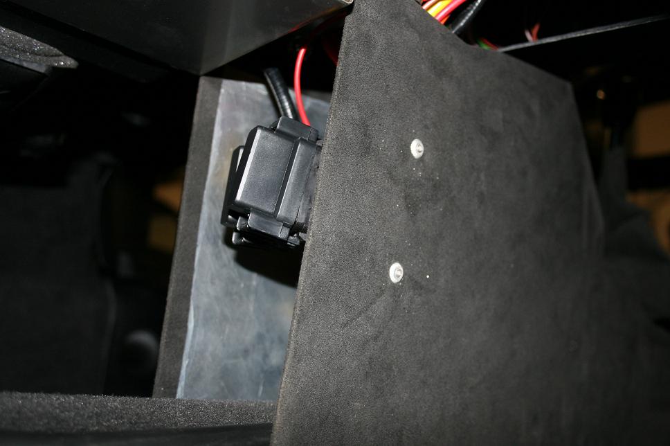

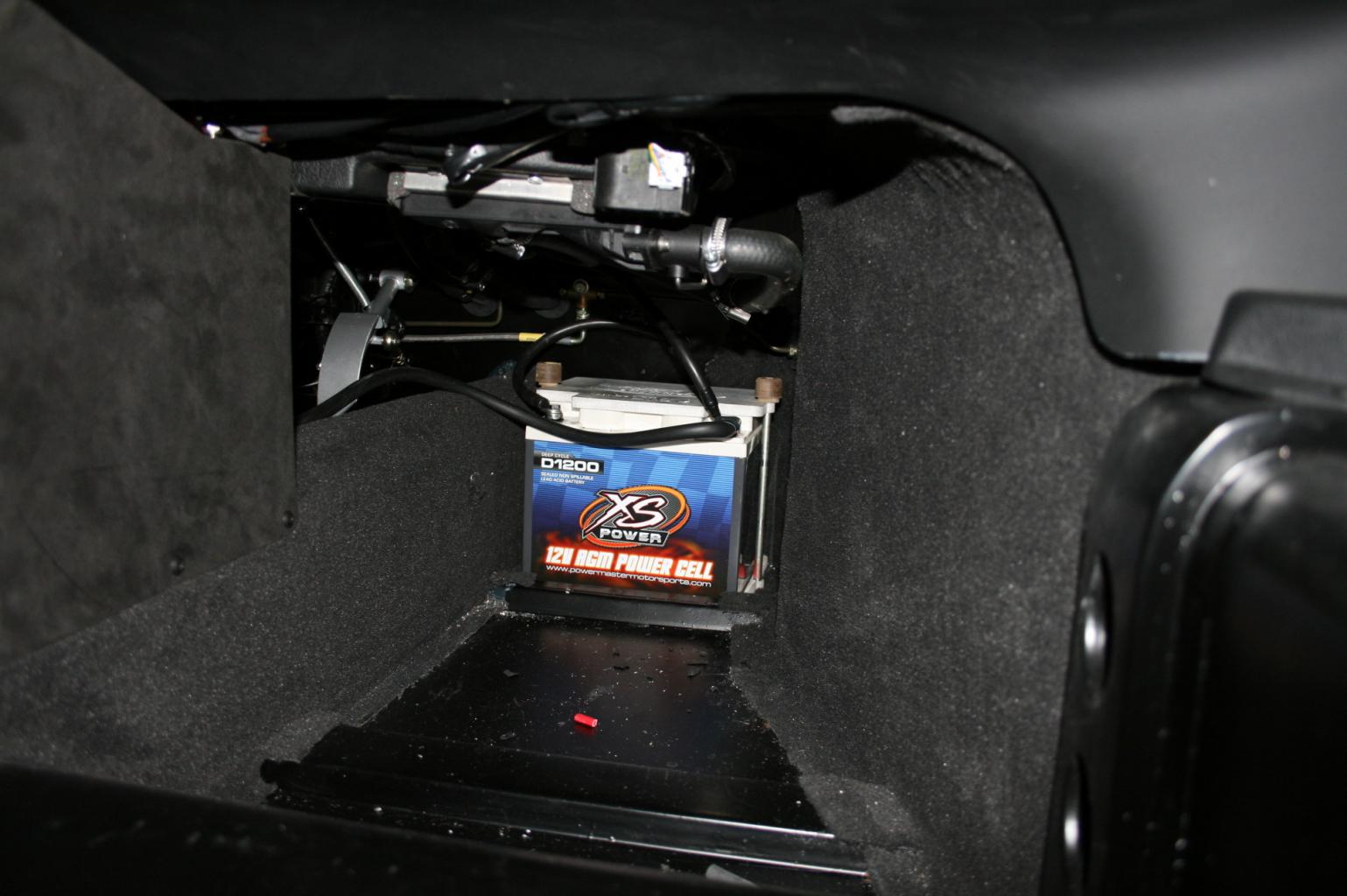

If you look at the wiring in the early SPF cars you wonder what where they thinking or drinking when they designed the wiring. If you follow the power wires they go from the back to the front then back to the main fuses located in the engine compartment then back to the front of the car creating about 14 feet of wire and resistance in that wire. I located my battery in the passenger foot well then put the main fuses up front then did away with the back and forth wires. Also not many people use amp meters, a true indication of battery condition is the measurement of potential power (voltage) not kinetic power (current).
