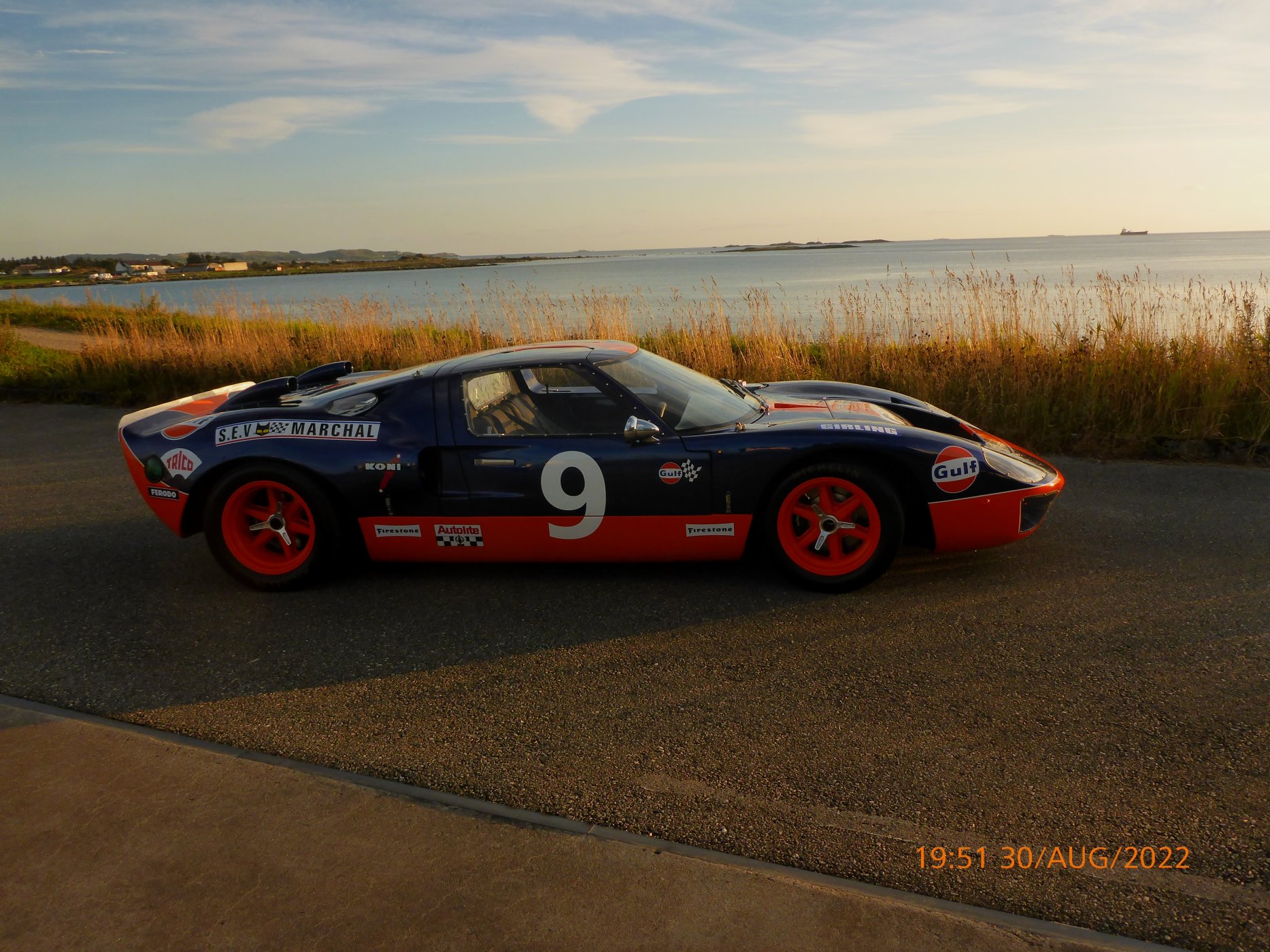

Some pictures from earlier this evening
Just read this thread from start to finish.
Good lord that is some skill and patience that you and the other builders have.
I will happily admit that this is the most beautifully built car that I’ve seen so far - and that’s not easily said!
Am glad you’re out and about enjoying it, she’s a beauty.

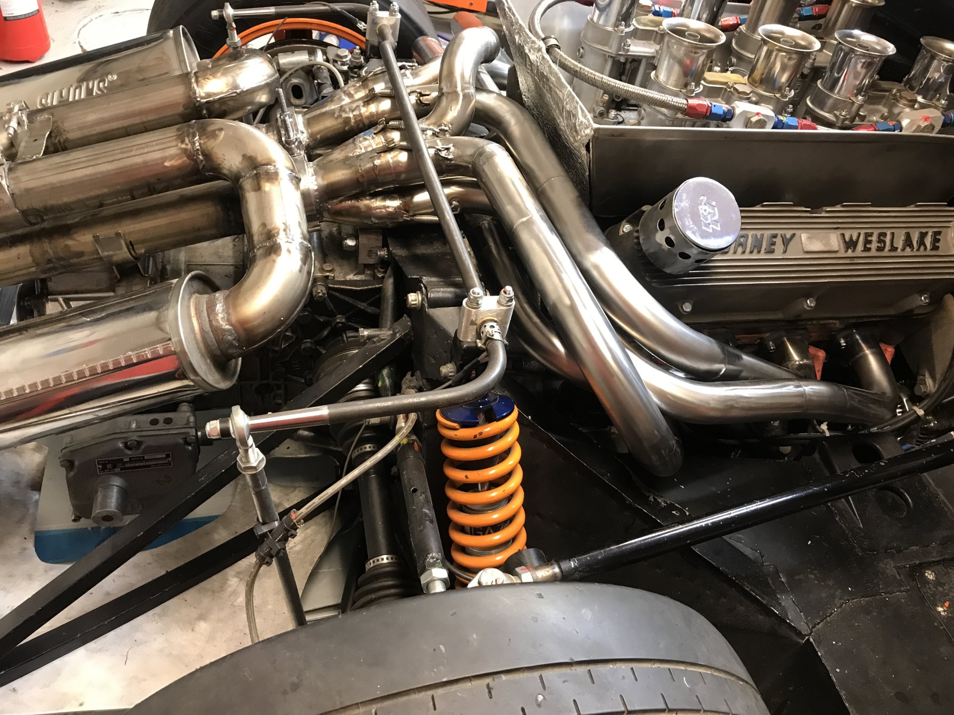

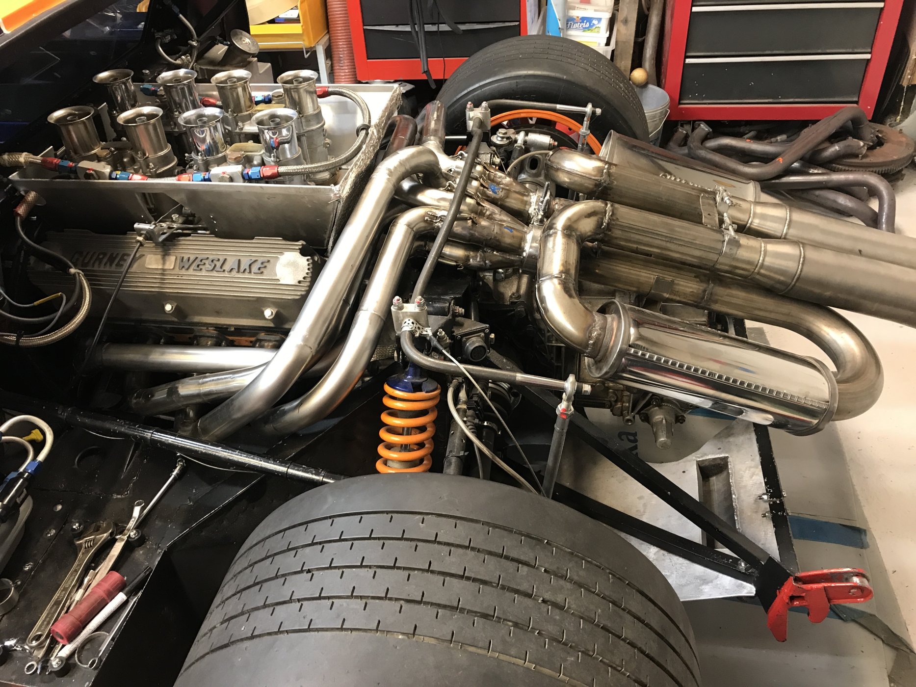

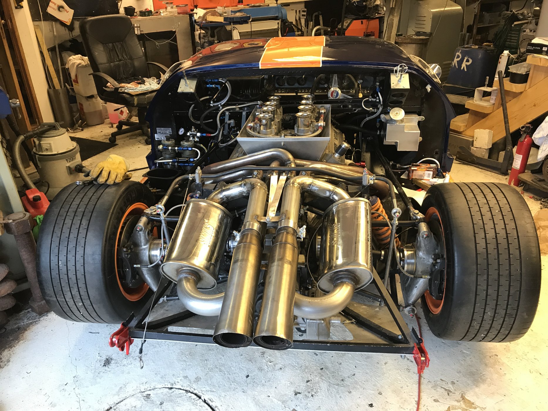

Have been some time since my last post. My new gearing (4.5)(have a 3.2 crownwheel and pinion that can go, mint condition) works vey good seems that some adjusments on the ZF made it more smooth in shifting gears. Some lower top speed, but enough for a old lad. Nerves seems to come closer to the skin. I was not satisfied with all the heat from the exhaust around the carb area, so I decided to try to make a new exhaust in stailess. It was a huge puzzle but together it come and the temperature in motor compartment was suddenly low. I measured 100deg C lower temp on the pipes 6" from outlet and that is good . Good enough for me. Not easy to weld, but with back purge it was ok . I did not realise that stainless was twisting so much so I did not do final welding on flanges before everything fit. Now it is winter here in Norway, so no driving before spring. Only some starting from time to time and let it be warm.

Neil
