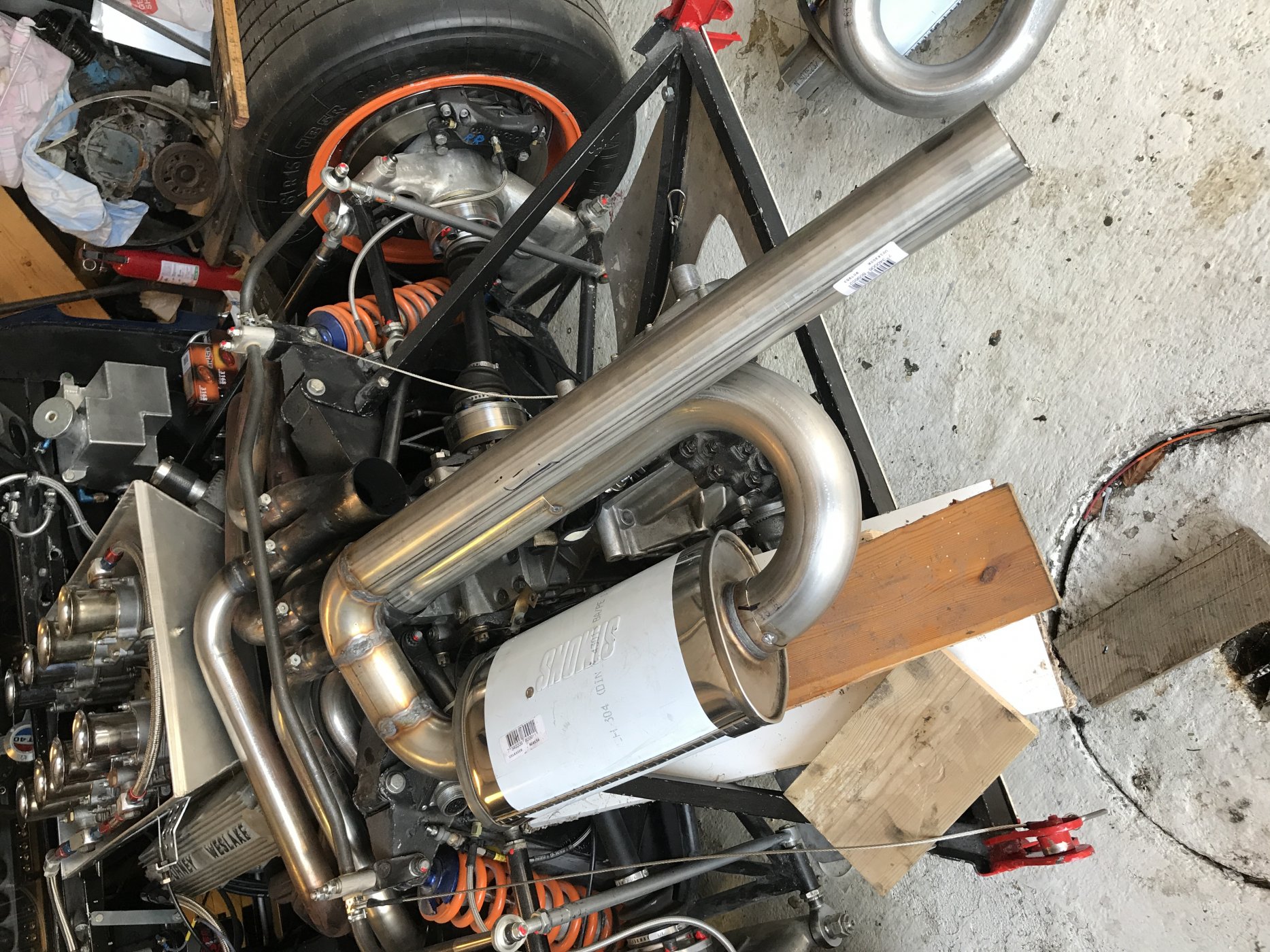

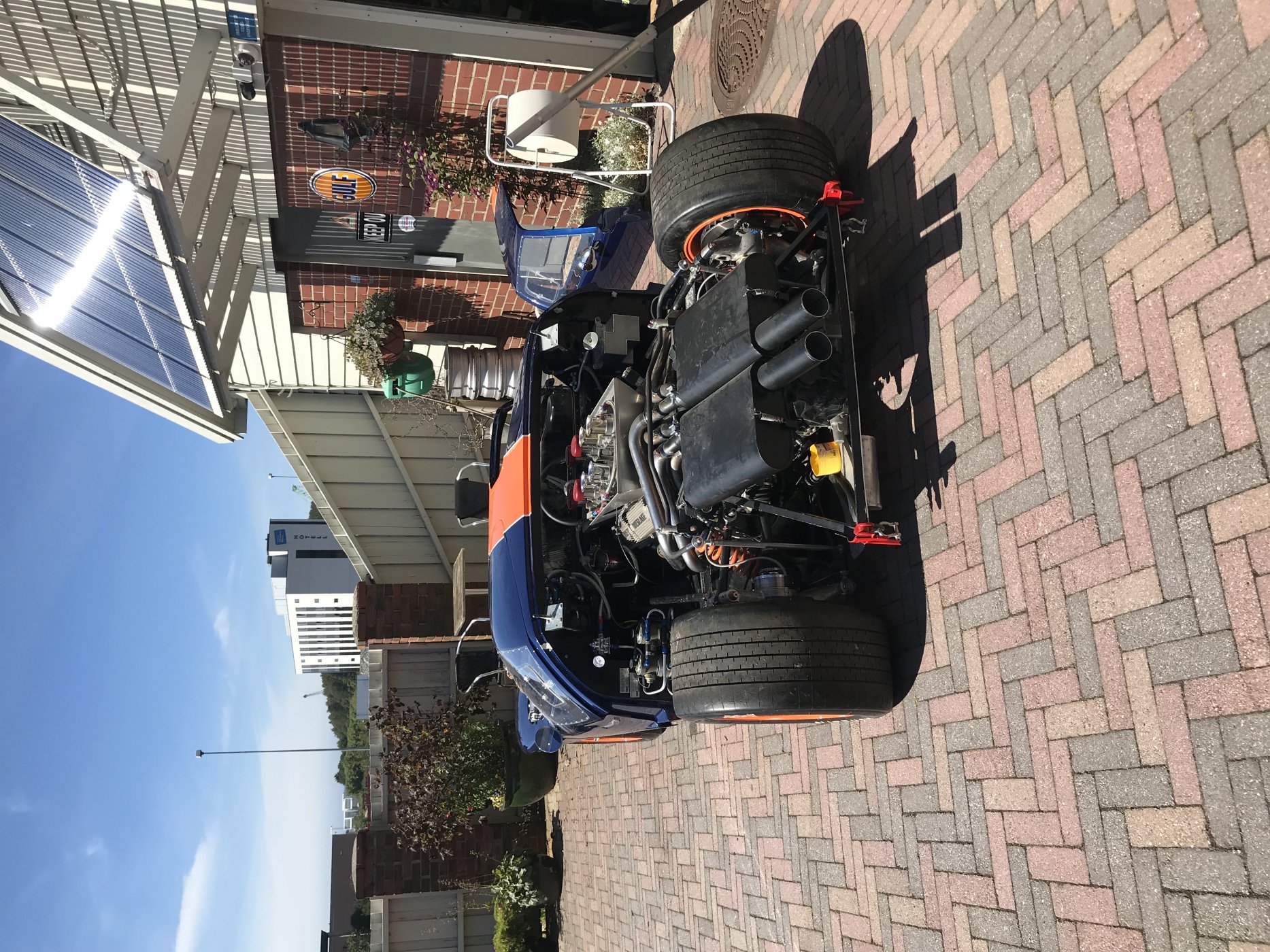

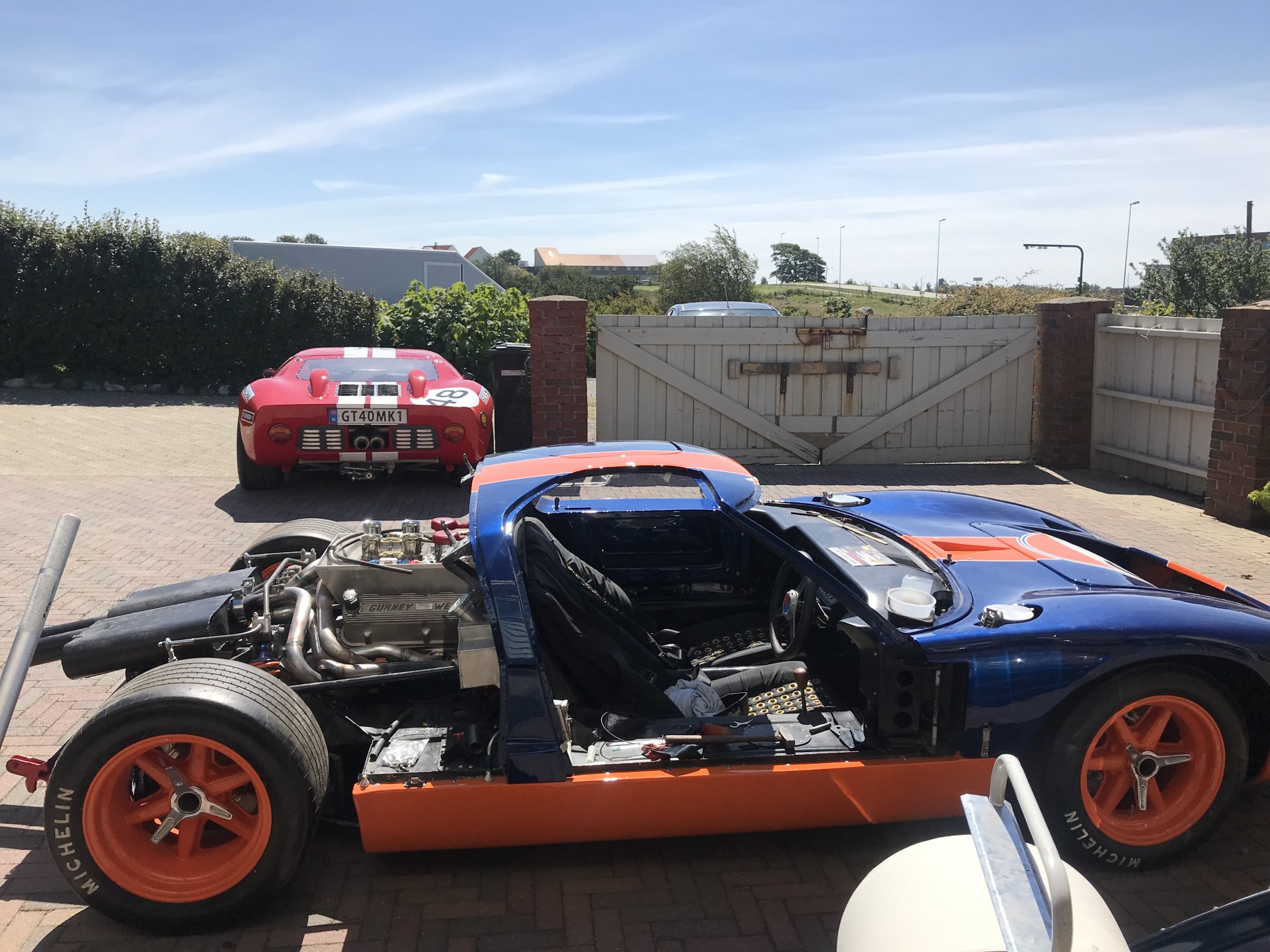

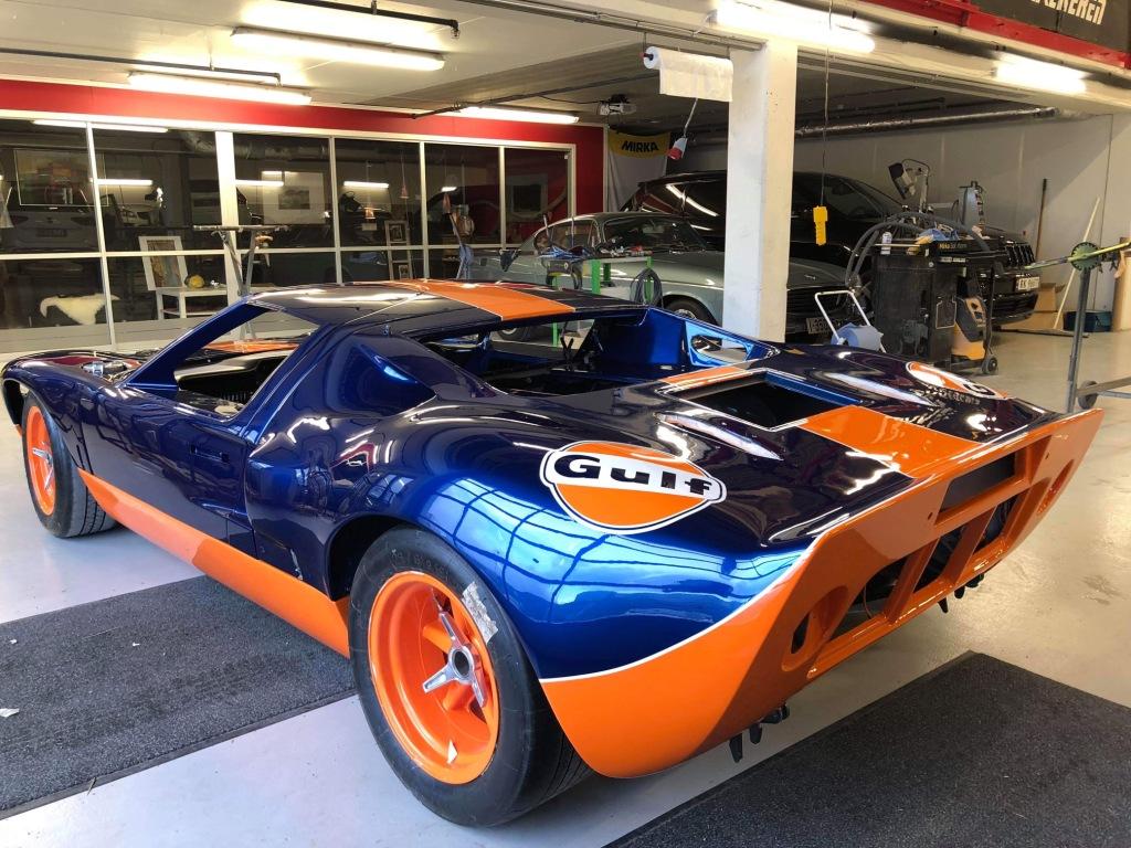

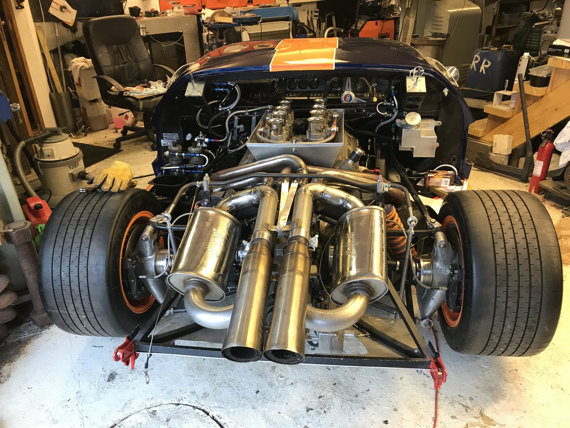

It has been e bad summer ,the body is gone for painting, and the engine is at a test stand. I had to do lot of house related work ordered by my wife . But now the engine have been running for few minutes ,one weber was flooding and the water pump was leaking. Will be fixed monday hopefully. The body is now in dark blue and on water sanding step, will have some withe stripes and lot of orange all around the car , so soon I can show some pictures , and work for a complete 40.

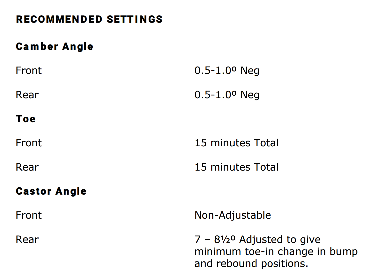

I am about to do the adjustment on camber and caster, I plan to use 0.5 deg camber front and rear, Have no clue about caster rear, someone out there to help me out with the most common used angles for most street use.
OttoRT
Hi Rune.
The original spec sheet from JW engineering says caster on the rear should be 7-8½ deg adjusted to give min toe-in for each wheel.
