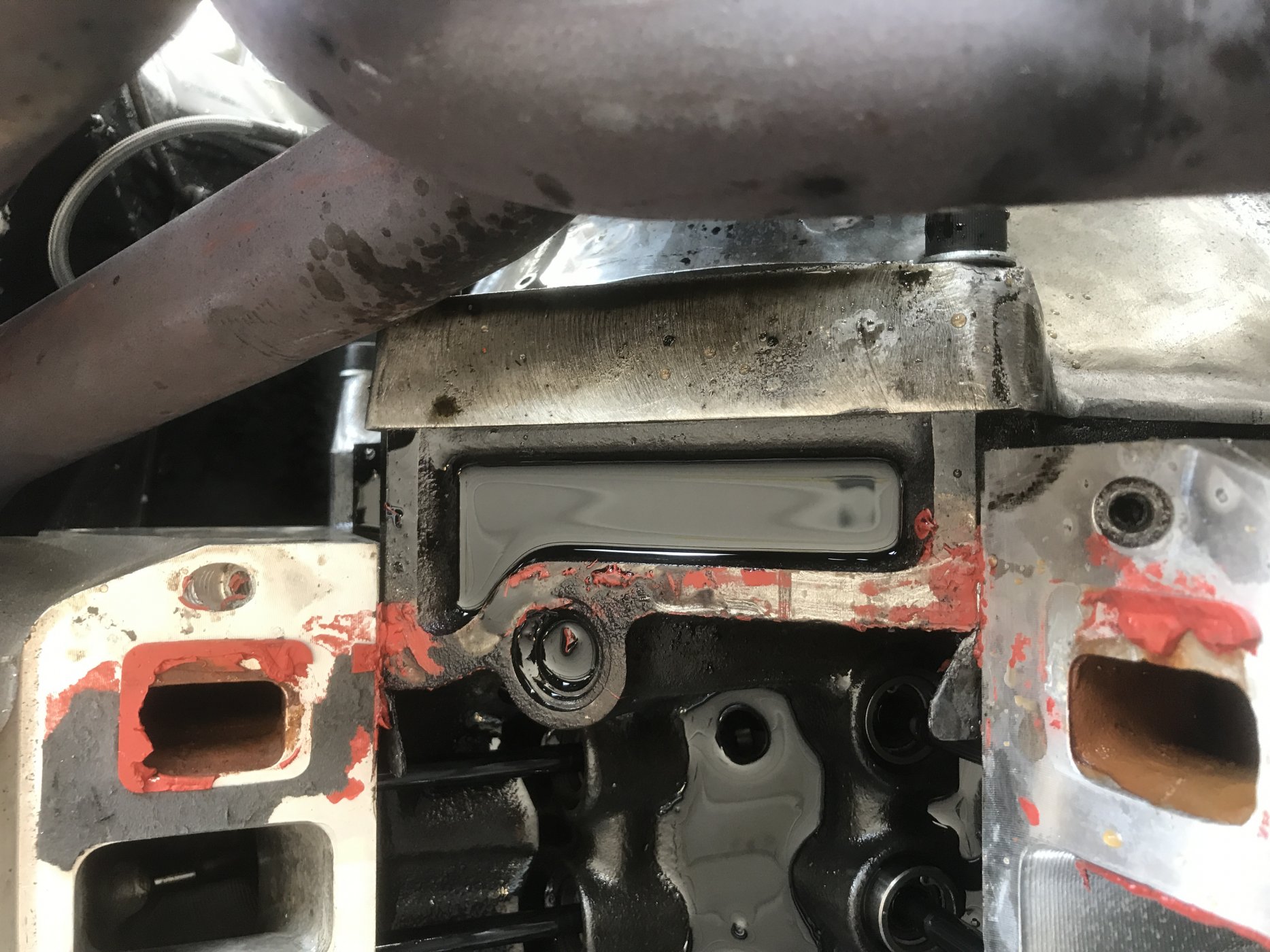

Here are a small update on my now completed and road legal GT40
After some test driving I found that my LeMans ZF was not for road driving. 3.22 was just for LeMans. So I had to do something. After a try with a bad produced crown wheel and pinion(clearence was 2mm between Crown wheel and pinion) witch I had to return to seller, I found via a forum member a set in Germany. 4.5 was this one and never used. Then I go down on top speed, but thats ok for a old guy. So then it was to do this job once more. After reinstall I had to do a adjustment on a unplesant sound from the valves(been there for sometimes). They needed a check and I used 0.35mm to measure valve clearence. But when I found 5mm clearence I understand the sound:eek:. I had to remove alot to open up for access to lifters to see if there was some damage, but it was the pushrod. I belive that the failed one was from production. So I changed all to a better type. After some hrs the car was back in service NOT. I had a small test drive with the new gear and it was escellent for me I was scared how fast it was now 0-100 on next to nothing. When home again I opened to look over the engine and there was OIL outside. Reason for this was very simple, when I put intake manifold back in place I did not used enough sealing compound fore and aft. So then I got some new hrs engine work. Now I hope everything is sorted out, so I can enjoy som driving without hrs of repair. But that is how we can keep our cars always in good shape.:)
