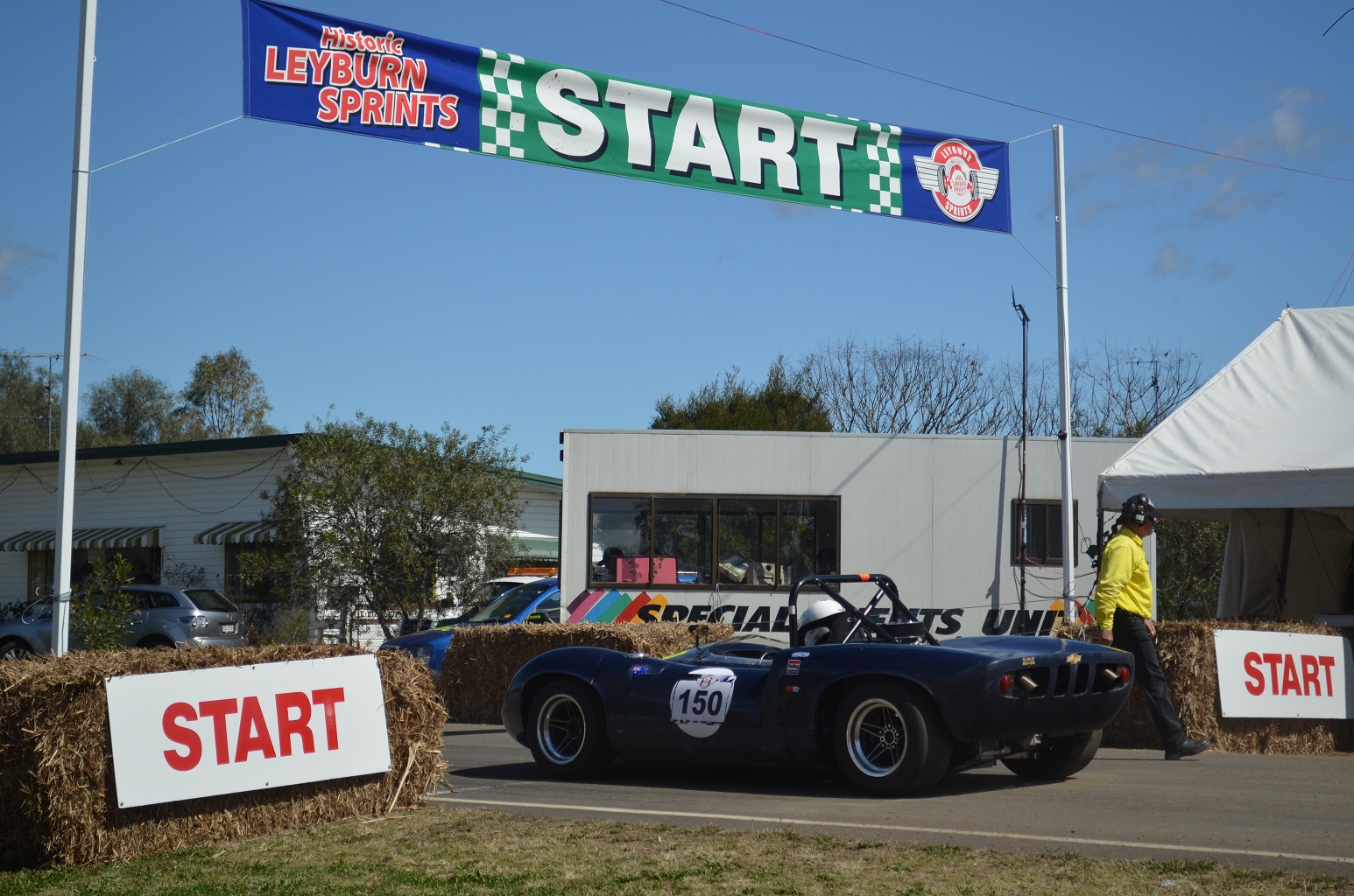

Chris,
Sorry about you’re off track excursion. The Lola was definitely a crowd favourite with its speed and wonderful noise. I hope you reconsider and return to Leyburn, I think you’d have a great chance at top three. This shot was taken on your last run.
