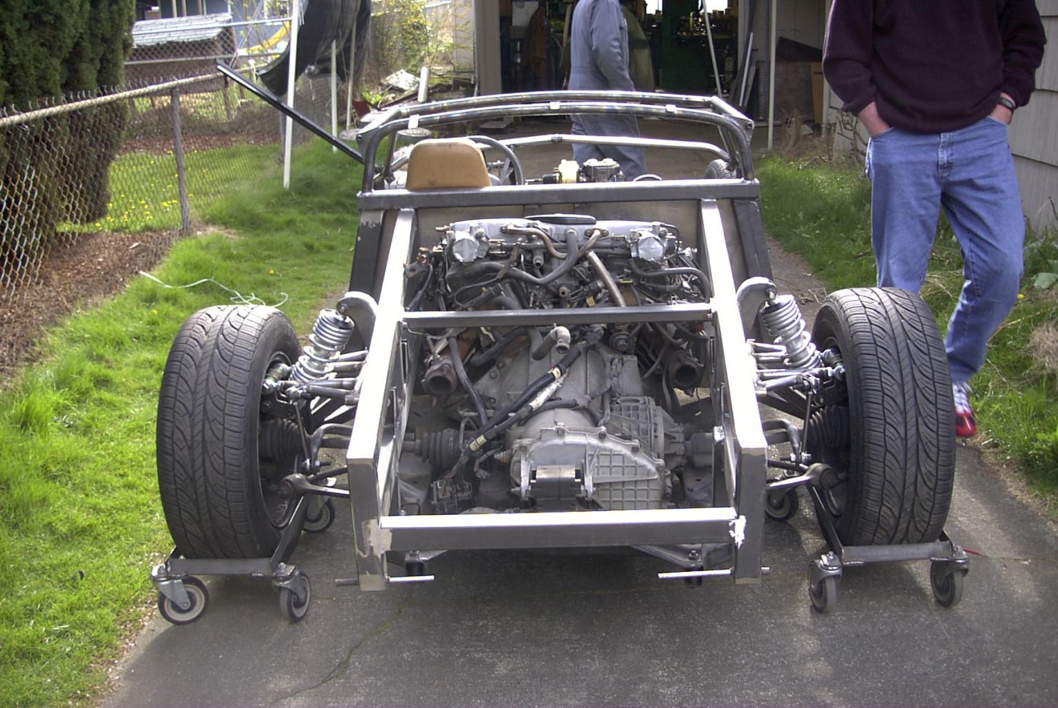

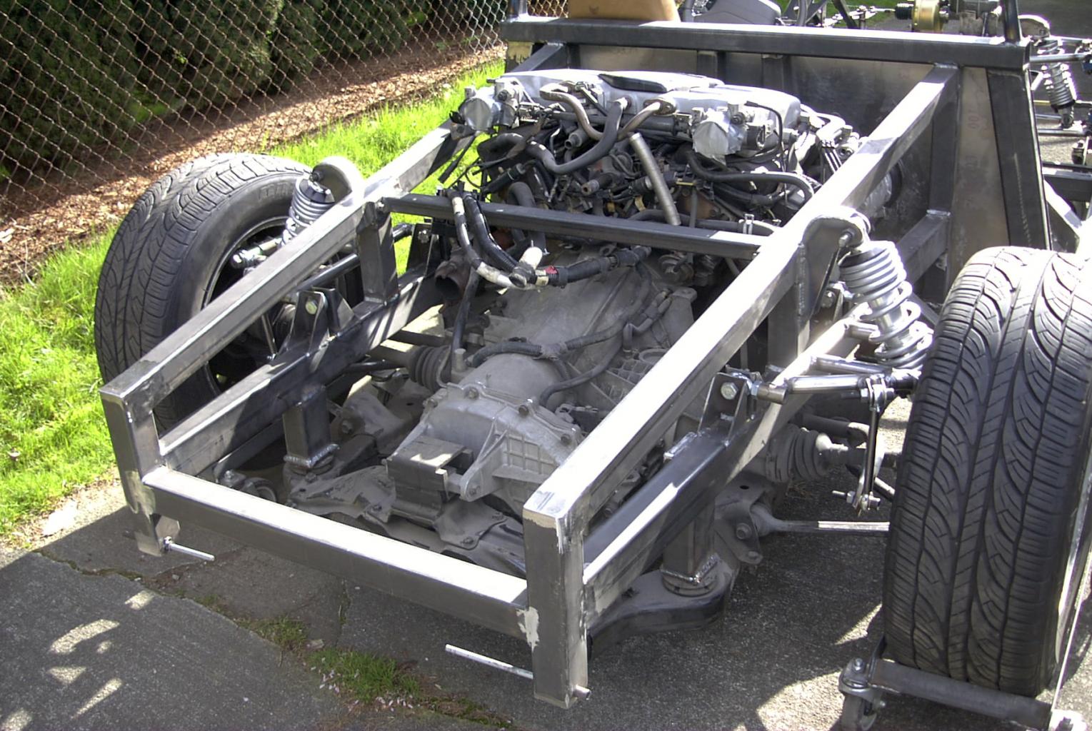

Been there done this... last project used the dirve train from an Intrepid
here are some pics of the build

Oh my - now that does look good. Those pictures from 'true' above this post, what is the transaxle used there - what is it from? Intrepid ... ? hmmmm
Hi Bruce, Actually the trans is a 43le out of a LHS but it is the same as the Intrepid.. I have an Intrepid waiting to pull the whole drive package for another project coming up. works great and you can turbo the 3.5 easily as well as other performance upgrades.
