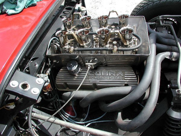

The "turkey pan" ( so named because it look's like the
aluminum pan many Americans cook their turkeys in on Thanksgiving) is the boxy item in the above photo underneath
the carbs. Very popular with the Cobra crowd.

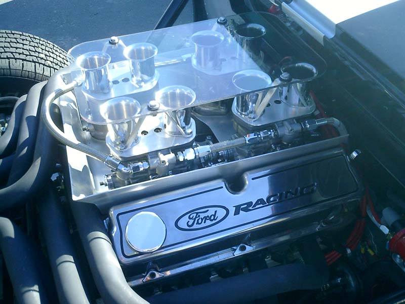

Here's a picture of my set up with a plexiglas shield.
Great photos guy's.
Larry, What is the distance between your ram tubes and the underside of the plexi ?
Have you noticed any difference in the way the car makes power? (albeit probably small if any)
