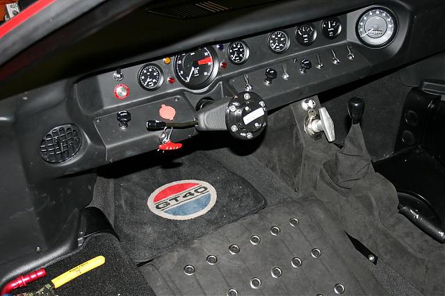

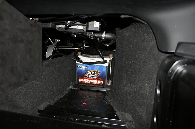

Here is where I put mine, the battery (dry cell rechargeable) is in the passenger foot well.
