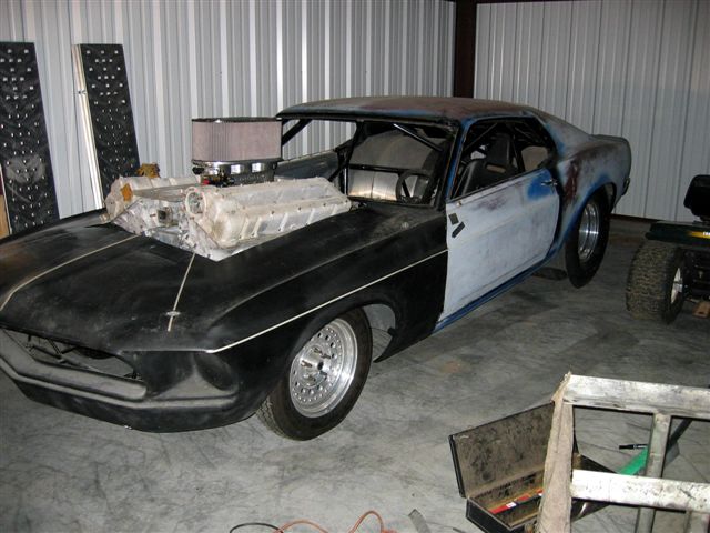

This is no joke! Check out the pics and the pasted string for more info. This guy put a sherman tank all alum 1100 CID V8 into a 1970 Mustang. Mr McCall...don't think you could hang with this boy! At least not in a straight line......

Just thought I'd share some before and after pictures of my Ford GAA tank
engine. All aluminum 1100 cubic inch V8 used in WWII Sherman Tanks. These
were gas burners rated at 500 HP and 1050 Ft. Lbs. of torque for military
service, but are capable of much much more using mostly stock parts. They
feature a 60 degree vee, 5.4 bore x 6.0 stroke, 180 degree factory billet
cranks, pent roof combustion chambers, shaft driven DOHC's, 4 valves per
cylinder, and dual mags. They are pretty high tech. engines, especially
considering they were built in the early 40's.
I've been working on getting one of mine going for the last couple of
years, and should be cranking it within a week or so. (Embedded image
moved to file: It's setting in my 70 Mustang right now which
I plan on taking on short cruises when finished, 24 gallons of alcohol
wont go very far. It is bolted to a heavily modified Powerglide right now.
Wilcap ( Pat McGuire ) built the adapter and flexplate for me.
I drove to BFE Nebraska to get my first 2 engines. I ended up with 5 more
in a package deal just 50 miles from my house a year later.
Stock with all the tank accessories they weigh 1400 lbs. I've got it down
to 960 lbs. now which is liveable, not much more than a blown cast iron
Hemi or BBC.

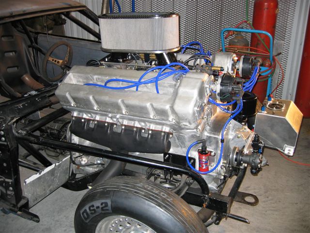

Here is another picture. The engine on top has the dual 6-71's that were
38% overdriven, those zoomies have 3'' primaries. The engine on the bottom
belongs to a tractor puller in Kansas. He used that one, twin turbo engine
to win the nationals back in the mid-eighties, beating numerous triple
Hemi and BBC powered tractors along the way. He claimed 3600HP with 34 psi
and alky. I imagine that # isn't far off because a 12'' 4 disc. Crower
clutch was having hell holding it. It used a stock crank, rods, cams, and
turned 5000+ rpm on a regular basis.
That's why the 2 blowers aren't sitting on it yet. The radiator will be in
back, along with the 2nd fuel cell, batteries, etc. I think its going to ok
though. I weigh 240, and I can't make it come close to bottoming out
jumping up and down on the front end. It really doesn't weigh much more
than a blown iron Hemi or BBC would. Enderle injected, 2 nozzles per cyl,
2 Impco 3.80'' throttle bodies. It is all aluminum, pan to valve covers,
no silver paint here. I probably have 80 to 100 hrs. of time invested in
polishing the pan, frt. cover, block, heads, and valve covers just to
bring them to a satin finish.

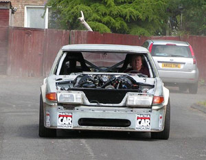

Hmmmm. Ford seem to like that "GAA" tag. They also gave it to the much much later 3.4 litre DOHC V6 that was so successful in European tin top racing (Cologne Capris?)

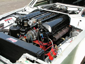

There is a guy in the UK, Charlie Broomfield, who writes a column for Practical Performance Car Magazine who has done something similar in mating a 27 litre meteor (i.e non supercharge merlin engine) in a rover SD1. Saw it at Goodwood last year and it was quite a sight. They used to start it up on the hour and it drew rathera large crowd.
The car now runs and has home made EFI but i believe the plan is to fit twin turbos to get the power up to 1001 bhp (1 more than the Veyron!) The current BHP is 650 so a few more than the sherman/mustang!
Attached are a couple of utube videos which are admittedly not the most exciting but give a good impression. Good noise though.
YouTube - 27 litre Rover starting up
YouTube - 27 Litre Rover SD1 reversing out

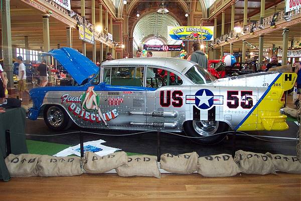

This Merlin-engined 55 Chevy was recently completed in the States. The workmanship and finish appear to be of the highest standards - I think this did actually come up on ebay 18 months ago but failed to reach its reserve. It is not exactly something you would miss if you spotted it! Anyone recall seeing it?

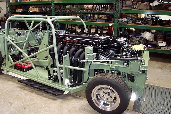

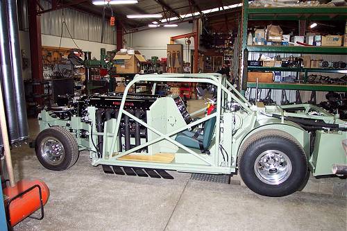

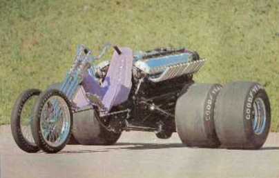

Also a merlin engined Trike!

Minor correction on the merlin powered 55 chev. It was actually built here in Oz by Rod Hadfield, A gent of some distinction when it comes to custom vehicles.
Rod started and ran the Castlmaine Rod Shop for many many years and at the back had a bit of a museum containing all his vehicles. He has since sold the business.
To see that car in person leaves you in complete bewilderment as to how Rod had the vision and dedication to produce such an amazing piece of work.
Utterly brilliant.
Peter Delaney
An old magazine article on the 55 indicated that Ron actually got "Club Plates" rego on this car - imagine going on a cruise (with fuel tanker following) !!
Awesome !
This car was built by Rod Hadfield who owns a custom rod shop in Castlemaine, Victoria about an hour and a half from Melbourne. I did get a look at this car a few years ago and it is a pretty neat bit of gear. I thought that the car was taken to the USA and sold. I was told that Jay Leno had purchased it, although I can’t be sure of this.
I have seen it and know the guy here in CA that owns it. It's a hoot to watch him drive that thing around his hometown with the body off. I've been trying to get him to take it to the Reno Air Races since he bought it a while back. He says if he does, I get to be his crew cheif. He is so busy that he has not had the time to commit for the display at the Air Show. You think that is something, you should see some of the other car toys he has in his 8,000 or maybe its 12,000 now sq ft garage.
