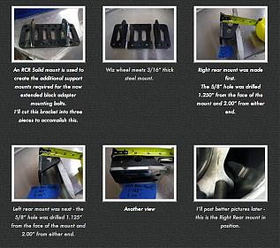

Also I've finalized the rear motor mounts to help support the adapter plate since I had to move the engine forward a couple of inches to make my non-standard G50/03 transaxle work. These rear mounts were made from a single RCR Engine mount.

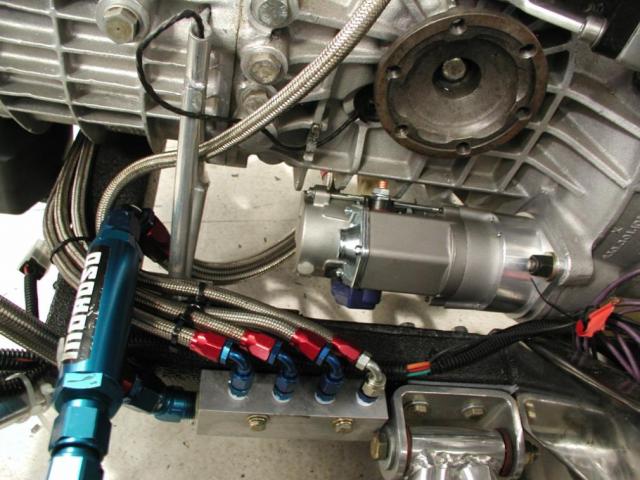

Did you ever get the starter question answered? I got the info from Ron Earp and ordered the Hi Torque starter with the lengthened nose piece. Then we noticed it would interfere with the CVs, as it sat too high. It fit well, but it could not be clocked in the right direction. It has about 4 or so positions it can be clocked to. The position it came with was the best(or the lowest). When we inverted it 180, it hit the fins on the trans. We cured that problem with grinding the fins down a bit. The engine should be fired up next week(I hope).
After all that work installing a starter I think I would buy one or two spares. I would hate to have that one fail and not be able to find an identical replacement.

I don't know how well my re-clocked starter will work (yet) but I can tell you that it will clear the CV/Axle - that's one of the things I checked for when I have everything bolted into the car..
