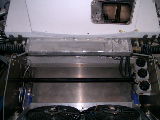

Now is the time to open up the big hole over the drivers side foot box area. The round OEM one is marginal for fitting your hands down in there to work on peddle box, etc. See picture below.
Appreciate the tip Howard, but I have small handsies! I was able to get the pedals installed and plumbed without opening up the factory holes.

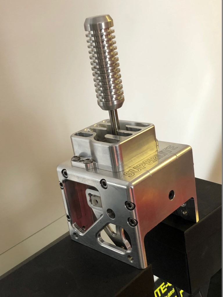

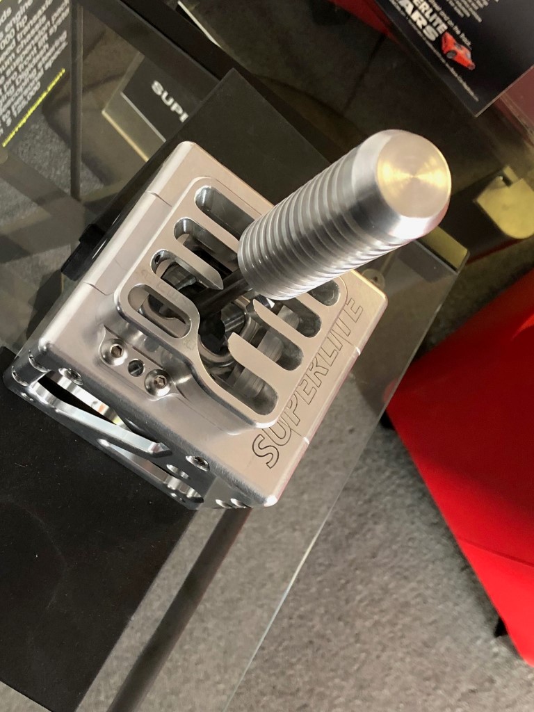

Teaser pics of the Superlite Graz shifter...
reverse engineered from the R8 production unit but with an overall smaller package size.
FYI..shift knob is just for testing
