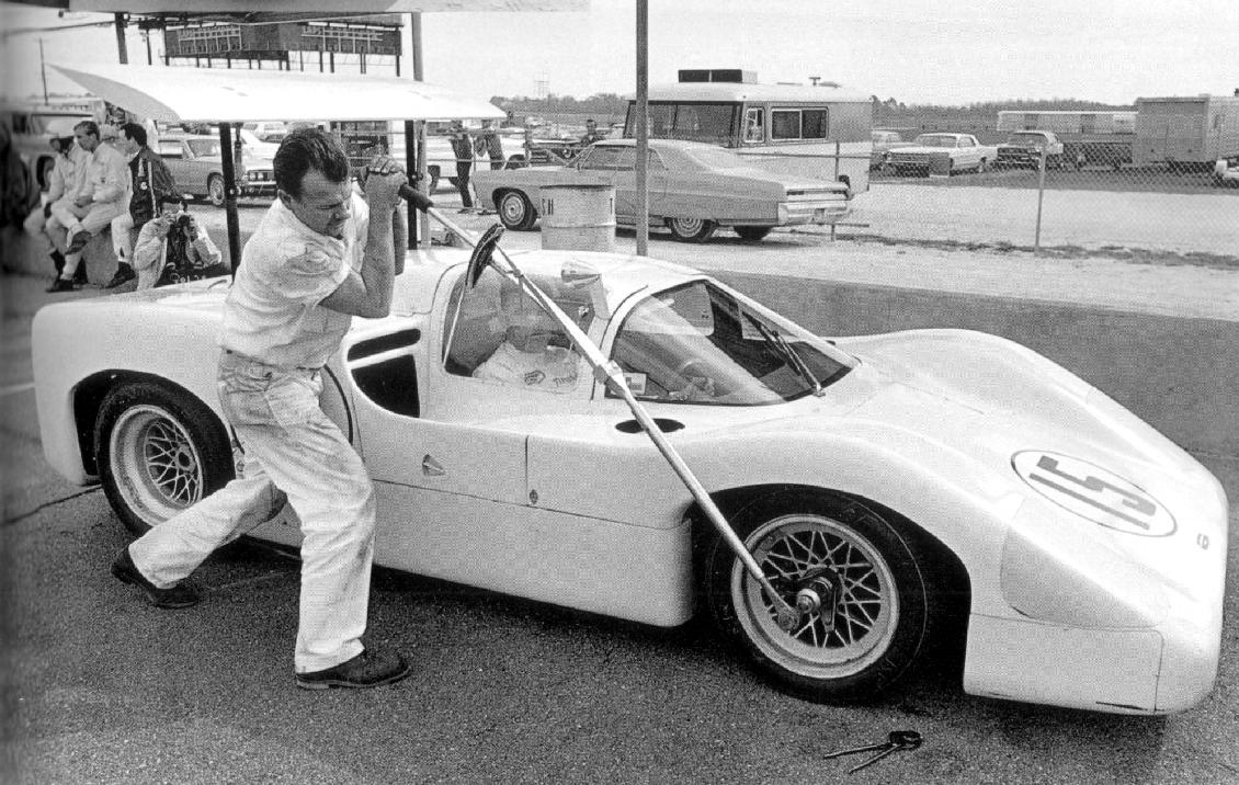

Spent some time looking at my bench grinder this afternoon LH and RH threads..
Will
Pat
Or you buy a really long torque wrench.
