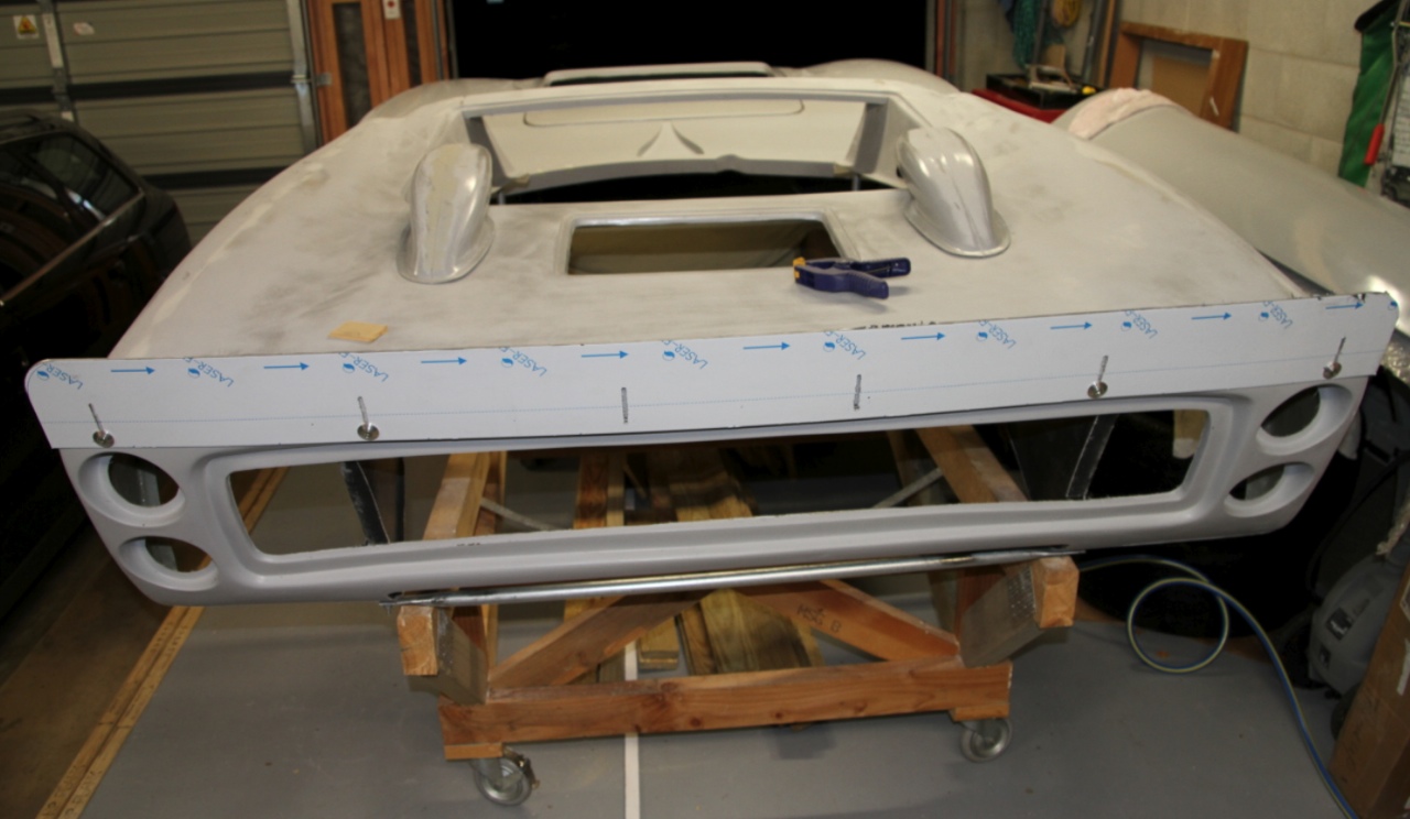

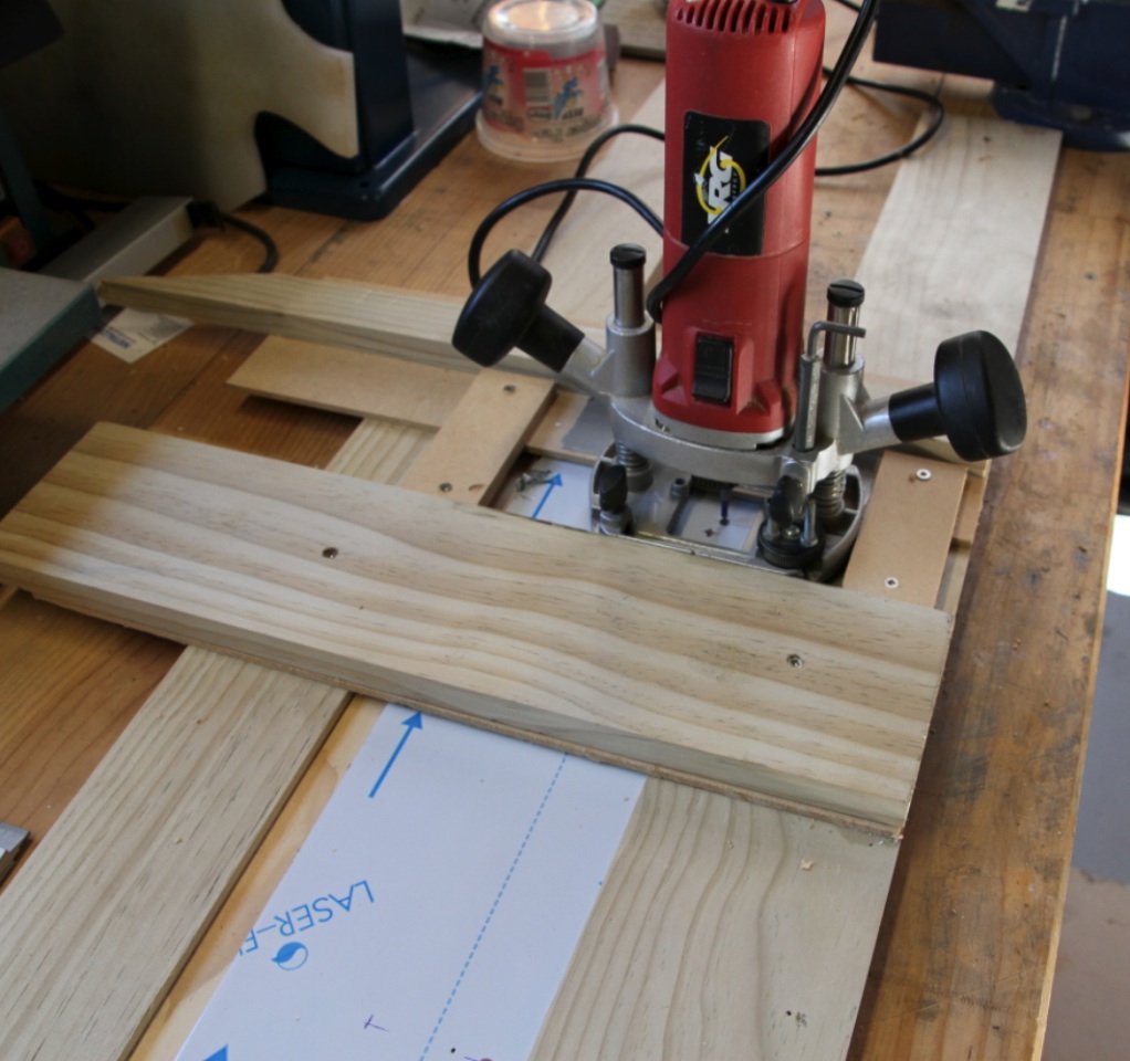

Using a very simple jig and my trusty router I cut slots in the rear spoiler over the weekend and trial mounted it.

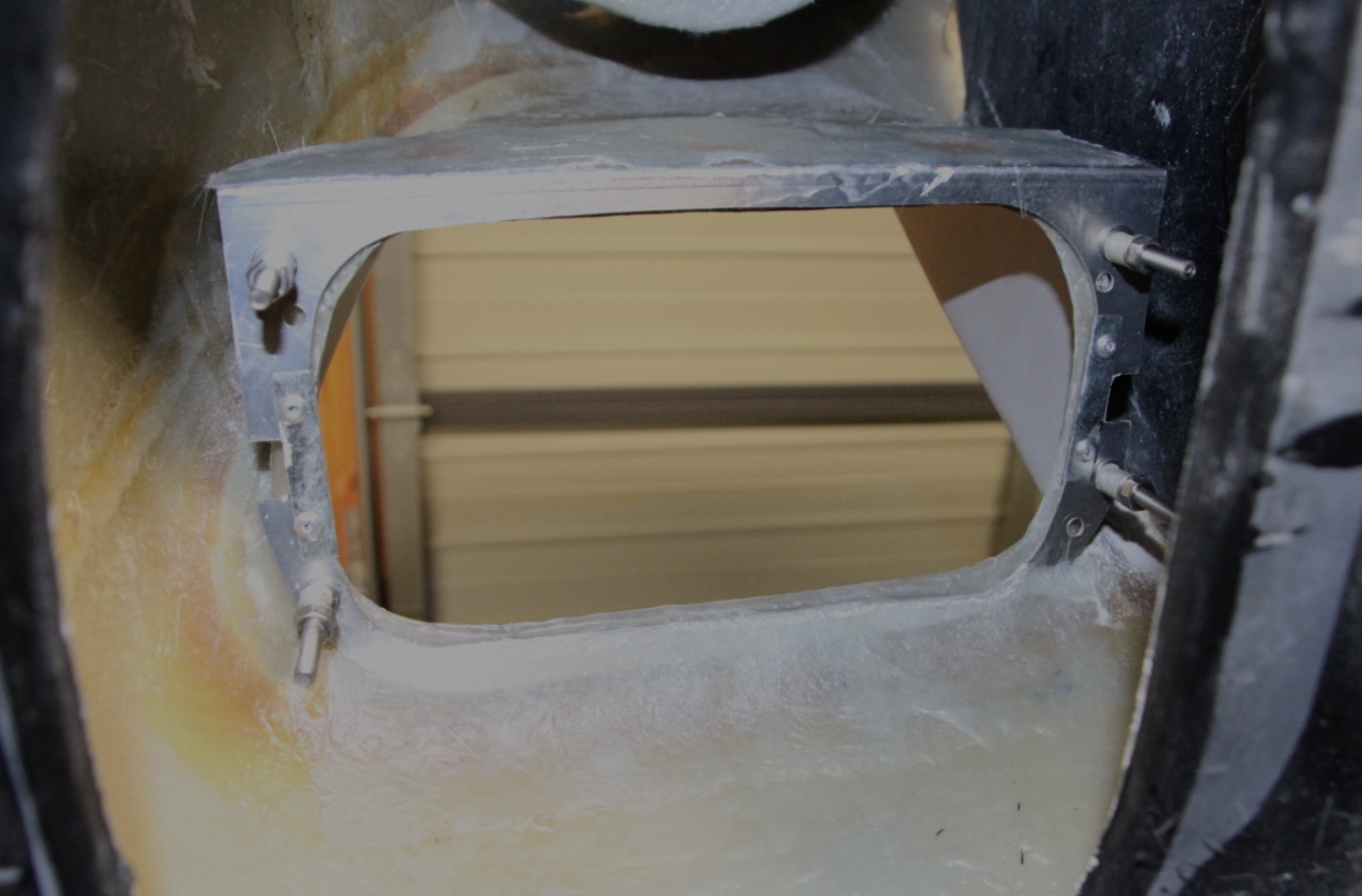

Brian Stewart
Quietly plugging away at the bodywork. All holes for lights and indicators now cut and glassed in the headlight mounting plates last night. Finding time to do stuff is the biggest issue at the moment.

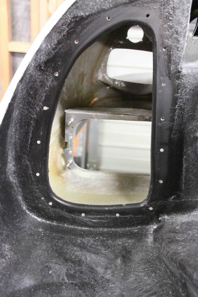

Brian Stewart

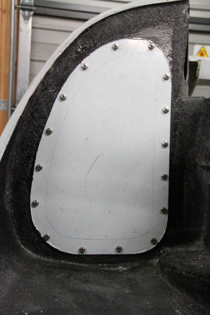

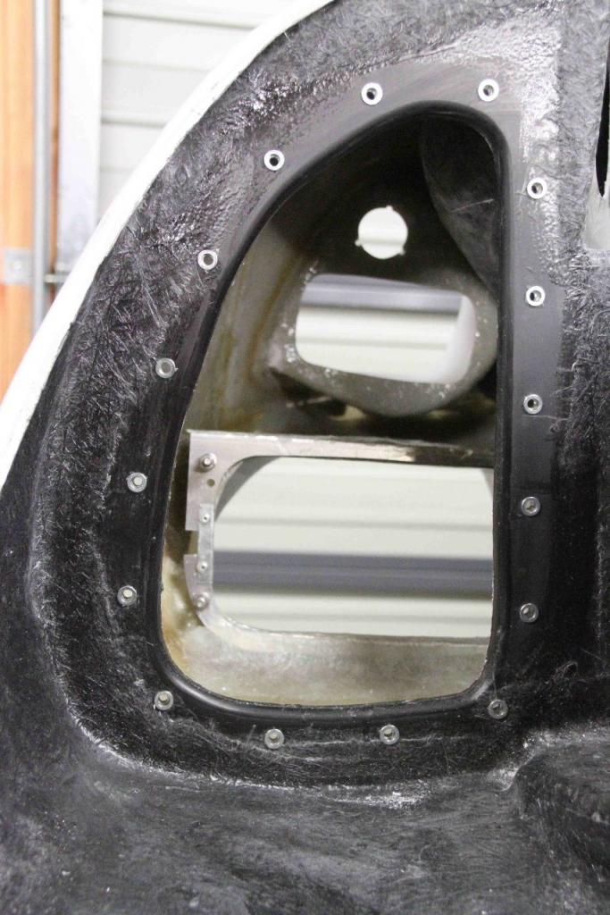

Got the panels that cover the rear of the headlight/driving light recess cut out last night and fitted them using rivnuts. Looks a bit rough at first glance, but that is the plastic coating on the aluminium....

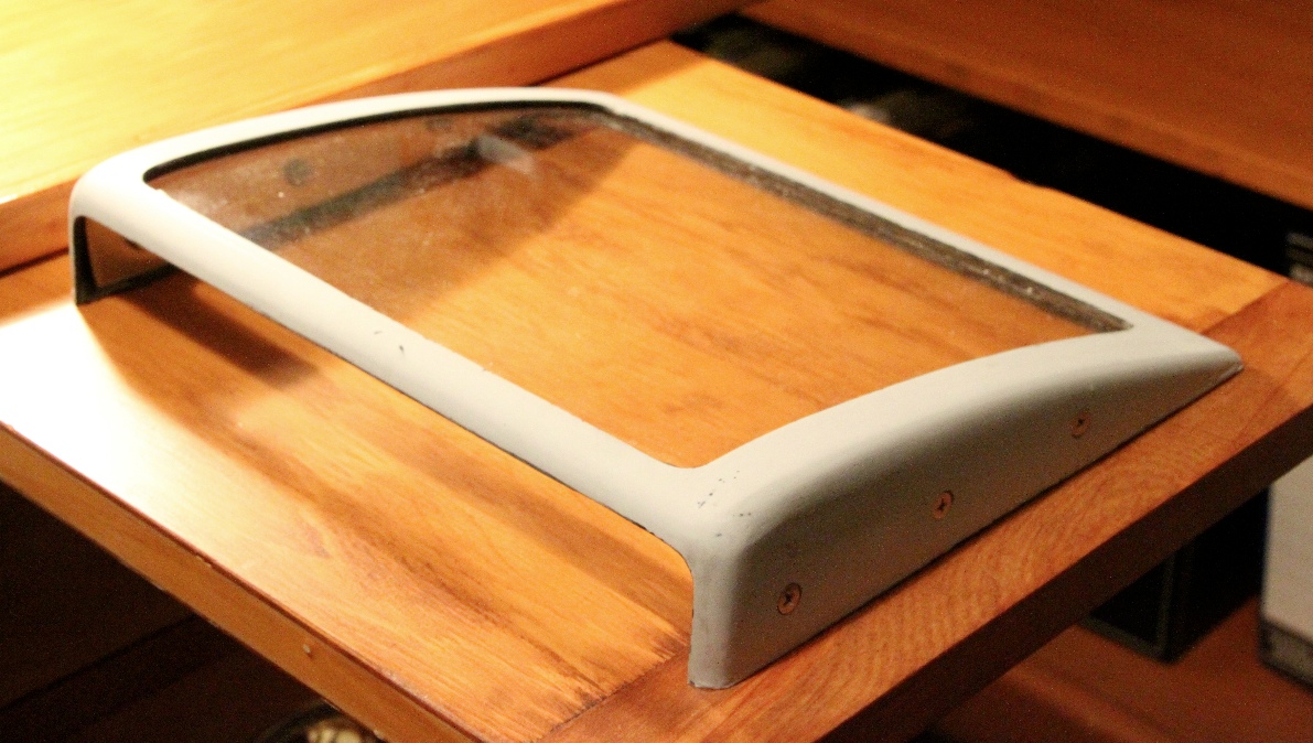

Shaped and installed the pair of aluminium "spacers" needed to hold the perspex part of the transaxle scoop in place last night.

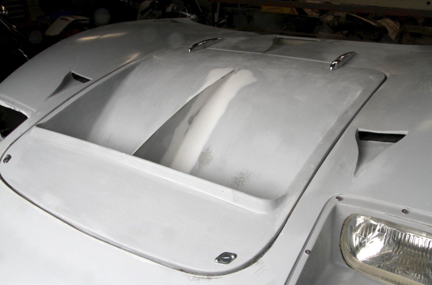

Brian Stewart

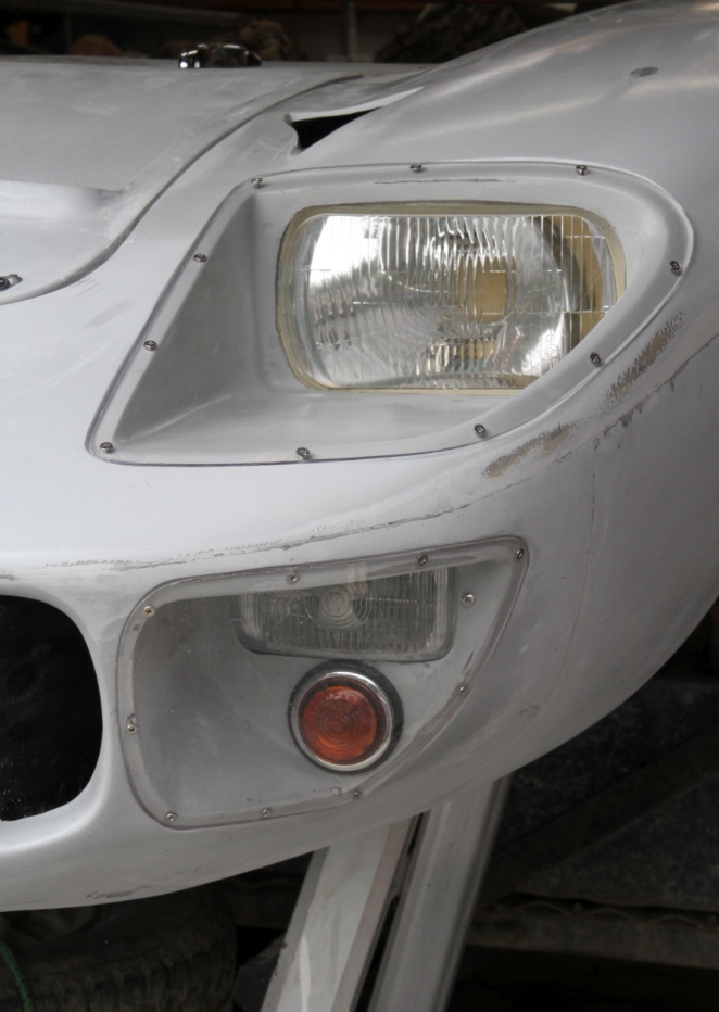

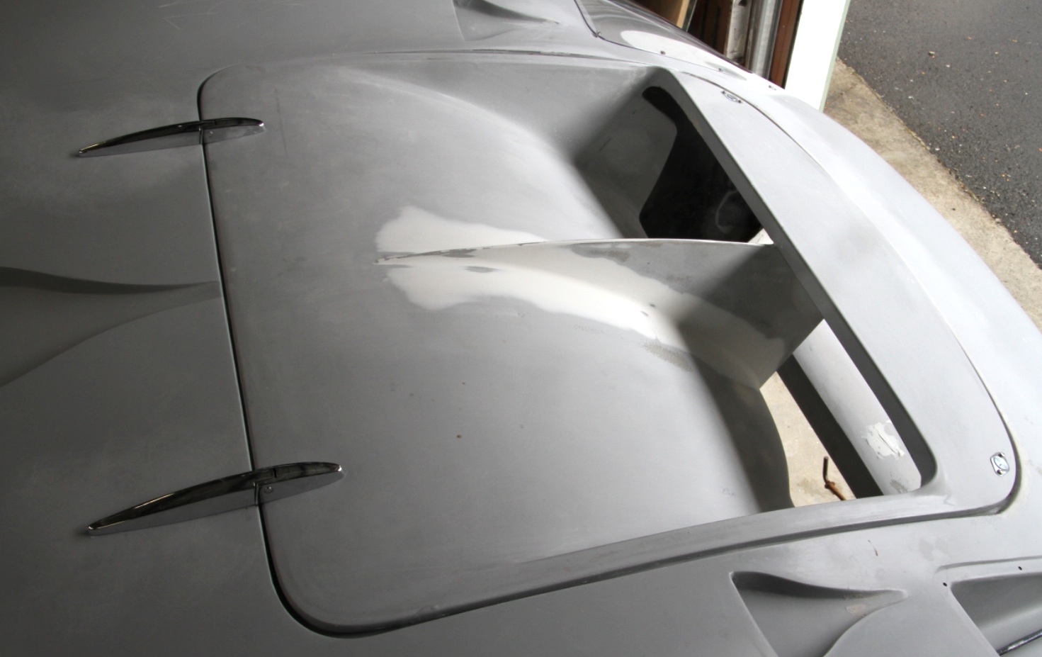

Been pottering away on the bodywork over the last few weekends. Lights all fitted now and light covers all trimmed to size, drilled and countersunk. Since I'm going for the early MKII look, as in the white car pictured, I made and fitted a divider for the single nostril and fitted hinges to the nostril panel with Dzus fasteners at the front. Some gapping to do, but coming together...

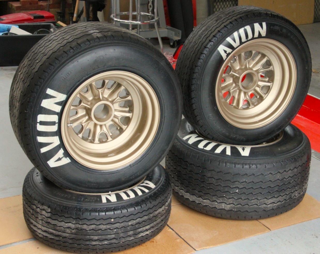

Brian Stewart
It will finally have some feet to stand on. Wheels machined and painted and the tyres fitted.

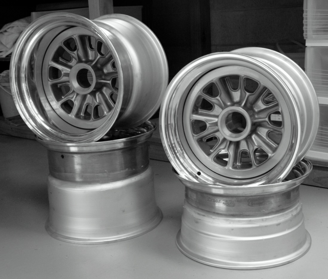

Brian Stewart
Hi Dave. They are three piece wheels from Image Wheels in the UK. However, I wasn't keen on the standard look of the Image wheels, with a noticable gap between the centre and the rim and a pretty flat centre (see picture). To get a more original look I had some rings laser cut from 20mm aluminium plate, glued them in using aircraft grade epoxy, then had a sloping profile machined. Paint is a Land Rover colour - Maya Gold metallic, code GAN. Tyres are Avon CR6ZZs - 215/60VR15 fronts and 295/50VR15 rears.

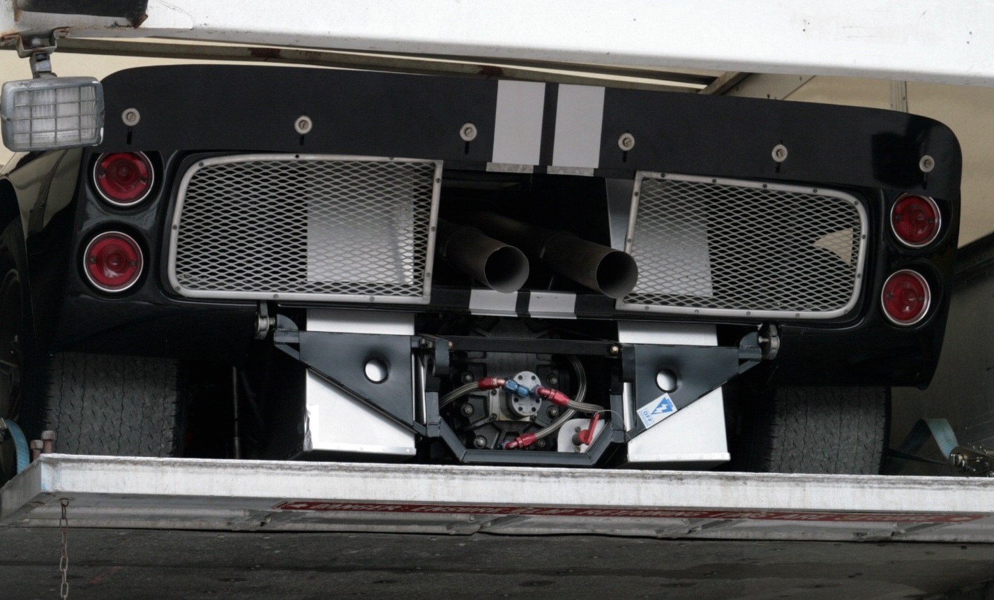

Brian Stewart

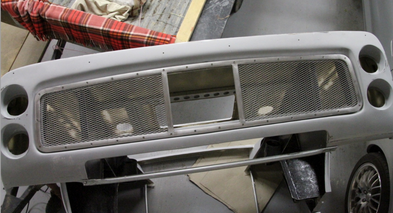

Rear grille fabricated and fitted.
