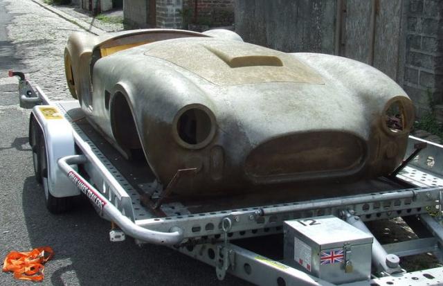

Hired a trailer 2 hour drive to look at it, returned with a chassis (free), body (free), rear axle (£30) and steering rack (£30). The kit is a 'Libra' cobra, bought 'in the mid 80's' the glass is in one piece with bonnet, boot and doors. Is the body a 289 cobra?
Yep, Doc, that's a 289'er!
The fishmouth is the giveaway, note the straight horizontal nature of the bottom of the fishmouth. The 427 variety had amuch more curved bottom lip, a mirror image of the upper lip.
Congratulations! That's quite a find, even in the sad condition you've found it, and from the description you've given it's definitely salvageable.

Old 289 slabside Cobra replica. Something a bit different compared to all the 427 shaped cars. Well I suppose you can't complain about the price. :D Enjoy.

I concur that it is indeed a slab-side..

I'm with Randy on this one--slab sided 289's are in demand here in the U.S., although only to a select few--the 427's outnumber the 289's by a huge margin. Most of our 289's are FIA replicas, slab sided 289's are very difficult to find....

BTW what is a 'slab sided' cobra? is that an early model cobra? production model?
When Shelby first started shoehorning Ford 260 V-8's into the Ace body, at first they were just production bodies. Keep in mind these British sports cars were usually fitted with 4 or 6 cylinder motors, no need for large tires, so the sides of the car coursed straight down, like "slabs". Well, with the SBF ol' Shel needed more space for tires, so he essentially massaged those "slab sides" into the Cobra equivalent of our "Gulf flares". Ace saw the writing on the wall and changed the fenders very quickly to accommodate Shel's need for more tire; hence, there are very few slab sided original Cobras out there.
For example, look at your photo at the front wheel arches. Yes, you do have a slight flare at the lip of the wheel opening, but the flare doesn't extend all the way up to the top of the fender; now, on the other hand, 289 FIA models usually have flares that extend all the way to the top of the fender to accommodate more aggressive front tire profiles.
The newer Cobra replicas have taken this to even further extremes in order to take advantage of current wheel/tire options that weren't around in the 1960's.
Many Cobra purists believe the slab-sided Cobras were the most beautiful, others believe what I see as a "bloated" 427 model to be the epitome of Cobradom........but not enough want the slab-sided look that the replica manufacturers are willing to invest the R & D time and money needed to release those models (I did hear some rumblings that F5R is going to release a 289 model, but I haven't heard anything about that one being a slab-sided model).

Its actually has several different model Cobra features- Rear guards are slightly higher at rear than originals, brake ducts did not feature on slabside, nor the hood scoop.

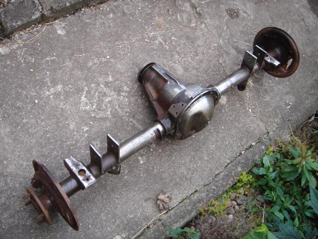

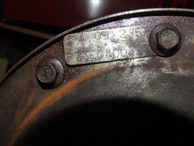

Ok here is the rear axle, from a Ford Capri 3.0 V6. Tag shows ratio of 3.09 and it has LSD fitted.

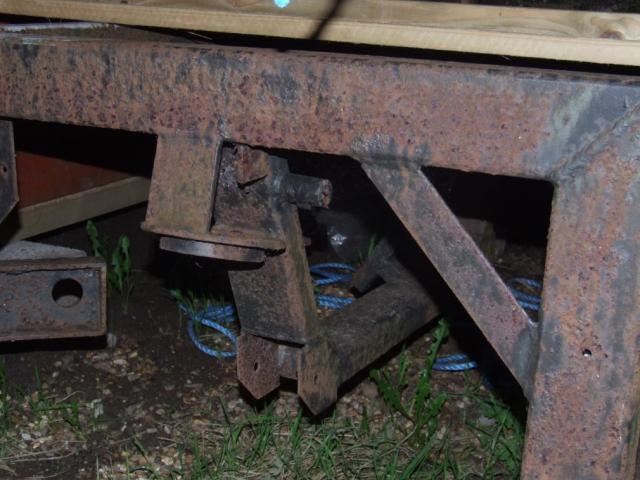

The original capri leaf spring brackets are on the ends of the axle and the 4 bar link mounts are inboard. The angled bushings can just be seen below the axle and the two plates mounted on top take the coilovers and the straight link to the chassis.
Look at the rear chassis and you can see the angled mounts.
Which way does the axle go in? as shown or is it upsidedown in the photo. No info on lengths of arms so I will have to work out the best geometry.

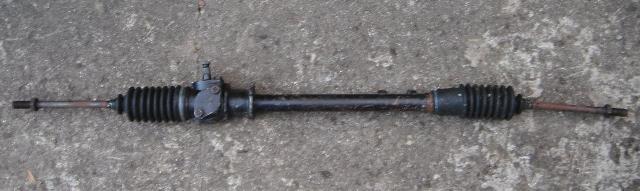

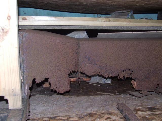

Also a shot of the front suspension mounts and the rack. Oh and something that was a tunnel.....

Rear axle is upside down in pic, I would start again on the chassis ( Get a refund on your investment at the scrappy :) ). , convert rear axle to 3 bar ( retain two lower and fit one top link going forward & down slightly on RH side of diff center ) plus watts or panhard link. Doc , your gonna get us kicked off the forum with all this Cobra talk!
PS, you will probably be able to find a rear cover for the diff that has an integral pivot point built in for Watts linkage-- check with the classic escort rally car boys at the local car clubs etc.

Your rear axle was a real bargain. Price was under w/o LSD -level....
It is old model 3,0 Atlas, maybe from mk1 Capri.
If so, it`s narrower than mk2/3, but a little bit wider than Escort Narrow Atlas.
3,09:1 ratio was in use from -70 to -86 (mk1 3,0 "uprate" to mk3 280 brooklands)

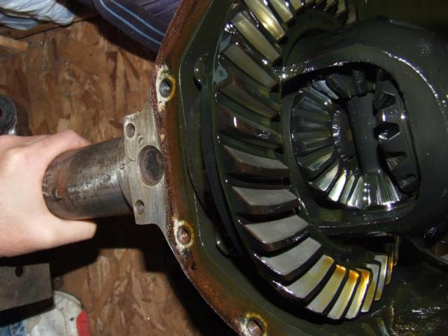

Pulled the back plate and no LSD...damn.... was going to sell it and buy a doner for the cobra.
