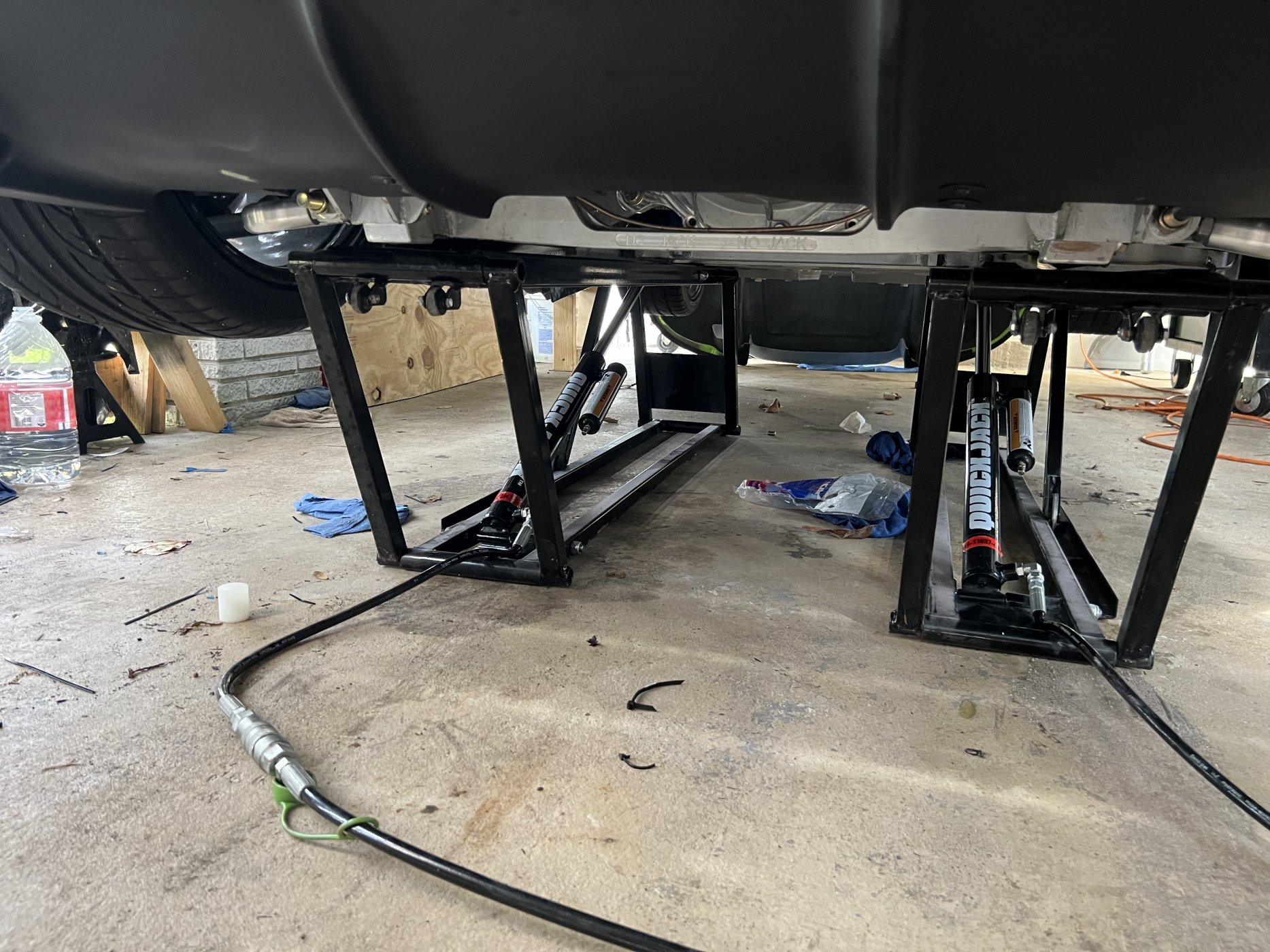

Should have purchased these a long time ago. If anyone is reading this who is thinking about building, buy some quick jacks. I can drive right over them and they leave plenty of room to do things under the car.

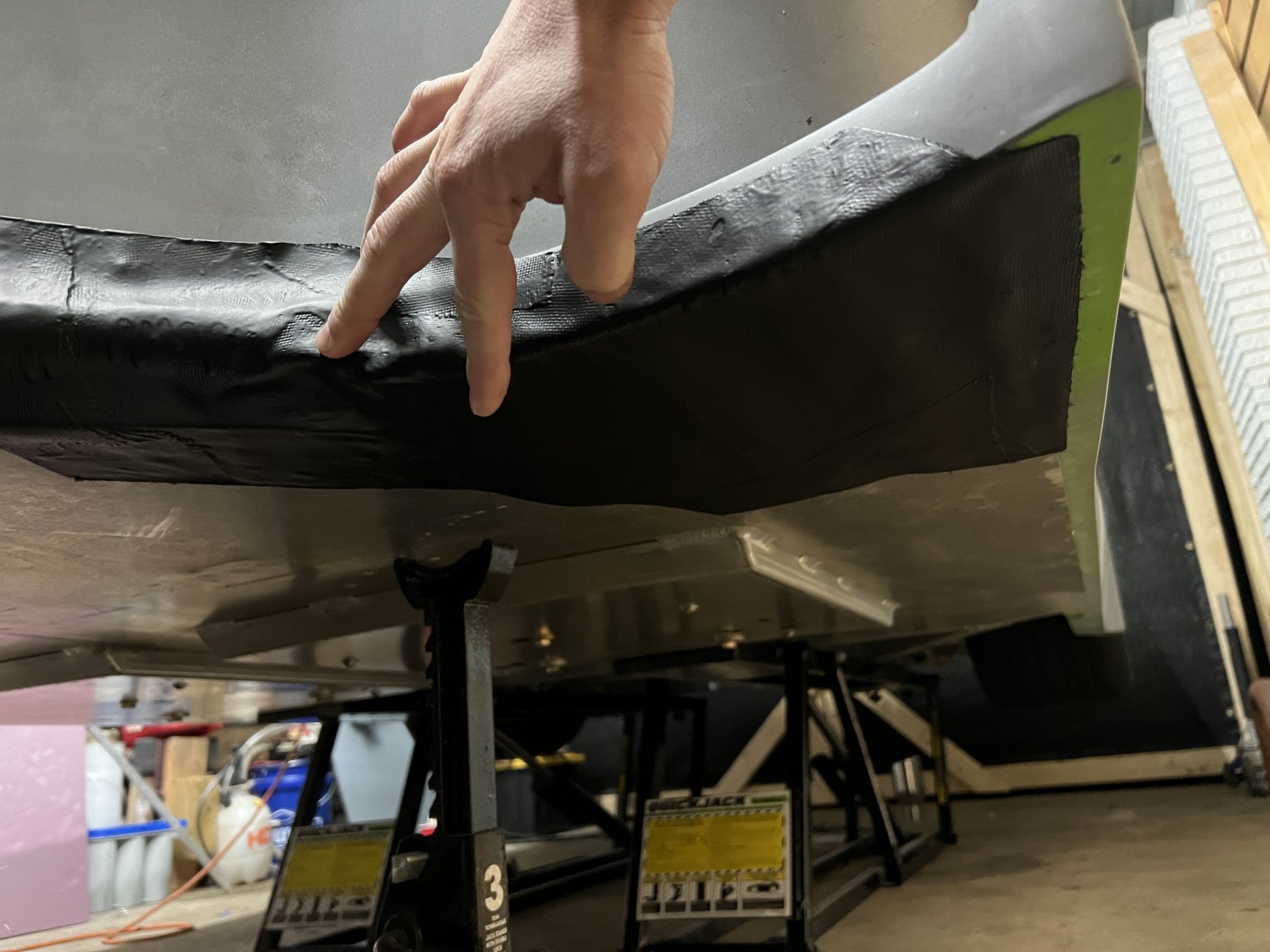

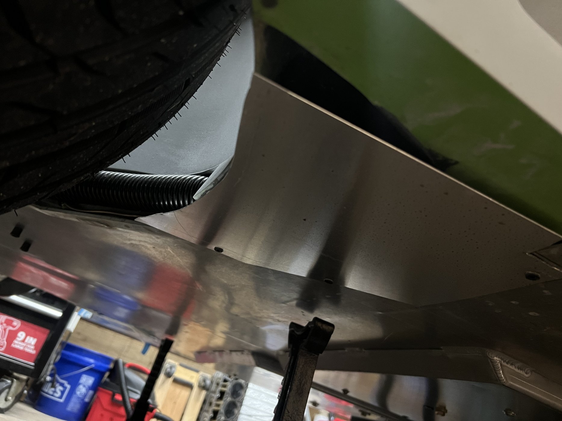

Took out the thin sheet metal that was covering the holes near the frame and slider. Replaced them with some formed fiberglass covers. Ugly but functional and they’ll never be seen. Blue and aluminum tape was just for mock-up. These will be fastened with 1/4 hex bolts.
Got some quick jacks on sale at costco last year! Just need to buy the car to put on top of them. They're pretty solid, I've used them sideways on our SUV for some tire swapping. They aren't what I'd call convenient, but they do work very well.

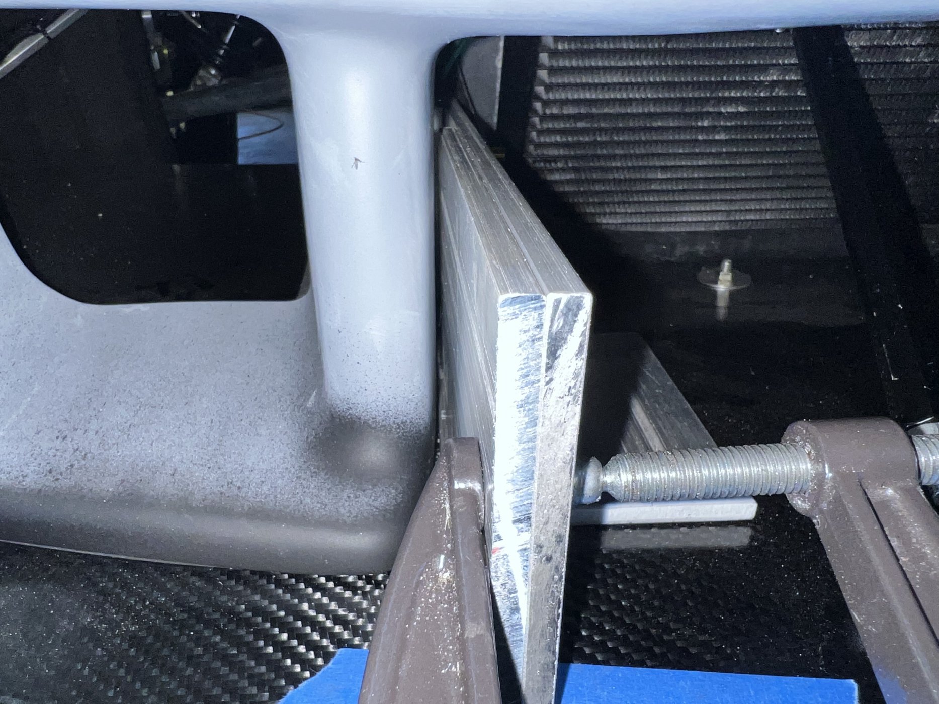

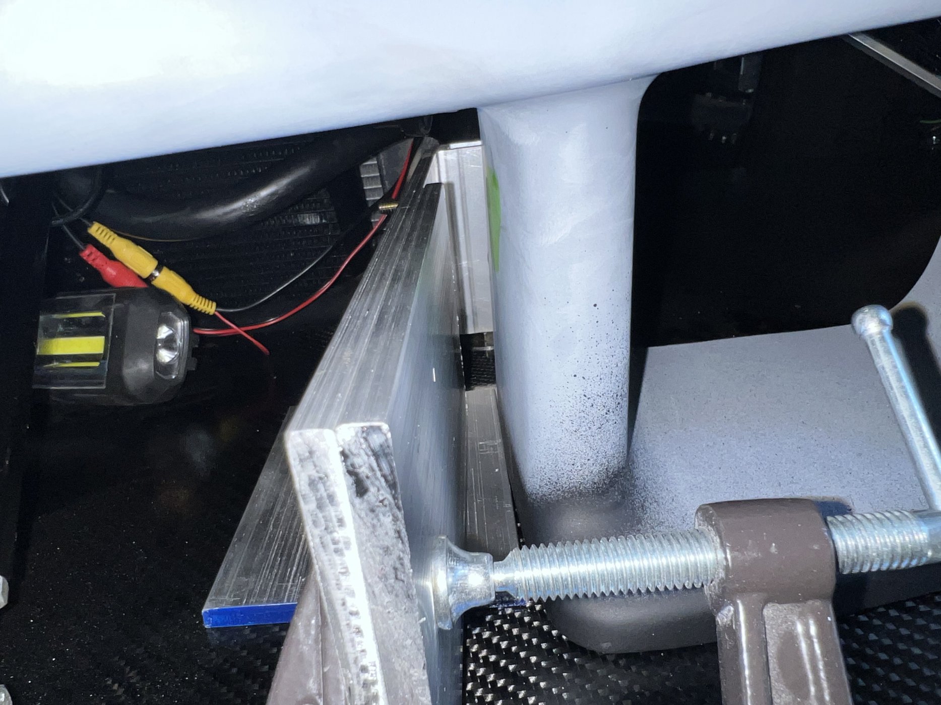

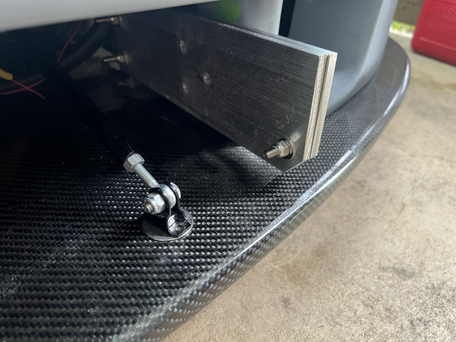

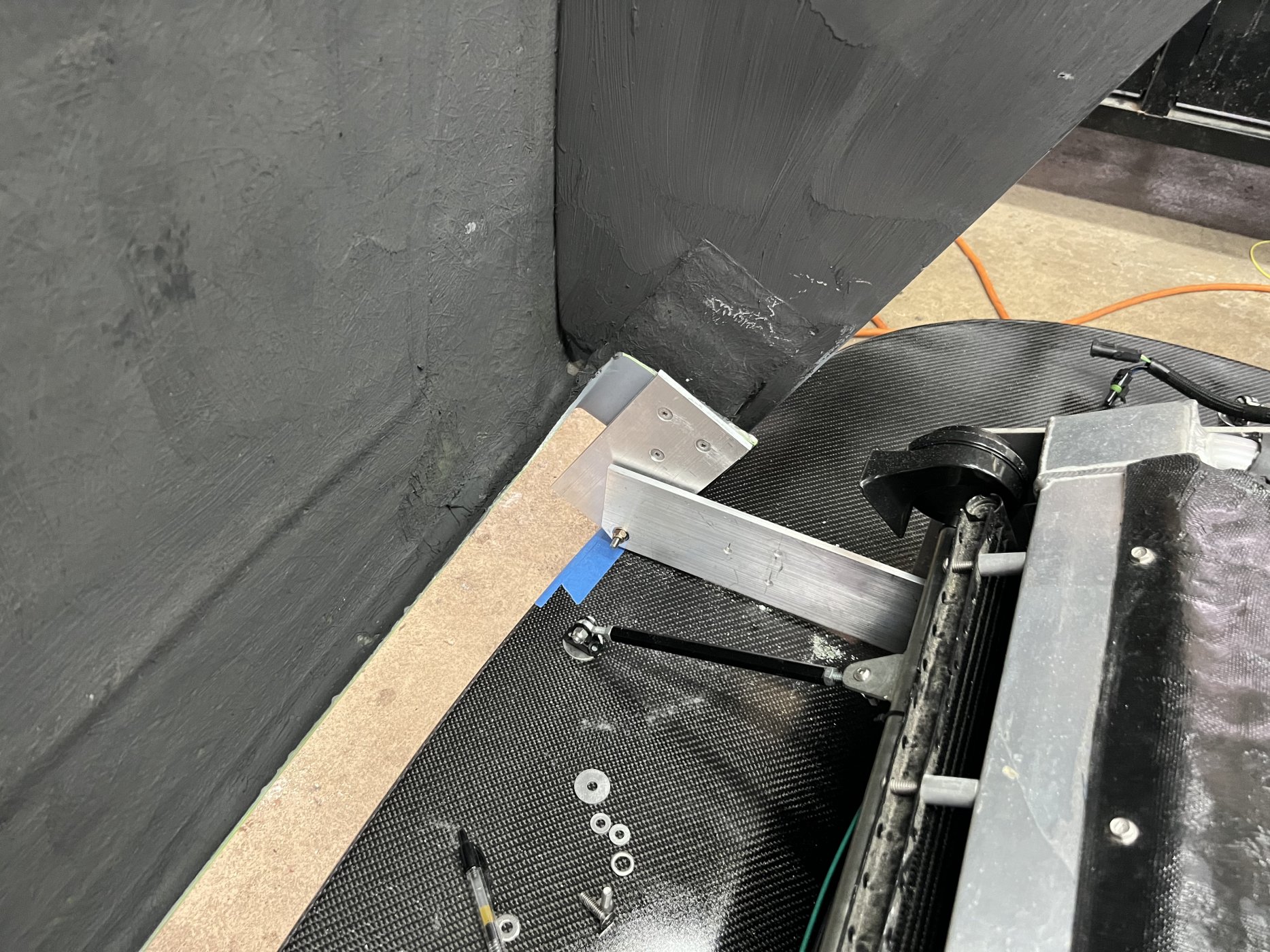

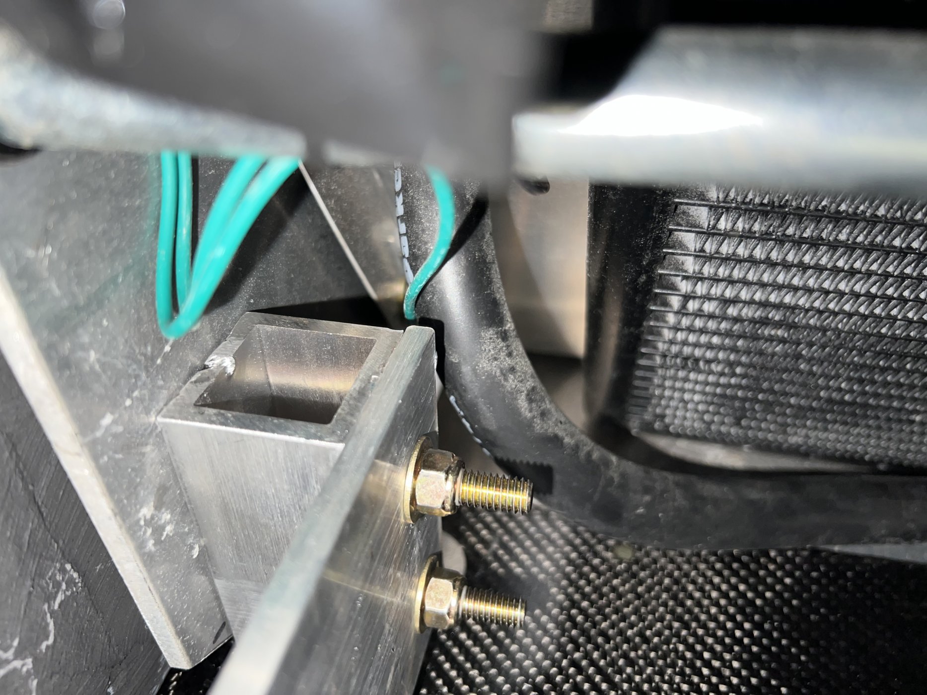

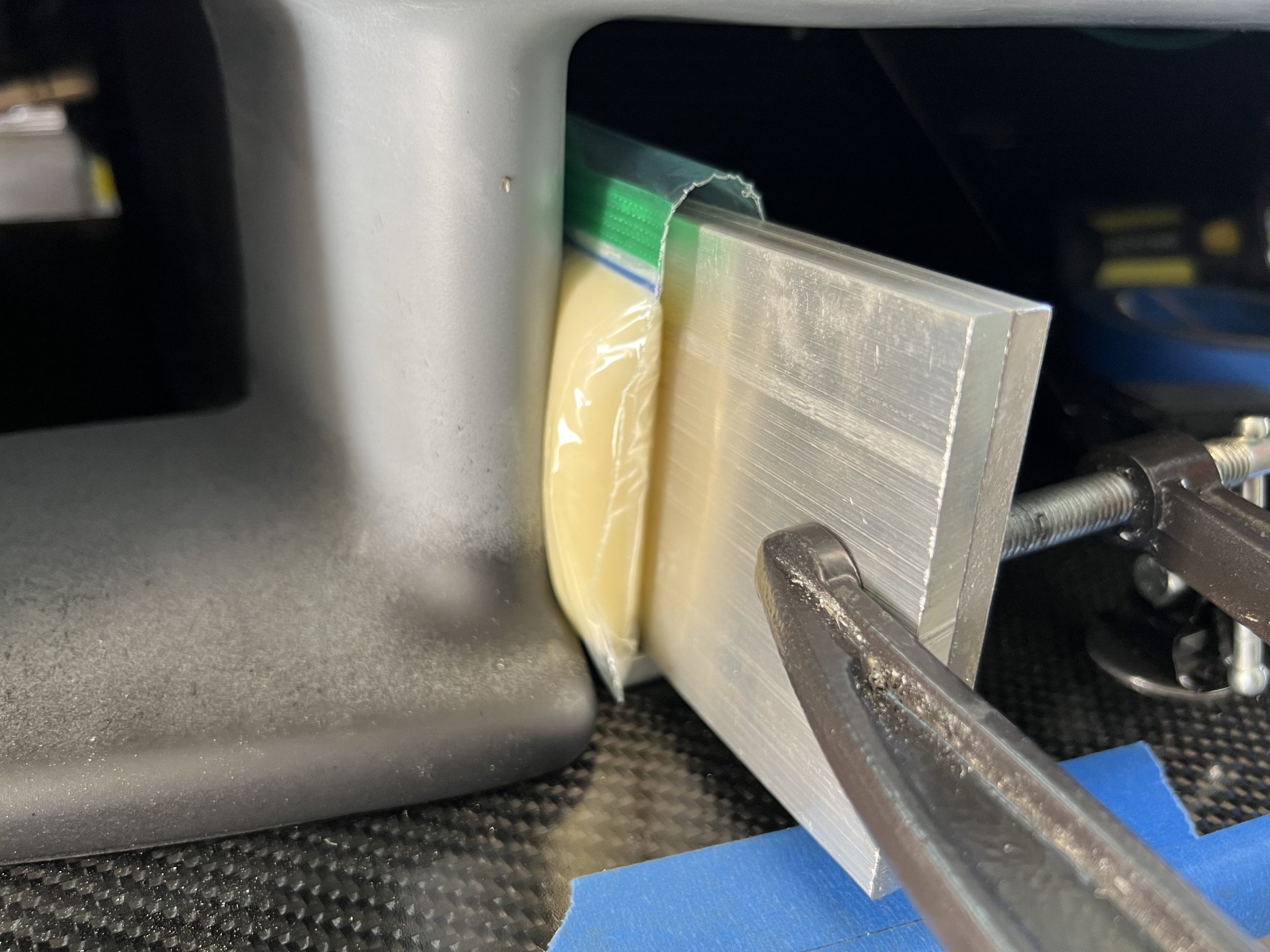

Front hinge was big on my to do list. Two 1/4 aluminum 3.5in pieces, used some 1.5in square tube to space off the frame. Expoxy spacers as the gap just wasn’t perfect. It works as it should, however the wheels have to be turned slightly or the wheel wells hit the tires. I also need to craft up some pneumatic lifts as it is hard to hinge up as one person. I’ll finish cleaning up the edges later and round everything off.

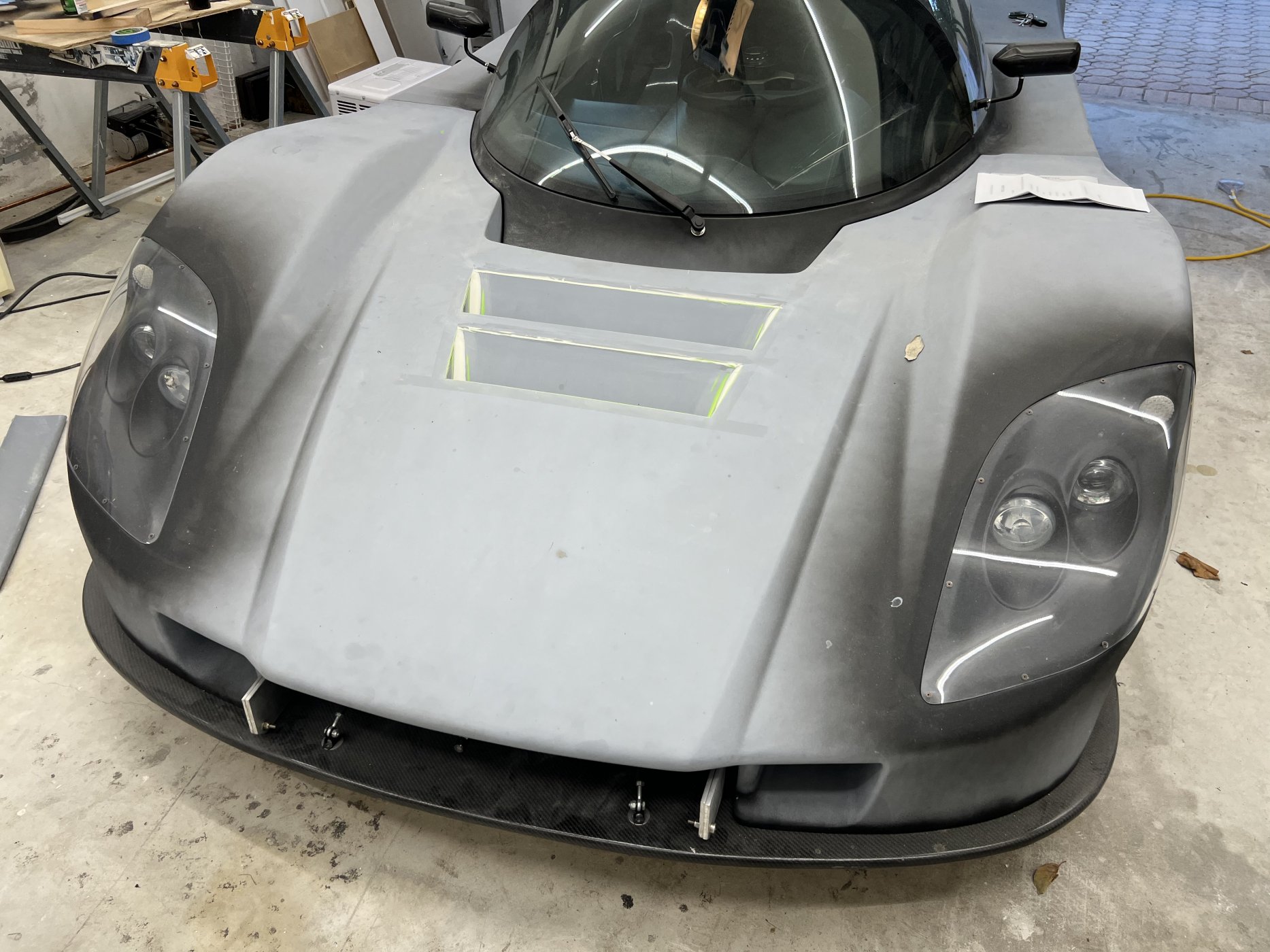

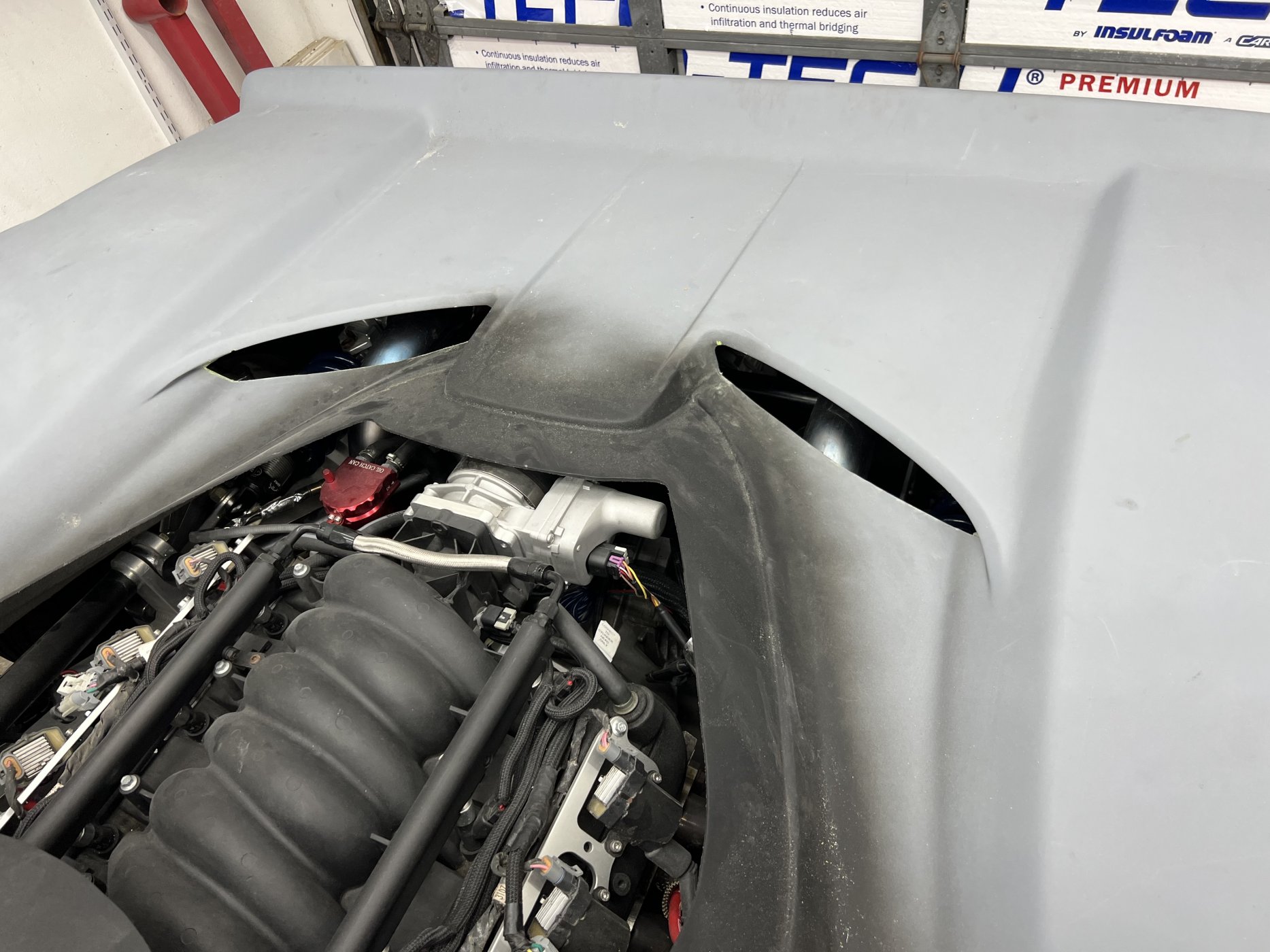

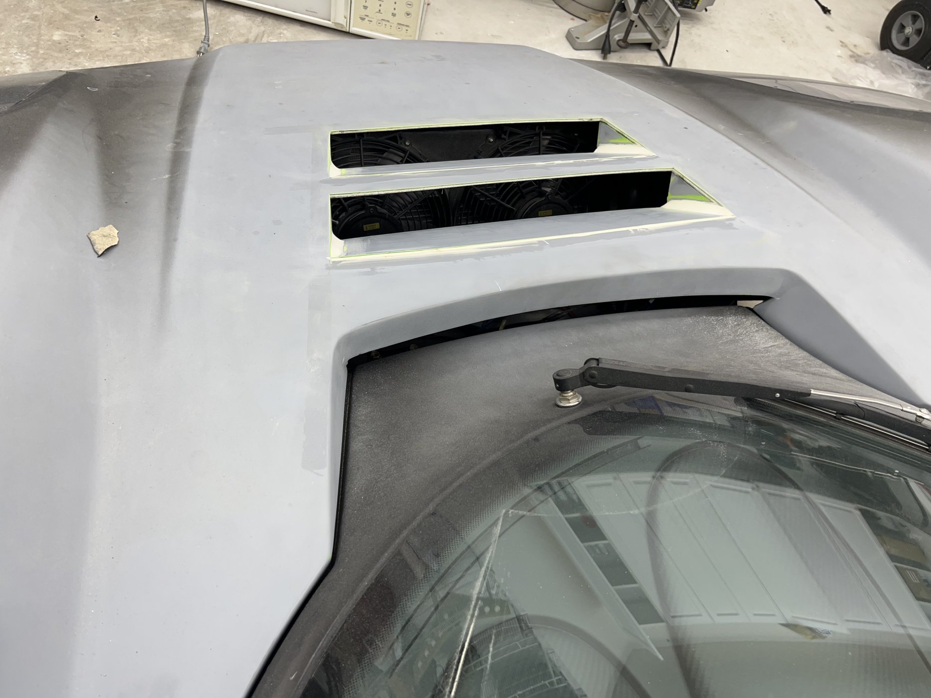

This is going to look stupid, and it is. I didn’t have much laying around to act as an air diverter for the front clam. But low and behold I had an old windshield sun shield. As proof of concept I’ve laid it in as haphazardly as possible to test. During a brief drive things seem to be much improved.
Going forward I will be cutting out more of the front clam and probably adding in some vents, similar to the C7 corvettes. I’ll then attempt to reorganize the front area and build a fiberglass air diverter.
Happy to report otherwise the car stays under temp and runs much better with a raise in idle speed and some additional timing down low.
Also if anyone has any idea of where to place some gas struts and what length, that would be great.

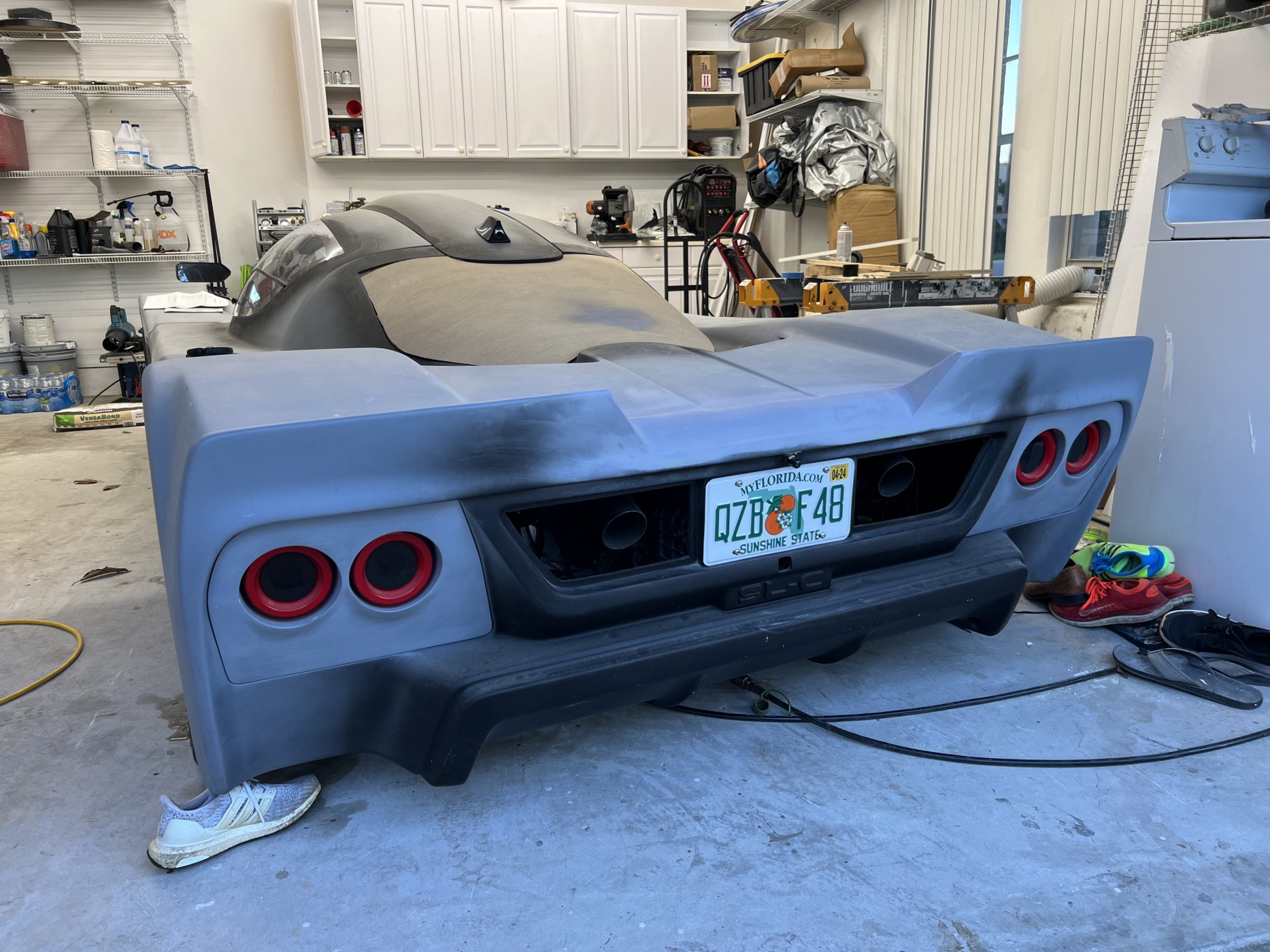

Been awhile. Moved to a new house, finally have a garage with AC to work in. Finished up a new design for my exhaust. Don’t mind my welds, still playing with the Mig. These will be wrapped.
Soon I’ll be ducting the radiator, opening the front clam for more flow, adding some custom fender vents, rear air cleaner duct and splitting the rear spoiler.

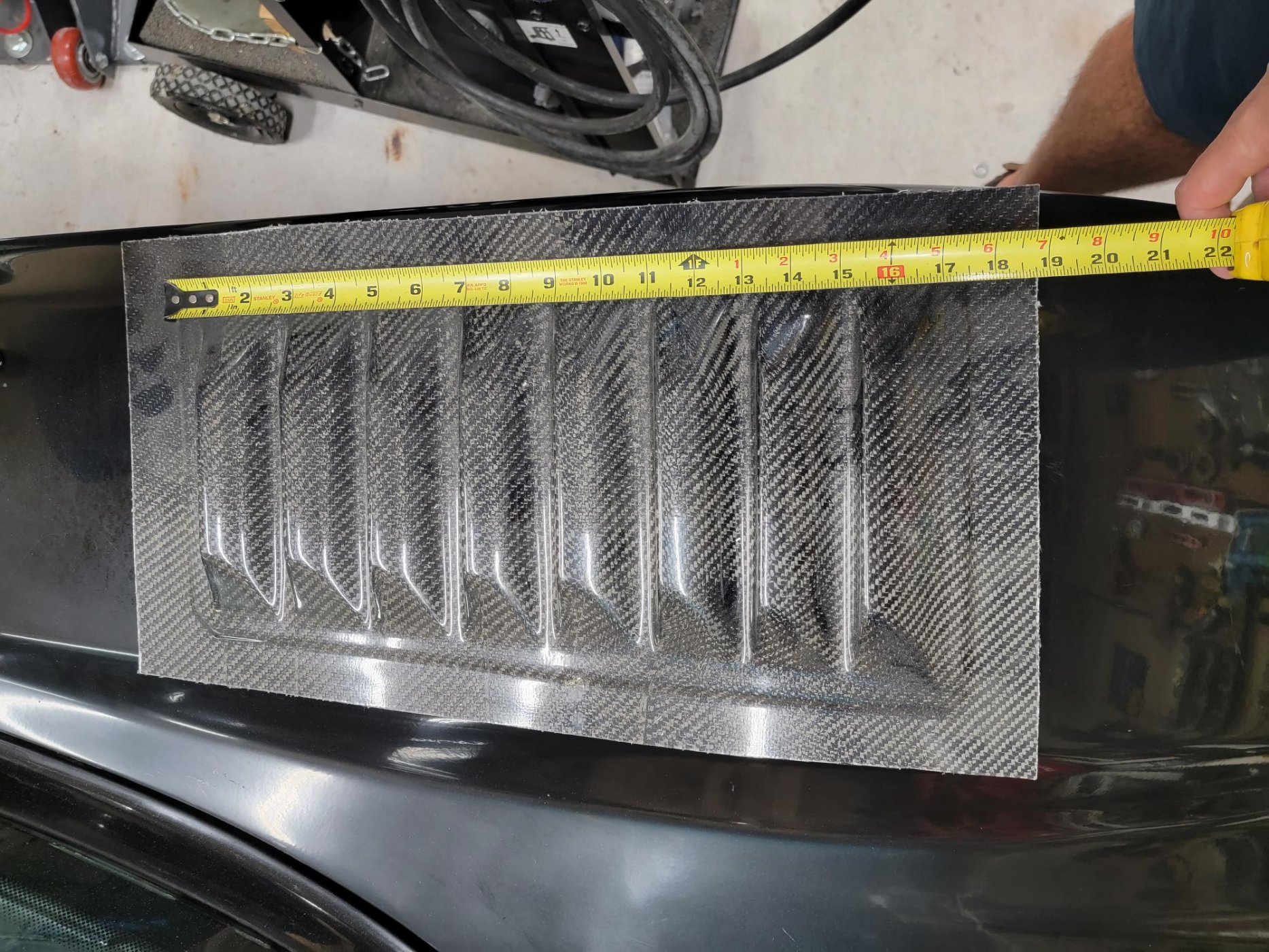

Anyone have measurements of the SLC fender vents?

Mark B.
Congrats on the house and the garage with AC -- I'm very jealous!

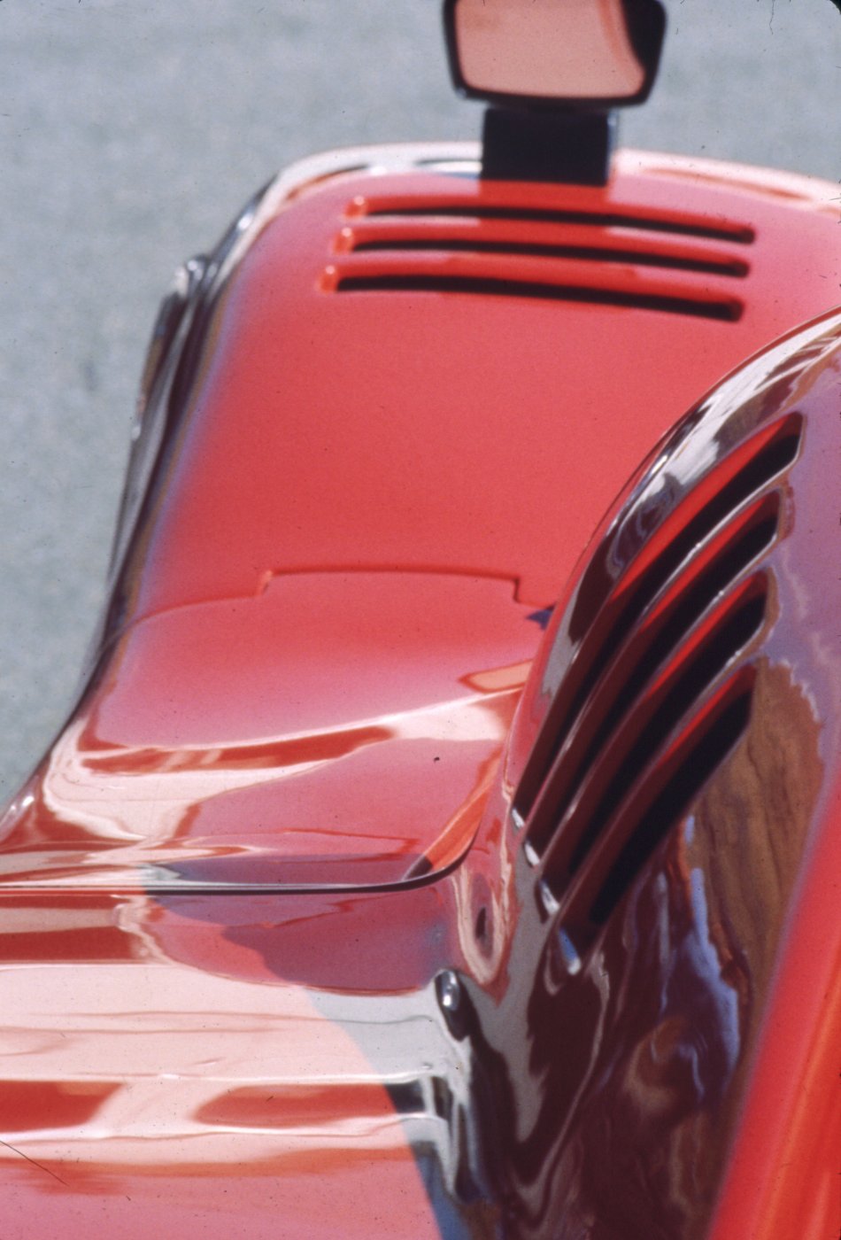

The factory fender vents are 17.5" long (measured at the raised area intended for the fender cutout), 9.75" wide at the front, and 8" wide at the back (front is at the right side of the pic below, this is the driver-side vent before installation)
Howard Jones
The RCR supplied set is not symmetrical. One will fit on the l side and the other on the r. If I were to make a set, I would make one mold and then use the one re-designed style on both sides so therefore much less mold construction.

There really isn't a NEED for the fender vents on a street car driven at near legal speeds. The SLC is intended to be a self-built street-legal supercar. Additionally, the underside of the front fenders as well as the vents take a lot of beating from road debris and the "fingers" between the vent holes are especially susceptible to cracking. I wouldn't put them on a streetcar unless I was willing to replace them as they cracked and were broken. At least they are replaceable but they would not be if molded into the original fender design.
I have repaired mine on my track car twice. Not really that difficult but you must catch them as they initially begin to crack and not wait until a "finger" comes off.
