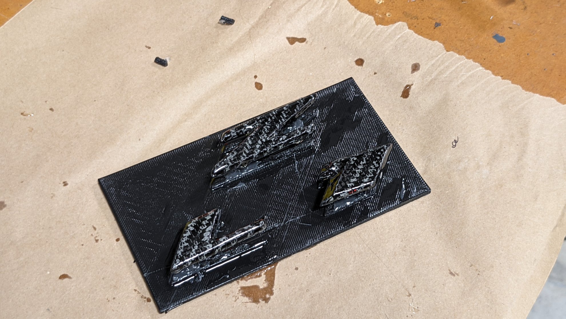

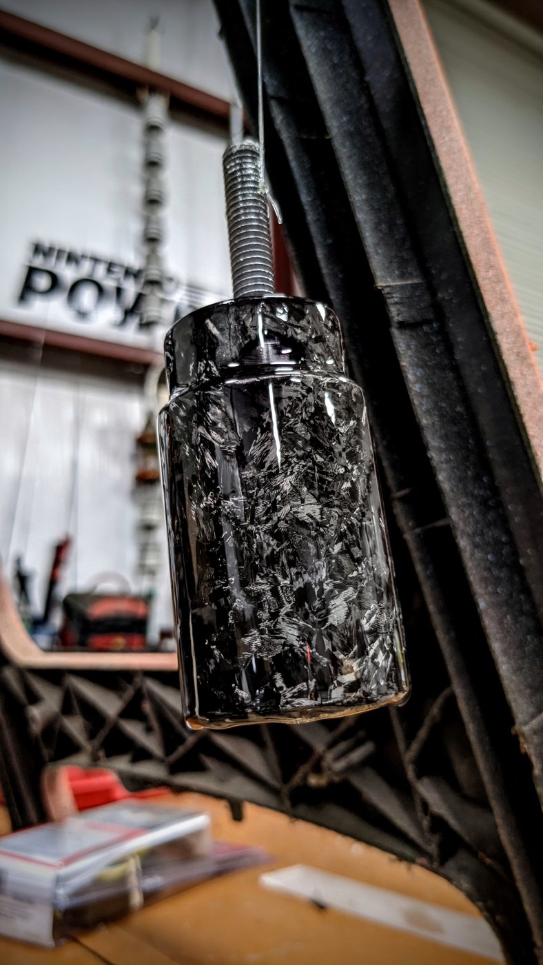

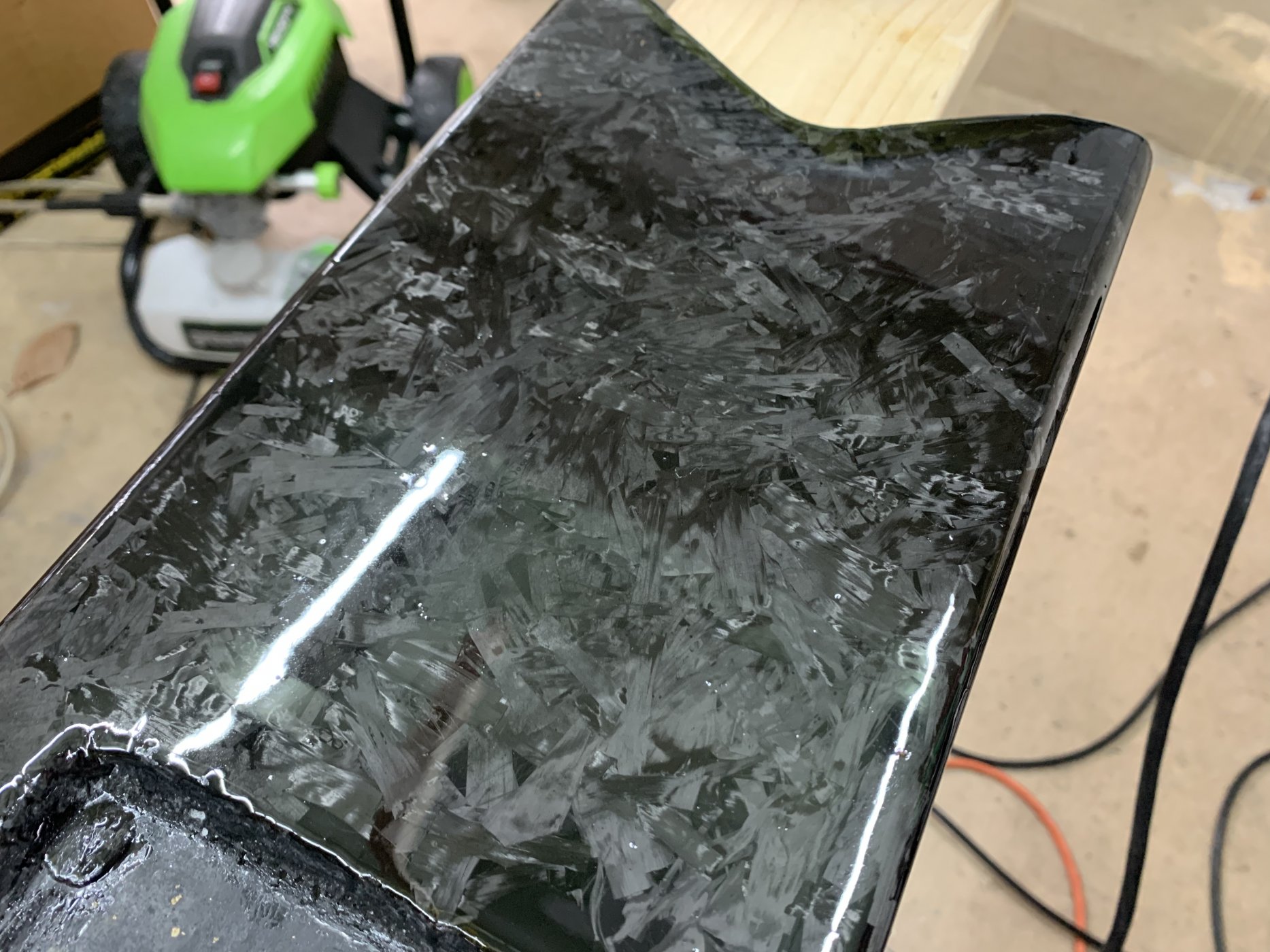

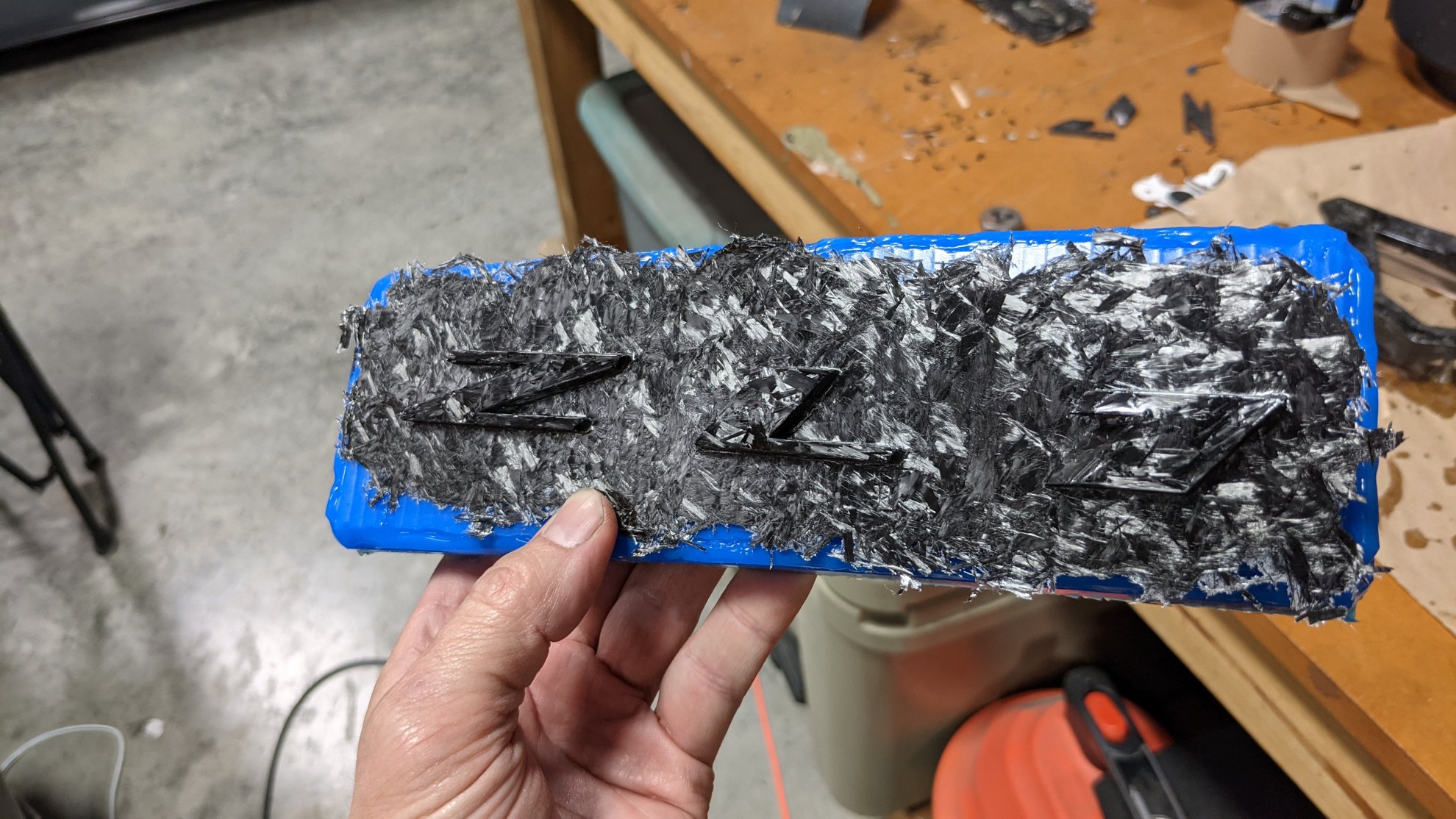

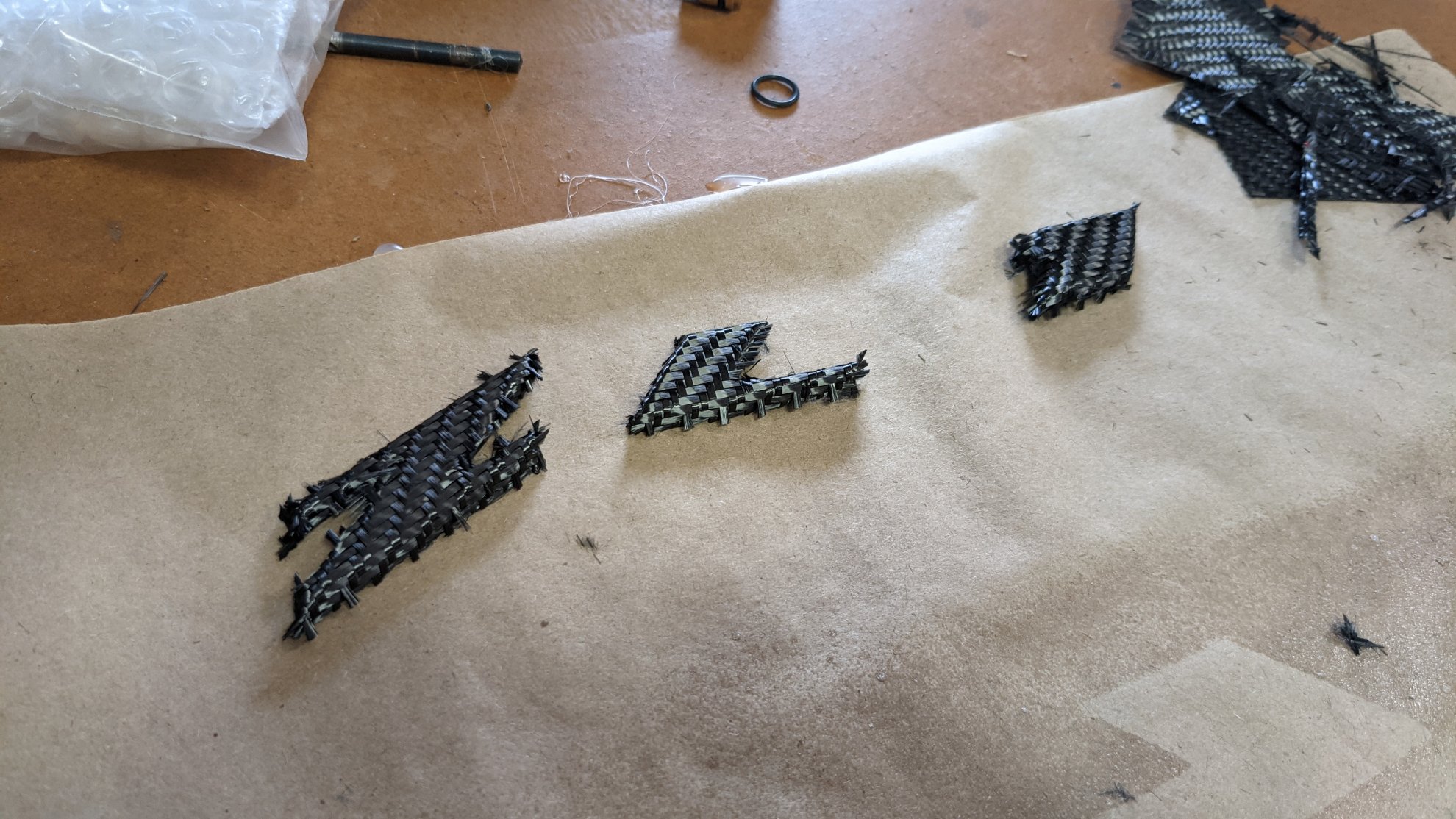

I've done quite a bit of forged carbon skinning past several months, although on smaller objects and with 1/4" carbon. After trial and error on handful of things, will relay my procedure in hopes maybe something will be of help. This also works great on regular carbon fiber too, although you can't be quite as carefree as chopped.
I use a typical cheap food vacuum bag sealer. Normally wouldn't be useful for you, but actually would work for skirts since you can buy bag by the roll. Brother has a pneumatic vacuum sealer with a 4x4 bag he used to veneer drums years ago, now it's mine. I have yet to try it, but need to see how well it works.
- Clean part, make sure it's either black or has been painted black in case you miss a spot here or there.
- Lay down 3 layers of clean masking paper (like you'd use to protect floors of house). Put part on it.
- Using Gorilla spray adhesive, lay down a layer on part. Remove top layer of masking paper, under part, so it's on clean paper
- Start generously sprinkling chopped carbon on top and cover as much as possible.
- Cut vacuum bag to length and seal one end with vacuum sealer.
- Mix up epoxy and start dabbing it on the carbon to wet it all out. Examine and lay more carbon as needed to spots that need it.
- Peel ply, then absorbing mat.
- Slide part in vacuum bag, start vacuum sealer and let do it's thing. Let cure.
Parts seem to come out great using the food vacuum sealer, better than I expected. Attached a few pictures of random things I still have pictures of on my phone to see outcome. The forged ZL1 emblem is the latest thing, also is full carbon I made a from a silicone mold of emblem. I need to trim and do a full wet coat, they have potential.
Those look fantastic! This side skirt is coming out well, just lots of sanding. Vacuuming and peelply is the way. I don’t think I’ll do another part without it.

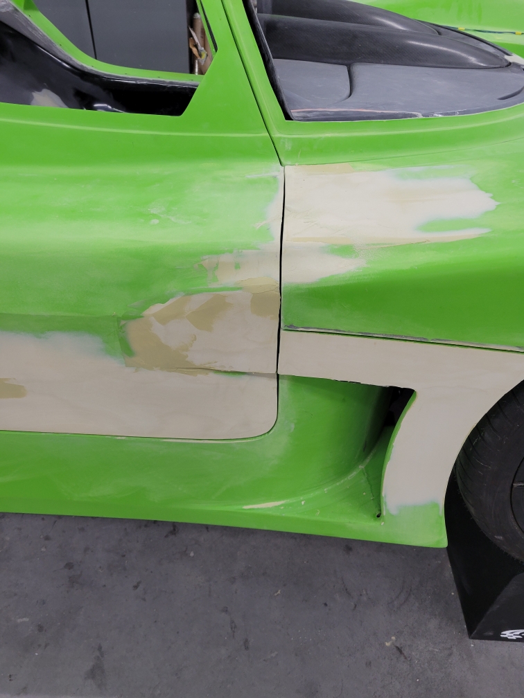

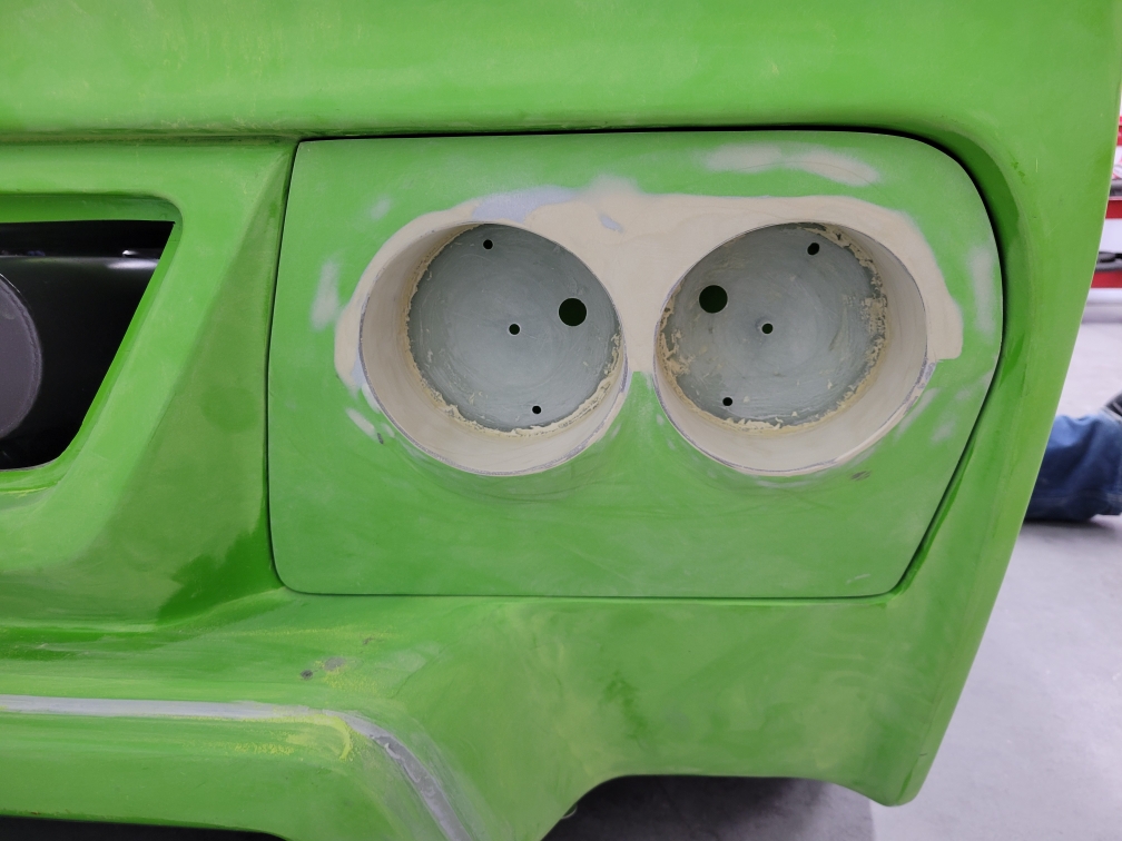

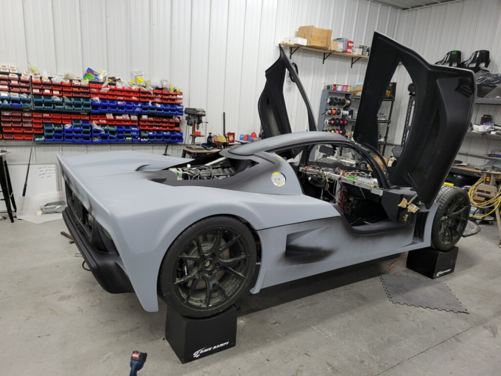

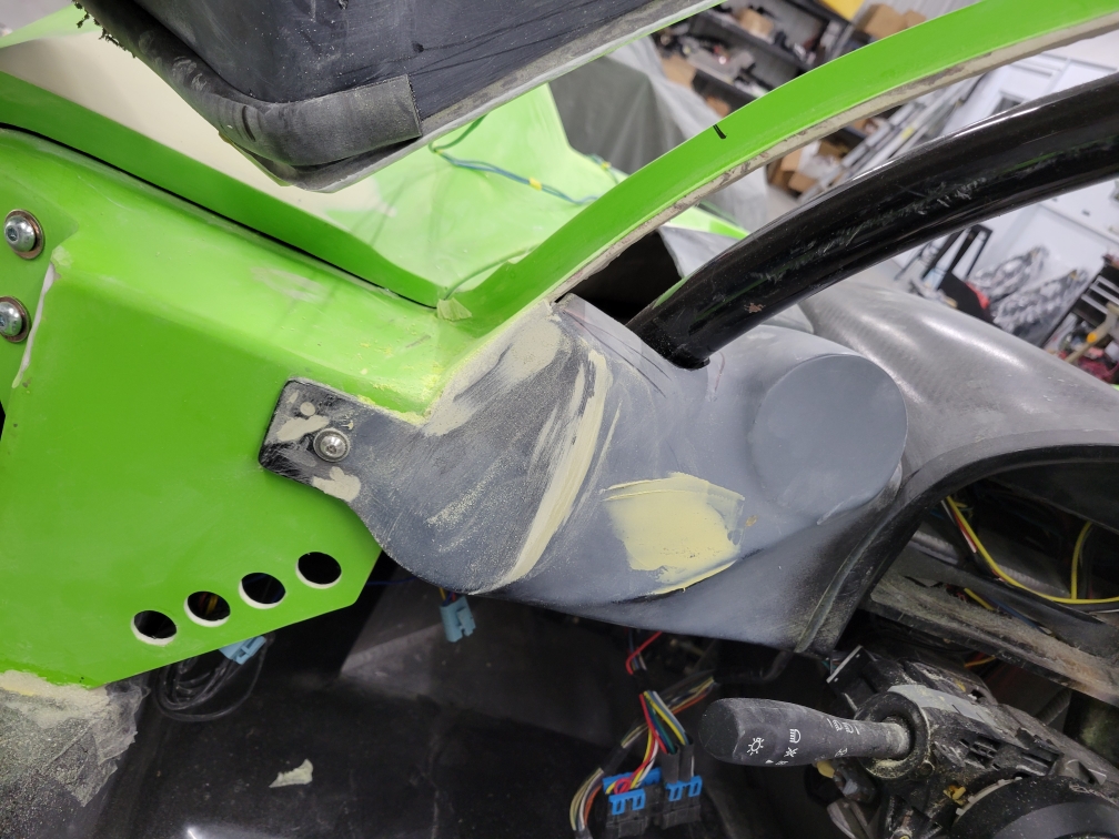

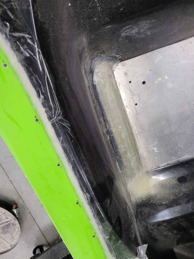

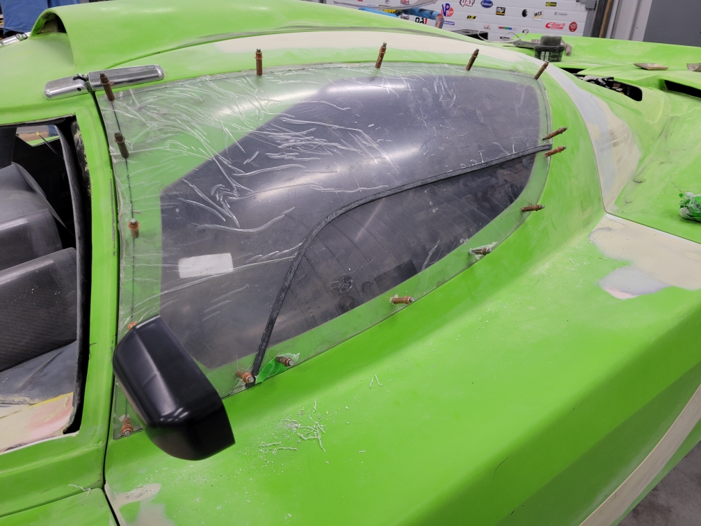

Allan has been making good progress. Doors and actuators are all adjusted and working well. He did have to add a bunch of fiberglass layers to the door where the hinges meets. I did not modify that area at all, so anyone building in the future check this area.

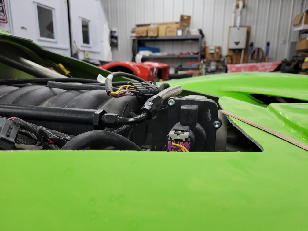

Anyone using an LS, make sure you get the corvette style throttle body. My truck style 3 bolt is too tall. So I’ll have to convert my Holley connector to a 6pin plug. Should be good to go then.
The forged looks awesome on the side skirts. You're definitely right, plenty of sanding for sure. At least it's flat and no little nooks and crannies to get into with it. After using vacuum and peel ply, it's hard to imagine doing it any differently.

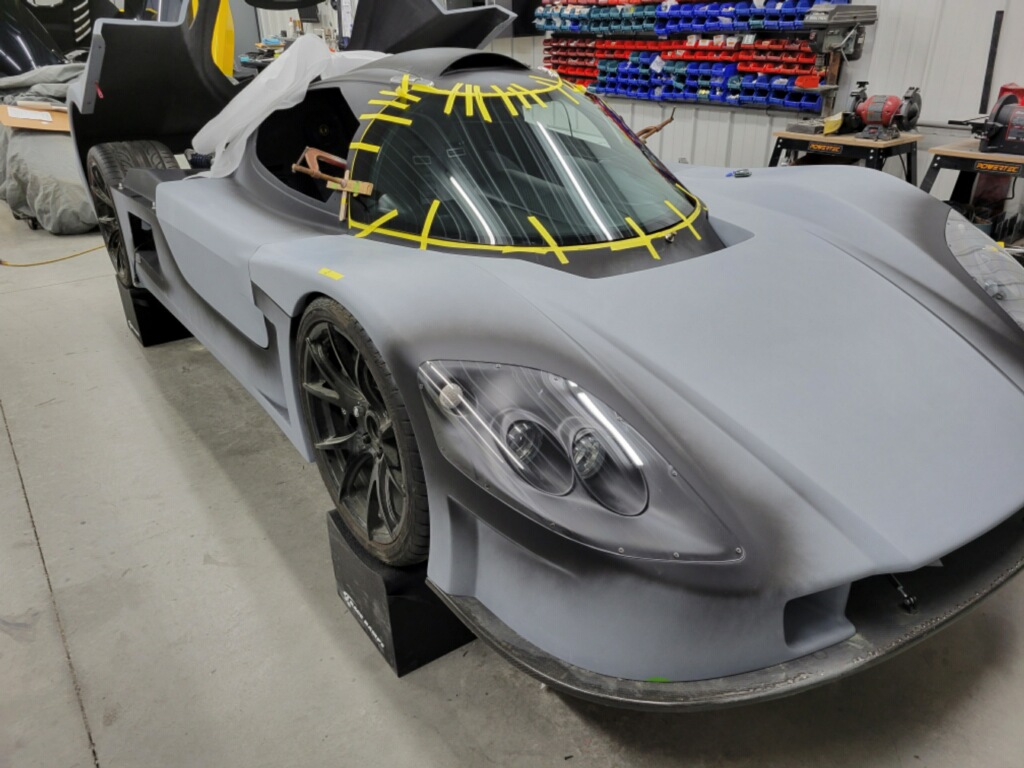

Little update. Allan says the car should be finished this week.

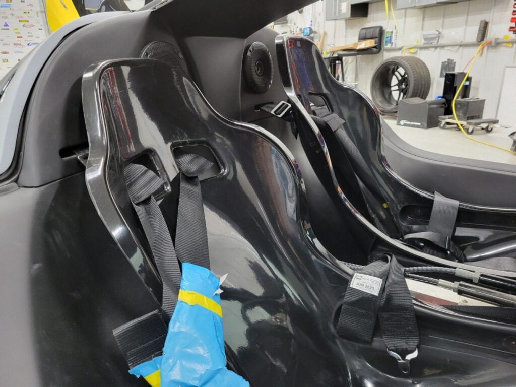

Is Allan also building your an upper console to hold a couple more speakers? If not, may be worth considering. Not really for extra audio, just visually looks nice and filler between the seats.

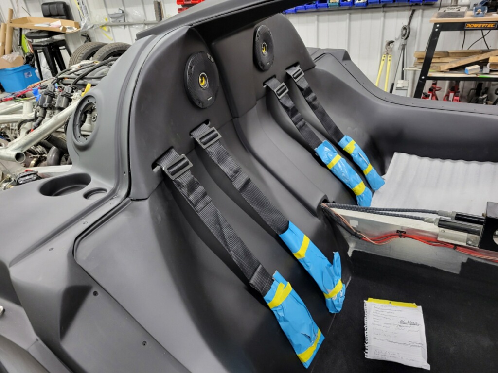

In hindsight if I was to do mine over again is I'd put 2/3-way 5.25/6.5 behind the seats like you, enclose the upper console Allan built to hold little 6/8" sub.

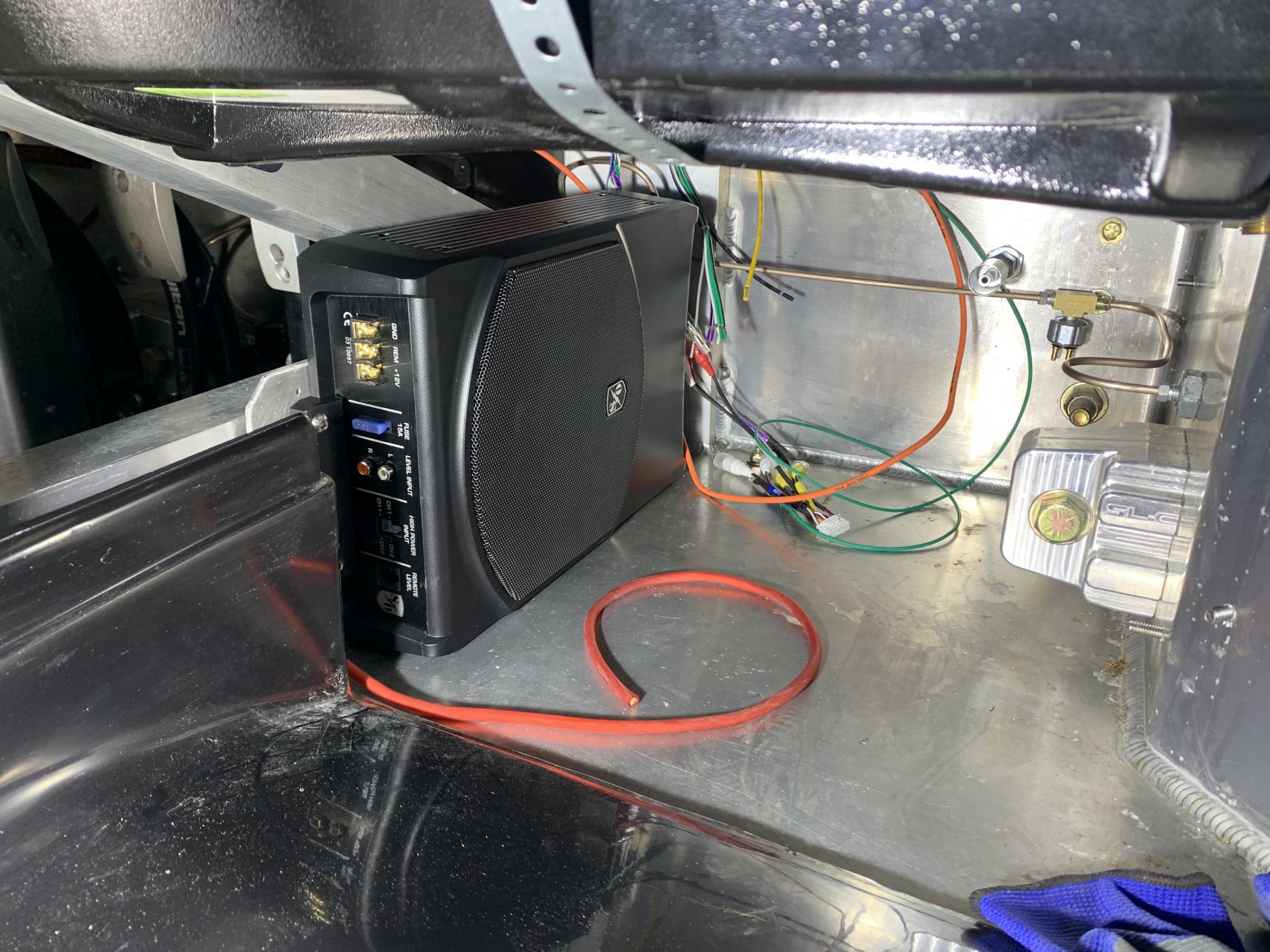

In the passenger well there is a 8in powered sub. I think my biggest worry is going to be rattling. I think what im going to do is add some more sound deadening in the doors and possibly add some expanding foam in the distal corner of the door as well. I need to remove the door inserts to carbon them anyways. I also want to remove the dash and add some more foam/deadening etc.
Have pictures of the 8 enclosure? I built one for mine, but had a brain fart apparently and didn't take into consideration the HVAC was lower, lol. Box was just a cube so easy to rebuilt, but it's on the back burner for now. I agree, I'm curious about rattles from it or just sounding bad in this car from so much metal and fiberglass, but some umph is desperately needed in mine. :)

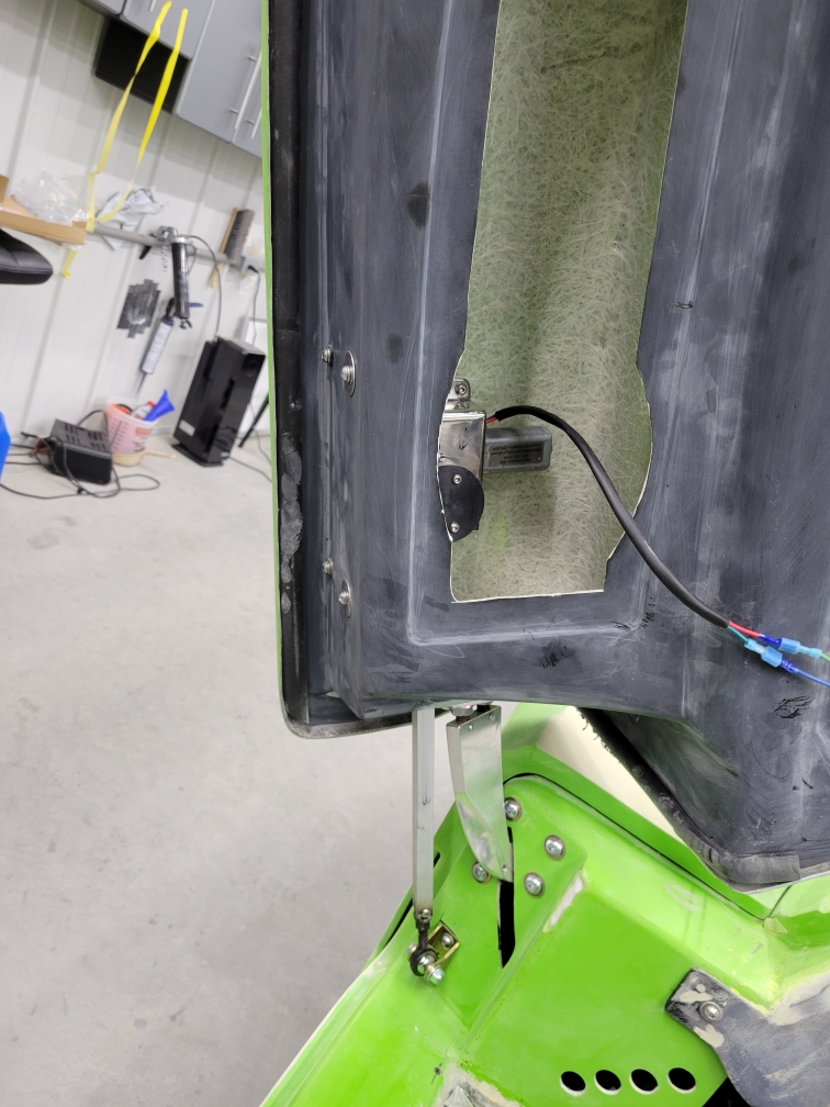

Make sure to ask Allan how to readjust the doors for when you remove and skin them in carbon. I understand the linear actuators are finky when you add weight after they're set.
Here’s where I put mine, no idea how it sounds
. I know in regular vehicles these pack a punch. Obviously not a 10/12 but it will help. Plenty of room in the footwell too.
I’m hoping if I can close on this property I’ll have a two car detached garage as a car work shop! So if I can ever decide on a color then I’ll attempt to paint it myself. Allan basically did all the hard work for me with prep and primer.

Kyle - Looking really good. what brand and model is that speaker?

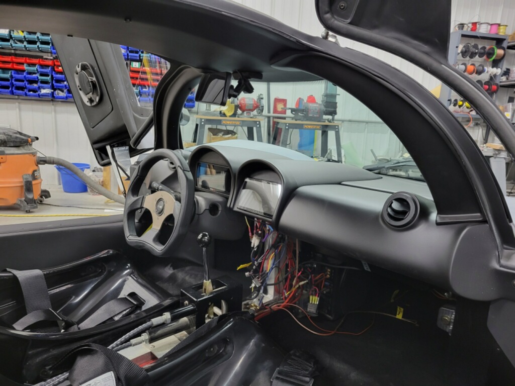

Fran @ RCR sells a LHD rack ,this will be the easiest of your conversion.
To do a “Full” conversion I probably would have needed to move the center spine over a couple of inches. However, the amount of time required just wasn’t worth it. My seat is tight to the center console, but that was going to be custom anyways. As you said, steering rack, dash, and center tub were the main things needing modifying.

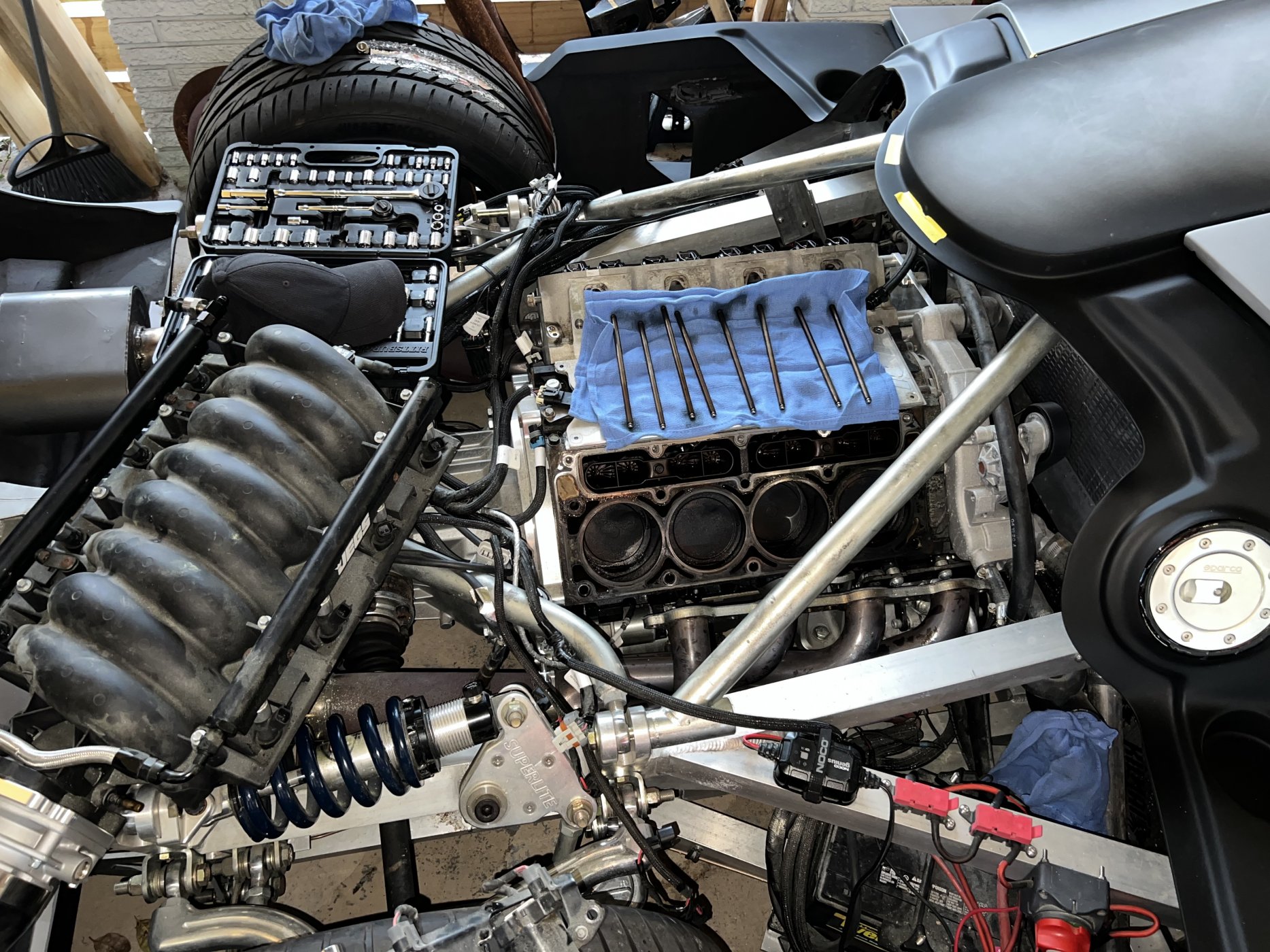

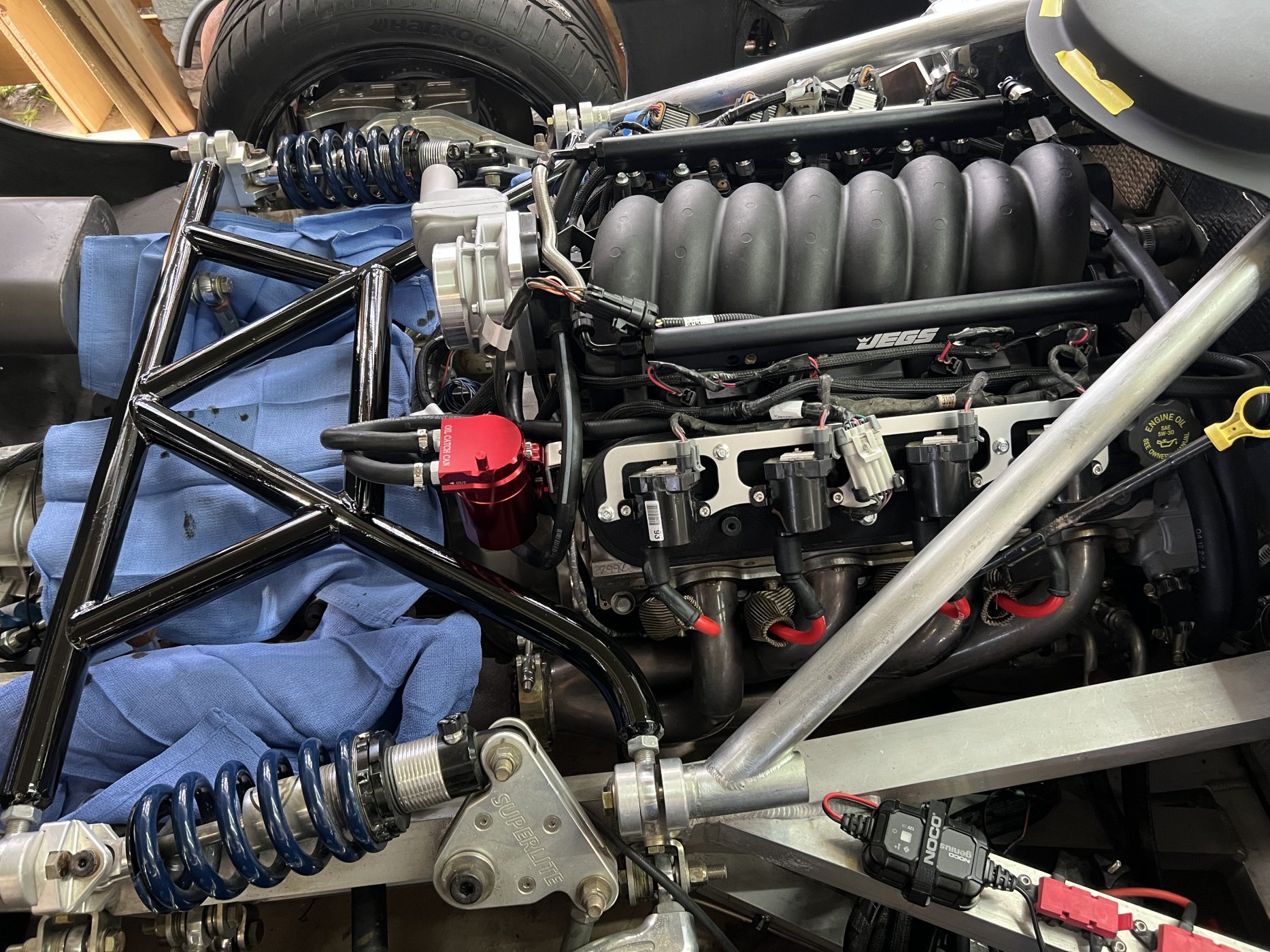

Been slowly knocking off tasks. Heads are back on, new coil brackets, rerouted the coolant lines to go into my expansion tank and basically act as an aerator, painted part of the supports black with Por15, need to do the side angle supports.
Added in a catch can, lots of oil in my intake even without having ran it much

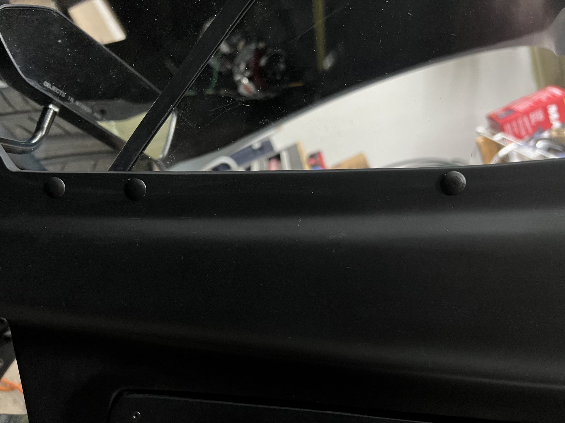

Added black hole covers for the screws where the windows go.

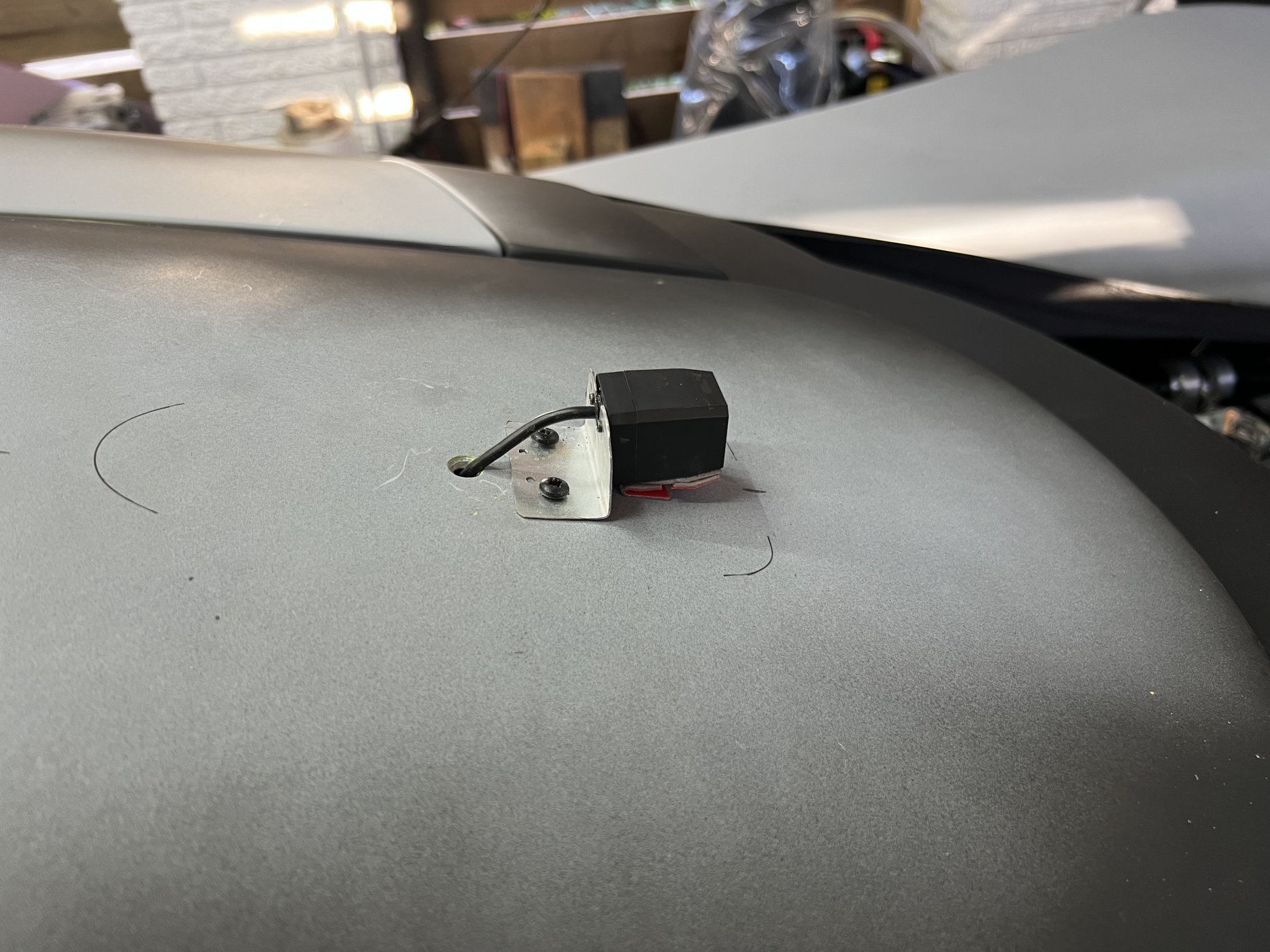

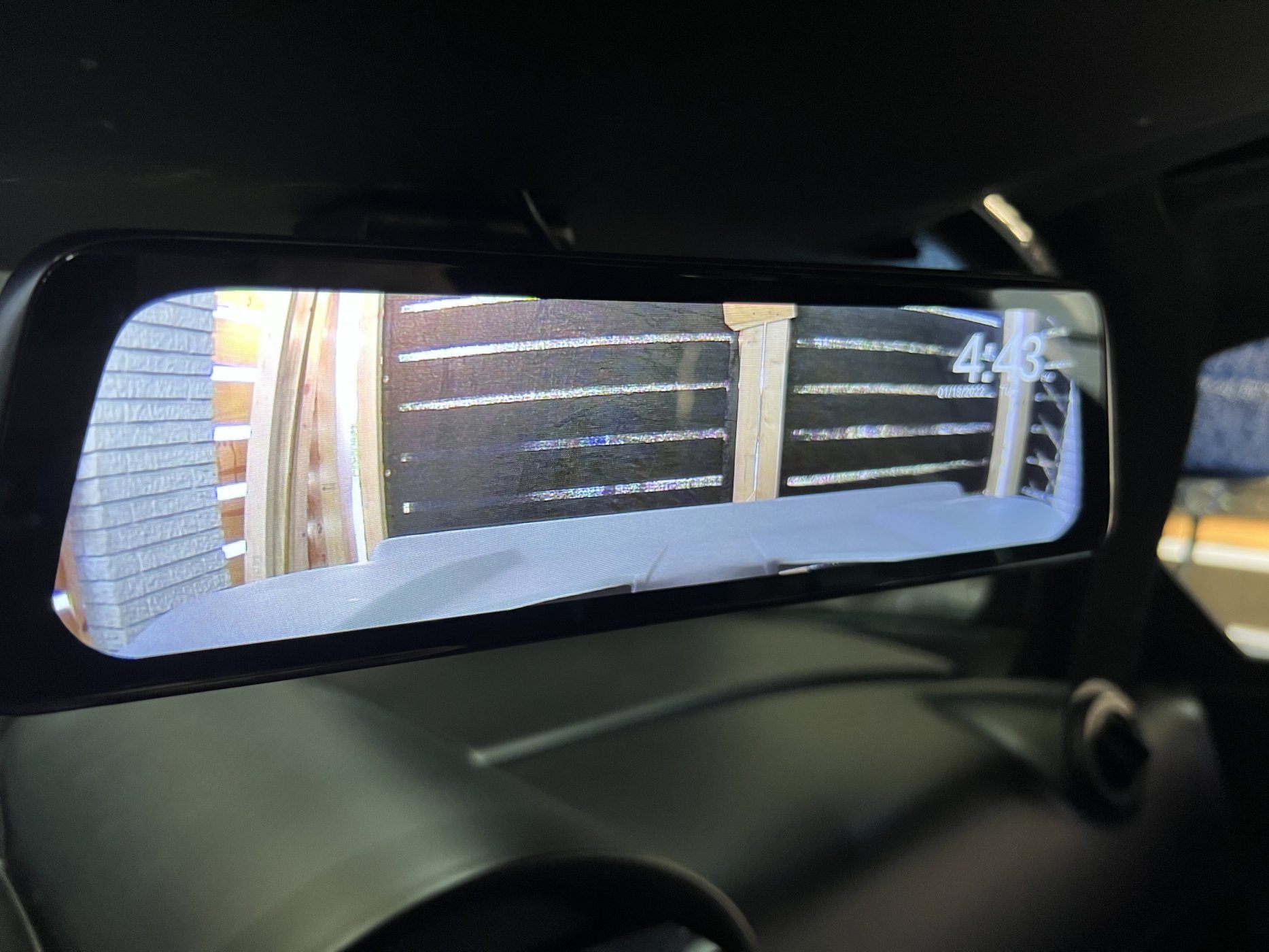

2. All the cameras and mirrors are much needed. I strongly suggest having a back up and rear view camera mounted up high.
