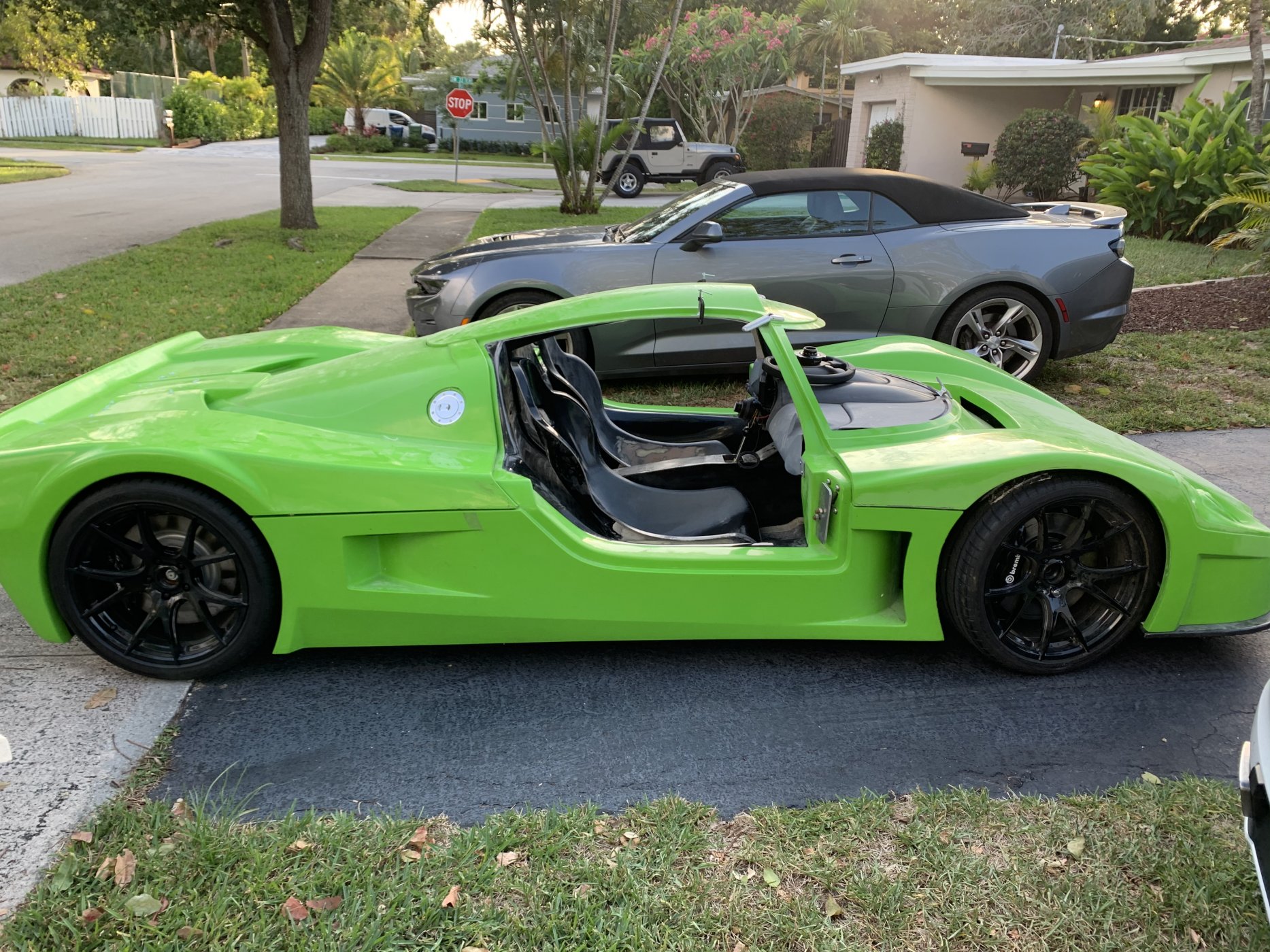

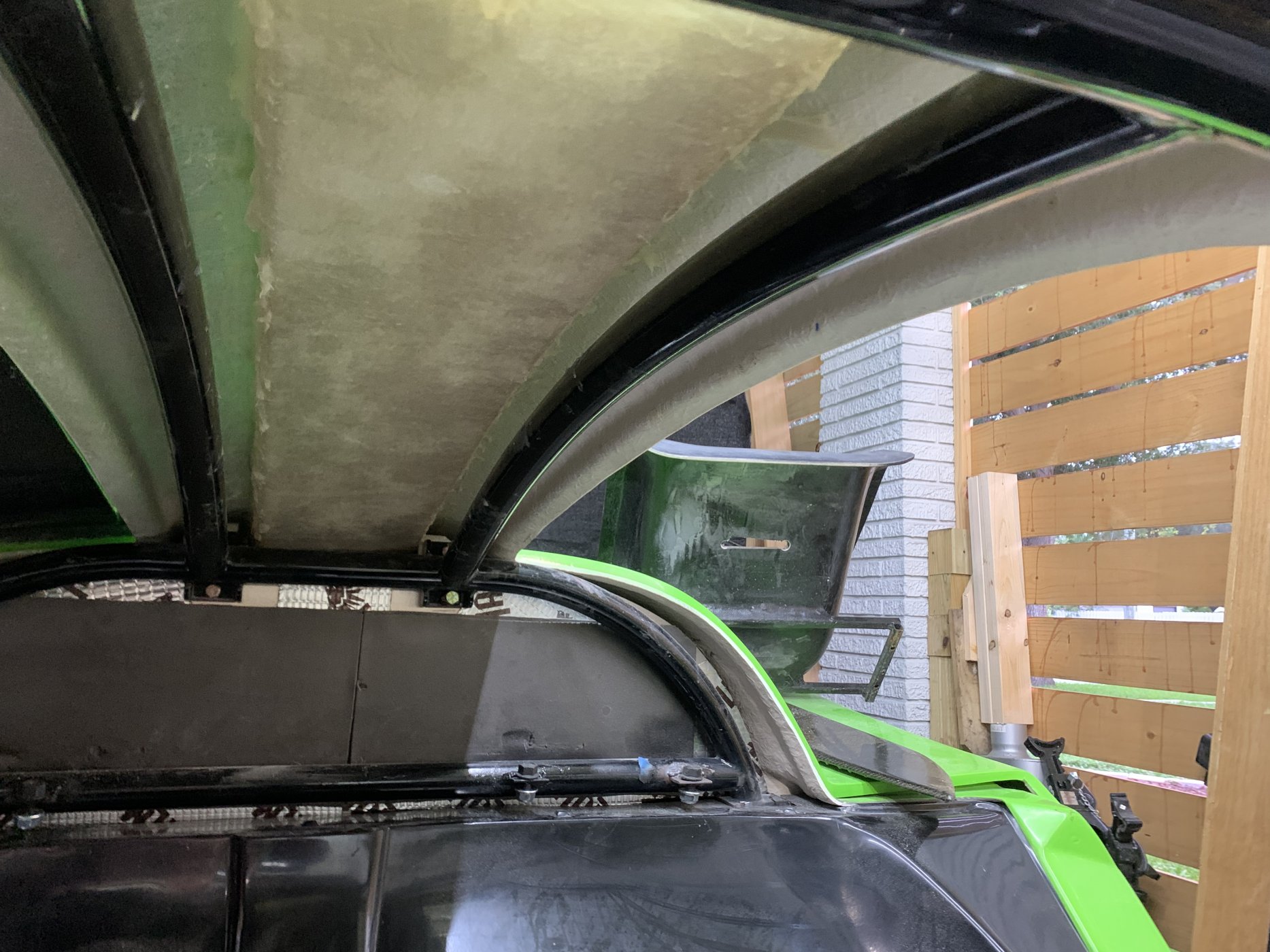

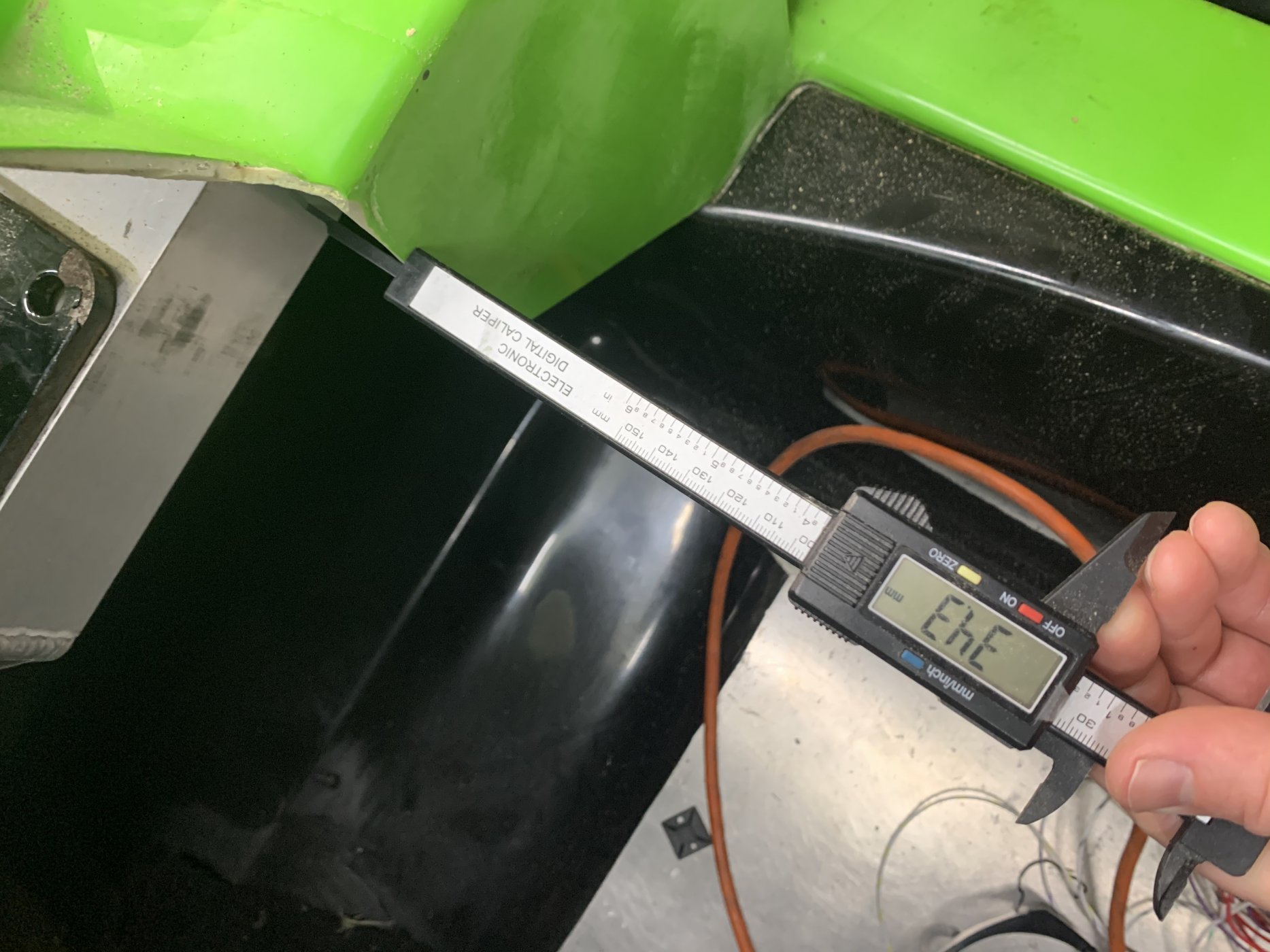

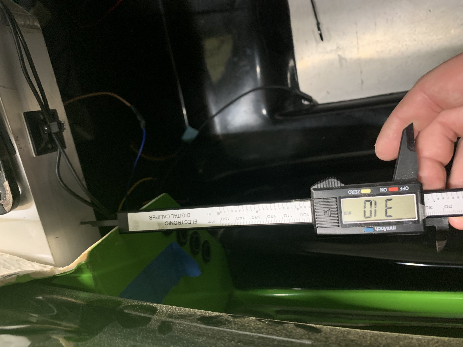

Body fitment continues to plague me. Can anyone with a proper fit body provide me with these dimensions? These are frame to spider, in mm.
As you can see from the last few pictures my front wheel gaps are way off, the front clam is too far aft, the rear clam shows the same. The whole structure needs to go forward. However to push the spider forward means the very front of the spider will hang over the chassis near the steering column about 1in, is this normal?
View attachment 114287View attachment 114288
View attachment 114289View attachment 114290
Yes, that’s a pretty normal gap.. set the main body to the chassis and slide it backward as much as possible.

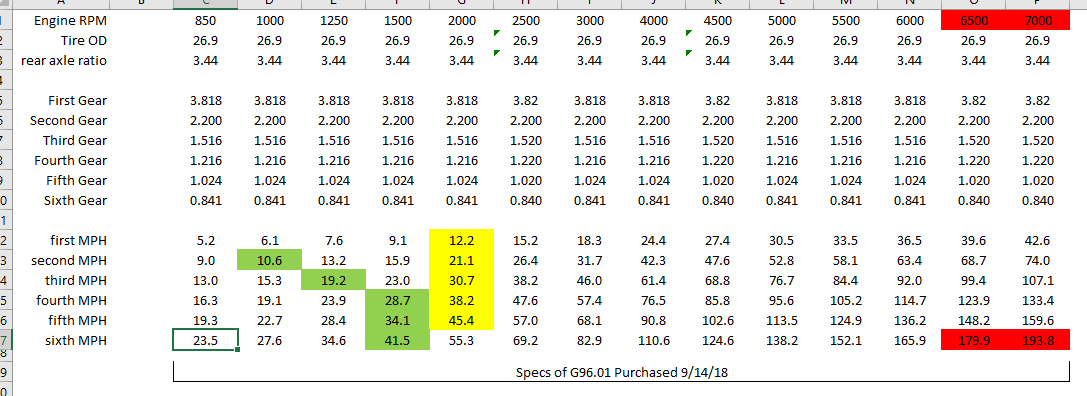

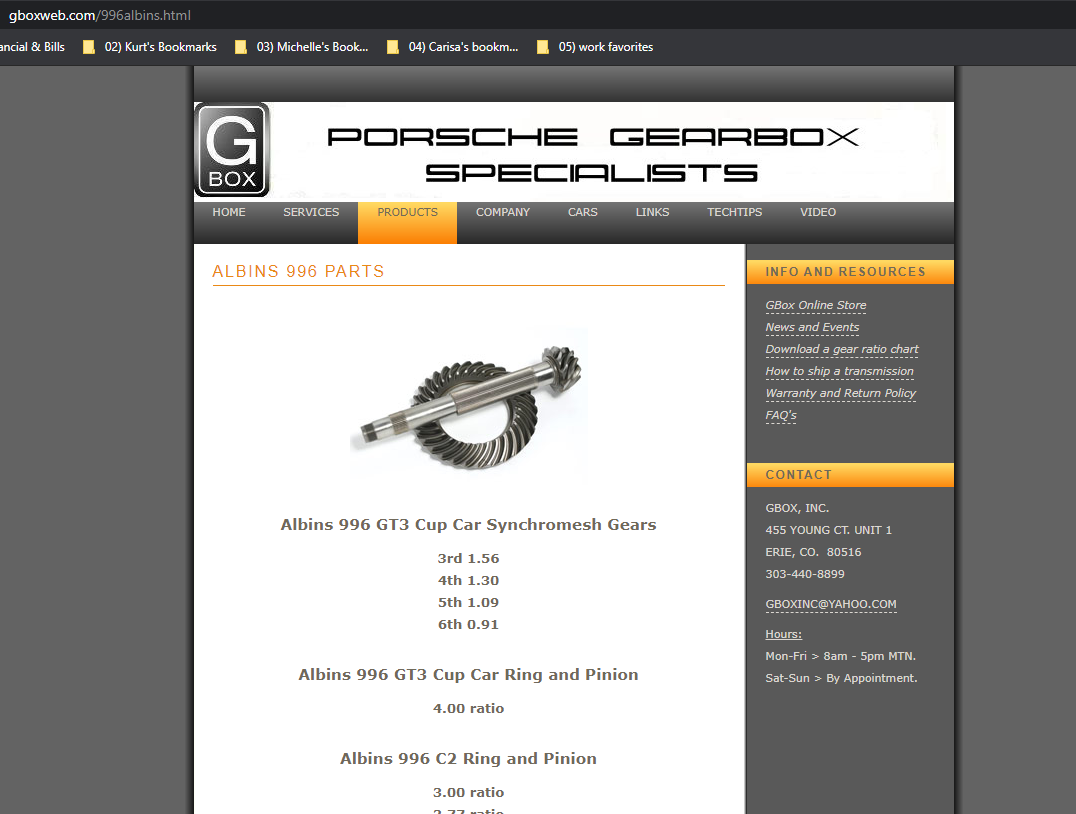

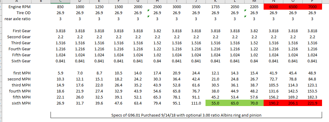

I have not seen a drop gear setup for the G96 but Albins makes a replacement ring gear in a 3.00 ratio that looks very appealing. Below is a chart I put together of the stock ratio and the 3.00 setup.
Theoretical top speed goes from 190 at 7,000 RPM to 220!
On my test drive I also found first to be best for parking lots, city streets, or pulling UP my steep driveway and not much else. My motor has plenty of low end torque to take off in second, even third if I feather the clutch just right.

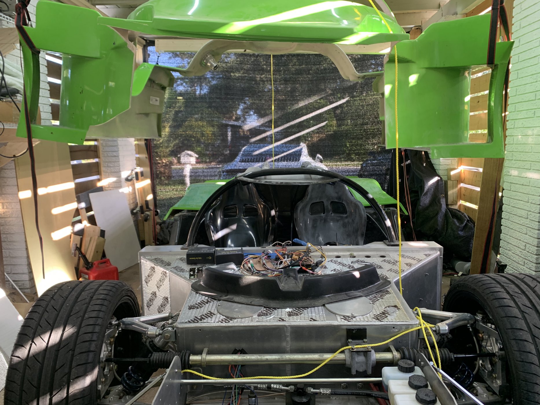

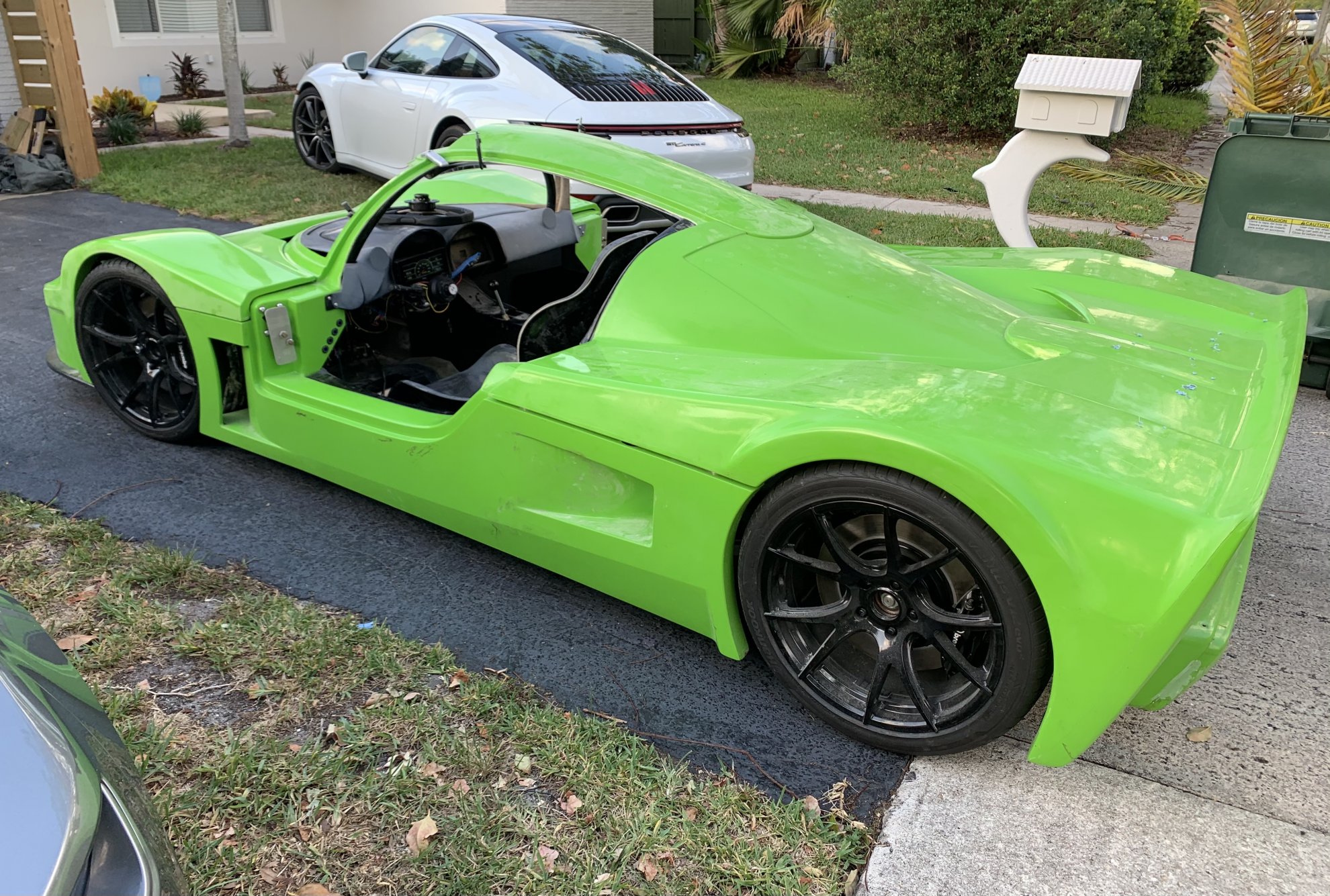

Was able to raise the body today. This should speed the build up quite a bit I hope. Still delayed because I’ll be waiting on the lotus tailight. Otherwise I think I now have everything to complete the build.

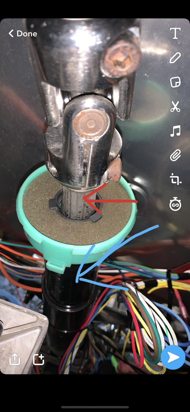

Does anyone have issues with the olds Column having some slack between these two points? There is a D shaped rod that slides into the column that just doesn’t quite have the tolerances it should to not have any play in it. The rest of the joints once tightened seem fine.

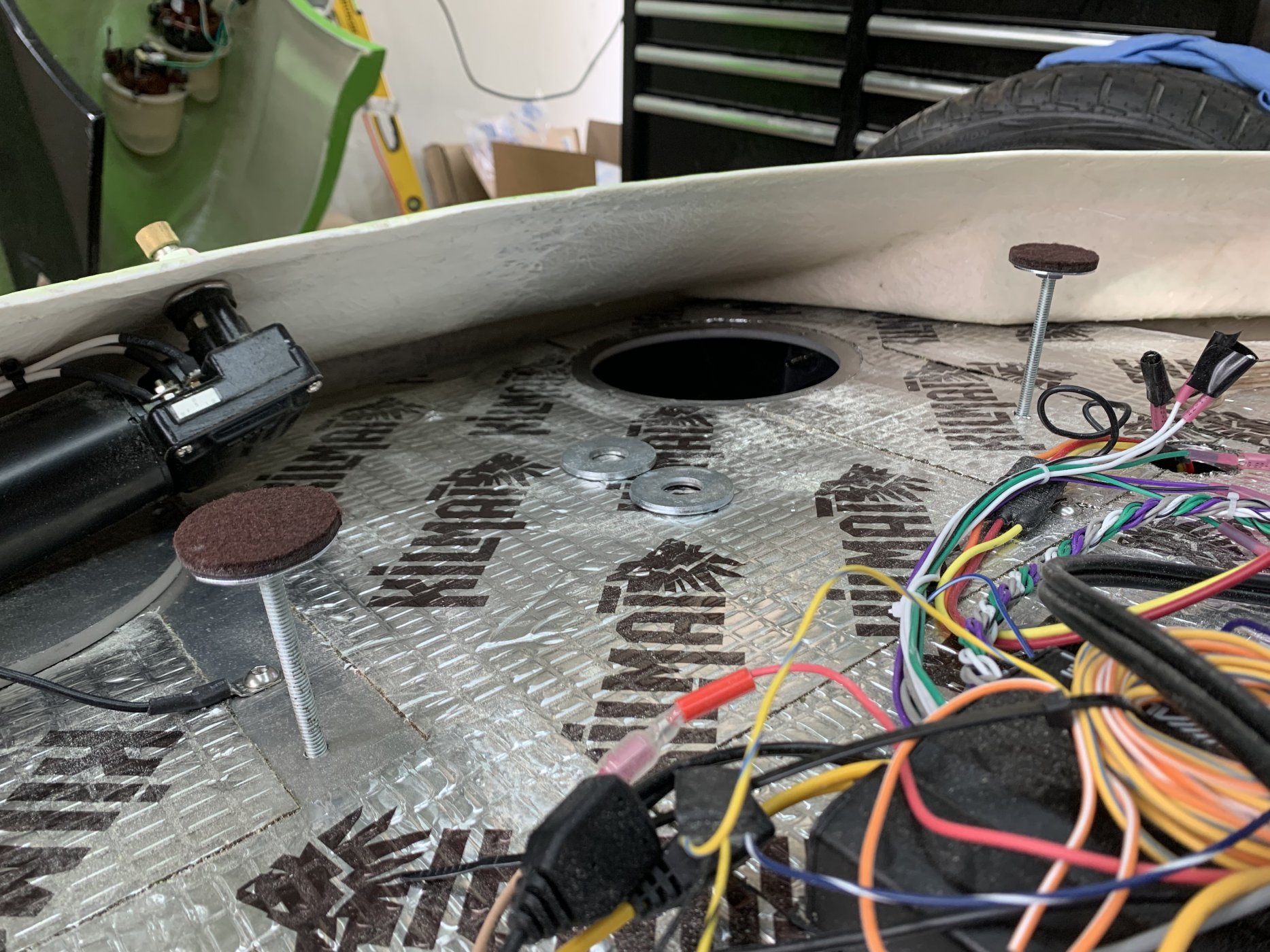

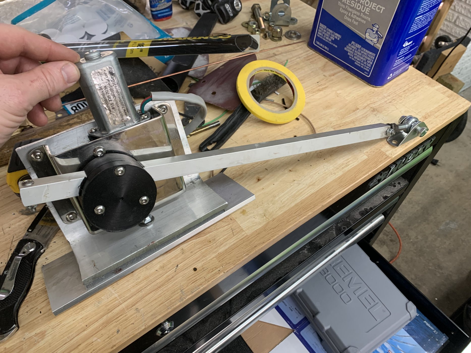

Stole this idea from someone, can’t remember who. 1/4-20 rod with fasteners on the end and felt pads. These keep the dash really tight and I can unscrew if I need to. I’ll more than likely use velcro on the leading edge like fran suggested.

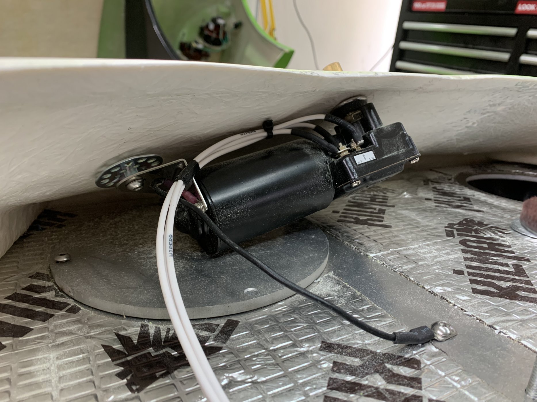

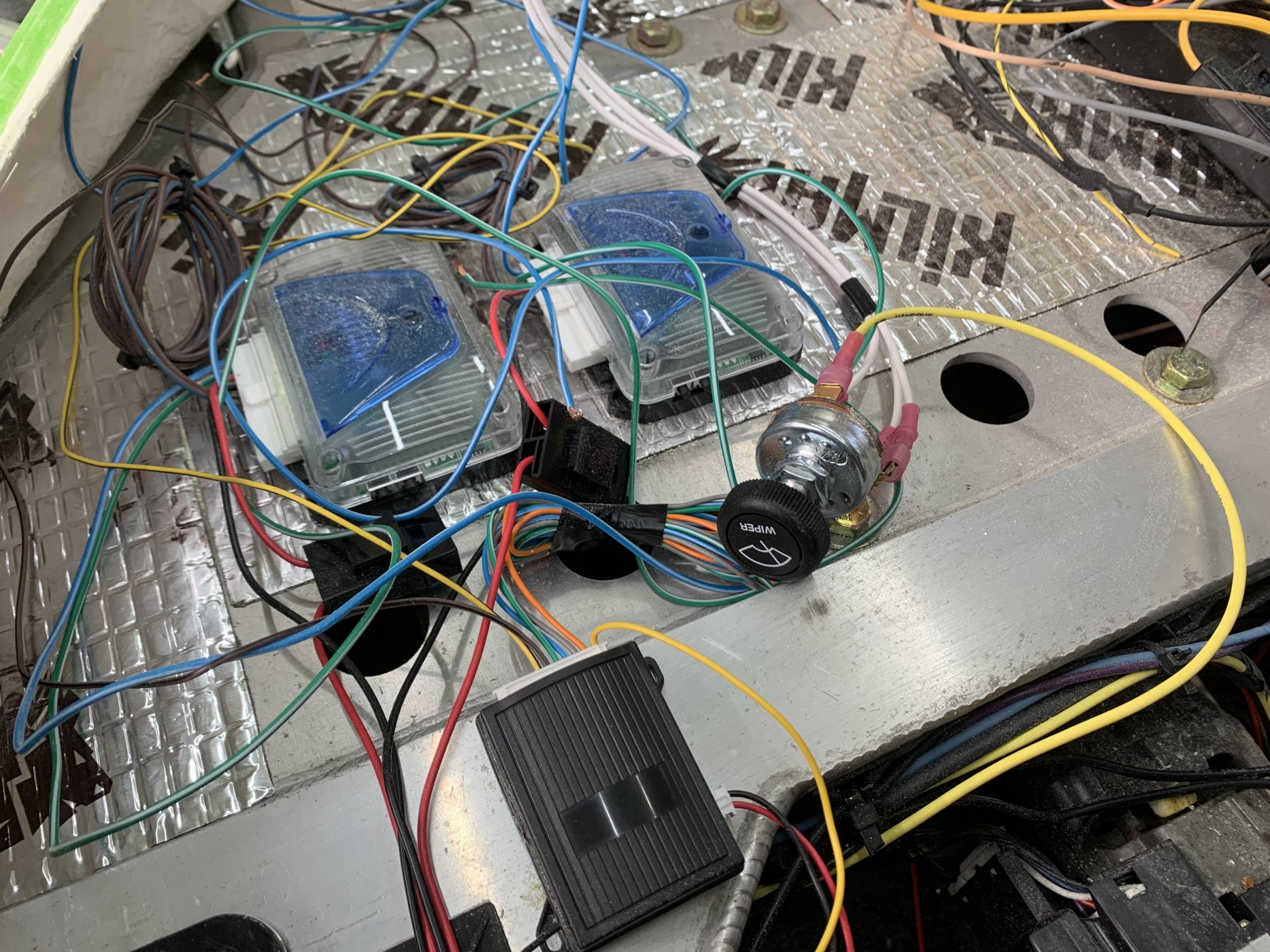

I had forgotten about the windshield wiper motor, hole is drilled and the few washers in the previous photo will space it out enough for the shaft to not be poking out as much. 3 wires fast low and park. I took off the GM column wiper arm and I’ll just use a simple turn knob wiper control. Works flawlessly.
The two autoloc motor controllers are mounted and partially wired. It is wired to a remote controller, the black one in the foreground, also autoloc. This setup works well and is super easy to wire. Since I am using the door actuators as locks this will be to constant power.

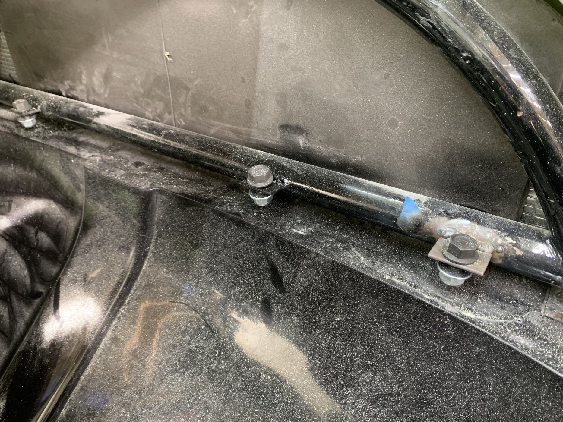

I created way more work for myself by welding these brackets on for the harness mounts. Totally forgot I could just wrap around the bar. I’ll be grinding these off and going with the wrap method. It will be a much cleaner install that way.
My lower harness mounts are ugly, but they’ll be under the seat so you’ll never see them. 1/8in steel with 1/2 bolts with larger fender washers.

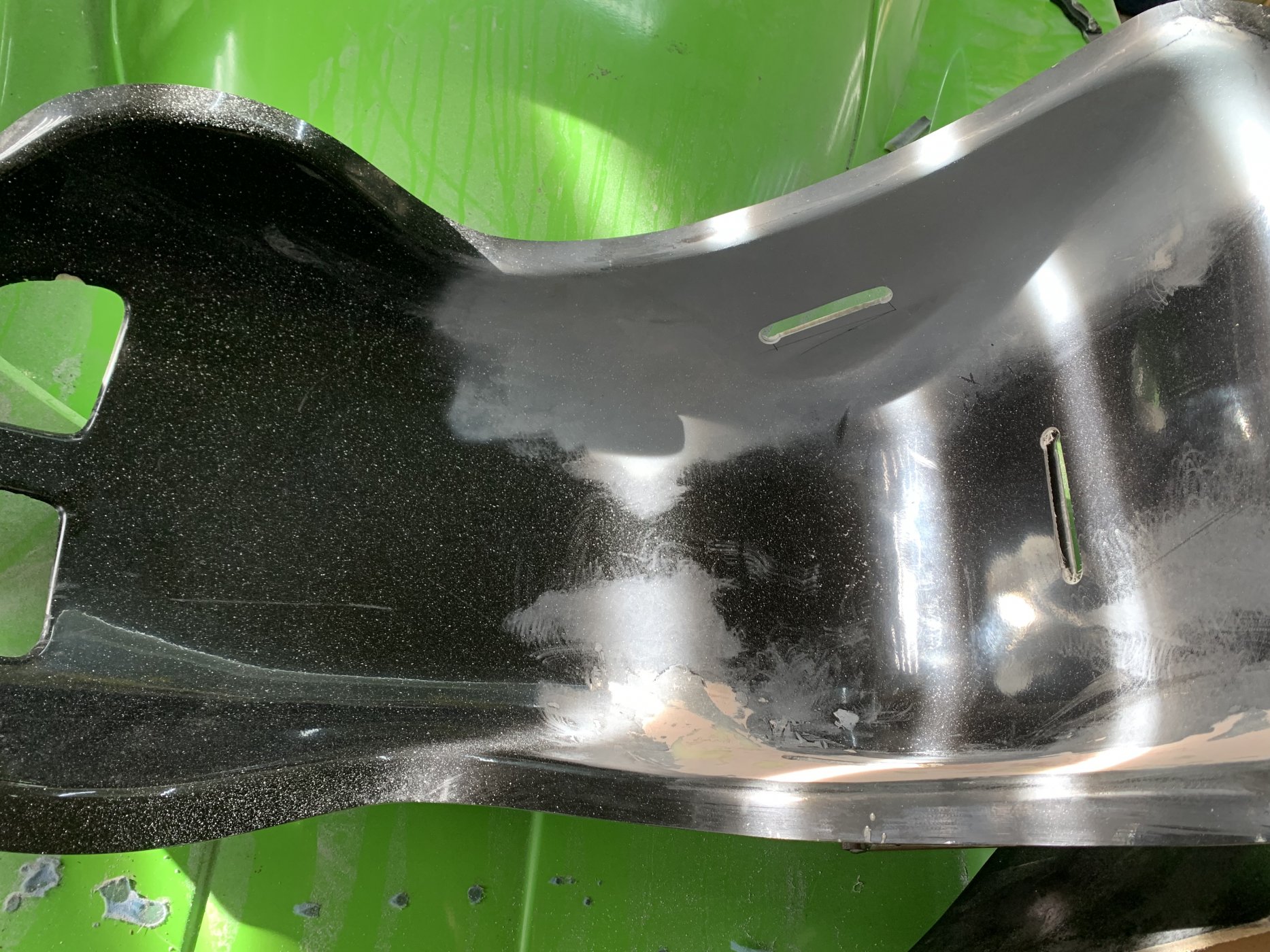

Progress on the seats have stalled, so much work. I finally cut out the holes for the harness. I will have to add in filler on the bottom cut out since the seat was made from two halves. These will need a lot of refinement before I can carbon skin them.

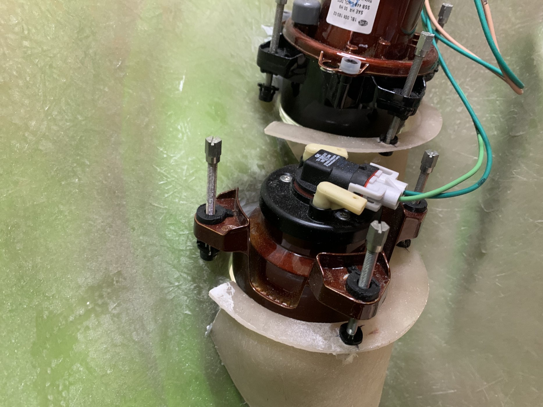

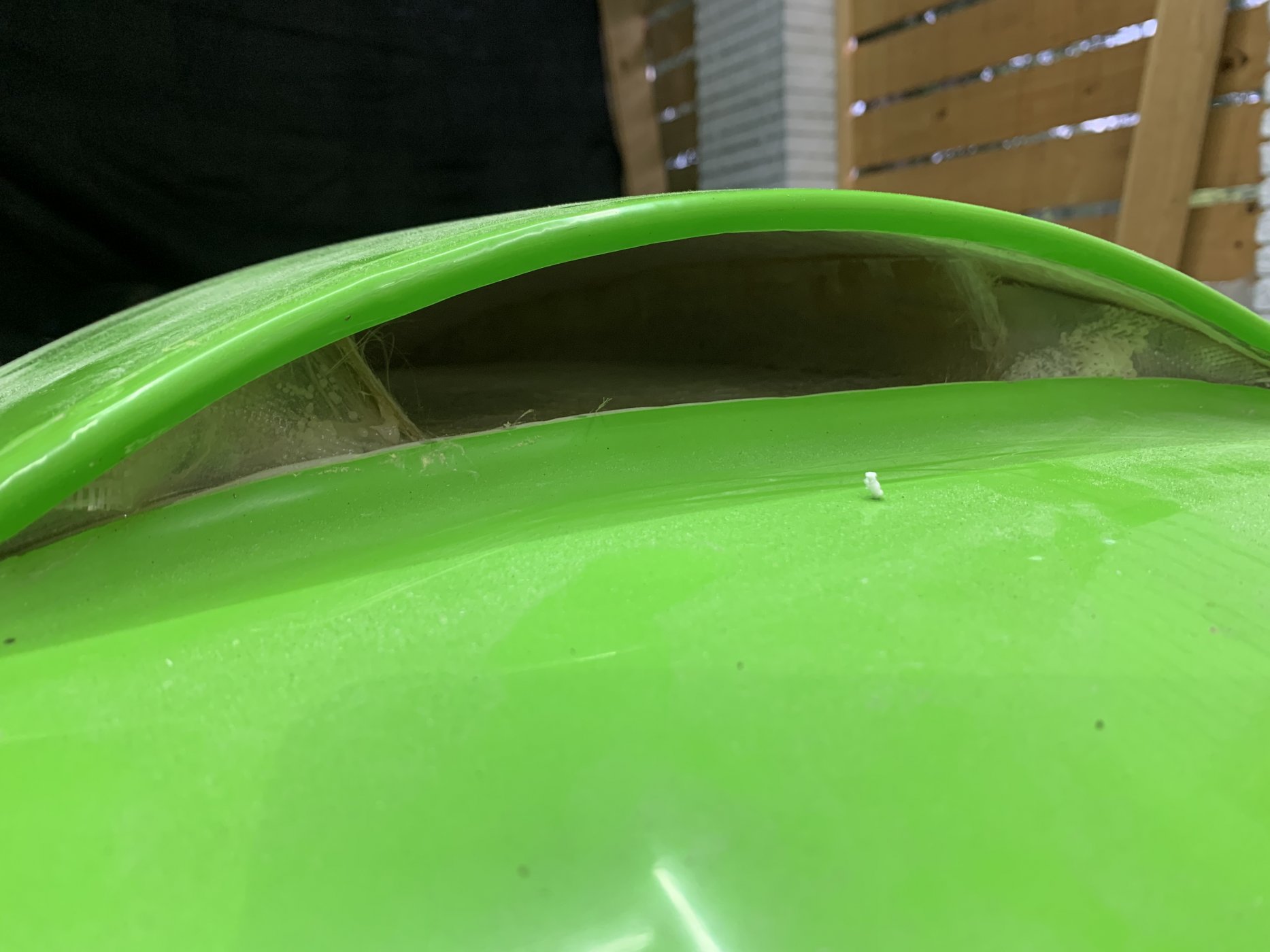

Top hole mounts on the headlights are an issue, I’ll have to make some fiberglass brackets to hold those. I’ve been procrastinating on this.

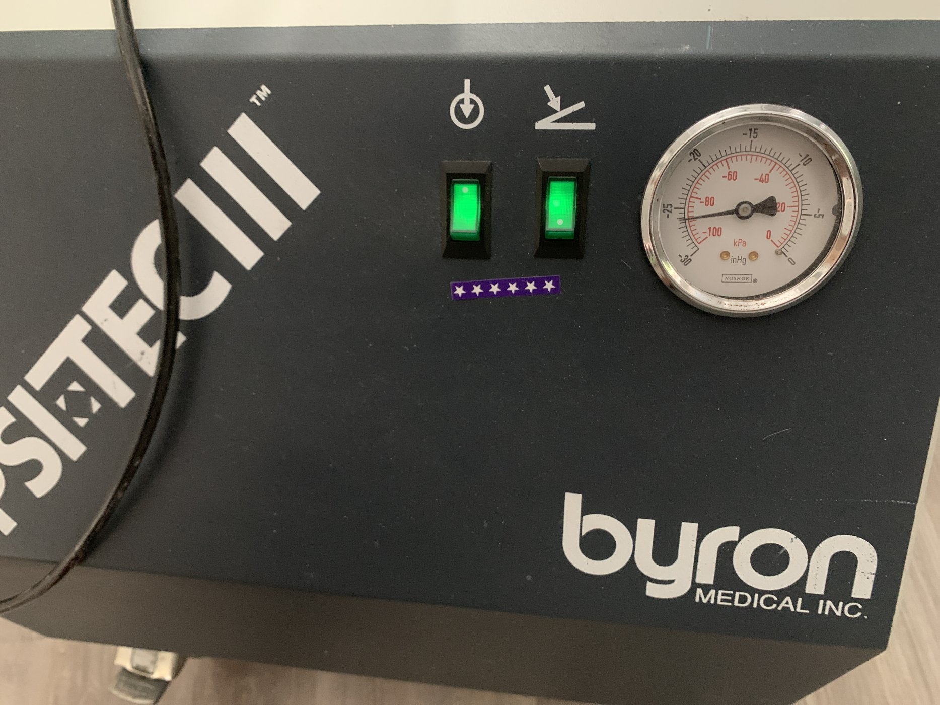

I have a big vacuum pump that we use for liposuction, probably going to try my hand at vacuum forming the center consoles and side skirts and then last vacuum the carbon on the seats. I don’t expect it to go well the first time!

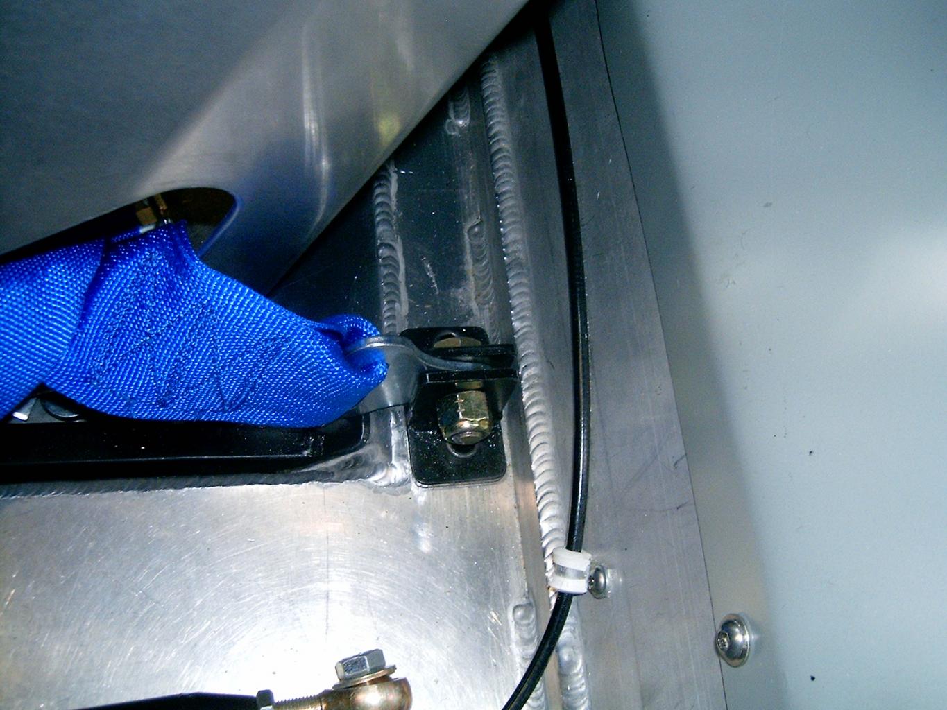

Here's my seat belt mounts, They are 1/8" 4140. Tig welded on all four sides, The flat floor mount is attached with two 3/8 grade 8 cap screws with large diameter thick washers and nylocks underneath. The through-bolt is 7/16 inch grade 8 with nylock nuts. As you can see they secure the belt tab in double shear and the lever length is held to the minimum to reduce the mechanical lever forces applied to the vertical tabs (centerline of through-bolt to the length of tab to base).
You can duplicate this to some extent by using two 90 degree mounts back to back with a through bolt containing the seatbelt tab in the middle. I am afraid your single mount bolt will rotate under load and twist and flatten the seatbelt tab. This in turn will be more prone to tear the belt material in the tab.

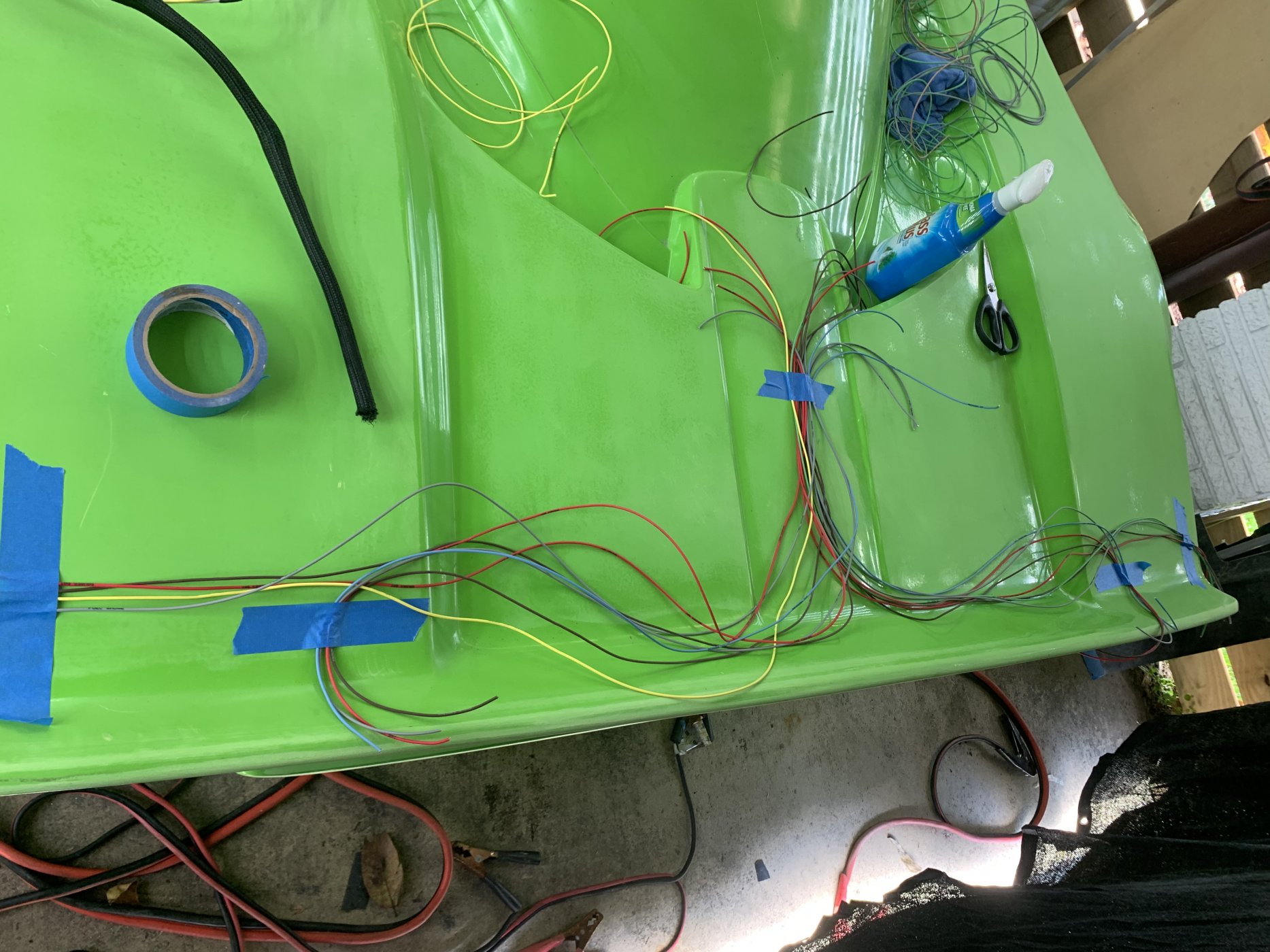

Been awhile since an update. I’ve been gearing up to try and get a few more things done before shipping to Allan. I elected to go with the lotus taillights, finished up the wiring today. Also getting started on skinning the center console with carbon later. A few last little things I want to get done so Allan isn’t wasting time with petty stuff and then hopefully off to him by end of the week.

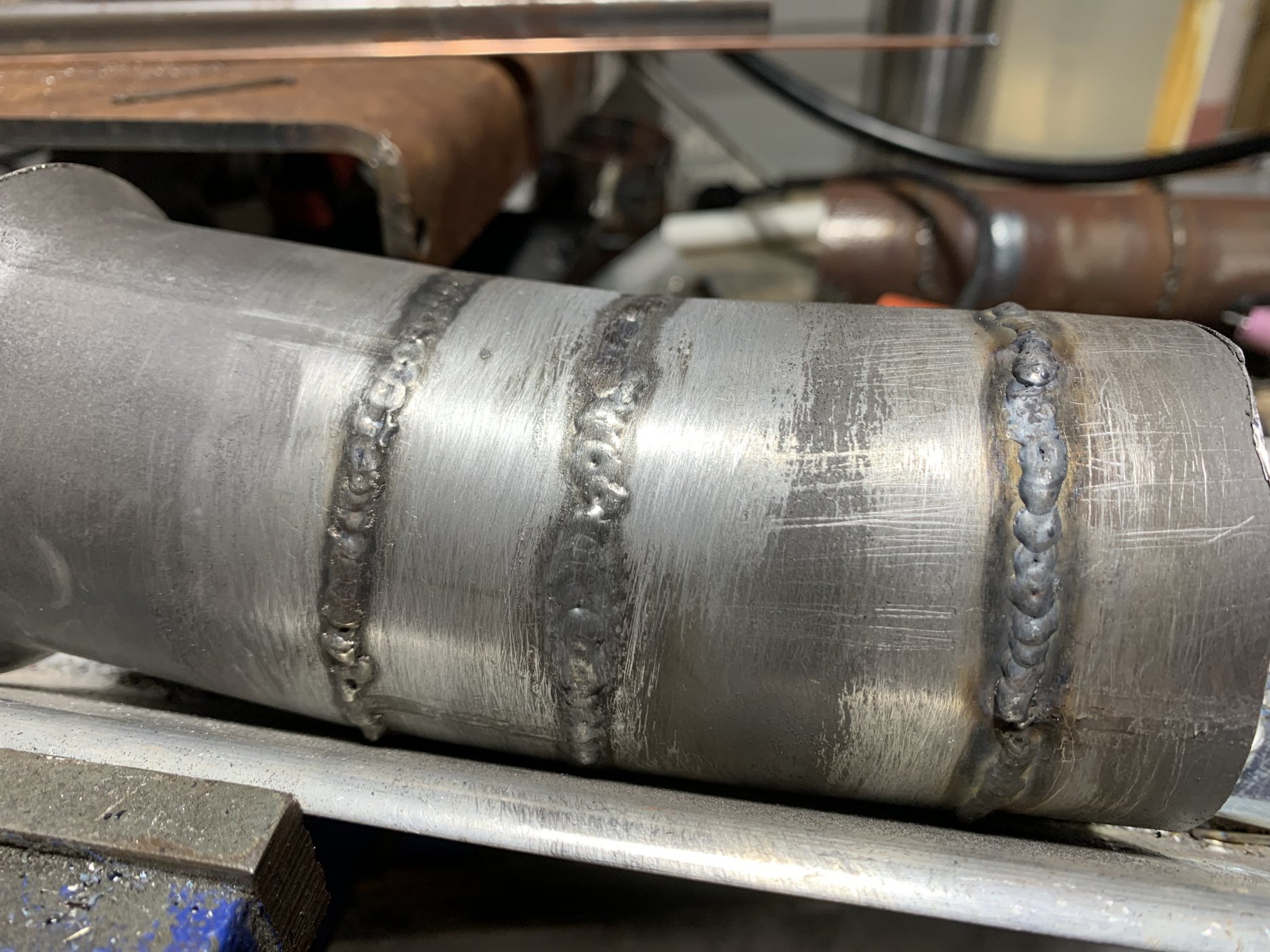

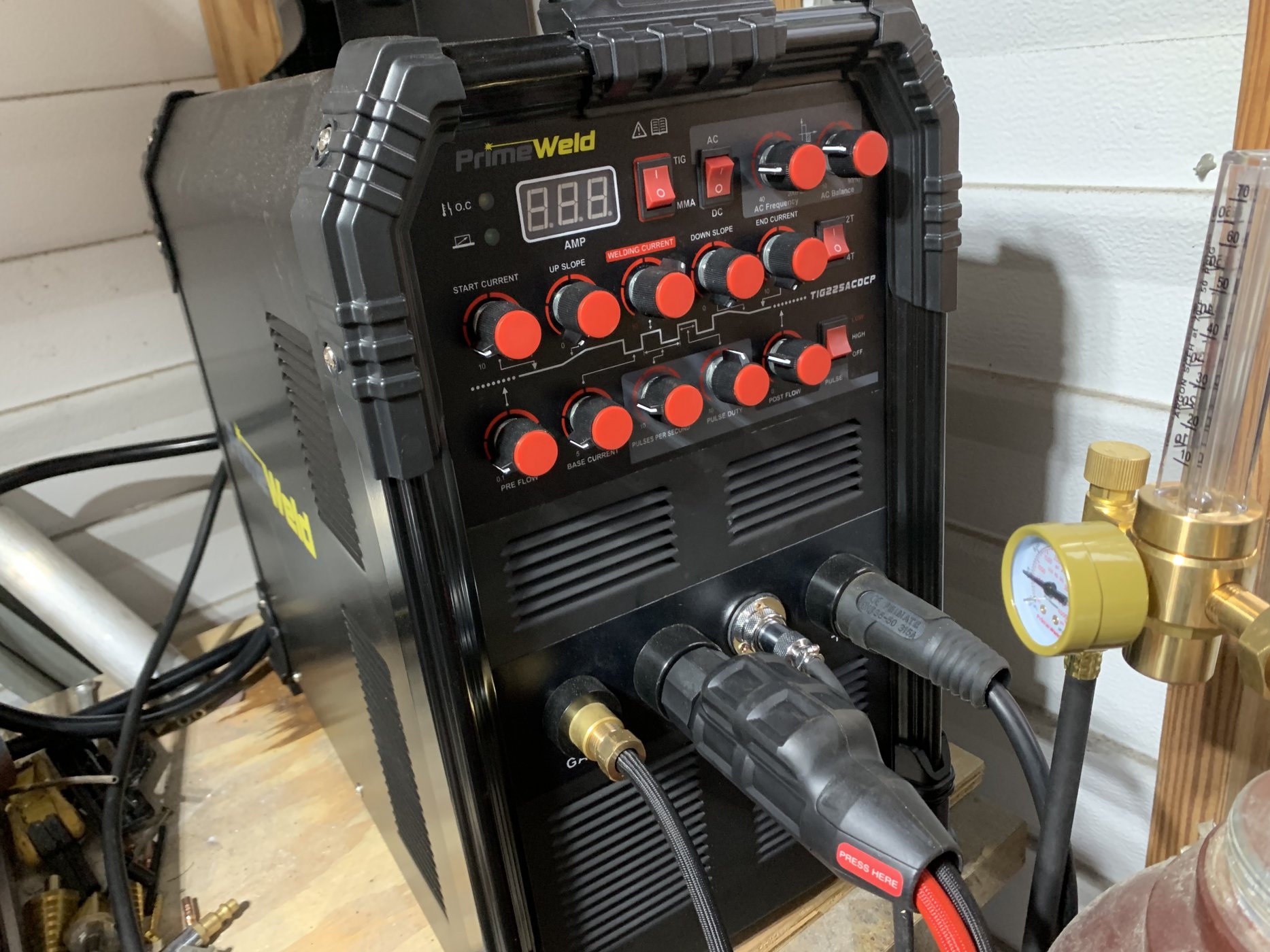

Well, just a few days until 1 year mark with the car. Hoping to have it back from allen here in awhile. In the mean time I’ve been practicing my tig welds. Really rough but slowly getting the hang of it. Having a better machine makes for improvement.

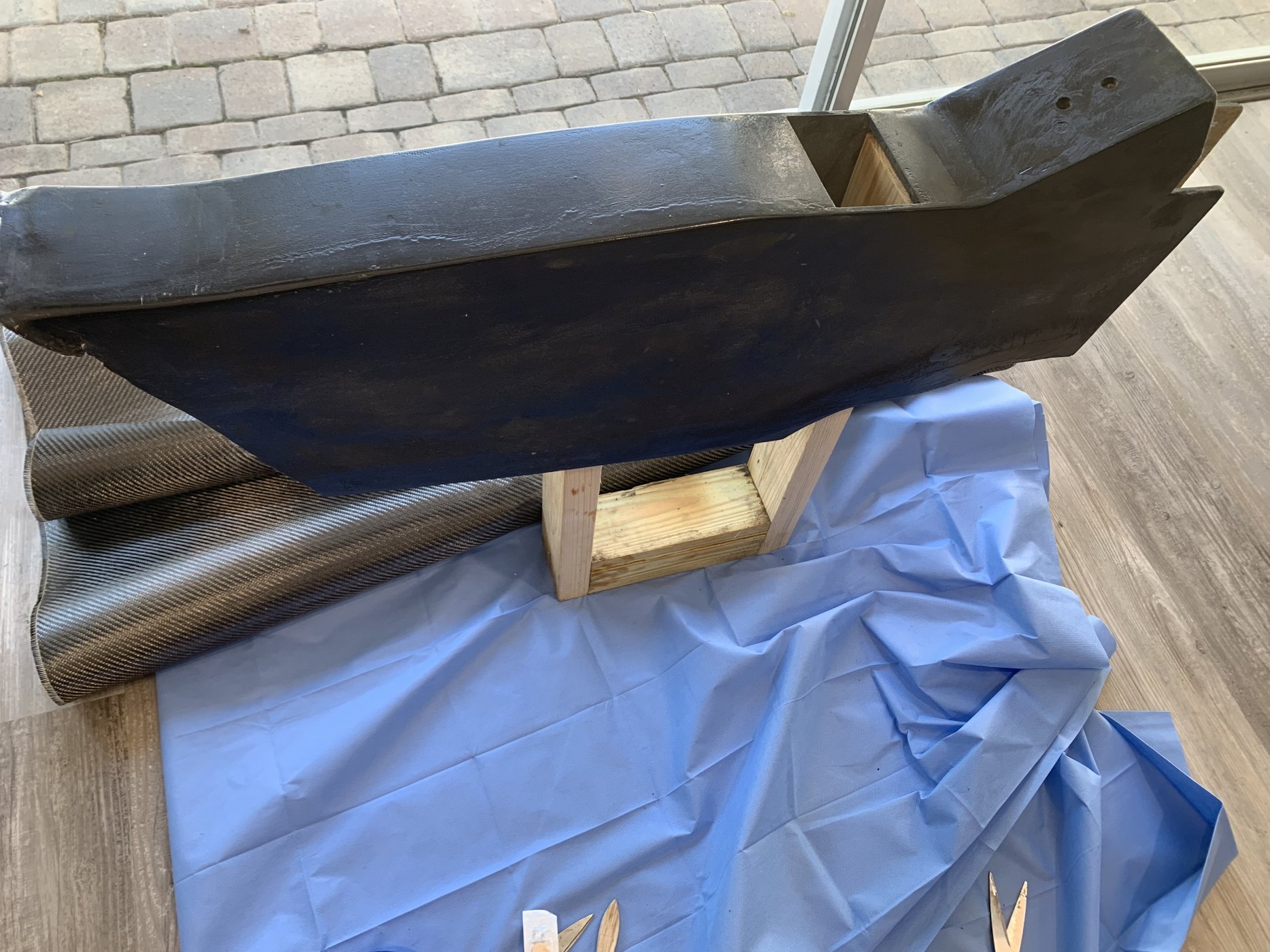

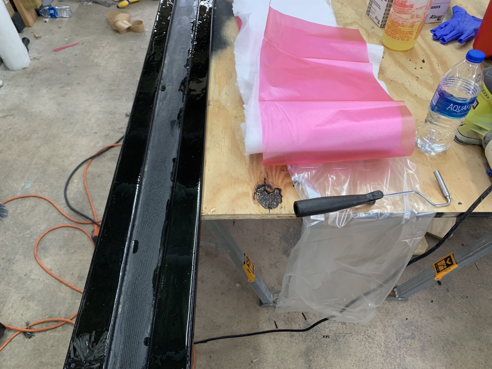

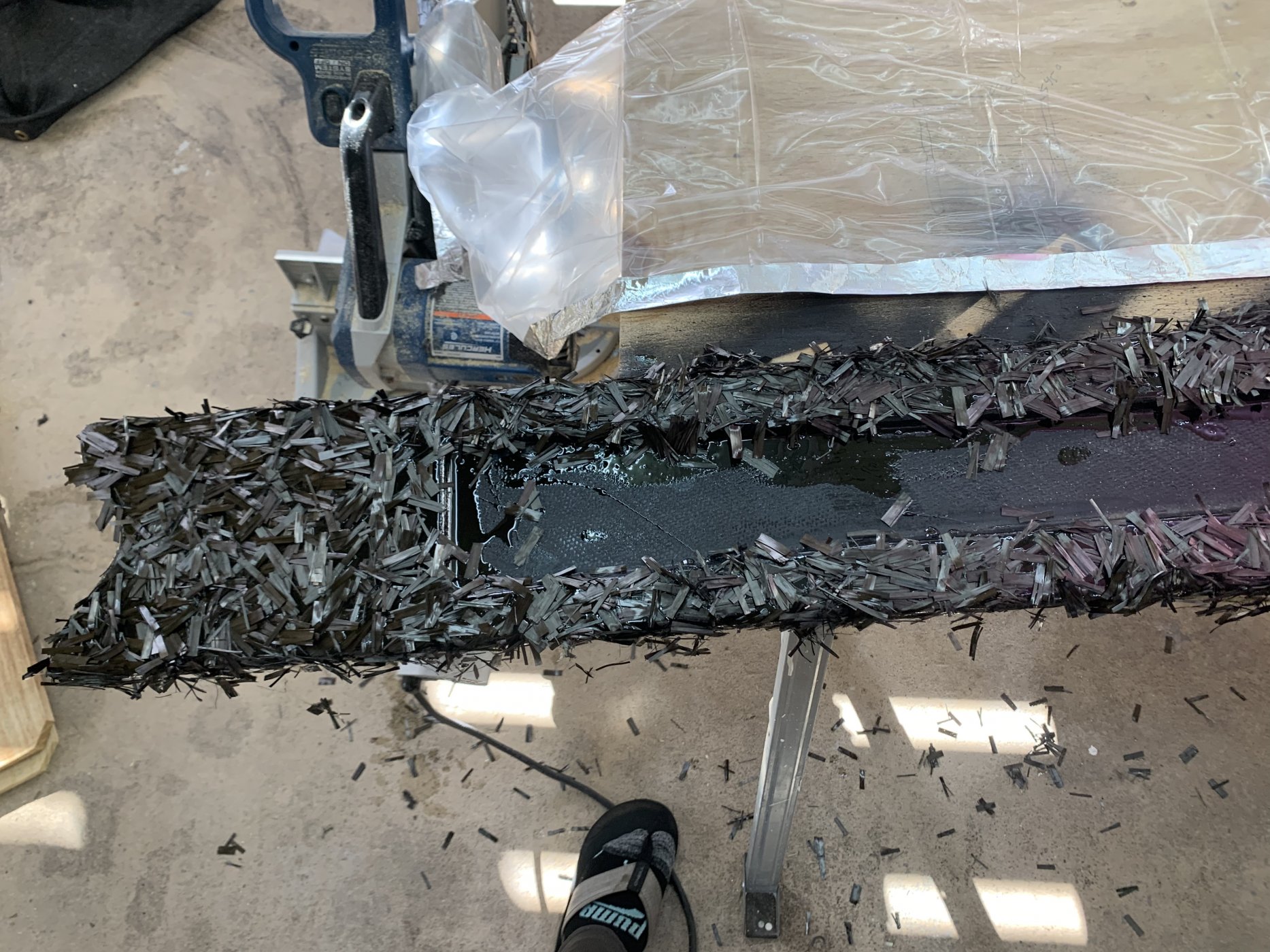

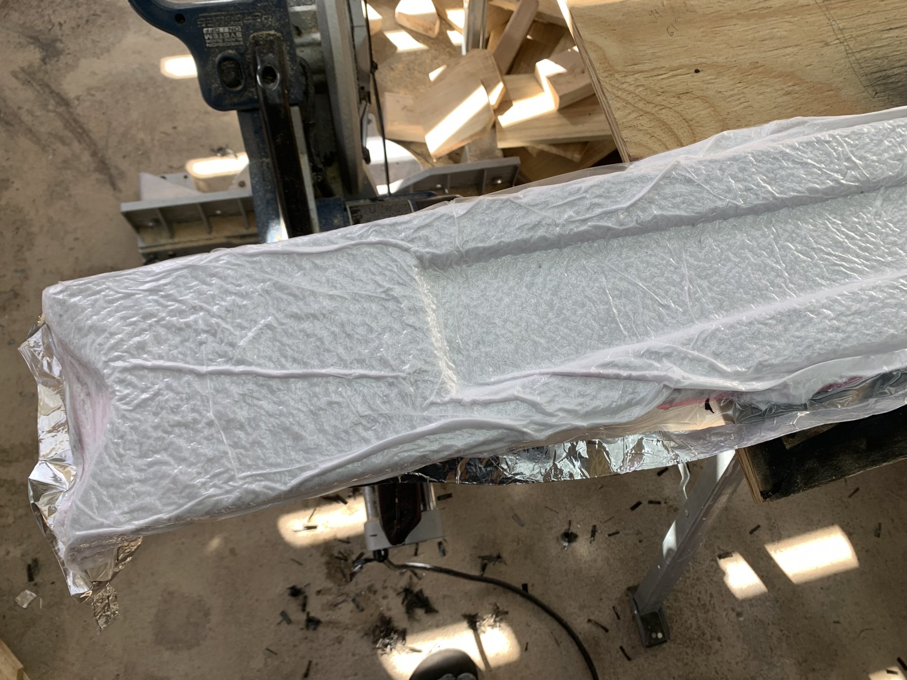

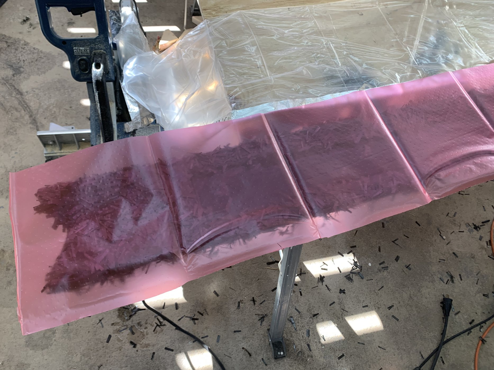

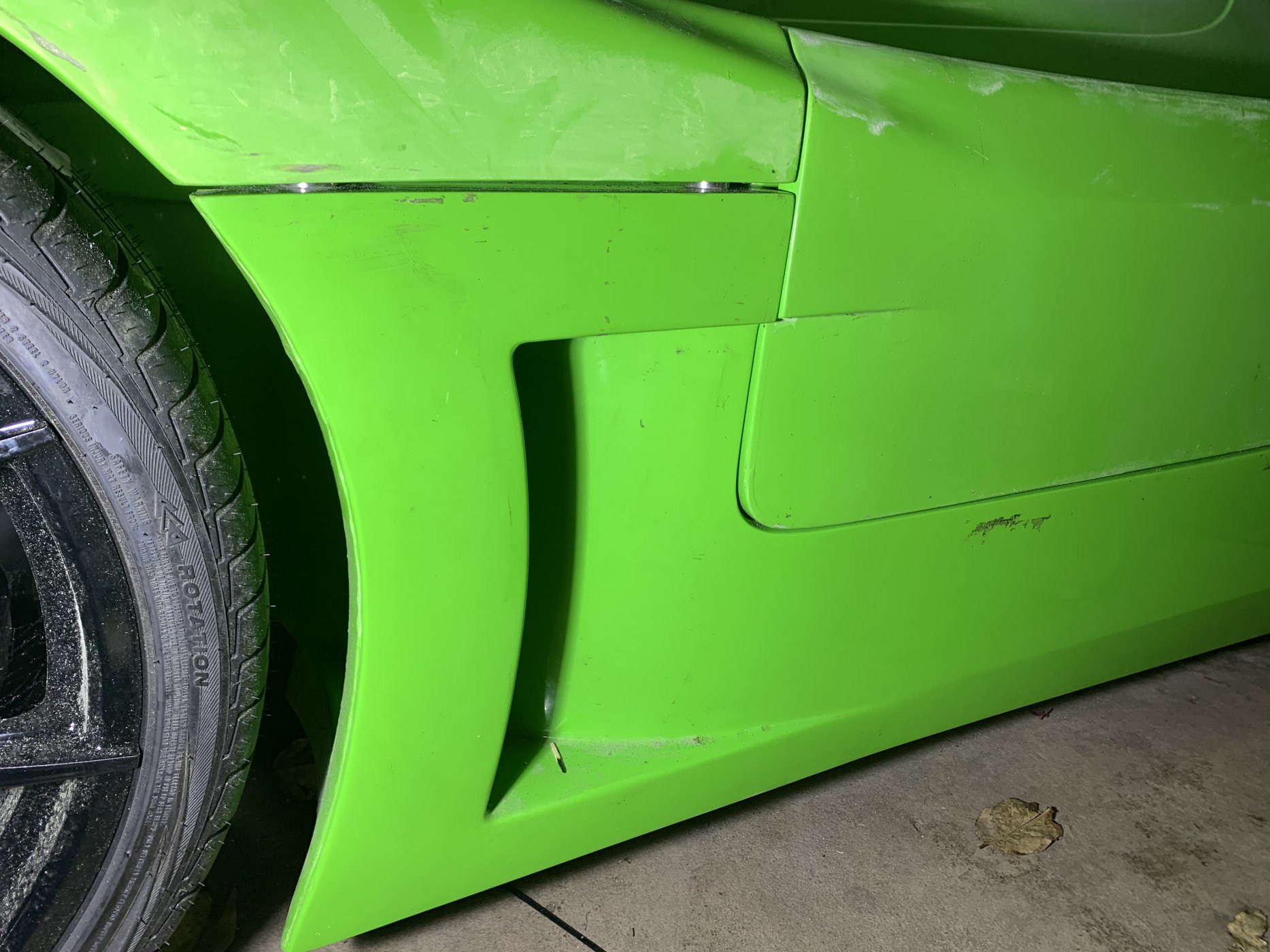

So there are a couple of items I didn’t send to Allen, one being the side skirts. I wanted to try my hand at carbon forge, essentially cut up 1in carbon pieces. Here’s the process, basically clear epoxy over the unsplit skirt. Lay your carbon, it will be very messy and not flat. It might even “hair up” on you. Just get the best coverage you can at first. Then lay up your peel ply, then felt, then put it in a bag. My bag is just 2mil poly from home depot sealed with aluminum tape. The key is my suction, it’s a spare liposuction machine I have. They are incredibly powerful. I’ll let this run for the next 5 hours or so and see how it looks.
I’m fully expecting for there to be some bare spots I need to put more carbon on. And it will need to be sanded and epoxied again many times before finally clear coating.
Kyle
GT40s Sponsor

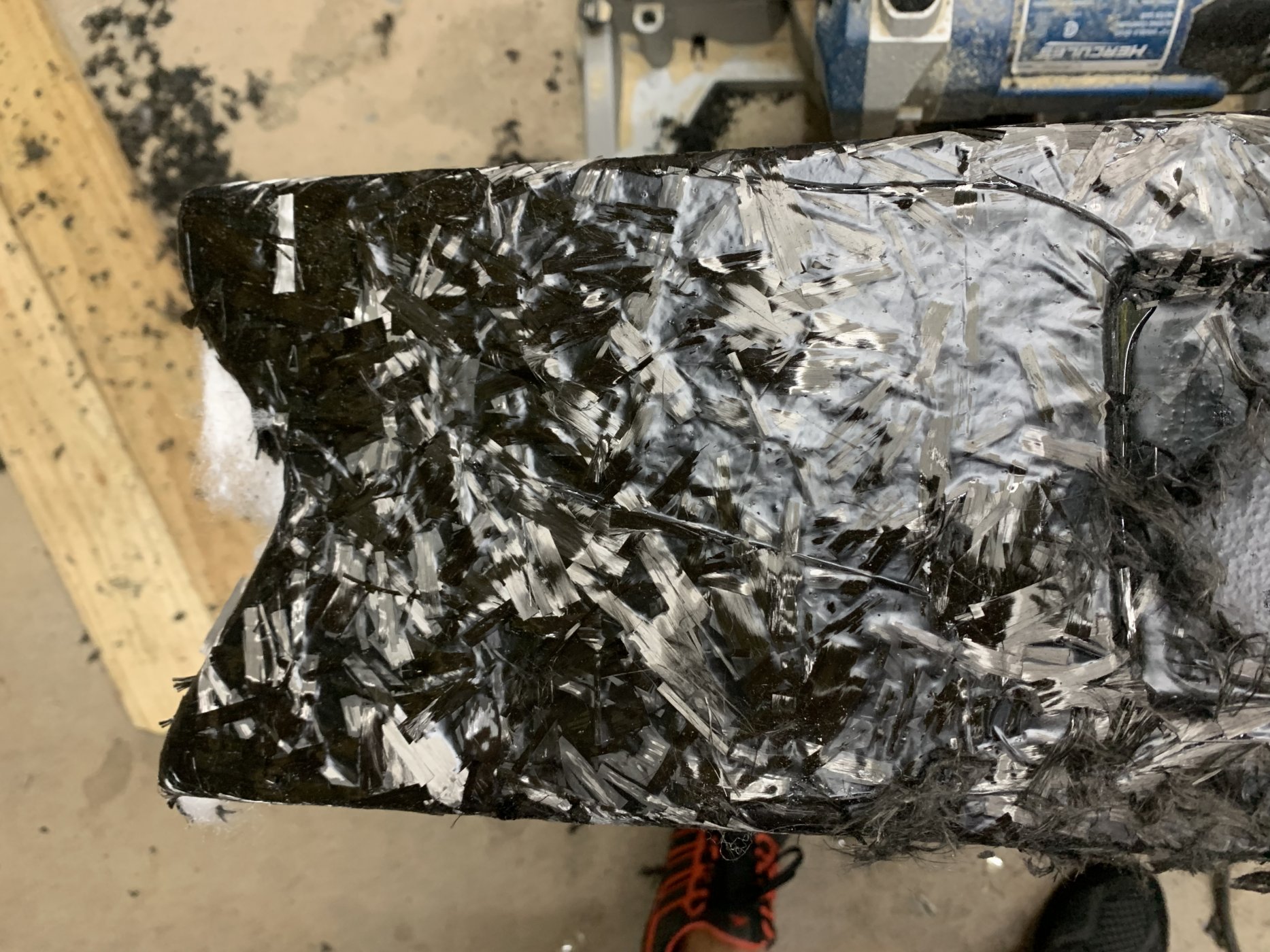

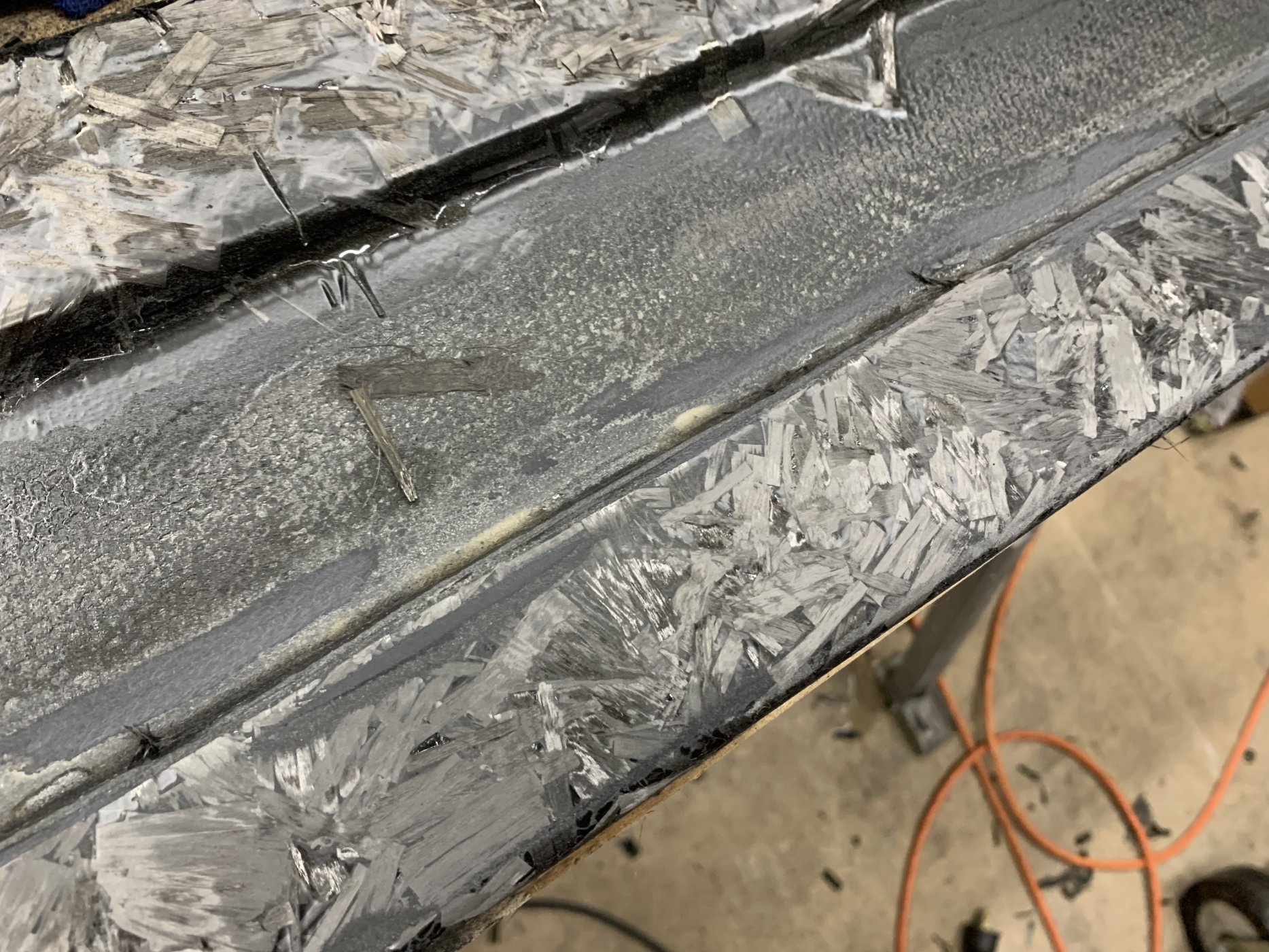

These are the results after tearing the peel ply. Very rough but that’s expected, especially when you lay the pieces down in uneven layers. I expect to do this about 3-4 more times. I think the key for the second round will be putting more epoxy over the carbon pieces after laying them down. Here are a few pics in various stages, right after pulling peel ply, sanding and after sanding.
