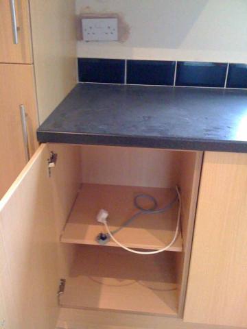

I'm now two and a half years into a six month house build.
Below is just an example of the incompetence I am having to deal with!

Simon, the two plugs are for integrated appliances? and should therefore have either an unswitched socket behind them and a fused switch above the work surface or a switched socket in an adjacent unit.If one guy is doing the whole job you are employing one idiot, if you have seperate electrican, kitchen-fitter,designer etc you have lots DMcG

If you need an electrician that does good work. I can put you intouch with the guy that did my extension. As David says, should be a switched fused unit at the worksurface level with just a standard sokcet underneath.
Come round and see mine if you need to take pictures to show the idiots, I mean proffessionals ;)
