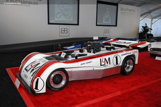

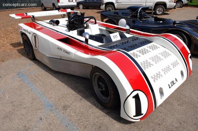

How about this one? I had LONG look at using a GTD modified chassis and my own bodywork to do one of these as I had a idea where to get one. Pretty simple concept and it could be done for about the same cost as most other ideas like this. The radiators are what nixed the project for me along with the fact that a SLC could be converted to a street car if I wanted to do that in the future.
A space frame car with simple alum pannel body work like this Lola could be done given the skills and work space. Chevy SB V8, Porsche GB, copy another kit suspension geometery. BAM! trackcar!
Another idea would be to rebody a Ulitma.
