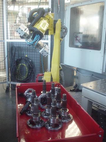

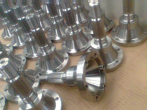

flatchat(Chris)
Corvette C5 wheel hub to 930 CV stub shaft -- from billet 4340 steel and heat treated or a modified C5 universal stub -- some 20 years ago for under $500.00 aud each -- feed back said too expensive, therefore ceased production
