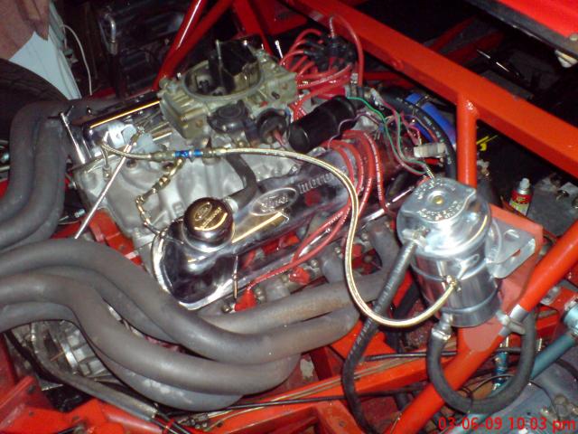

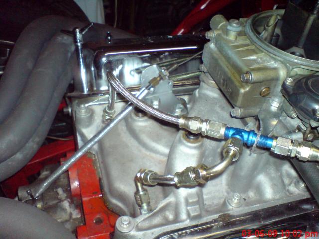

I feel I'm making good progress now, having replaced some hoses, I have now almost completed the cylinder head bleeds, (just need a couple of nuts for the bulkhead fitting) and replaced the old plastic header tank with an aluminium one.
Next Job, clip back all the pipes, run motor and check for leaks, then reinstall and seal bulkhead. Then finish off the seat belt installation and we're good to go.

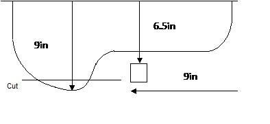

Sump
While I am at it, the sump is stock, and is the lowest part of the car, with a dent and scratches to prove it.
Is it possible / advisable to reduce the depth of the existing sump by 1" to 1.5" at the deepest point?

You can do want you are planning & cut of the bottom of the sump and match the oil pick-up pipe to it or buy an 8” deep Moroso sump & pick-up pipe from the likes of Summit or Real Steel

Sump is the easy one
regards

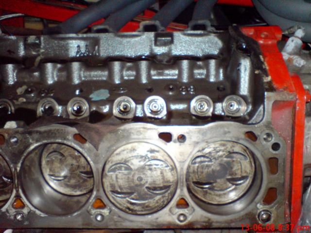

Guys, Andy, please can you answer this from a picture of the valley from the head change, boss or no boss? If no boss what do I do?
How green is my valley??:laugh:
Dave
Green for go!!>>>>>>>>>>>>>

Ok, I think that question is answered, my supplier says that the later block will only accept the ones with the spider installation kit, so the cheaper option is go. He just wanted the valley photo for confirmation.
thanks for your help Andy and Jac

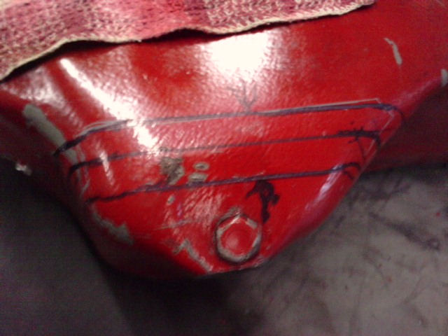

Guys,
engine is out and on a stand, I am cleaning everything up, and have an issue with the sump. This hangs down 1" below the chassis and is almost scraped through. Now I can repair that, but what I am thinking is to cut and shut the sump 1" to 1.25" to clear from grounding. I will also need to reposition the oil pickup to suit.
If I do this as shown, I will lose 1 litre capacity from the sump.
I could claw some of that loss back by extending side and lengthways a little. Is that necessary or am I ok with 1 litre less?
Would it be ok to chop the sump and then baffle it so that the smaller quantity of oil is better contained during braking and cornering?
What are your opinions?
Yes I know I'm a cheapskate, but I havent seen a suitable rear sump anyway, and would like to save my dosh for other stuff. :)
Dave

I just caught this thread and if you are asking if that block has bosses for the stock roller cam spider, It sure looks like it to me. In some later posts you are talking about a retro fit kit, you shouldn't need one, just the stock stuff. It looks like someone has "retro" or is that "reverse" fitted a roller block with flat tappets. If you haven't already popped for a retro fit kit, I'd pass and just get a roller cam for a late model 5.0 with hydraulic rollers.
Dave Wood

Hi Dave,
assuming that you have an oil cooler fitted you should be OK, however if you plan to do any track work you may need to consider a larger oil cooler or putting the extra litre back in the sump.
While you're modding the sump it would be worthwhile fitting a boss for an oil temp sender so you can keep an eye on the temp when you start pushing the engine (should be looking to keep the oil below 110-120 deg C)

Long time no post here and I have to admit I've been somewhat lazy getting the engine back together and in the car. Anyway, here's what I have done;
Cut and shut the sump to get ground clearance. (I didn't shell out for a new one as I still harbour a dream of dry sump).

So what use is a post without pictures.
Sump. (see post 73 for original)
I cut and folded the wide bottom and having cut the sump back as shown in post #73 welded it on. Welding didn't seal too well, so I took it to work and the experts seal welded a strip around it for me.
The sump was somewhat distorted by all this, so I had to open out some holes, but it seems ok, no oil leaks as yet.
regards
Dave
