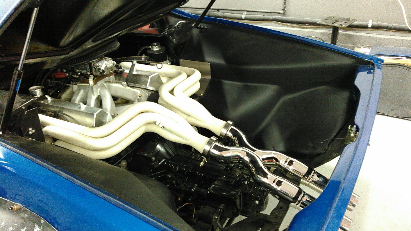

More exhaust work this weekend. I have begun the process of connecting the collectors to the primaries. I cut all 8 bends and really had to sand them well to fit in the collectors. That's good because a tight fit will keep it from leaking.
I bolted all this into the car and started making the connections. First one was easy but after that, nothing moves!
After a day of work, this is what you get! It is all tacked together.
If you take the trans braces off, the headers slide right out. Here they are ready to weld up!
I am really happy with how they turned out.
Luke, the length is pretty close to what I was after. Everything is a compromise and I'm pretty happy with how it turned out. In some areas there is a lot of space and in others it gets pretty tight. For my first set of headers I could have probably chosen an easier project!
Anyway, here are the final headers after they are fully welded. I also finished up the "mufflers" and I use that term loosely! The option of using a real muffler and giving up the x pipe is always there but why would I ever want to do that? :evil:
Here are a few shots with the system on the car.
It is all taken apart now and on its way to Jet Hot for ceramic coating. I can't wait to get it all bolted on to see what is looks like all shiny!

Darn it, Dean! I sure wish you'd tape the stacks shut!!!
'Makes me n-n-n-nervous seeing 'em left 'open'/'exposed' like that! You're just inviting "Murphy" to pay you a visit sometime! :sick:
BTW - those headers are g-o-r-g-e-o-u-s! :thumbsup::thumbsup:

Hi Dean. Regarding your comment below:
"The option of using a real muffler and giving up the x pipe is always there but why would I ever want to do that?"
The answer would be take a ride in my car! I have the same setup, possibly bigger Burns mufflers, and when I drive on interstates for any length of time I use earplugs! Yep it all gets to much after a while. Its great for short 30 minute drives but any longer and hell its loud.
Anyhow we will see how you go.
Ron McCall
I also have the same setup on my Pantera with even smaller mufflers and I think it is quite manageable. The neighbors may not agree though. ;-)
Ron

I agree, I need to get the trumpets covered. I have used a string of tennis balls in the past. Probably a good idea.
The exhaust is perfect for me. This is one badass car and I want it to sound like it. Every builder is different. Who wants to hear a lion "meow"! Roar baby roar!
