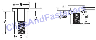

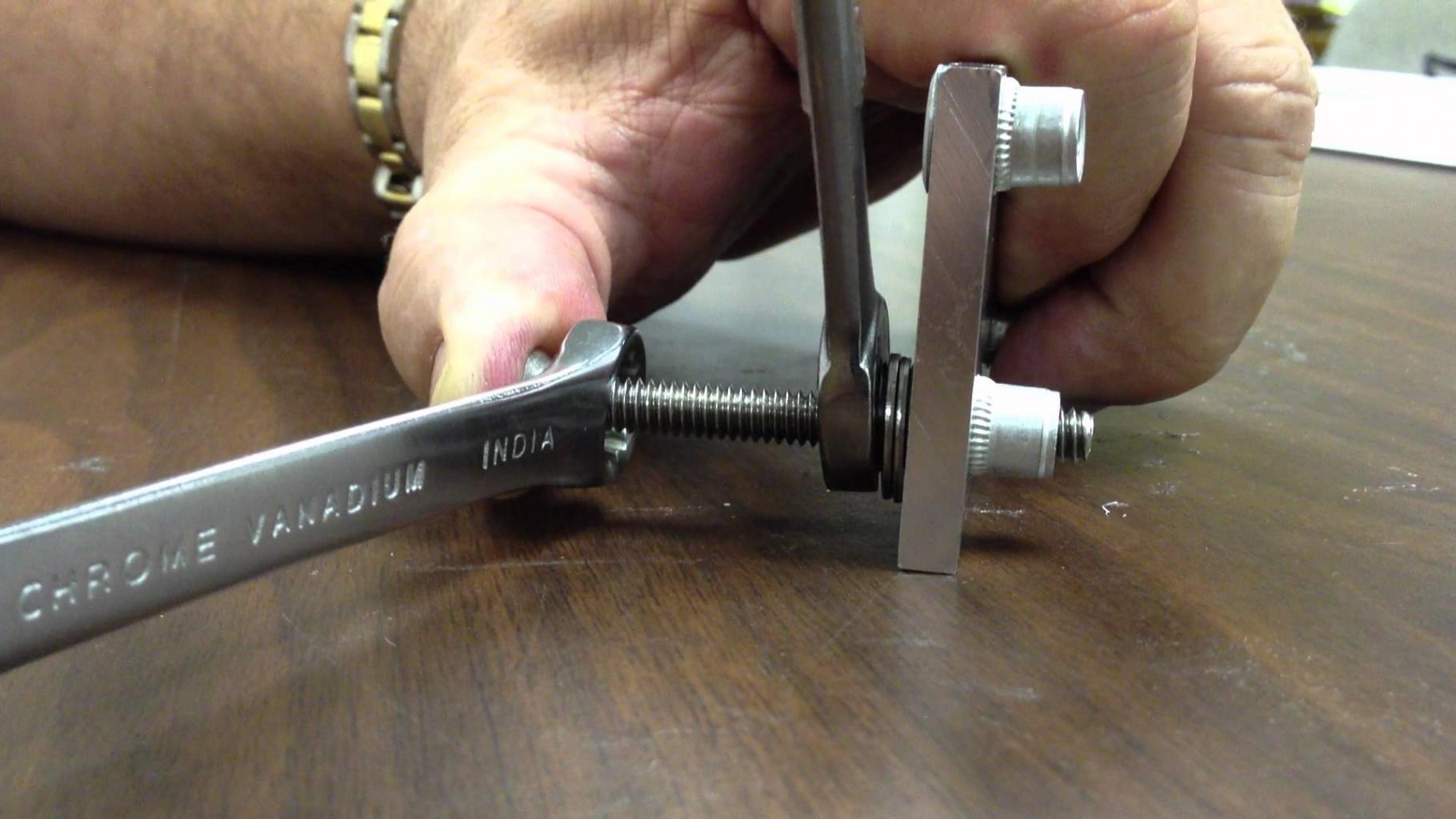

Nutserts, although you might have to whip the tank out again to fit, another thought, cut a rectangle plate of 1/4" alloy about 1'' longer & wider than the shifter base, drill and tap for shifter and use rivets @ 3/4" spacing all round edge of that 1/4" plate to rivet it securely to tunnel.

First time I've seen hand tools from India!
