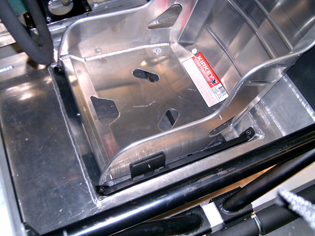

Dean, how about one more slot in the seat bottom for the crotch strap. If you go all the way to the front of the seat it will allow you to slide forward too much before the crotch strap arrests the forward motion of your hips as they slide forward under the waste belt. This will cause internal injurys.
Here's a picture of my seat.
Final seat pictures on the way. They turned out great but I'm not quite ready to share the finished product yet.:lipsrsealed: I think they will meet the highest track day standards.
I had to return one set of belts. I ordered the passenger harnesses just like the drivers harness but I realized that it didn't need to accomidate a Hans device. RJS is sending me a standeard belt. They have been very easy to work with.
I am happy to say that I am done with the seats. Who would have thought we would spend 2 pages on something as simple as seat installation. I guess there is a right way and a wrong way to do things. When it comes to a track car, there is only one way to do some things and that is the safest way for the drive.
I had to alter the mounts to accommodate the seat belts and the room they needed to pass thought the sides of the seat. The seat has the two front mounts, one floor mount and two rear mount locations created with steel nut rivets.
I used a grip edging to create a smooth surface for the seat belt to pass over.
The sub hole was cut and the belts were test fitted. It is much tighter and I think it will work perfectly with the Hans device.
