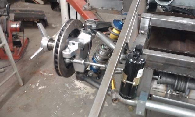

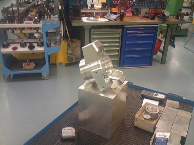

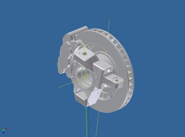

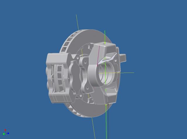

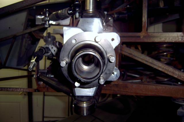

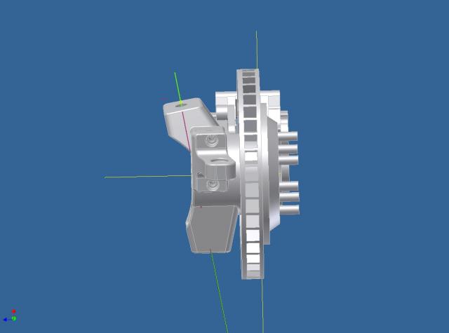

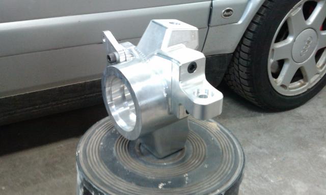

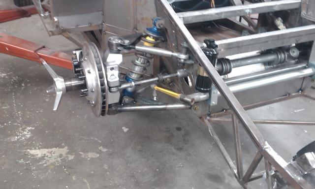

Hello
That is why I have developed my own. Not a soft airy aluminum that is not cured. These have bolted steering arm to easily modify Ackerman 10 degrees of kingpin angle, adjustable caster but default 6 degrees. Bearing fit that makes it will never come off. See the pictures and enjoy ..

Wow, those are some beautifully machined units. Look very sturdy. Much sturdier than the alloy uprights on my early CAV mono.
For a sturdy steel unit that is also precision made, Ian at CAV Canada makes some beautiful pieces that should work well for just about any GT40 replica. He might sell these to non-CAV owners if you're nice to him!
