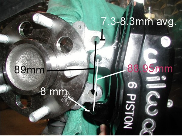

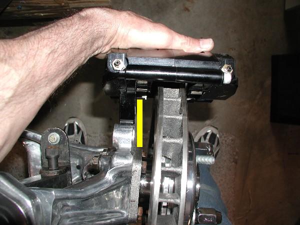

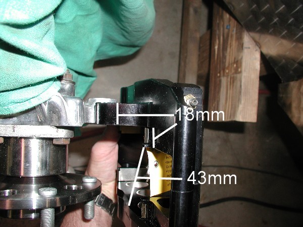

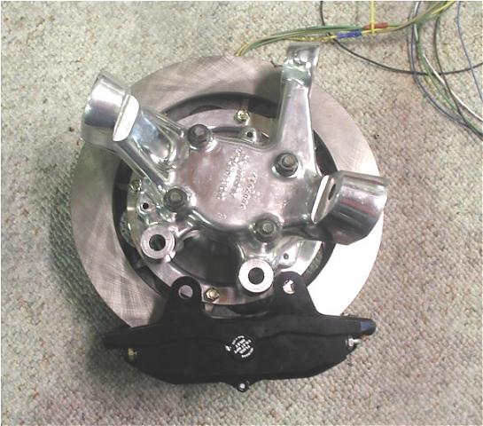

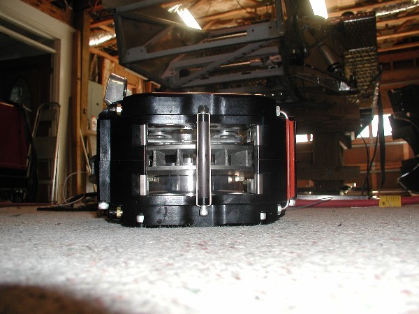

I am in a dilemma. I will elaborate on the dilemma, and leave the story behind the dilemma for another post, which will be very enlightening to a lot of you. Here it is. I now have some 12” rotors for my Corvette front suspension. I have some Wilwood 6 piston calipers for those rotors. What I don’t have is a way to connect the two.
The problem in the beginning is that no one makes aftermarket brakes for the C-4 Corvette, except Corvette themselves. These are single piston units that have some serious drawbacks. I had these things made and purchased for me on the understanding that they would go together, or would be modified so that they would. I am now stranded with the parts and no way to get them together. I am including some pics and measurements for you engineering types to advise. As I am no engineer, I don’t know what my alternatives are. It would seem that a bracket that surrounds the two mounting holes of both pieces would work. The outside of the upright may have to be squared up for that to work. What I don’t know is if that is a feasible thing or not. Lord knows I wouldn’t want to be at speed to find out I was wrong. So I will throw it out there for you guys to advise. I really appreciate any help I can get.

Bill,
This was the exact problem that I had just finished solving on the TVR I used to work on when I sent you the bump Steer info .
The previous clever clogs had machined the original caliper mount lugs off the C4 upright and made a new caliper bracket that mounted on the rear face of the upright by means of the four bolts that retain the wheel brg assy, In practice this method gave trouble as the caliper mount was not in line with the caliper & deflection was causing long pedal & uneven pad wear.The new mount bracket now fitted was made from steel (0.0200") and is sandwiched between the wheel brg carrier and upright as well as having another pair of lugs to pickup on the rear face of the upright on two of the hub bolts.This bracket is rock solid and cured all of the issues we were having in this dept.
Fortunately in the process we had to change Rotor Hats as well and as these were approx 0.300" thinner at the hub face area we still reduced rather than increased the scrub radius.
Now looking at your pics & before you even start to try and fit those calipers have you checked that they are going to clear the center of the wheel with those rotor/hub assy as there does not appear to be a lot of rotor offset in relation to the hub face.
Just looked again, can the rotor not be mounted on the rear face of the rotor hat to help, you may then be able to mount the caliper on a simple stepped bracket that uses the existing upright lugs with the caliper slightly higher ( caliper lugs straddling the upper lug of the upright.)
Jac Mac

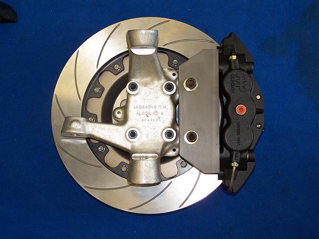

Couldn't you just get a plate made up similar to these? These are using radial mount rather than lug mount calipers but you would just have caliper mount holes parallel rather than perpendicular to the hub mount holes.
The mount is bolted to the upright with bolts, nuts, and spacer tube to bring the hub mount holes down to 12mm.

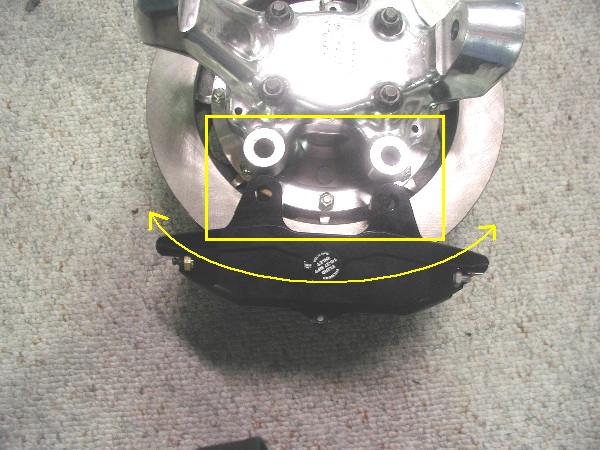

Bill,
I have a keen interest in how this turns out for obvious reasons. They say a picture is worth a thousand words, so here are a couple of your photos that I have annotated to show what I think Jac Mac is saying. The yellow box roughly outlines a flat plate drilled with 4 holes to connect the two parts. The arced arrow in the first picture is to indicate that the calipers could be rotated slightly either way, if need be, so that the ears interleave and the calipers are fully seated down on the rotor.
In the second picture, because of the slight angle, it appears that the rotor is not centered in the caliper if the plate were bolted in as shown. Would bolting the rotor to the backside of the hat, as Jac Mac suggested, put the rotor midway between the installed pads? If not, the plate could be milled and/or shimmed on the upper and lower halves independently, as needed, to get the rotor and calipers properly aligned.
Does that sound right, Jac Mac?
EDIT FOR LEE'S PICTURE - Lee, nice pic that must have been saved as I was typing. The obvious advantage to the radially mounted caliper is that the caliper and rotor can be aligned by simply drilling the caliper bolt holes in the right position. Worries over ears overlapping is also gone. Noticed also that Lee's rotors are bolted to the backside of the hat.

Bill, as Jac Mac has already said, the caliper sits outside the wheel flange by a significant amount, and the fear is that it will foul the inside of the wheel.
What you need to do is;
1 determine the position the caliper must be in to leave say 5mm+ clearance from the inside face of the wheel. This then determines the position of the rotor to sit centrally in the caliper. If the rotor will foul the hub or lugs in this position, you are in a bit more trouble. Also make sure the caliper fits within the wheel inside radius.
2 from this rotor position and the hub flange dimensions, determine the bell required to mount the rotor.
3 all being well you can then design the caliper mounting bracket. If you are lucky it could just be a piece of flat plate. I suggest you could do some hand sketches to explore the possibilities.
It may help to see my threads which contain some pictures and section drawings. Do an advanced search on my username for threads started by me and look for threads on the front, and especially the rear brakes you will see some pictures of mine and others brackets.
