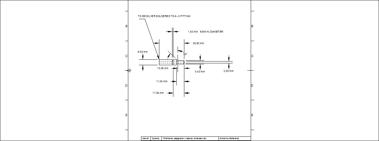

Guys i have a small dilema, i have the above trans for my jigger, complete with a plastic slave cyl, but i need the hyd hose to connect to said slave cyl. have tried the local Audi dealer, but as i dont have a Vin No. he cant or wont help me, the tricky bit is it looks like some sort of push on fitting into the cyl that I've never come across before.
can anybody help
thanks in advance John
you want something like this.
Check it before you make it.
I made mine.
Use the back of a drill bit to check the 5.4mm OD as it goes into an oring in the slave.
The 1.5mm groove is for a clip to hold it in, solder a -4 onto the back of it.
Jim

Thanks for that Jim, have sent the drawing off to my main man to see if he can turn one up for me, as i dont have a lathe, or access to one.
