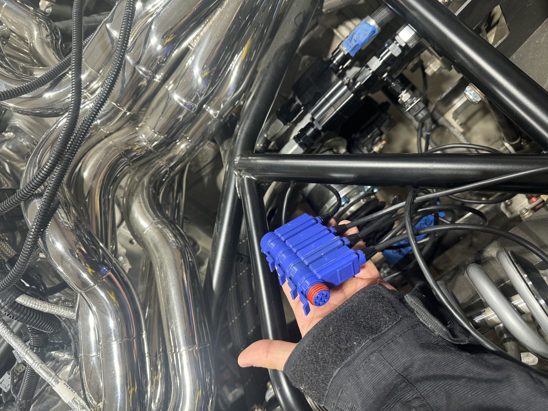

All the sensors terminate in this stackable chain that then plugs into the switch module. From there the collected telemetry data is used to program switching, and this data is also relayed to the dash Guage so the driver can see what’s going on and so that you can program your dummy
Lights based upon the sensor data

Rusty, Racepack looks like a really slick setup. I like the way all the components daisy chain and stack together. Nice to see you are getting close to the first start.

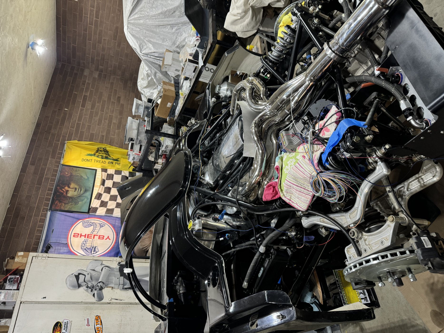

I have the engine all wrapped up neat. Clutch is bled and the oil coolers are all properly tied in.

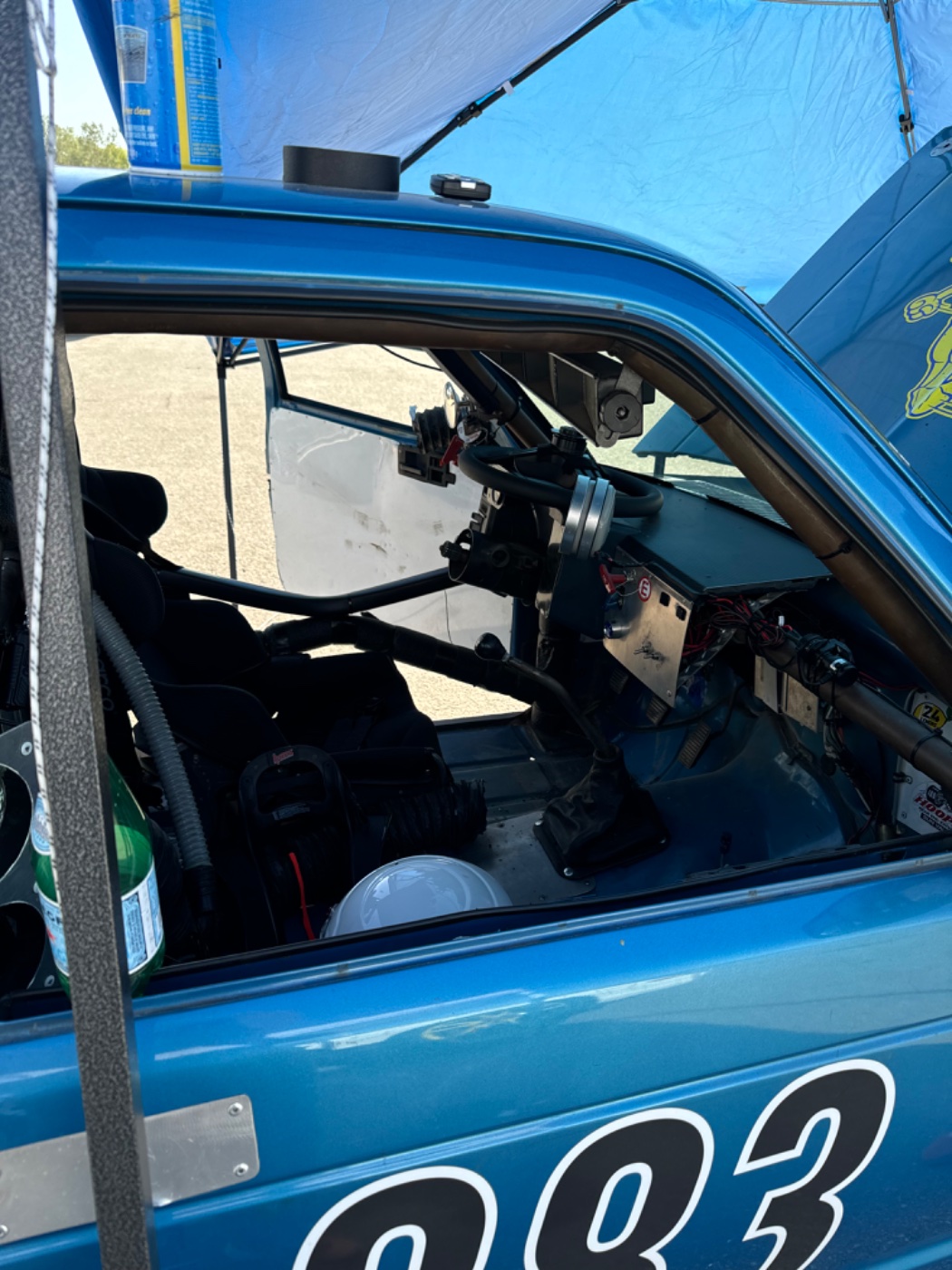

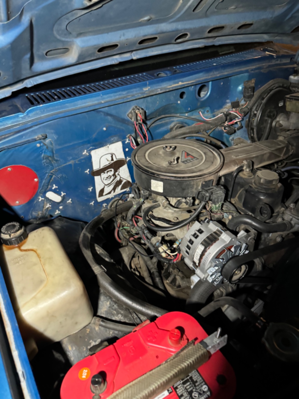

I’m putting more time into Slc now. Me and my brothers have been doing a lot of prep for the 24 hours of lemons Race that was two weeks ago. We campaign three cars this year. And our fastest car was the 99 S-10 with an iron Duke four-cylinder.

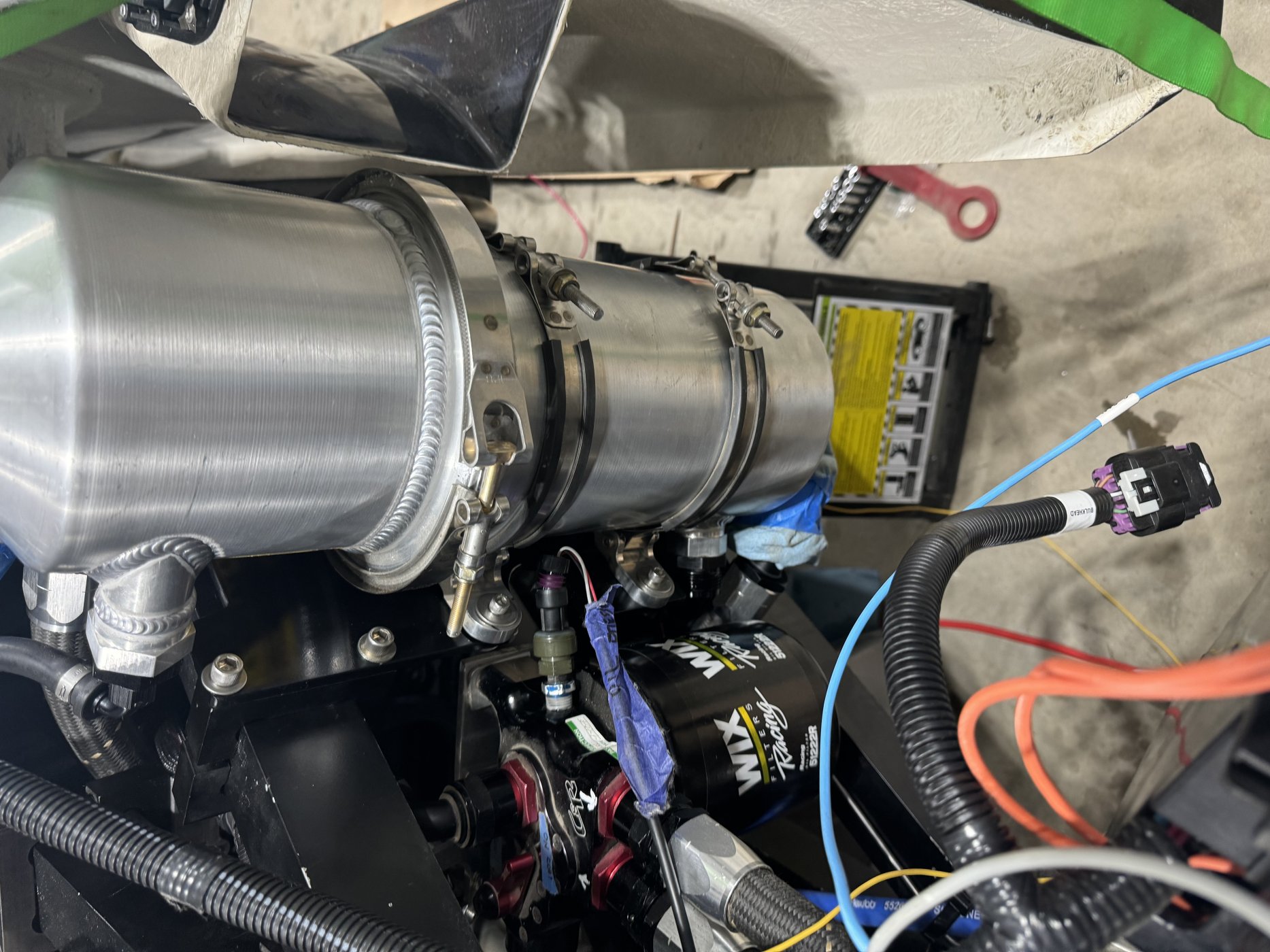

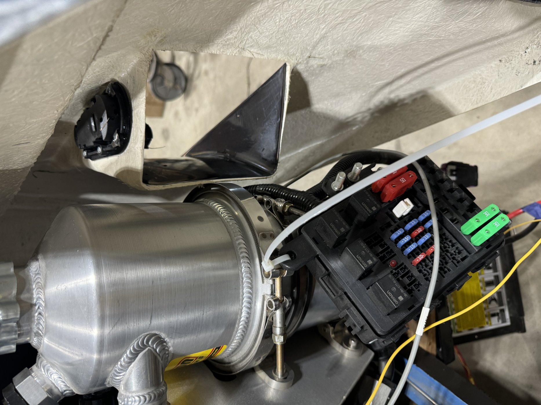

You can see in the picture my dry sump tank hitting the vent on the super light. This is why you measure twice cut once. This tank is off by about an inch and a half so now I have to rebuild the bracket for the sump tank. that’ll be about $300 worth of hoses that need to be replaced because of this mistake. It’s the little things to get you.
I can empathize for sure. I’ve had at least a few of those mishaps. I keep saying “the lack of space is the enemy of progress!” But your car looks great!

Lemon racing is really a great time. This team is one of the fastest. They actually had a a missile brigade, following this car all around in the pits.

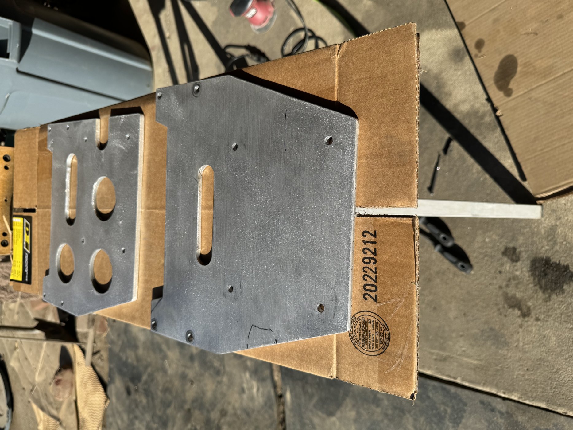

OK. Made the new dry sump mounting bracket. Put some speed holes in it while I was at it. Painted it black this time. Now it fits nice and tight in there. And I can go ahead and lower the body down to its proper position

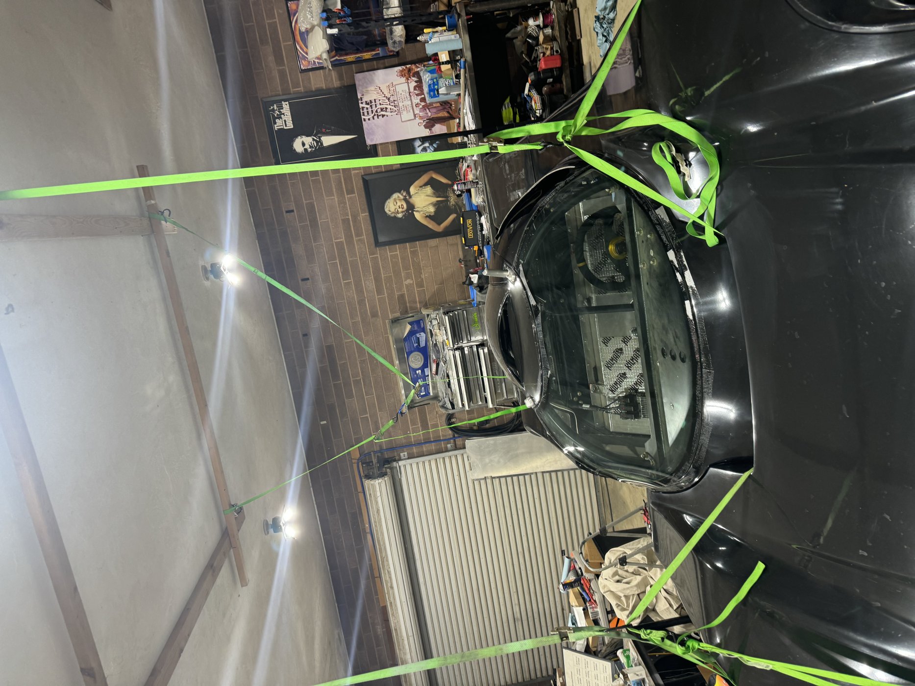

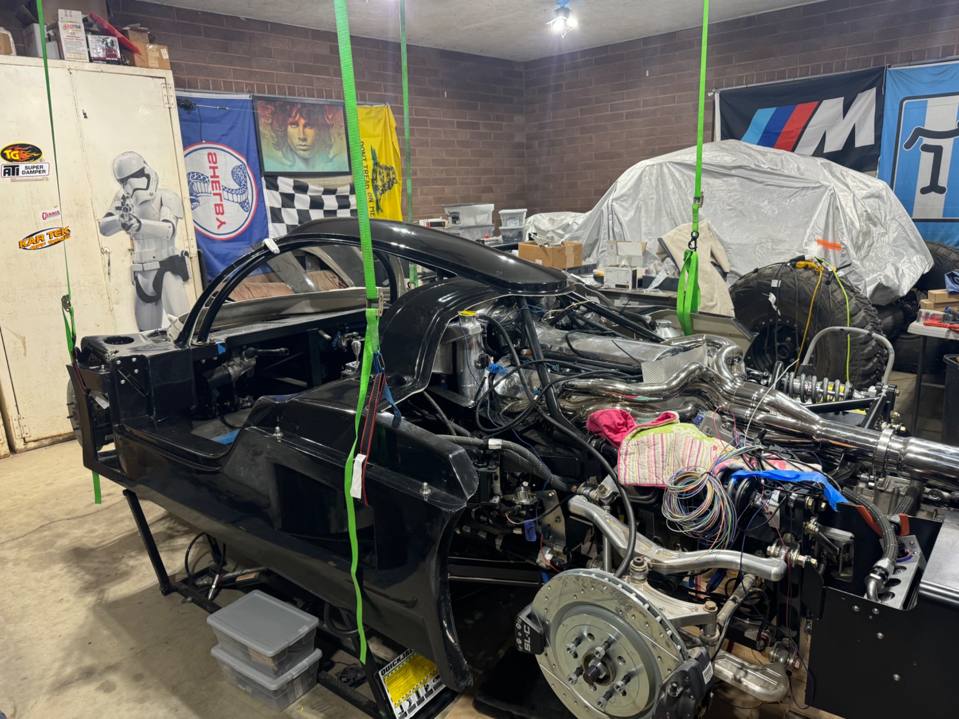

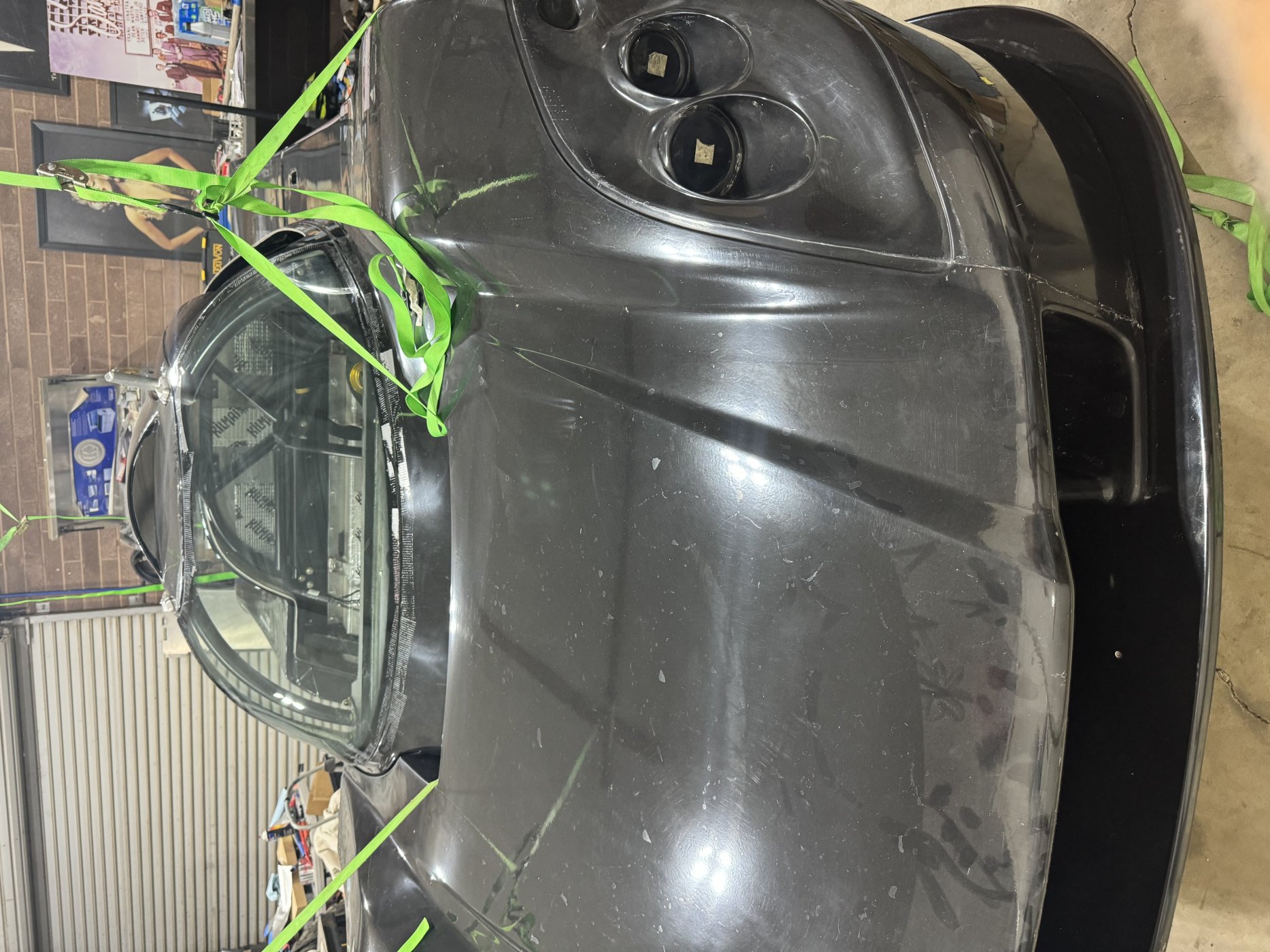

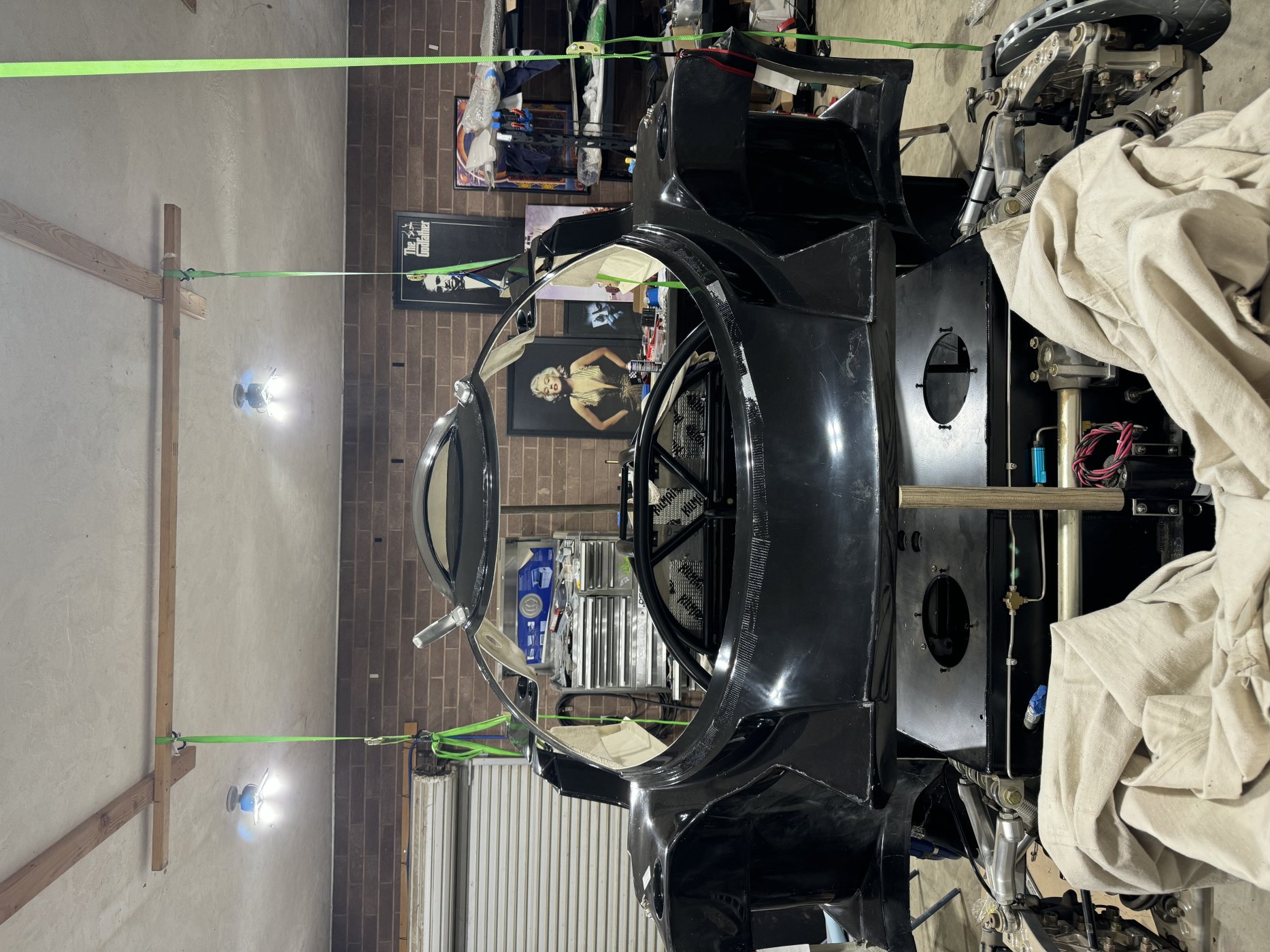

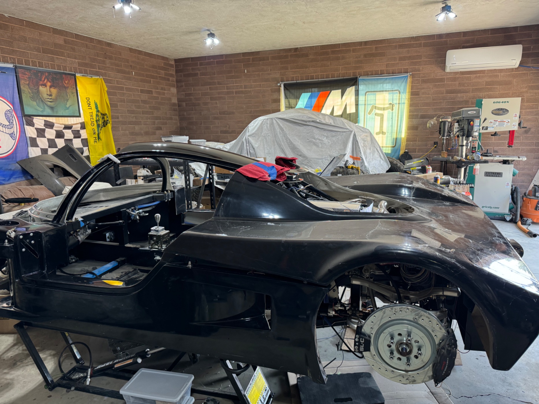

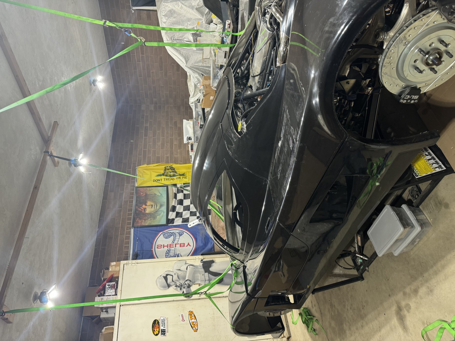

I’ve been trying to align the body and overall it’s coming together. I think I’ve got the spider figured out and the back of the car is looking good. The wheel position is about right inside the arches.
Having a little challenge getting the front nose piece right. I think I’m going to be able to fix that with proper spacers in the front. Spacers between the aluminum tub and the fiberglass nose piece will lift the nose up a bit and I think that will line everything up
I’m trying to decide if I want to buy that really cool front nose hinge or if I want to mount the front nose with some sort of clamps and disregard the hinge
Here is my question. I have seen threads on this form where people have placed spacers between the fiberglass and the aluminum chassis to help bolt everything down and position the fiberglass properly. Fact, I bought a few rounds of Delrin rod to cut and fit in such a manner. Can anyone remind me of which thread Reds had some good pictures of this done and showed positions of where people place these pucks? I’d rather do it where others have done then try to re-engineer this issue

Nice progress. Curious how well the windshield fits?
For the Delrin spacer approach and location, check out Johan’s thread post 49-57
much thanks
the windshield fits well. like 1/8 gap on both sides. i was considering making a hard spacer that fits between the rollcage and the windshield frame so that i could shape and stabilize the windshield frame in its relation to the window itself.
