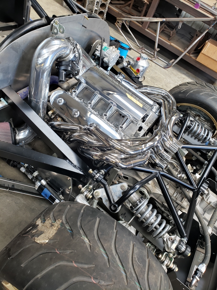

This brace is not as strong as the factory brace. But will it be strong enough? I suspect so. It “feels” strong According to my subjectometer readings.

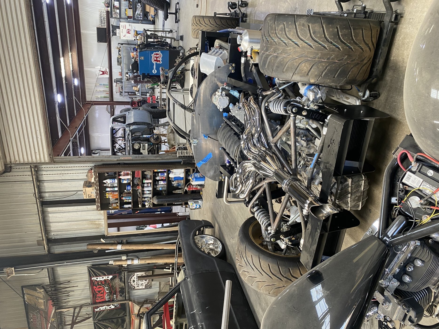

That is going to be seriously LOUD, need audio!

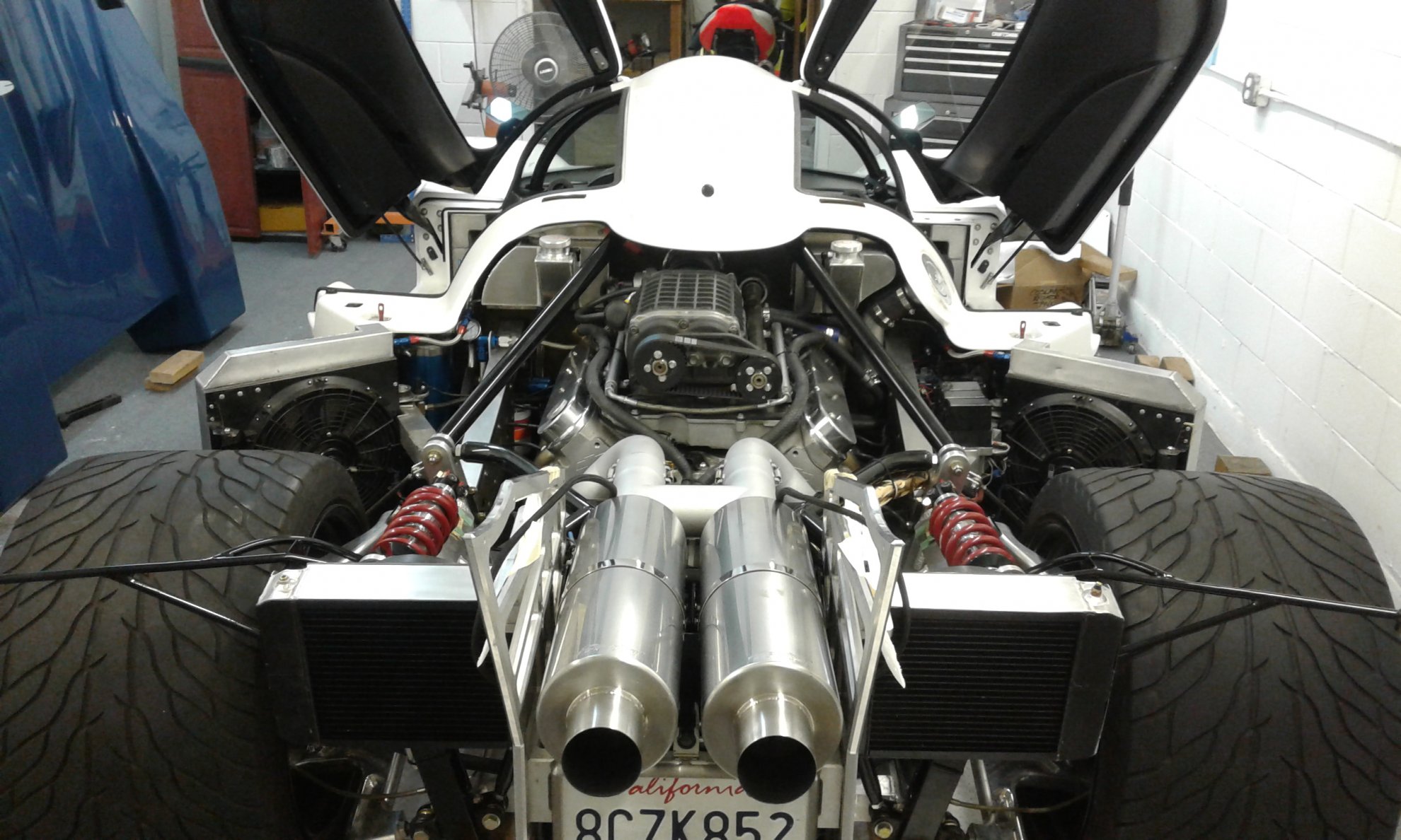

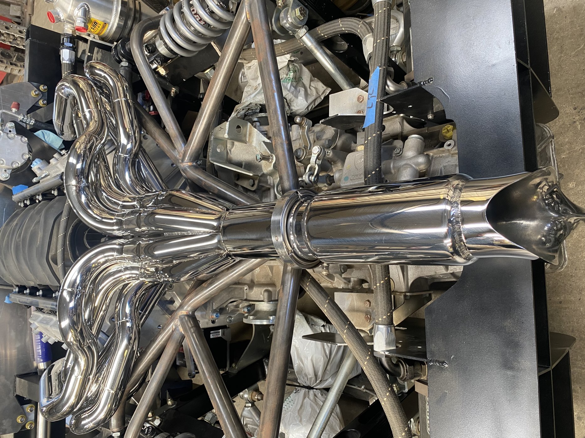

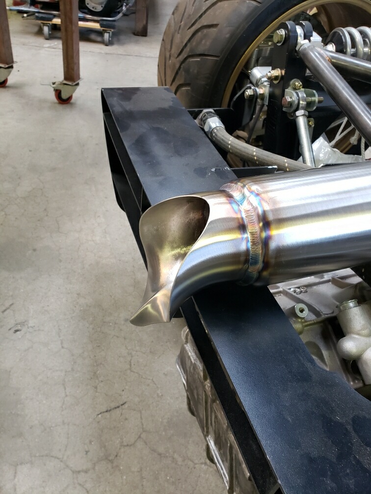

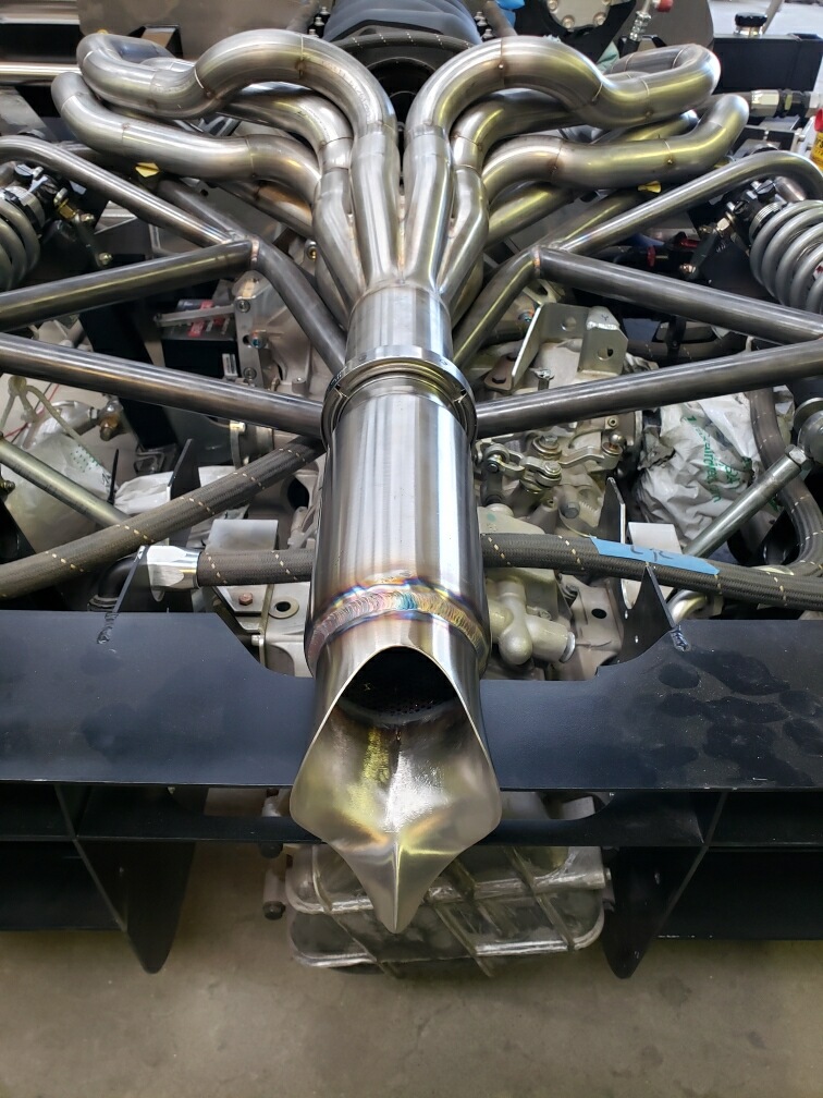

the question is whether or not the muffler could be insulated enough to not burn the clam....
My car has a similarly routed exhaust with a small section close to the pipes (within a half inch of the upper clam). Initially there was paint discoloration on the bottom side using "gold" heat reflective film. Up graded to the corrugated/dimpled fiberglass backed aluminum heat shield. End of problem. I did duct some cool air into the area to assist at the bottom of the glass and the mufflers are open to the air via a cut-out in the clam.
