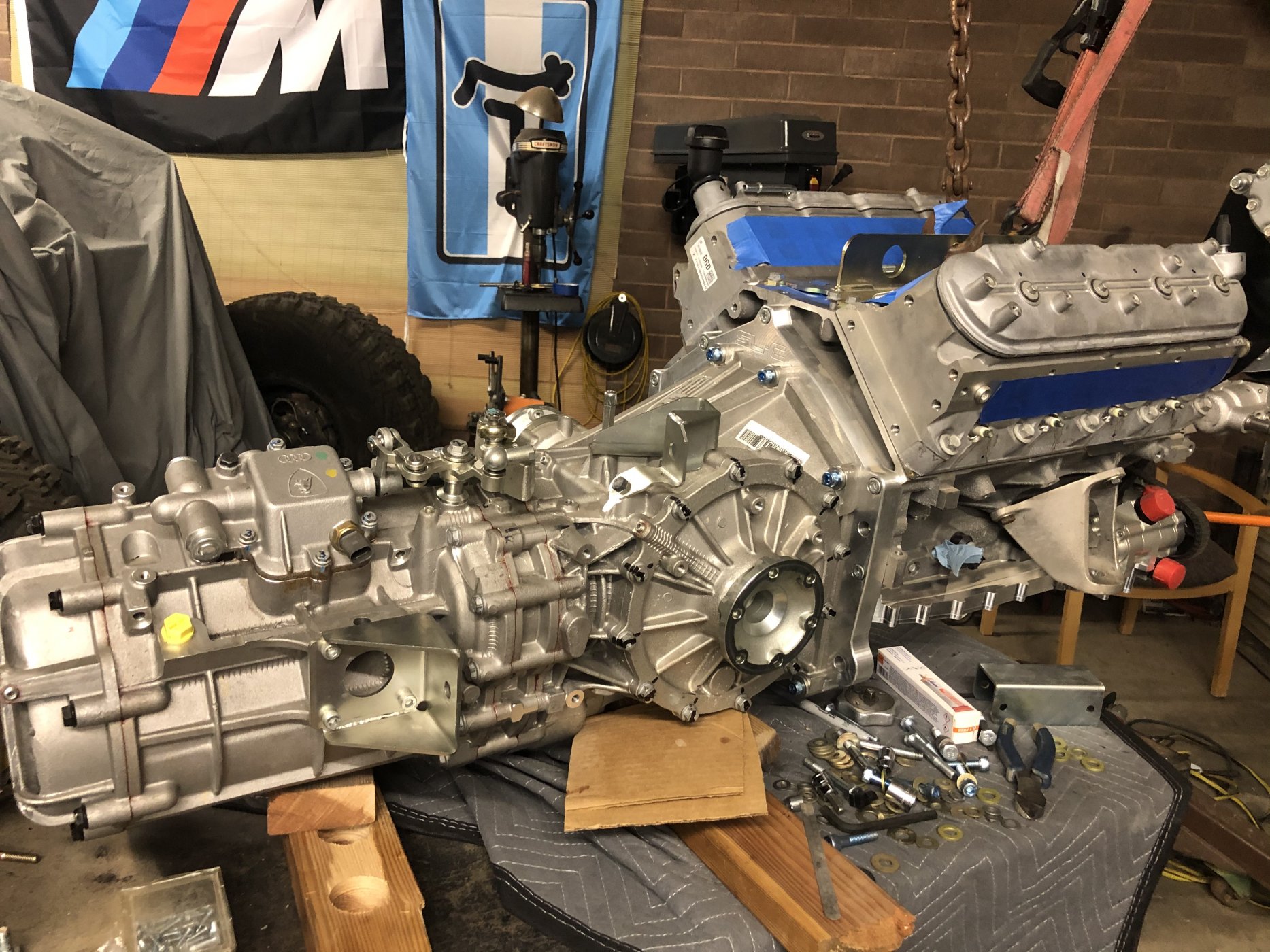

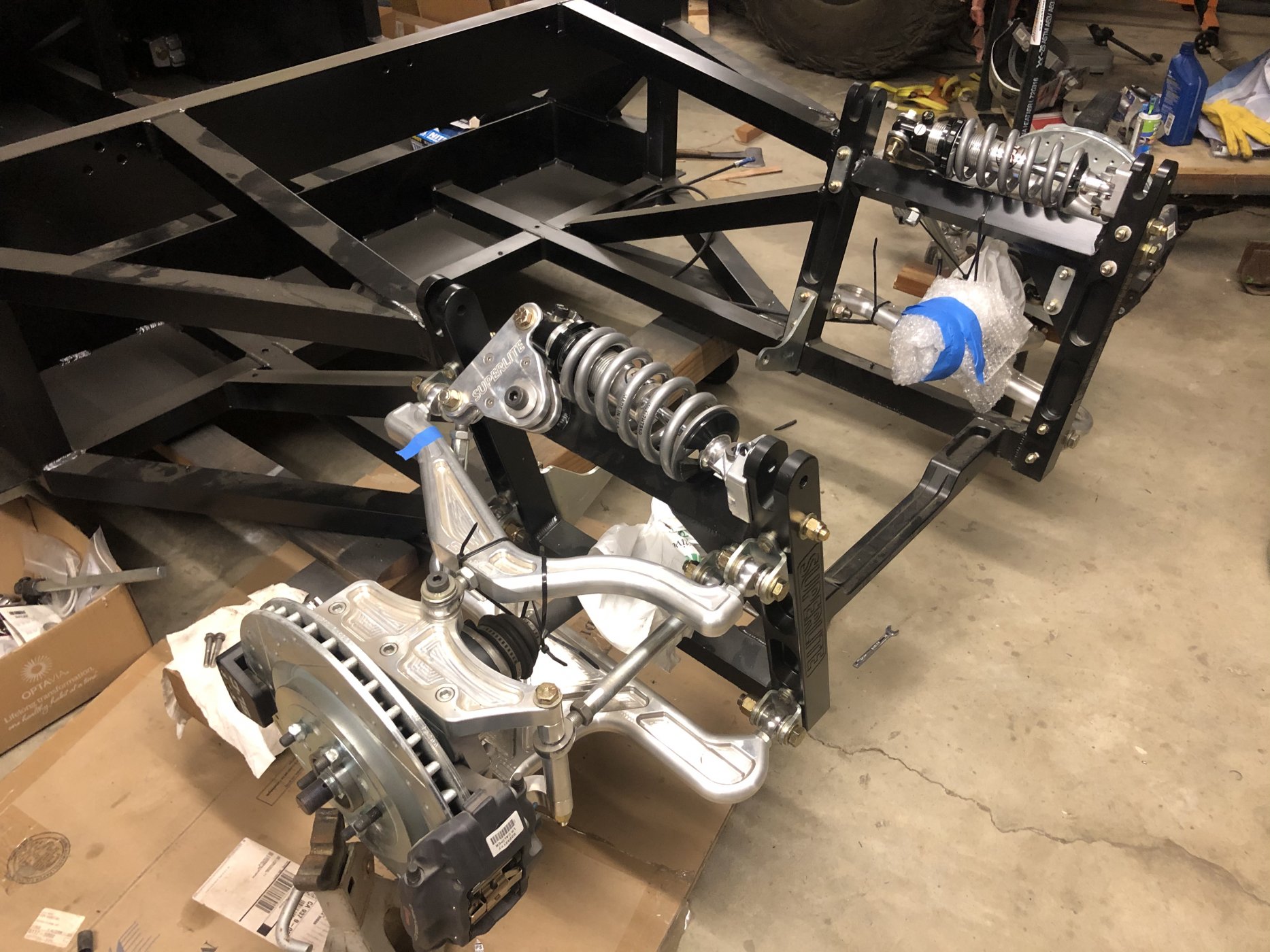

I am back on the Slc. I have all four sides assembled with regard to the suspension components. I cut down the bolts to the proper lengths and I torqued everything down. I do have a question though. These aluminum hub assemblies could be assembled with Loctite. Are people using Loctite? Specifically some of the keyed parts on these beautifully machined billet suspension components could be assembled with locktight. Are you all doing that?

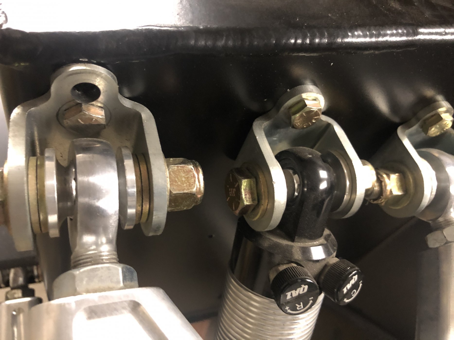

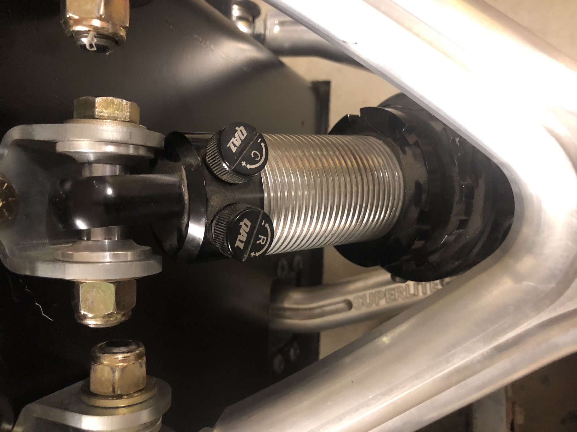

I am also looking at these coil overs and although they all seem pretty tight there is a very small amount of clunk to some of them due to the Heim joints on the shock towers. I imagine there’s going to be clunking which is standard with Heim joints versus bushings. Are you guys doing anything to remedy this or do you just live with it?

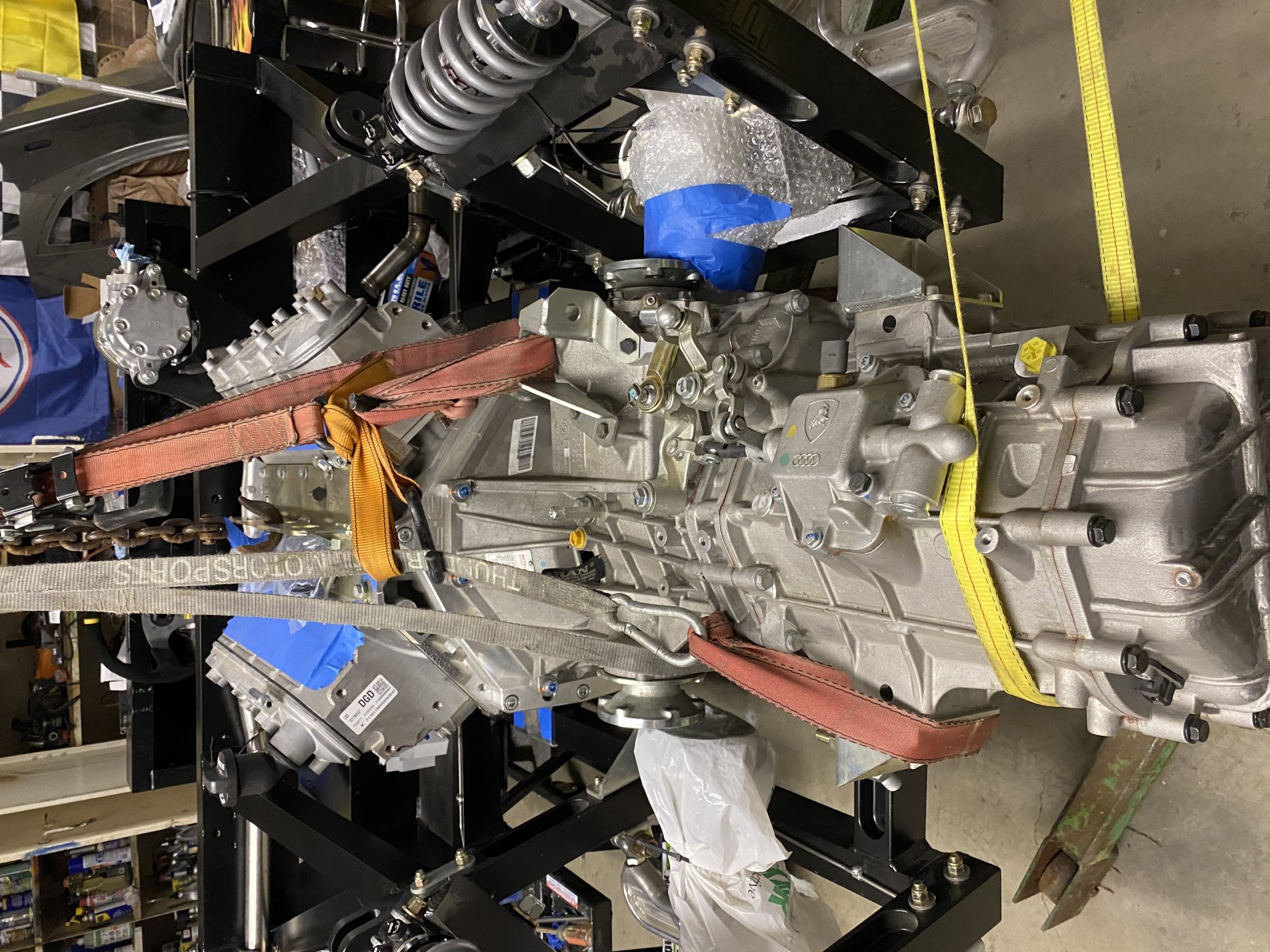

The clutch assembly is all in place now and so I can drop the motor in the chassis. Then I can take the car to the builder so that he can work on the eight into one exhaust which is going to go over the top of the motor which is going to cause all kinds of problems that need to be resolved

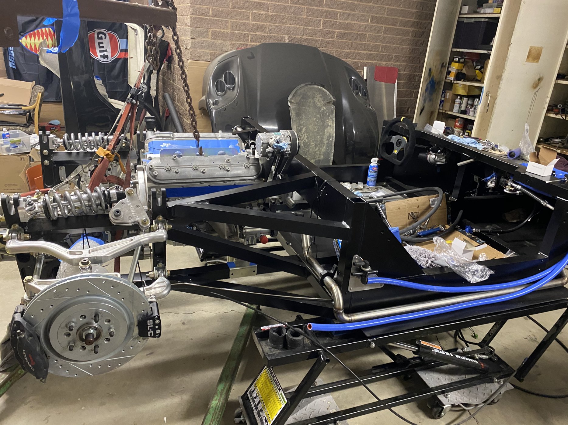

I refer to this form all the time as I am building my car. I don’t have a lot to contribute although I’ve been working a fair deal on the car. I probably get 5 to 7 hours a week done on the car. I’m feeling a little bit guilty because I haven’t had anything so here are a few bits

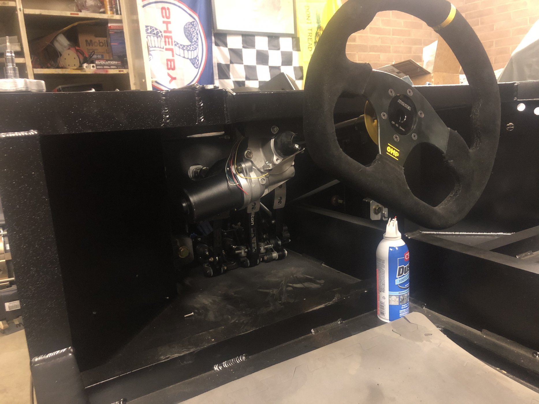

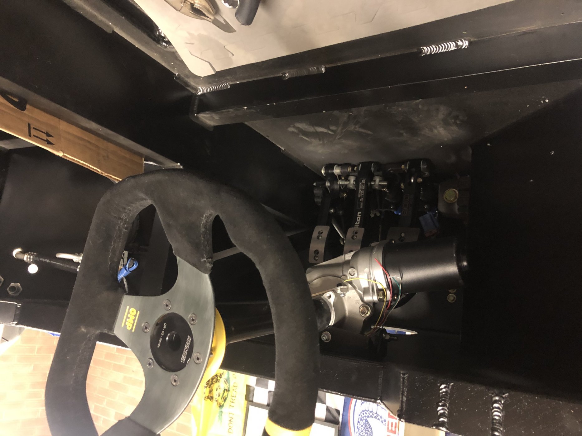

Power steering turned out great. The bracket that holds it is solid and the F1 steering wheel disconnect It’s by far the tightest disconnect I have ever played with. Absolutely no movement.
The motor is back in the chassis for now

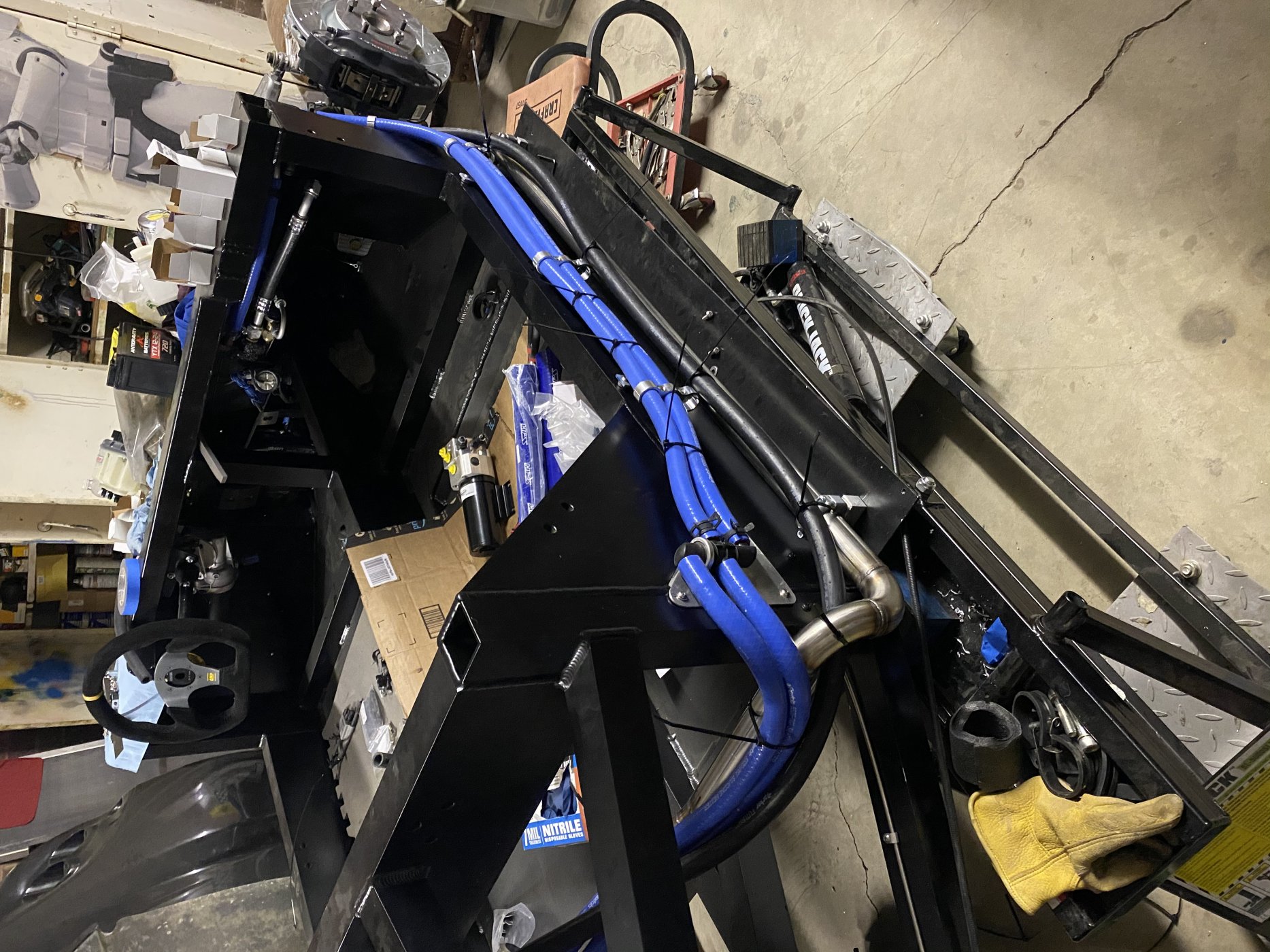

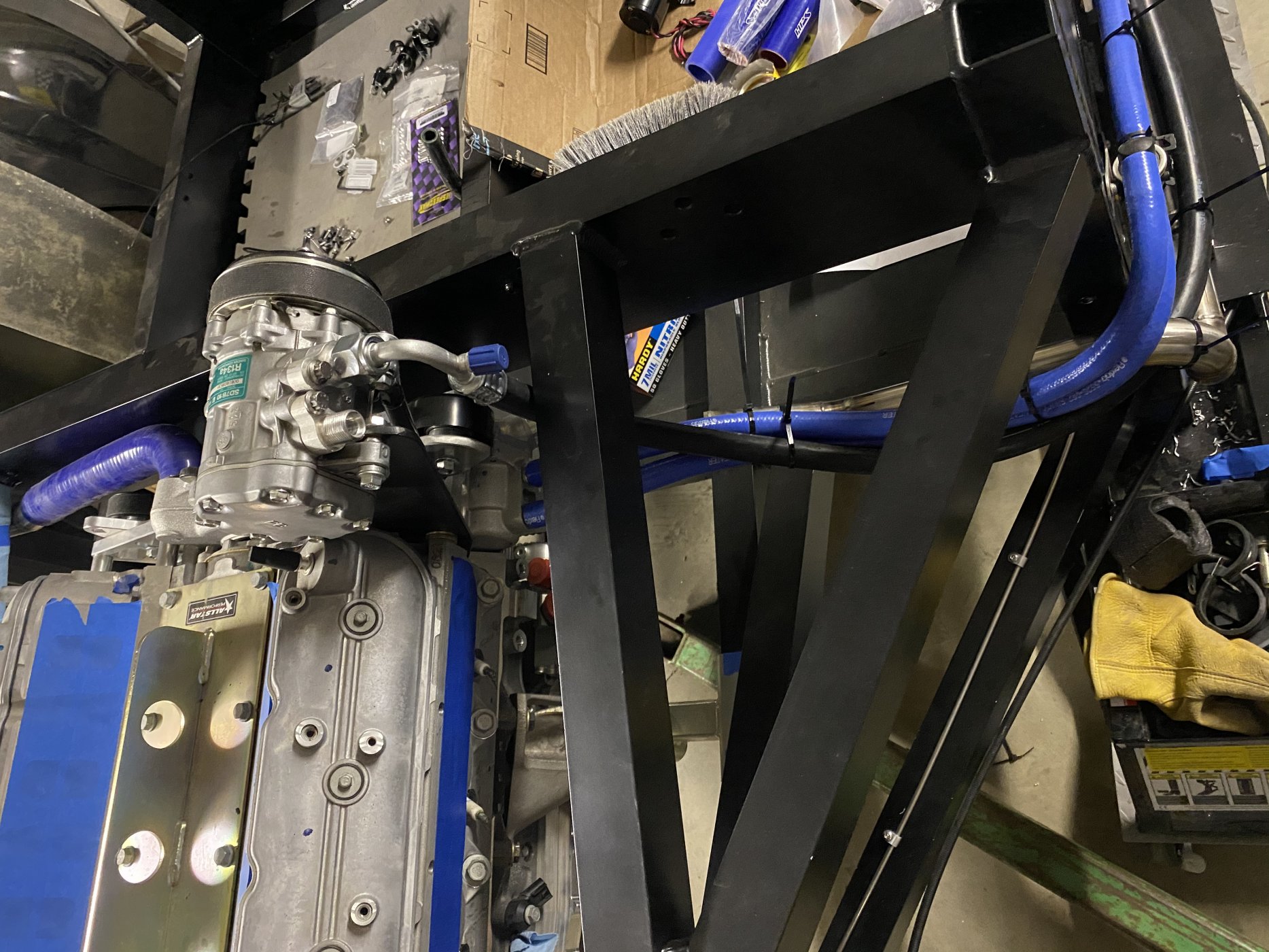

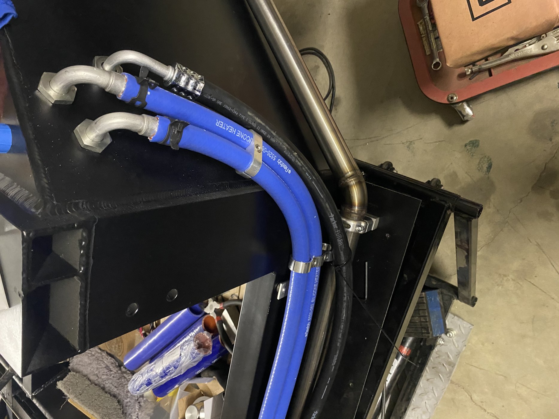

I have put so many hours into the water lines, heater lines, and air-conditioning lines and they are almost done. I will post them up soon

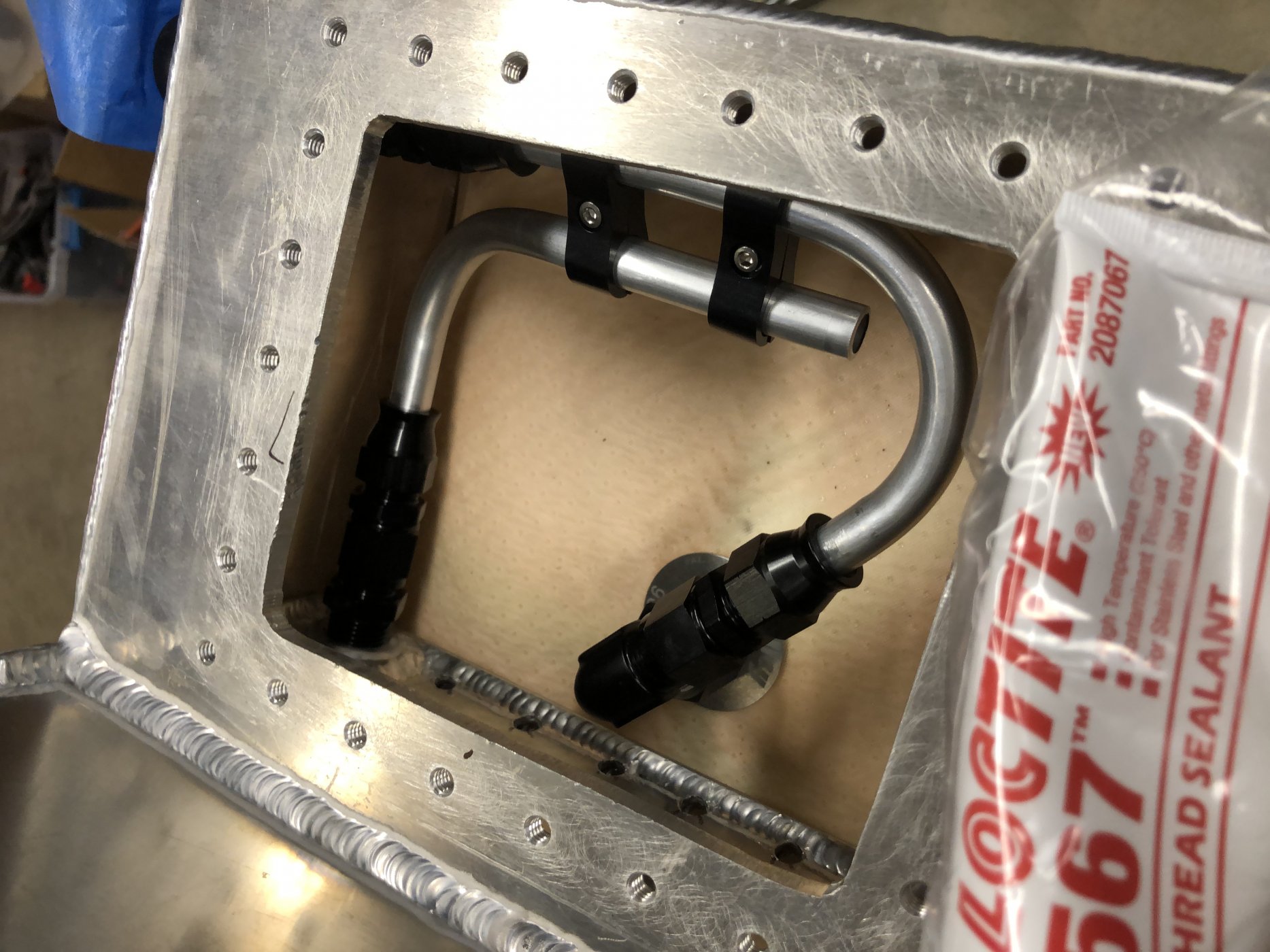

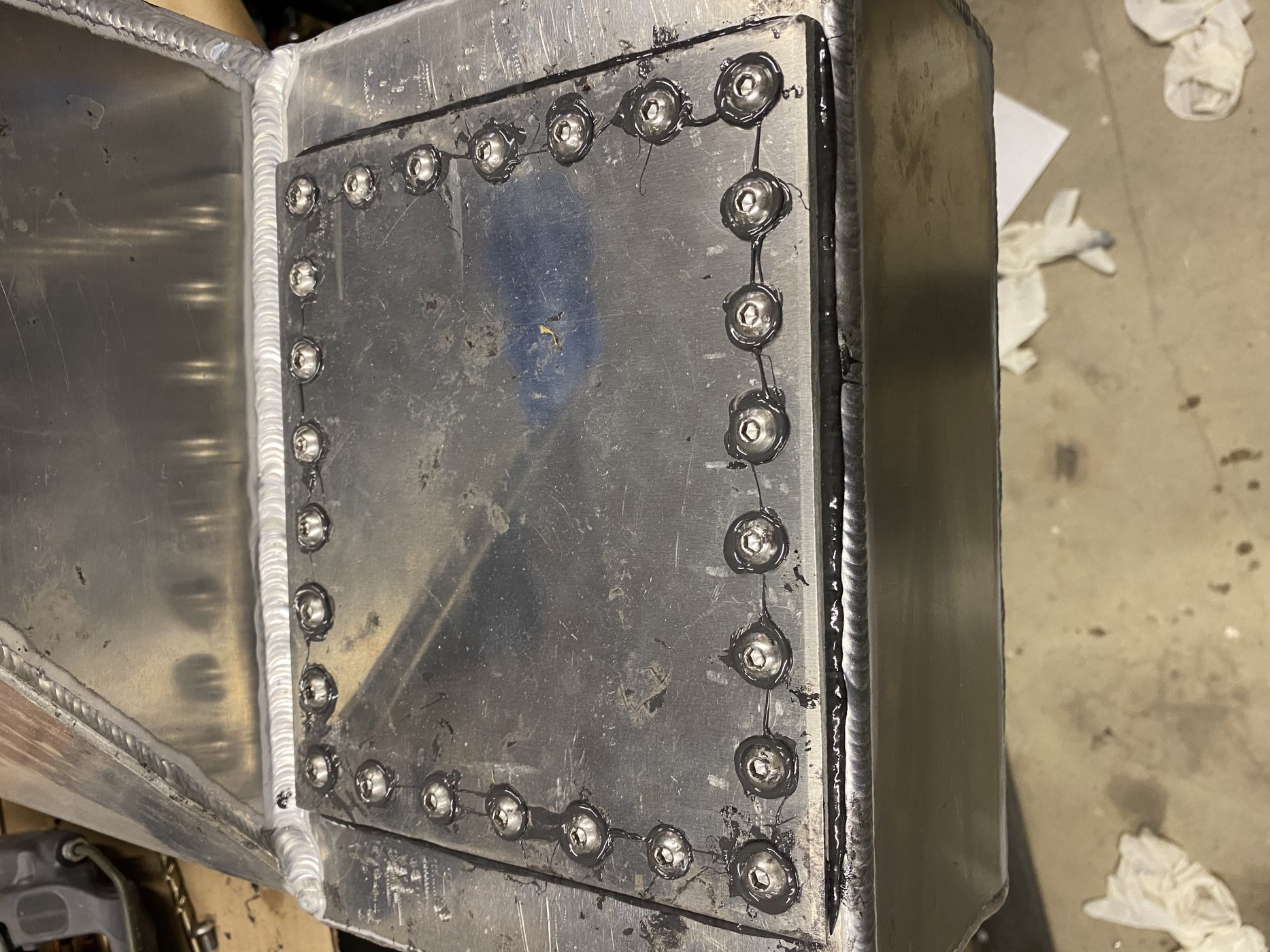

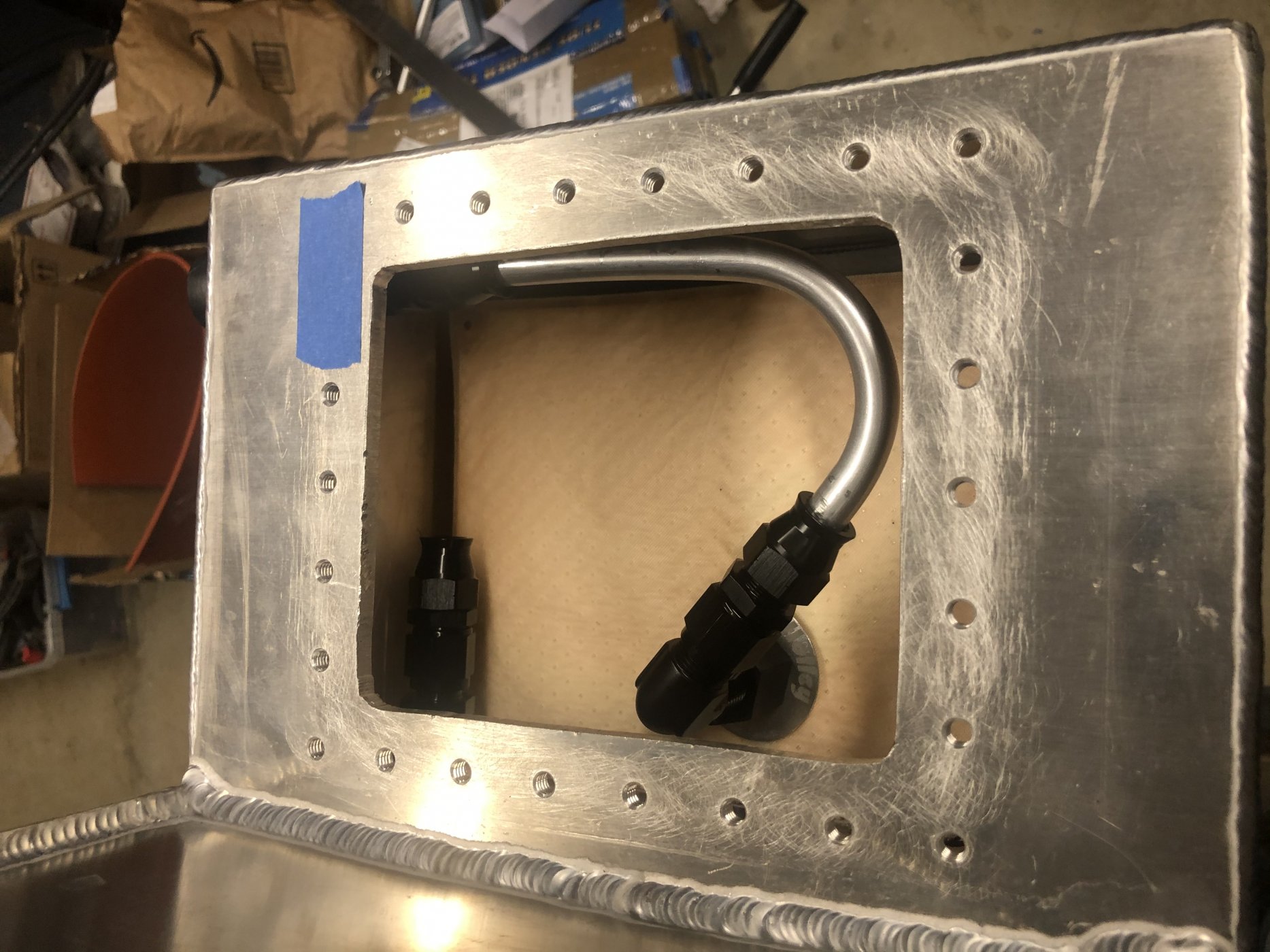

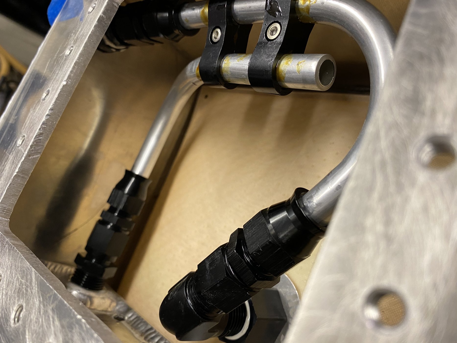

I did finish up the fuel tank. In the picture you can see that the holly Hydro Matt is now connected to the outside of the tank. And the tube that runs parallel to it does not carry fuel it is simply a bracket to help support the Hydro matt line.
Are used in aircraft wing fuel access type apoxy to close the tank access. I haven’t tested it yet so I’m hoping it doesn’t leak. I single tube of this stuff was 60 something bucks

Nice update Dusty, That power steering unit looks like it is at a good angle. Not too high or low.
I played with the steering wheel while tell I found work will likely be the best place for me. It’s not adjustable so if it doesn’t work it will be a hassle to build a new bracket.

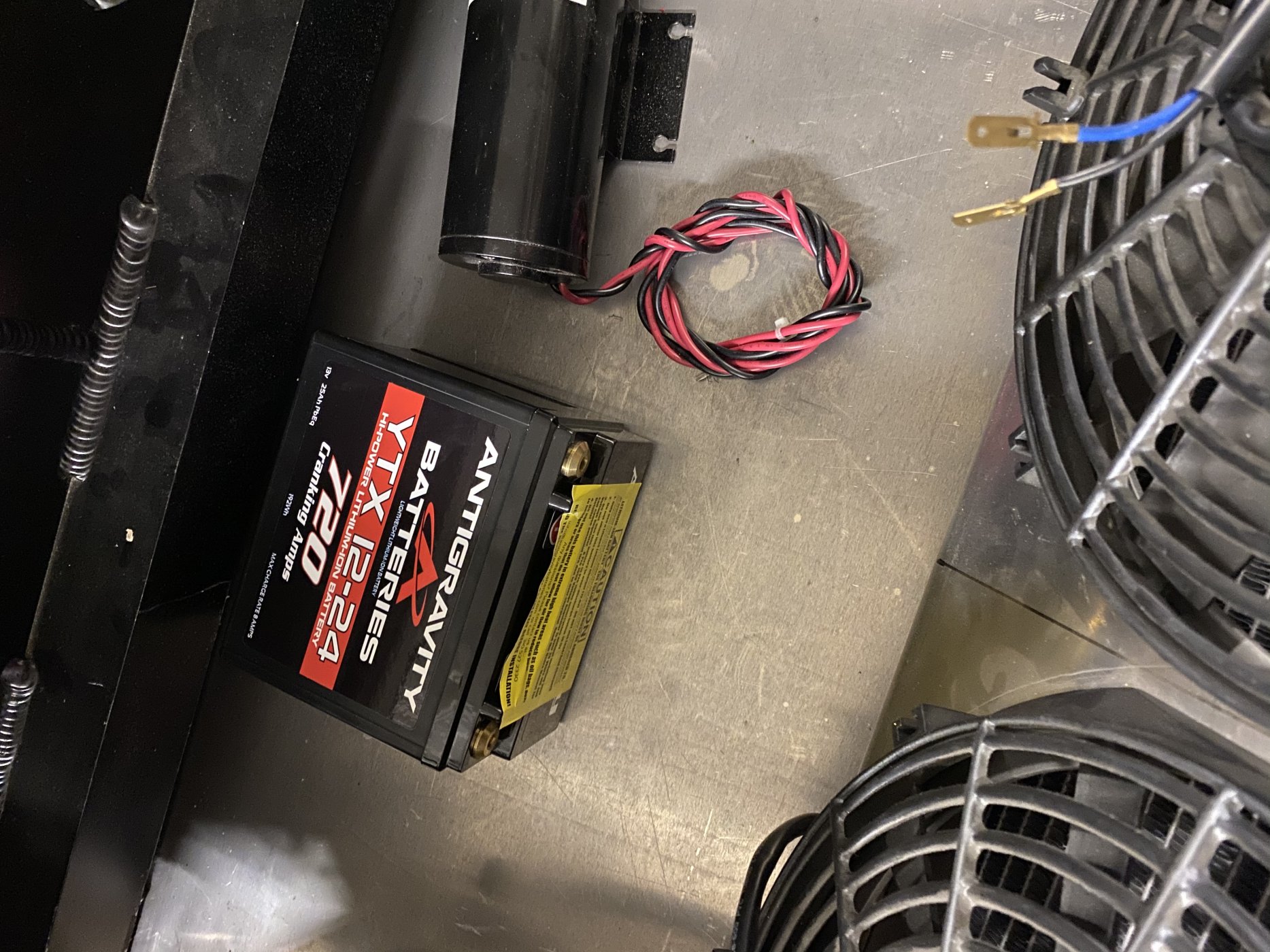

I’m going to use another one of these lightweight batteries. I use them in my rock racer and they are phenomenal.

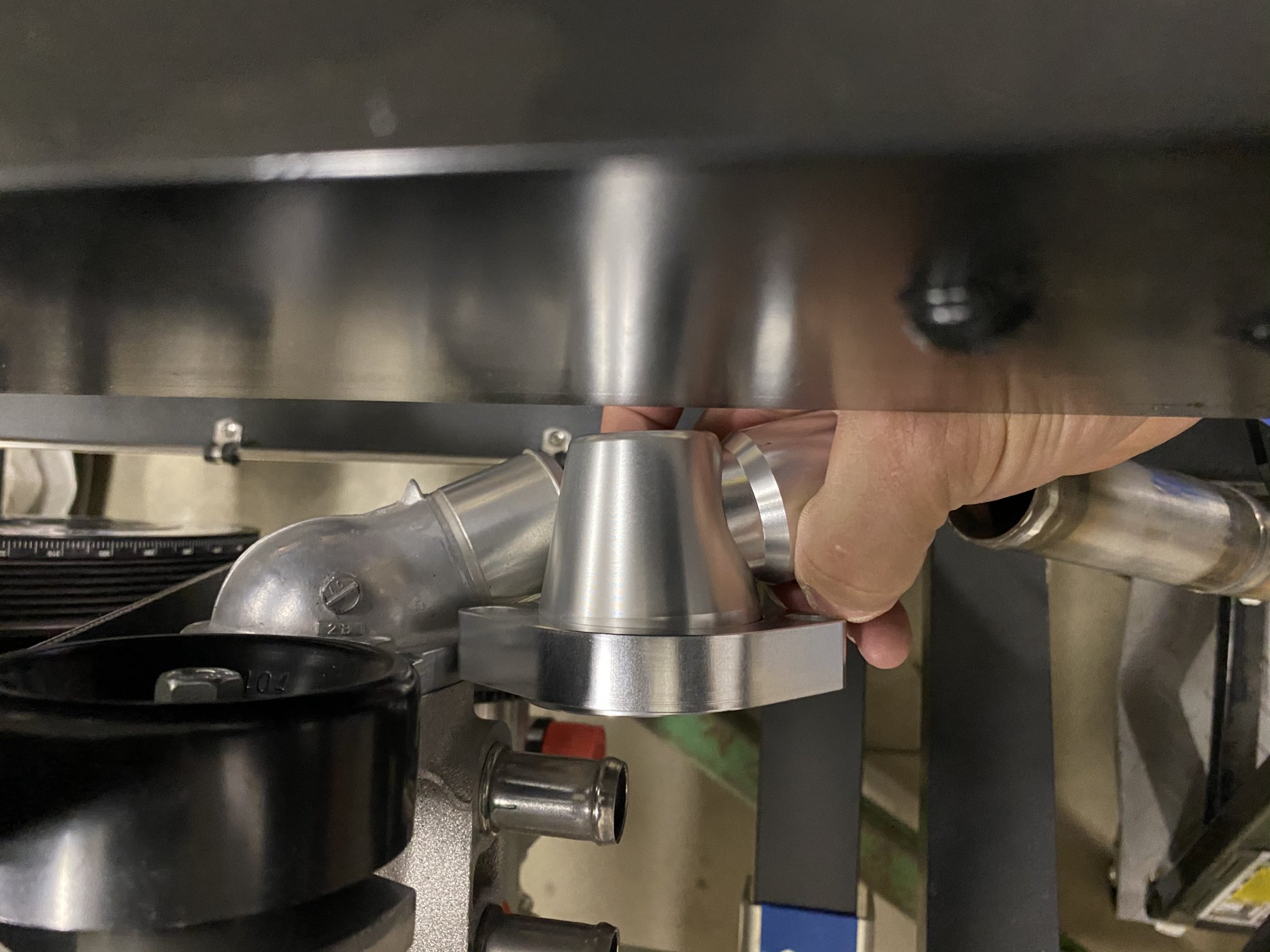

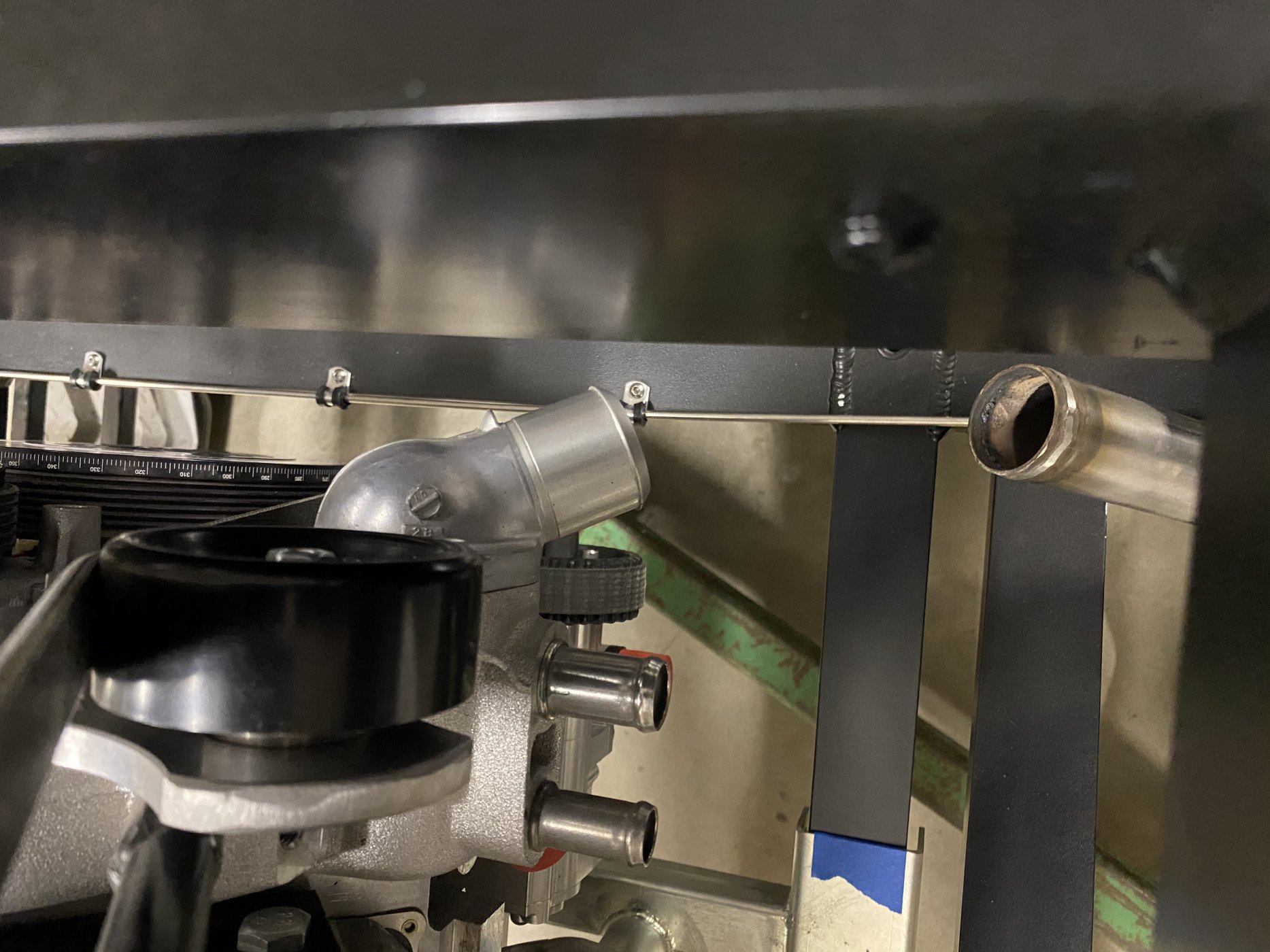

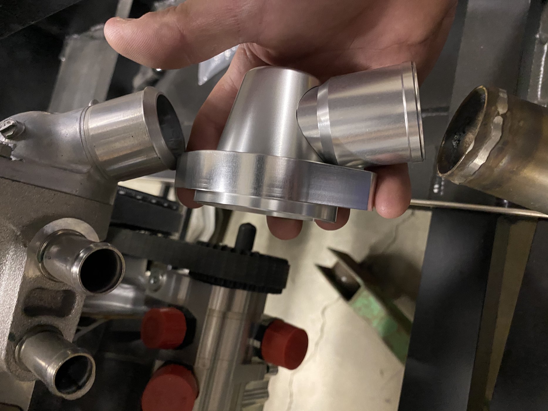

A question about this water pump thermostat housing fitting. I cannot find a low profile part that comes off at 90°. I purchased one online that has an adjustable swivel mount but it does not come off at 90° and it sticks out too far. Does anyone know where you can get one of these thermostat outlets that fit tight at 90°? Or do you have to fabricate your own?

If you look in the pictures. You can see that the aftermarket part doesn’t really offer any much space savings with regard to the thermostat outlet

good call. that fits in much tighter to the motor.
just ordered one. I also ordered a 1.5" aluminum hose nipple to weld to the swivel neck so I can get the water neck to line up to the stainless water pipe coming from the radiator

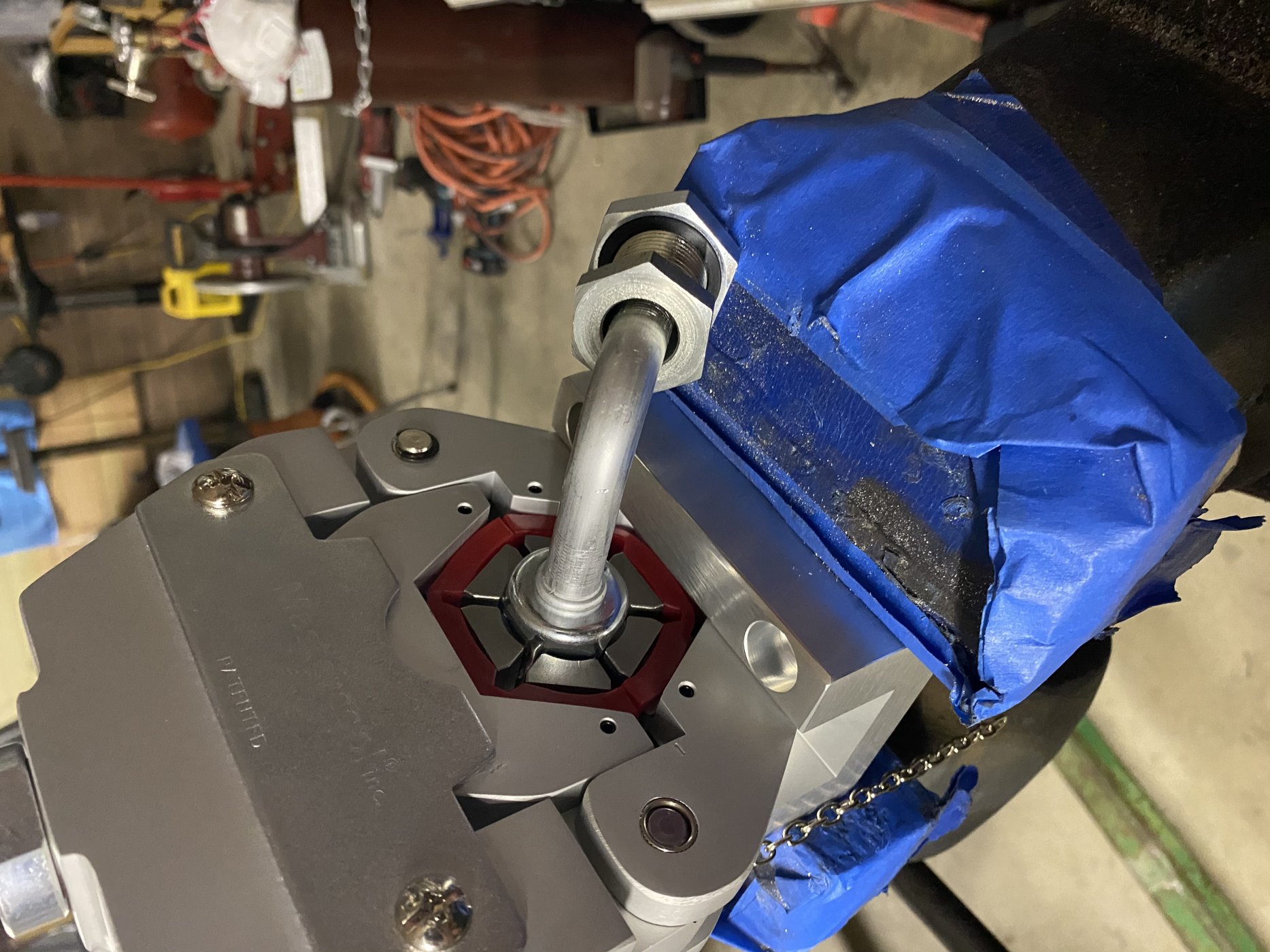

I’m really liking these crimper tools. They make the air conditioning lines easy to assemble.

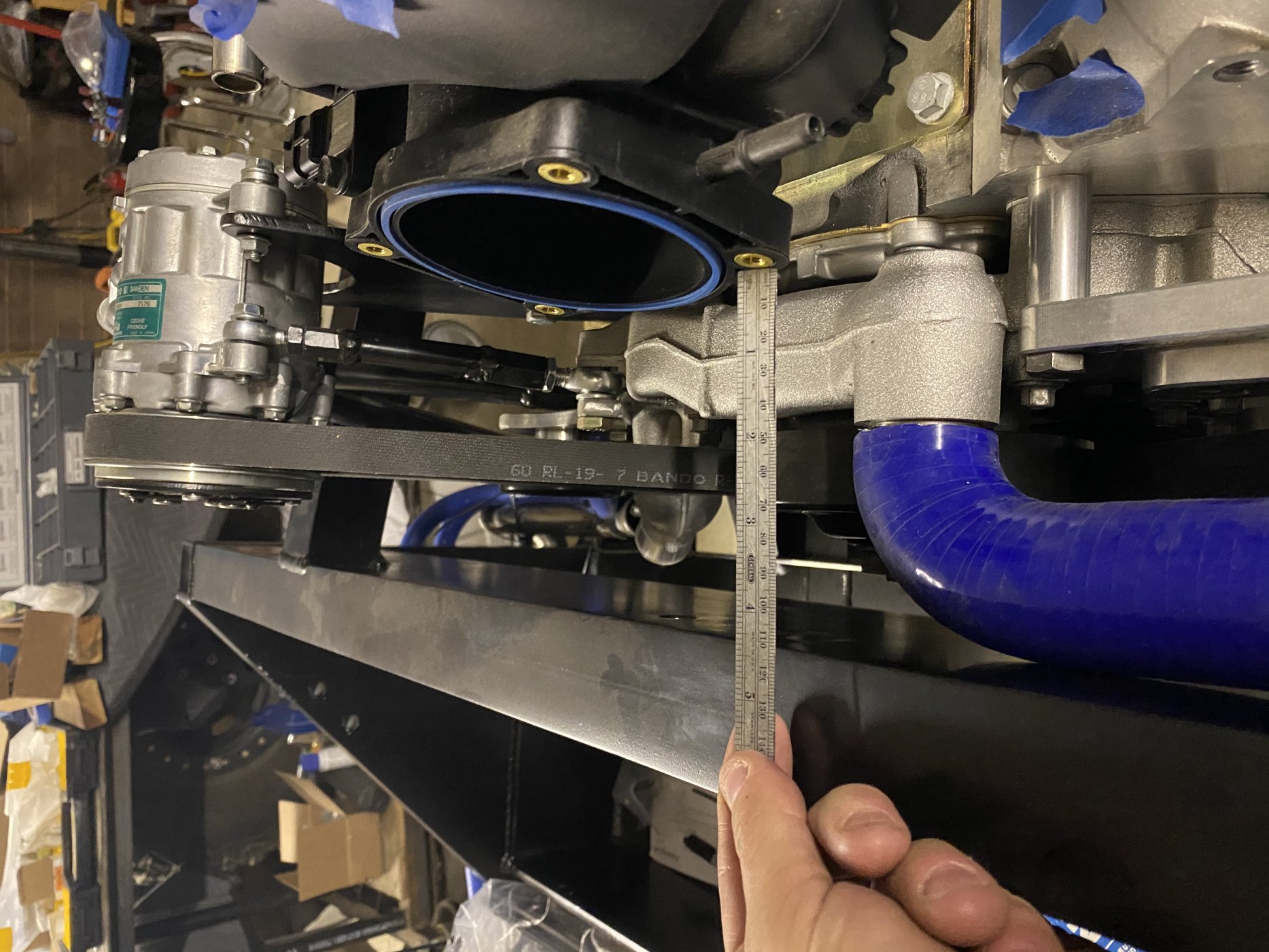

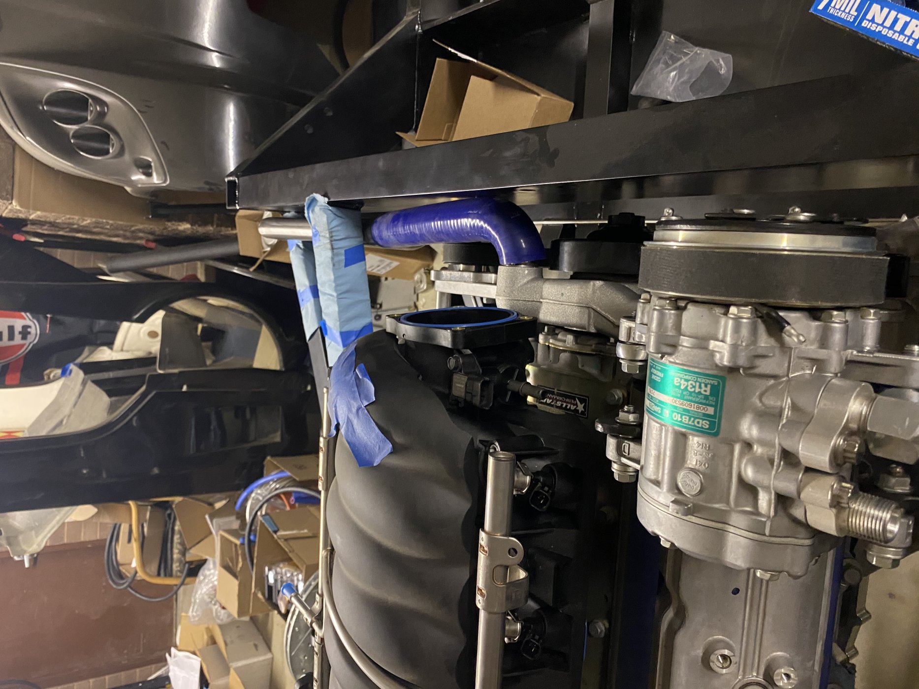

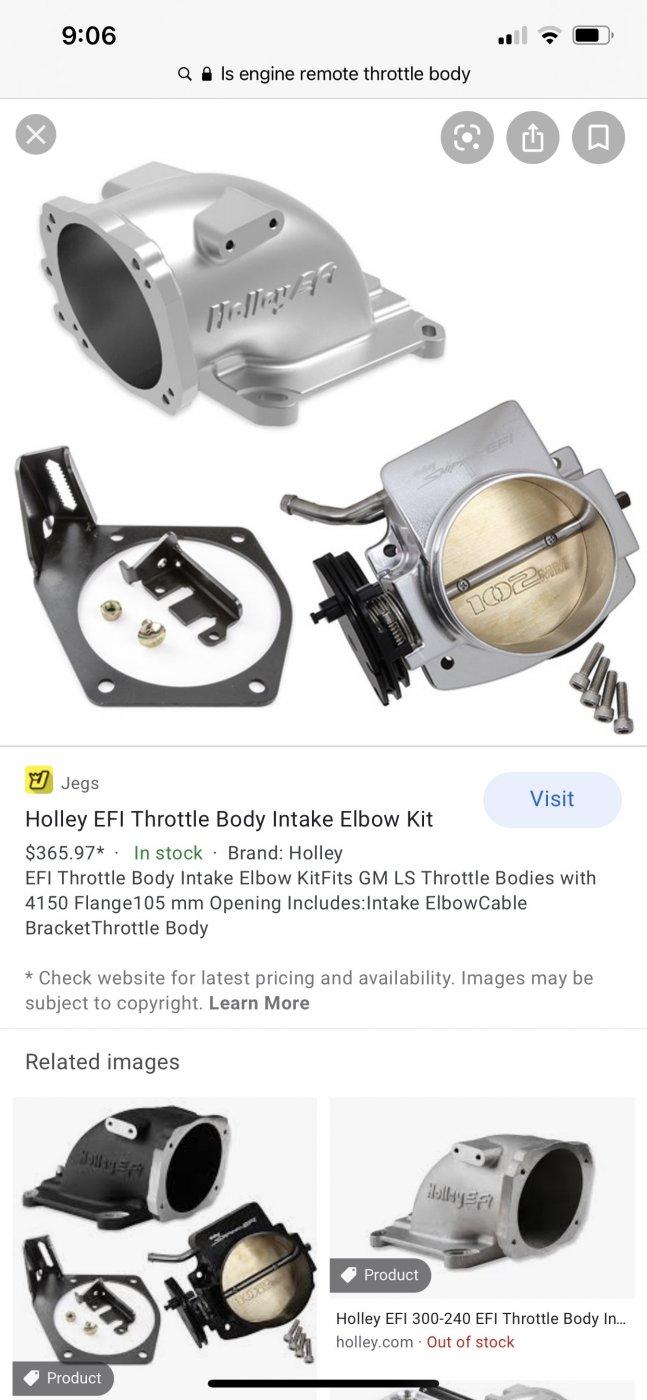

I have a problem. I’m going to be running the eight into one exhaust and so I need my air filter to be running towards the front of the car. But as shown in this picture I only have 4 inches from the inlet to the intake manifold to the bulkhead wall. The solution that I can see is to fab an elbow right at the inlet to the intake manifold and mount the throttle body remotely. There is not enough room to put the throttlebody on the intake manifold and still turn 90°
