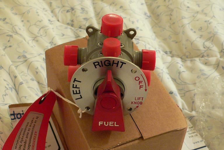

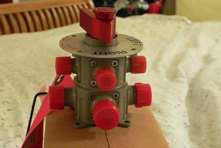

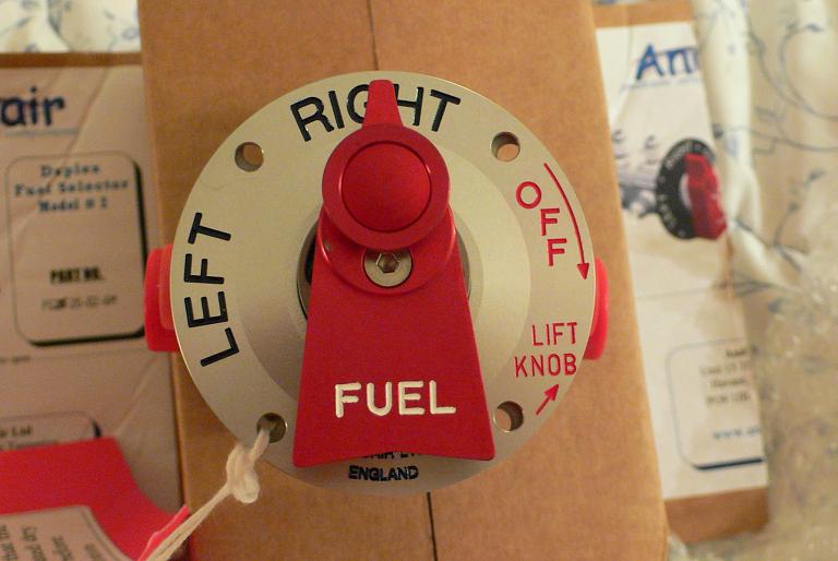

Got the Andair FS2520 fuel valve with -8 fuel and -6 returns. Very nice part. It was about £281 Shipped to the USA. Here are some shots.

That's a cool part, Sandy. Where do you intend to mount it?
Perhaps I don't understand how it operates, but it seems to me that it would have to be manually operated from the cockpit. That would require the routing a lot of fuel lines through the cockpit, which is something I'd be wary of.
Sandy
Gulf GT40
No fuel lines are in the cockpit, the valve mounts from behind the drivers bulkhead with the selector knob inside the cockpit, so all the fuel lines are in the engine bay. You would have to reach behind to flip it. It does have a locking feature that will not allow the valve to turn OFF unless the button is lifted, travel is free between the Left and Right setting.
I think one of the images of the original on the site some where shows an orig fuel valve done in a similar way.
The initial plumbing will be a feeder pump sucking through the -8 section of the valve to a swirl pot, then then returns from the swirl pot back to the -6 to tanks.
One feeder pump, one high pressure pump, both on at all times. The only issue may be 'suction' from the feeder pump, but the valve seems to have little restriction on the -8 side. Will just have to give it a try.

The andair product line looks top notch. Having just receive it, would you agree?

The Andair part is excellent, I would say a mil-spec type of part. Nicely anodized, all the bolt on fittings are staked at each of the fastners, very nice.
The informal flow test for the -8 side seems to be pretty unrestricted (Me blowing hard!). The valve would be a good candidate for motorizing, but I think you can get some other duplex valves if you go that route to save some $$. I think the other 2 motorized valves are posted early in this thread (I think) and one looked pretty good, but over $700 for it, the other was about $500 but it is pretty large.
When it really comes down to it I don't think I'll be running a tank dry in any of the events, so having the full electrical switch over is not such a big thing. Like Fran said, "just use one tank, problem solved" /ubbthreads/images/graemlins/smile.gif Of course that would be too easy. The Andair valve is a good safe compromise and if it can be mounted within short reach, perfect. For my planned plumbing I'll only have a fuel pump on/off switch not a left/off/right switch so no fuss with that when flipping tanks.
The Valve is a definite well made part!
