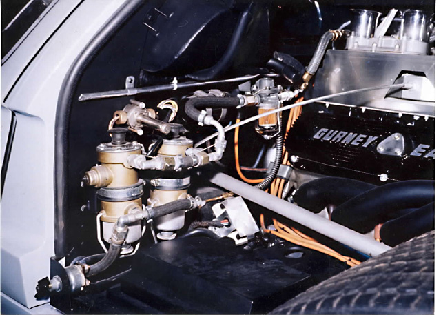

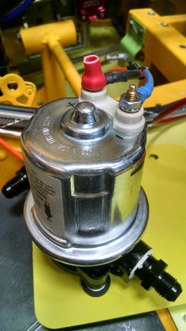

I have a pair of Facet red-tops that can deliver 7psi running through a pair of Malpassi regulator Filters at 7psi. I run both pumps when the engine needs it, and have never had a problem in 15,000 miles. Holley 670 cfm, 350 bhp 302. This works for me, the pumps are level with the fuel tanks.
David Garton

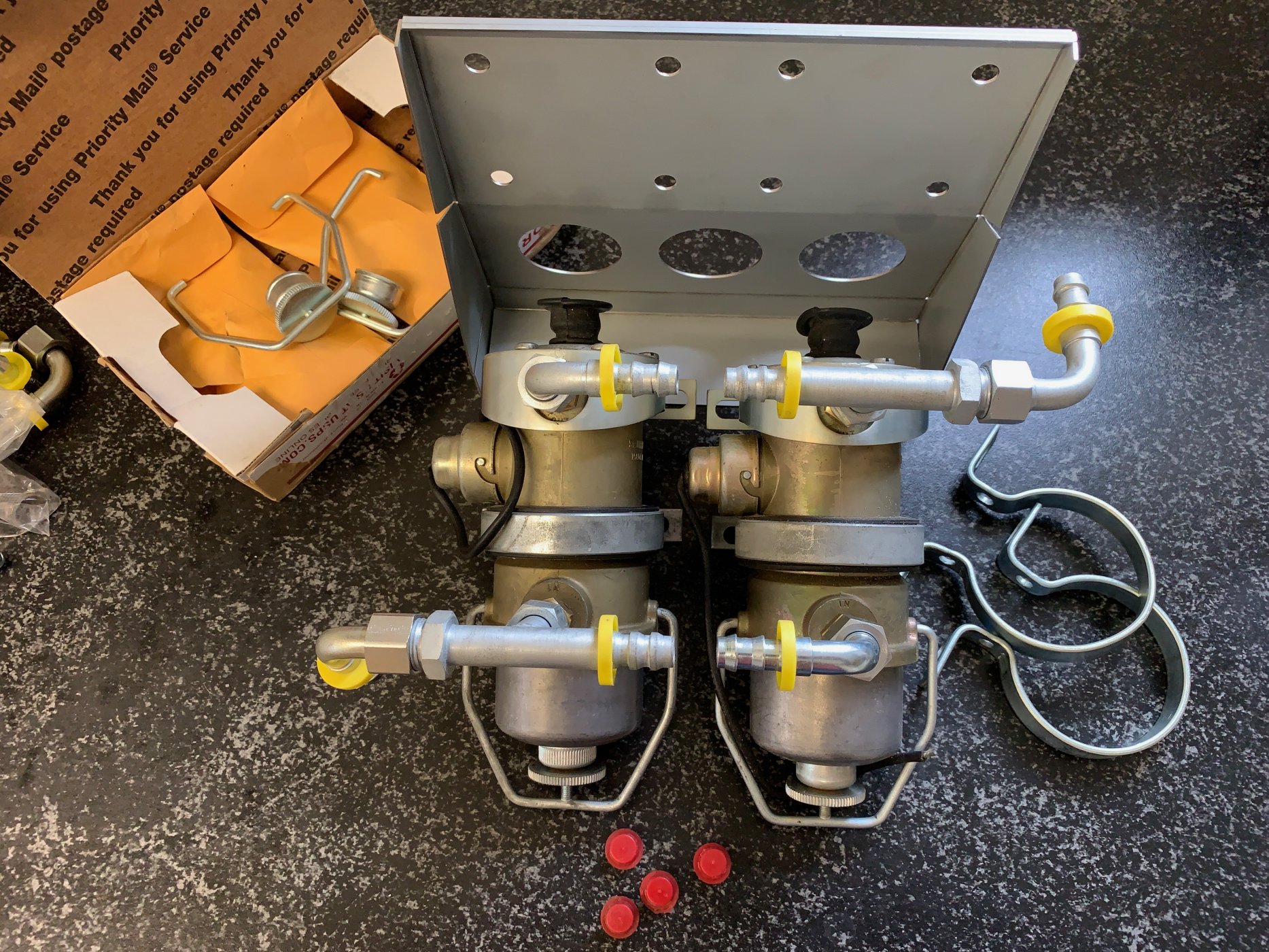

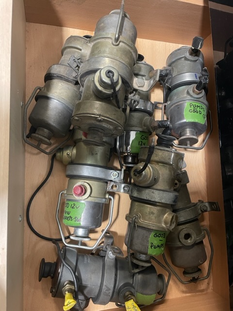

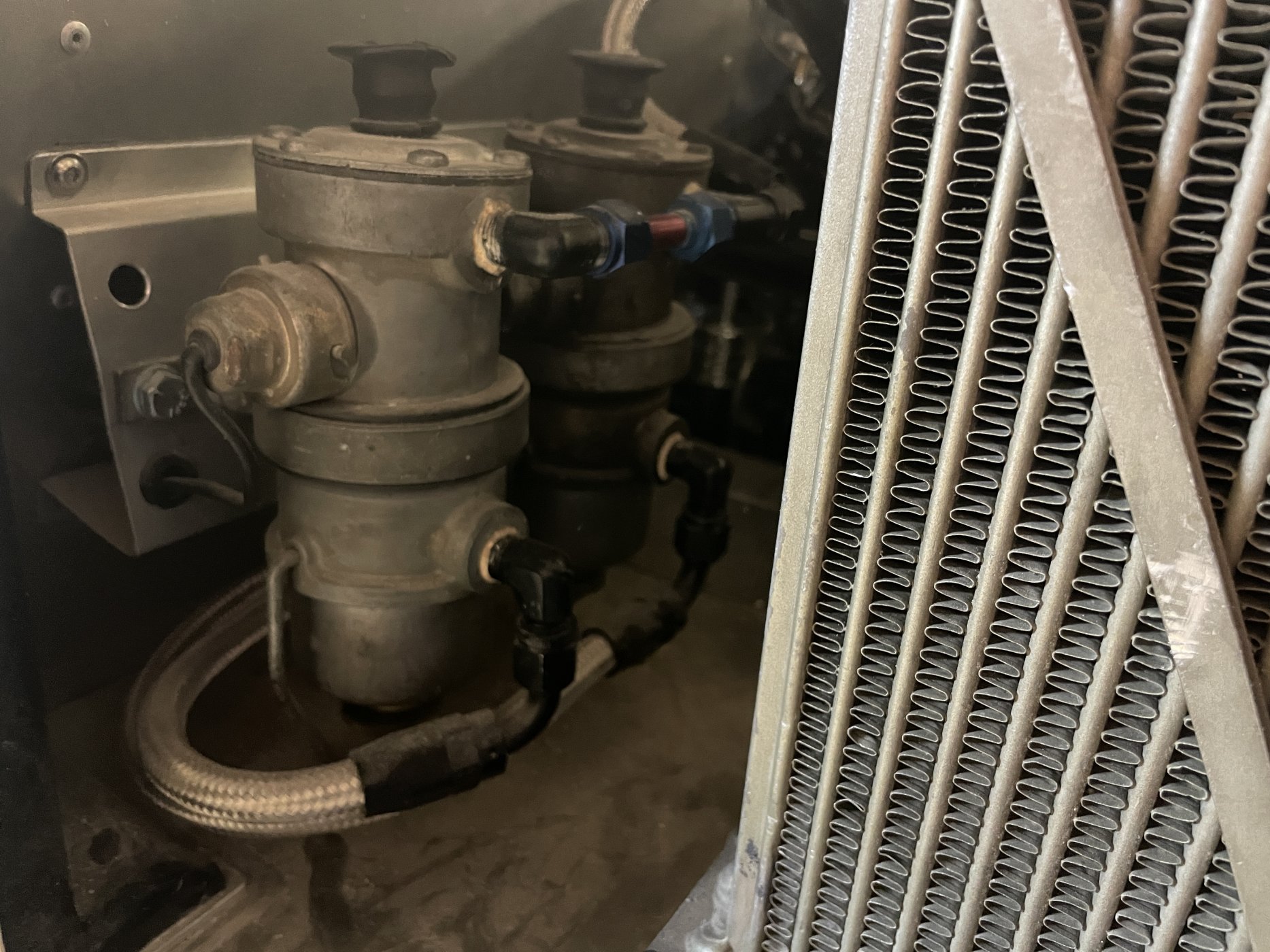

I'm using a pair of SW 240A. Not many road miles yet, but seem to keep up with a few spirited track laps. A bit hard to find, but crop on eBay now and then. Most will need refurbishing.

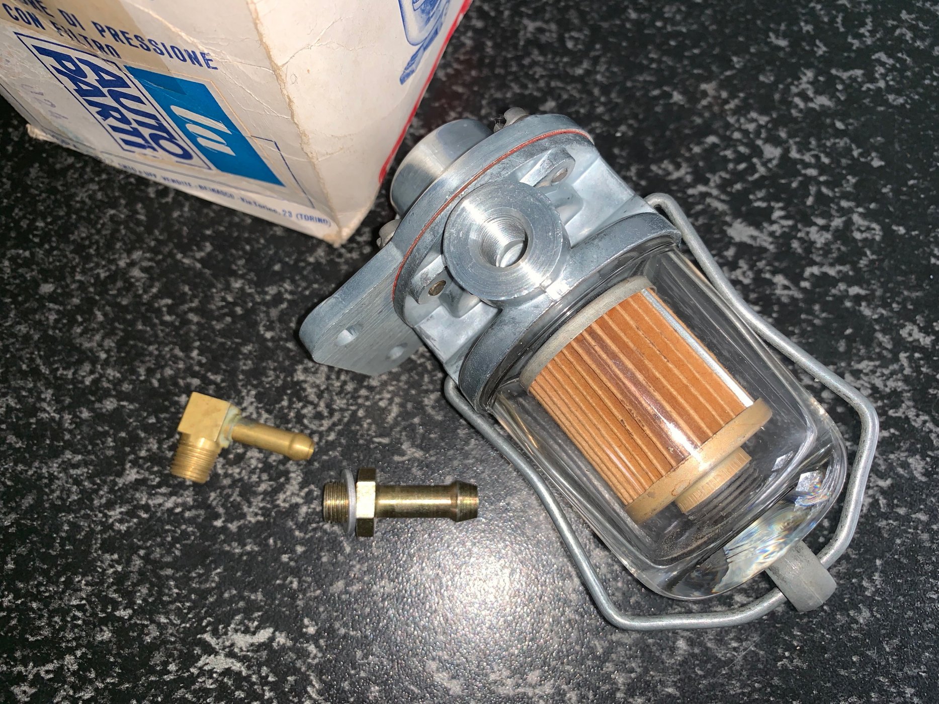

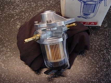

Brian, Im looking for Glass style fuel filter and regulator for my MKI build. Can you supply info on the one used in your photo? Thank you, David
Brian Stewart
Mine's a FISPA unit, as used on some old Alfas and Ferraris. Once again, they crop up occasionally on eBay or look on historic Alfa sites.
