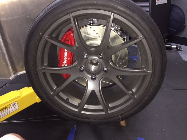

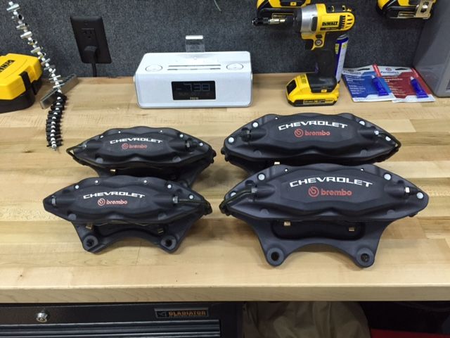

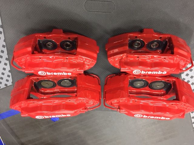

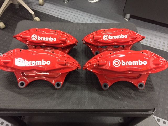

Thanks Mark they look great, is the Brembo Logo painted on afterward or some how both the base and the logo are powder coated?
The base color coat was applied and cured, the logo placed on it, then clear powder coated. It was a multi step process. I have Brembo brakes on my Ferrari and on my 911. These brake calipers look at least as good, if not better.
