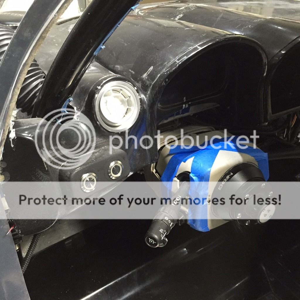

I have added my door, power, emergency flasher and overhead light switches along with the air vents on my overhead panel. This will have alcantera.
I had to pay homage to Porsche. My starter button and accusump switch are located on th left side of the dash...

I like your air vents.
I see you used vents with a pivot valve to control cabin air flow. Above the vents, did you do anything to keep water out when driving in the rain?
I have a fiberglass plenum that is integrated with the center spyder section. I have ducting (pvc) that goes vertical from the vent into the plenum. Water is going to have to make a 90 degree turn to be a real problem (I hope) :huh:
The reason I ask is that I'm thinking about adding a vent there as well.
Do you have a PIC of your plenum?
