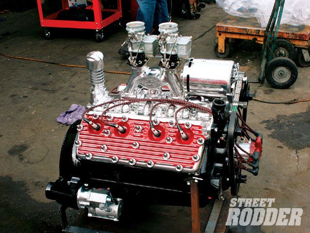

Might as well go all the way back to a flat head with Offy mainfold then :) You will never spend so much to go so slow
