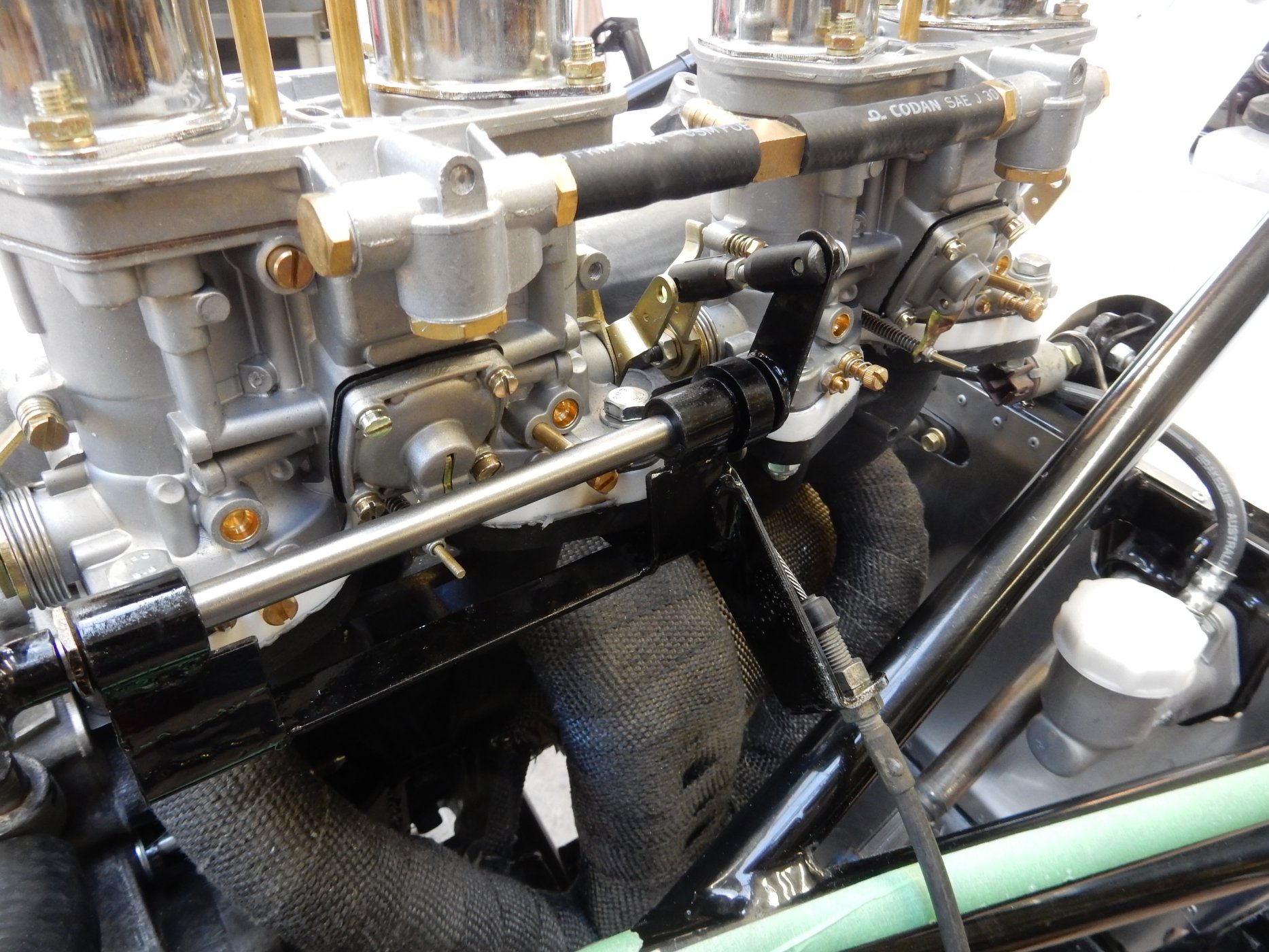

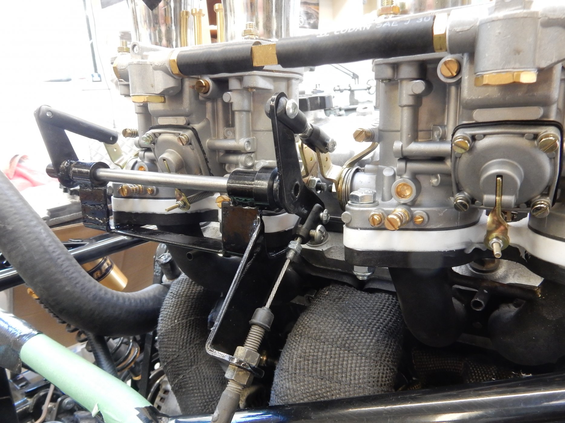

With so much time on my hands, I used almost 8 hours to design build test and paint the throttle linkage system so happy to say it works. Biggest issue is lack of materials, I used some 1/2 steel rod to make the clevis`s but need to get some plain shank cap screws for the pins. Still need to make the cable end connection more permanent, It uses a clamping screw at present.
Houston....we have ignition! AFTER sorting out no spark and tracing it back to some `expert` putting an earth on the coil, once removed I found that I had a really good spark....it`s still evident up my arm. This whole saga / project began when I saw these carbs for sale on Ebay for $125 a pair, I just had to have them. Now bear in mind that these have just come straight out of the box with no adjustment and it has fired up (on 3 cyl) easy as. I initially thought that it was just very camy until i noticed the loose lead so stopped and plugged it in. Starts good as and timing still needs to be set as just done by eye at the moment. Found the water pump seal leaks so ordered a new one. Always a good day when you have some life out of the project. Cheers
