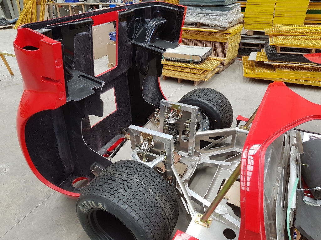

15" diameter by 15" wide hand-cut Avon slicks. Just not quite DOT approved...
