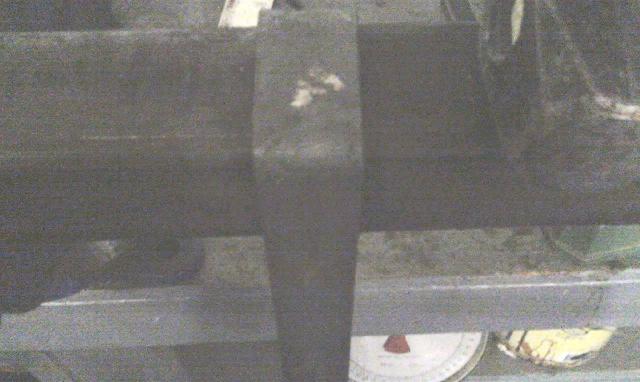

Today I was doing a little blacksmith work. I decided to make the upper control arm mounts from on single piece of 3/16" steel. I used 2 1/2" steel tube to form the bracket. Heating with a torch and bending the steel into a U shaped bracket.

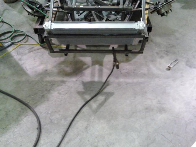

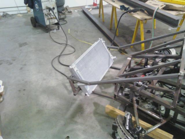

A little more progress to report. I have gotten the radiator support is welded in place.

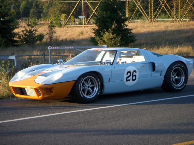

Hi Dave,

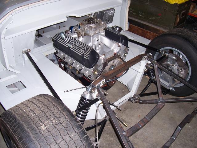

I'm here to tell you it CAN be done and there are several others on this forum as well. Keep at it one part at a time and you will have a great car to drive before to long. I miss working on mine now that it's "done" (I'm replacing the Audi box with a 930). Keep up the progress and enjoy the journey because before long it will be over and you will miss it! Have you decided what you are going to do for the rear hubs? Now that you have a mill you could machine them out of billet aluminum like I did and use Jeep Cherokee front hubs. This is what I did and it was inexpensive and very strong. If this looks like it will work for you let me know and I can give you the dimensions you will need. Rock on Dave:thumbsup:
Steve

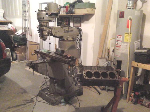

Tonight I worked a bit on my engine block. Removed the old cam and lifters. I also knocked out the frost plugs. It is ready to go in for cleaning and magnafluxing.

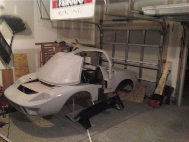

Since started the GT-40 project I have been working on it at work in our extra warehouse space. I have mainly been working on it during my lunch break and also a few weekends. Russ's completion after a five year build made me realize I need to finish sooner. ( lack of 5 years worth of dedication on my part) So I decided to bring the GT home to my garage. Tonight I brought all the body parts home
