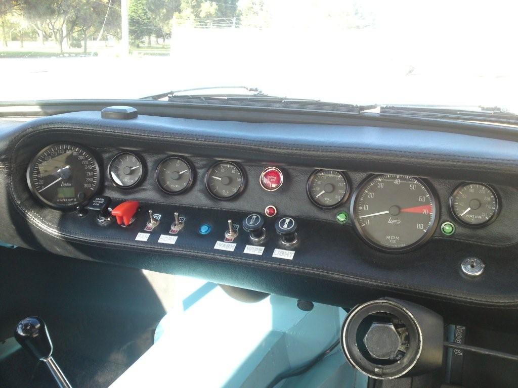

I have the Speedhut gauges and love them. I finally have good illumination at night. I can't wait for one of the Smiths/Lucas gauges to quit in my Cobra so I can dump them there also. I went with the pulse type speedometer. Your choice.
I used the full Speedhut Legacy GT40 set in my Triumph and thought they were great.
They don't work in tunnels, but it's a small price to pay. The biggest plus was not having to worry about various wheel sizes / speedometer drive gear changes or anything like that.
The speedos also have a heap of different performance testing functions (0-100kph, 1/4 mile timing, altitude, direction, etc)

Those look good.
Why type of sender is used with the fuel gauges? Float or capacitance?
How long does it take the speedo to lock on a signal from a cold start?
It used the standard Triumph Float sender from 1969.
From cold start, I'd say about 4-5 seconds until it picked up the signal.

Note in the pic above, the small black lump on the dash is the receiver. They are quite small, and actually looks bigger in the pic than in real life.
The funniest thing about my dash was that I had a 300kph speedo in a Triumph Vitesse Estate!
