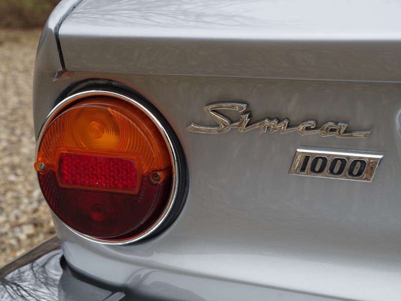

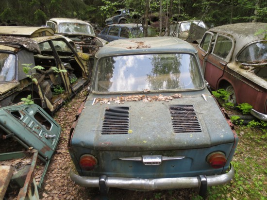

I found out the hard way years ago when I was prepping 1076 for Monterey. I backed it out of the shop and caught the wheel of the dumpster with the tail light in the parking lot. Ran all over So Cal looking for a replacement Tail Light lens for the one I just pulverized. That's when i found out where those babies came from.

What the heck is that?
I assume whatever it is, if you owned it and had backed it into the dumpster, you might have better luck finding a GT40 to pillage than the GT 40 owner who is looking for it to pillage
GT40 rear original light are from Simca 1000
They where made By SEV Marchal
Lancia Stratos rear lights are from Fiat 850
They where made by Seima
both seems to look similar but they are not ; fixing details , some dimensionsand materials on the chrome bezel vary , they can be recognized from the back with the red molding done on the lower part
Opel Manta are far from those

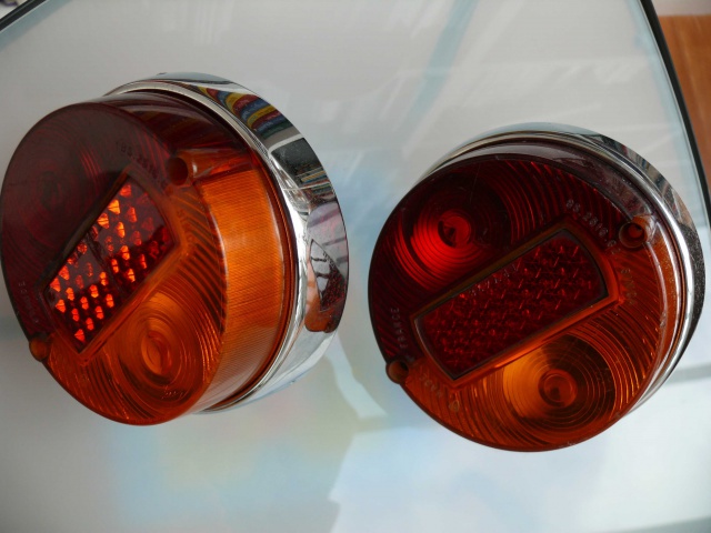

Yes, and particularly the chrome bezel on the Simca 1000 assy is kind of wedge-shaped, so that the rear face of the lens is vertical (as the body area supporting the rear light is not exactly vertical). With Fiat lenses, as their chrome bezel is a regular shaped chrome ring, the rear face of the lens is slightly tilted toward the ground. (Some Fiat units were fitted on my car when I bought it, I replaced them for simca units, huge difference when you know where to look at...)
