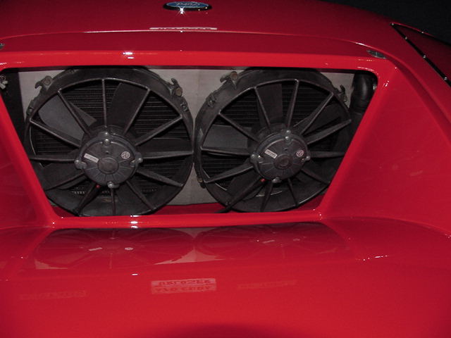

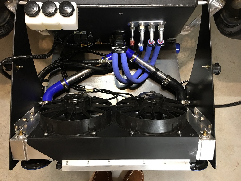

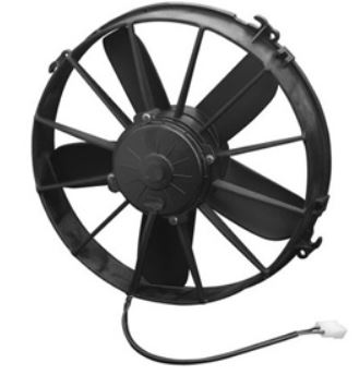

I agree Rick. These are the same fans I'm using, and cooling in S-and-G traffic has never been an issue. With that said, I've made mine where the shroud (with fans attached to shroud) can be removed in five minutes for track days. I learned the hard way to remove the fans for track days due to high-speed air forcing the fans to over-speed and self destruct. Nearly ruined a custom radiator when the blades grenaded. Anything above 25 MPH keeps the engine cool without fans. I hadn't realized air moved through a radiator that efficiently or quickly.
Neil
Would like toknow more about those fans and if they’ve ever been used to cool a radiator yet! Very interesting!
Randy;
These are TA600DC 12V 2A industrial cooling fans made by NIDEC, model A3405-29. Each fan is 6 3/4" diameter overall and weighs 21 ounces (595 g). The fans each have a 245 CFM free-flow rating but "free-flow" ratings are meaningless, what matters is the air flow rating against the backpressure of the air flowing through the radiator. Most cooling fans do not show curves for CFM vs backpressure but these fans are supplied with those curves. If I knew the pressure drop across the radiator I could know the fan's true air flow.
I originally bought a huge radiator cooling fan to use in this project but the motor turned out to be too tall to fit under the nose. These fans were a solution to my limited space problem. I think your GT40 has more room than I do for a taller fan motor.
I have not seen anyone using these industrial fans to cool a radiator.
One note- these do look a little like the fans in a computer but they are much more powerful.
Rick Merz
https://webstore.spalusa.com/en-us/...-fans/30102038/va01-ap70-ll-36a-12-p-12v.aspx
Neil, See above link for specs... Overall height is only 3.73" not too bad considering that they are very powerful for a small fan. I think that your fan setup is cool looking (because it is an original solution) and if your car is primarily a track car then it might work out well but if you need additional cooling power you might consider the Spal fans. I know that some of the Winston cup cars used them as well. They can be quick release if you use 4 bolts (as pins) and 4 springs to hold them in place, simply twist 90° and remove.
Terry, I can say that I have forgot many times to turn my fans off when at the track but I have never had a failure. I really like these fans and they will cool 600+ hp with AC on the hottest day, of course really only cooling 200 to 300 hp on the street. :)
The Spal fans that I have mounted on my RCR GT40 are a different model and are taller than the ones that my link points to
Attached is a picture of my GTD GT40 (sold it) with the Spal fans that my link points to, when you turn them on the car moves forward a little. :)

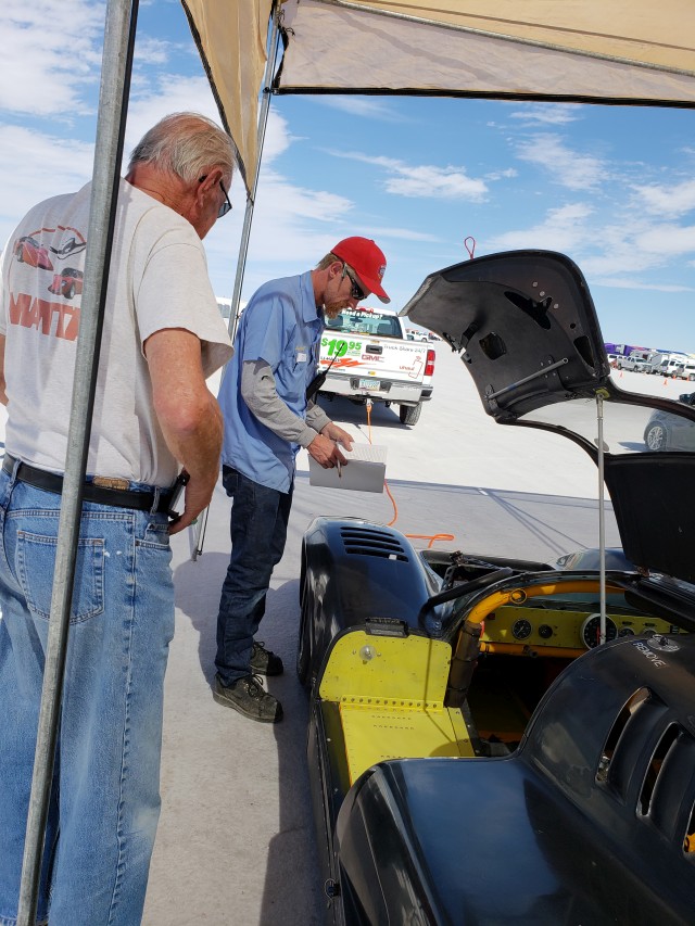

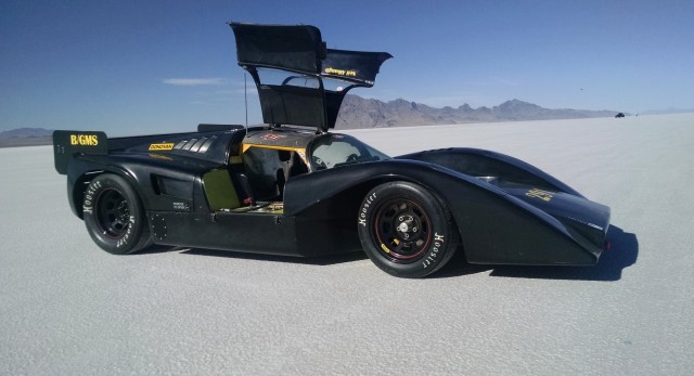

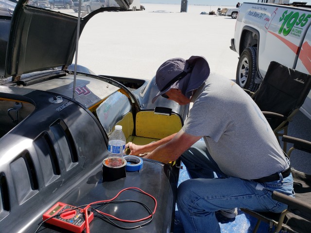

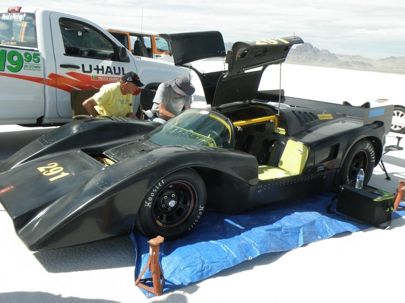

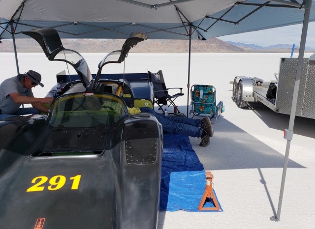

We are back home in Tucson after running in the World of Speed at Bonneville. This is a very much smaller event than Speed Week but the weather is cooler and the hotel room rates are not exorbitant. We had a problem with a bad diesel fuel leak on our tow truck on the way and had to leave it with a Dodge dealer in Henderson (Las Vegas) to fix. To continue, we rented a pickup from U-Haul and transferred all our gear and the trailer to that. In tech inspection, they wanted me to isolate the fuel cell filler cap from the cockpit and vent the fuel cell overboard. Fortunately, a fellow wearing a yellow “Team Vesco” tee-shirt stopped by our pit and wanted to help. He borrowed some aviation tin snips and a hose from Rick Vesco and, with the Ace Hardware sheet metal (three flattened stove pipes), we passed tech inspection.

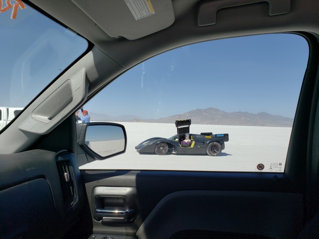

Joline towed me around to the staging lane for the short course and after a wait I was able to run. Embarrassingly, I promptly stalled the engine. Re-started it and ran through first gear, shifted into second, and at about 5,000 rpm the engine started misfiring badly so I turned off the course. Whatever the problem was it wasn’t going to be solved until we returned home so we packed up and left Monday morning. I posted a video on YouTube that pretty much says it all:
The engine really didn’t sound quite right from the beginning. I’m going to see if maybe I have a fuel filter blockage since it felt like a fuel problem... I’ll see what a teardown reveals.

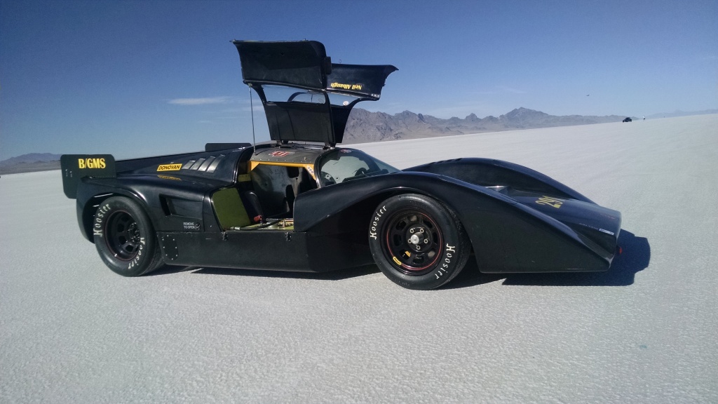

I ran my car at the World Of Speed event at Bonneville in September. After getting through tech inspection I ran on the short course but hurt the engine so that was disappointing but at least I did get to drive a car that I built by myself on the "Hallowed Ground" of Bonneville. I'm getting ready to tear down the engine to see what it looks like internally. One thing I found was that a 100u fuel filter ahead of my electric fuel pump is not 100u, it is 10u! That, together with the 4200 ft altitude was causing fuel starvation.

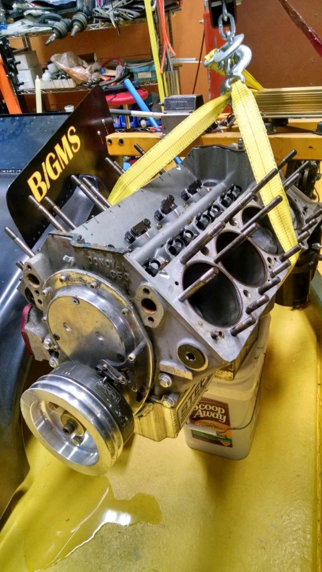

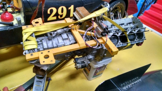

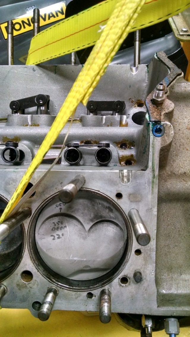

I hurt the engine at Bonneville and there is now an unhealthy sound when I crank it over. Time to see what is the problem.
I finished pulling the engine and transaxle out of the chassis this afternoon. Now to unbolt the transaxle and set the engine on an engine stand, drain the oil, rotate it upside down (after removing the lifters), pull off the pan and look inside. Any bets as to what I'll find?
