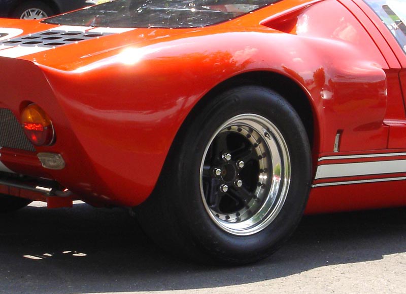

My experience with the very same tires (since I now own Andy's car...) has so far only been on the street. I can confirm that they are crap for street use as they only get hot enough when you smoke them—which is surprisingly easy. I have Pirelli P-Zeros on my Pantera and they offer a MUCH more satisfying street performance (although are not available in 15 inch sizes we all want and need).
One nice thing about the TDs is that the odd sizing looks great on the GT40. They (rears anyway) are slightly wider and lower profile than the Dunlop 295-50-15's I have on my Campys.
I was trying to decide what I will replace the TD's with after I melt what's left of them. Might need two sets of wheels to make things work properly.
