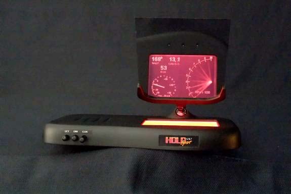

Anybody know what is meant by Tombstone display?
Hello -
The 'Tombstone' option refers to the angled piece of glass or plastic (or similar) that the image is projected onto.
Normally set at say 45 degrees to horizontal, you see the reflection of the image produced on this, looking through it to the view outside. The HUDs (heads up displays) I worked on were all of this type.
Without the 'Tombstone', the image can be projected onto the car screen altough I suspect image quality may suffer, even with special screen film applied.
You may not think it very traditional in a 40, but if you could blast round a circuit with paddle air shift and hud for warnings etc - I suspect I your mind could focus better on line, braking points etc etc - still seems fun to me! so horses for courses - each to their own, etc etc.
I have been sent a photo of the Tombstone display. It is a little screen that stands on a base. I will email anyone the photo if they are capable of posting it on the web as I do not have a website.

Here's the Pix of the display mentioned above by Knighton

Thanks for posting the pic Ben.
The manufacturer said the base is actually half this size. The Tombstone is a mini windshield if you will, for use in RVs and boats where the windshield is a good distance from the driver.
