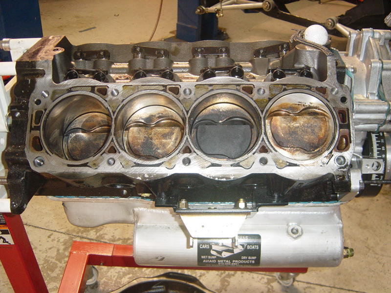

It has been a long winter... After the engine was all back together I took the car outside to idle and warm it up and within 5 minutes another rocker arm was broken... apparently there was a larger issue and something beyond my skill set.
Recognizing that I am better with a checkbook than a spanner, the car was shipped to the very capable hands of the Olthoff crew. I sent along a set of requests including to have the motor fixed. Overall I am very excited about what I believe the results will be. The car is still being finished up and I will share all the gory details when it is home, but here is a quick summary:
- Car was not perfect when I got it (they never are)
- As referenced above, my fixes may have caused more harm than good. We all get an education, I had individuals who I thought were capable helping me, unfortunately it appears we made some bad decisions
- I will lose about 1500 RPM off the top end as I went for a cam setup that would not require such high maintenance nor would be as hard on the parts (each of the valve stems were mushroomed)

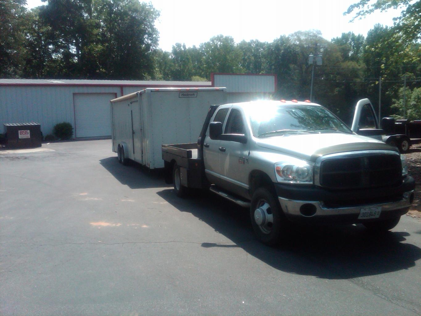

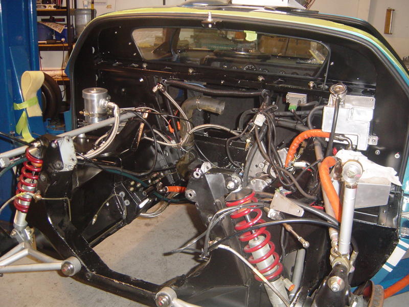

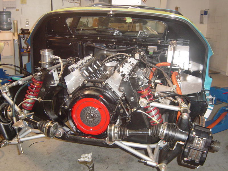

The car came home this morning after a 34 hour driving marathon from Chicago IL to NC and back. We made it to Olthoff's shop about 10AM yesterday where Dennis proceeded to describe in great detail all the findings. The engine turned into a bigger issue than initially thought due to the way the heads had been machined to support the high tension springs for the aggressive roller cam. As a result, we needed custom springs and a variety of other tweaks to the heads. The other large issue was the wiring, it had burned out many parts and required quite a bit of troubleshooting to identify the multiple issues. It would appear the original shop may have not understood the intricacies of the GT40 when it was built. In summary, is close to the total list of what was repaired/replaced/adjusted:
- New camshaft
- New roller rockers
- New springs and pushrods
- Resurface valves and cut seats (prior cam shaft pounded down the valve stems)
- Replace burned out rheostats (all three were burned out due to improper wiring)
- Replace incorrect clutch bushing (clutch would not engaging fully)
- Repair cooling fan wiring
- Rewire MSD box (it was not wired to the battery)
- Replace washer bottle and pump (pump was also burned out)
- Relocate water lines (they were running over the engine)
- Re-plumb heater connection (water lines were reversed through heater core)
- Install fender liners, center caps, carpet, and window hinge kit
- Repair engine wiring including the alternator wiring
- Adjustment of all body panels
- Plug chassis holes with foam to reduce heat transfer
- Adjust alignment and ride height,
- Test Drive (this is the single item I helped with)
As a result of the new cam, the RPM dropped from 8K to 6.2K but the torque curve also fell and now comes on strong at 1800. The power is still far too much for me, 493HP at the wheels and net I think the engine only lost 20-30 HP on the top end. At the end of the day, the car is finally operable and very enjoyable. While nothing looks different on the outside, it is a very different car on the inside. I don’t think losing the RPM is a big deal at all, factored in with the reduced maintenance I am very excited about the end result.
Dennis and team treated me very well and were always upfront with any issues they found. The end price for what was essentially a total rebuild was more than fair. I highly recommend Dennis and team, they helped me out of a jam by which usage of individual repair shops (engine, body, electrical, etc) would have been a much more drawn out process. As indication in the level of detail they used on the car, two clear stickers were placed where the gas cap cover would impact the body to protect the paint. I thought this was a great touch.

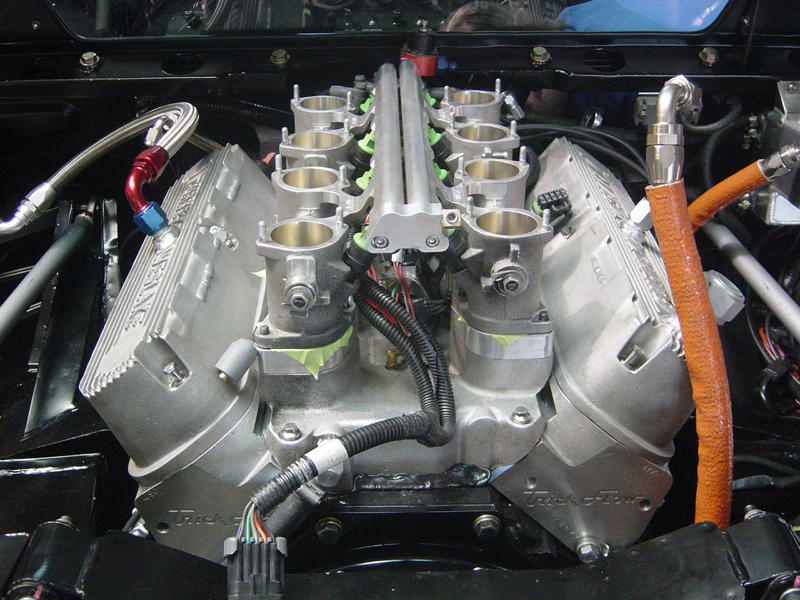

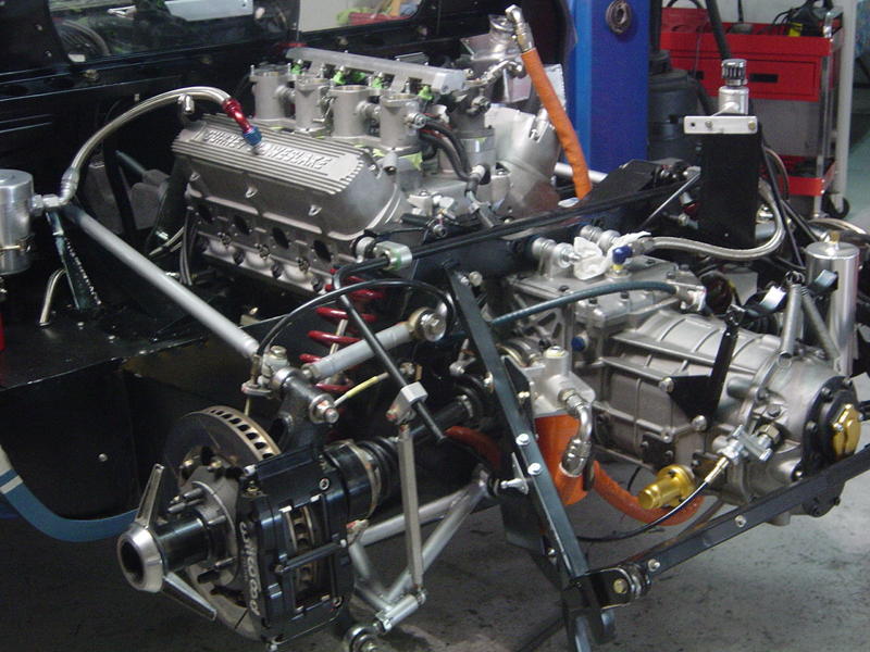

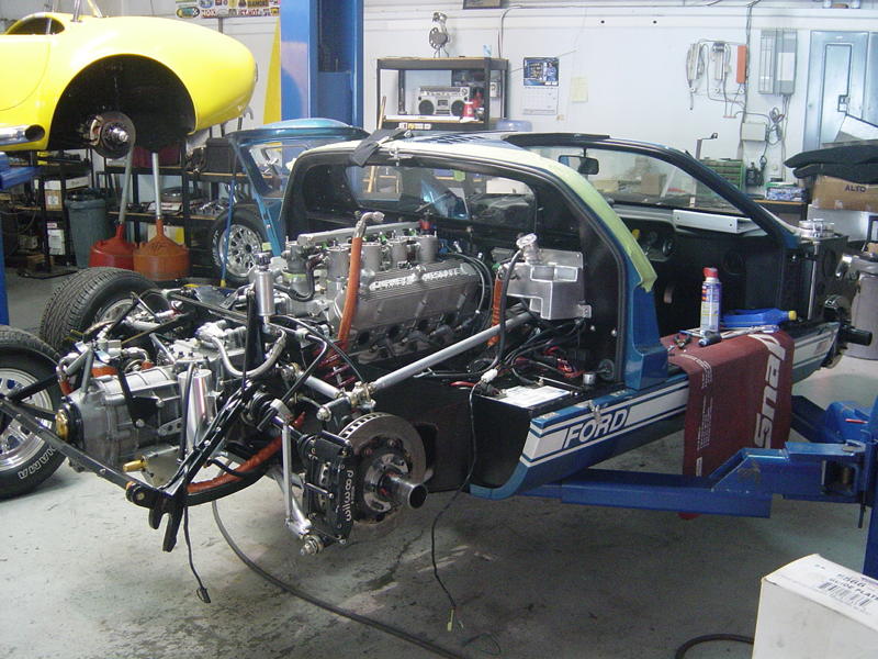

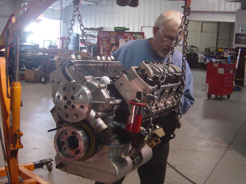

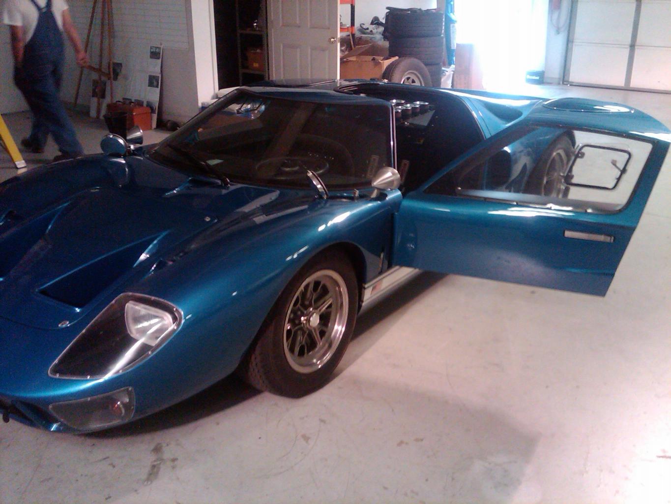

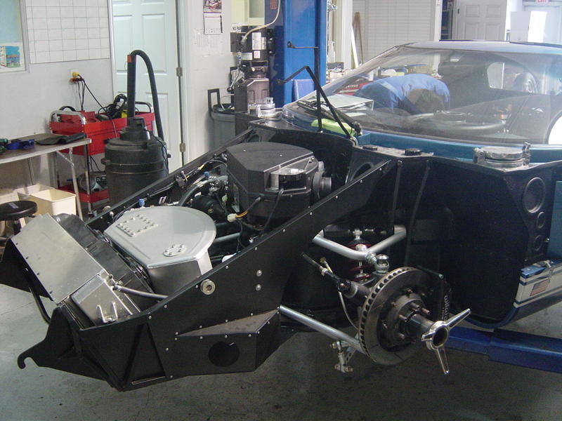

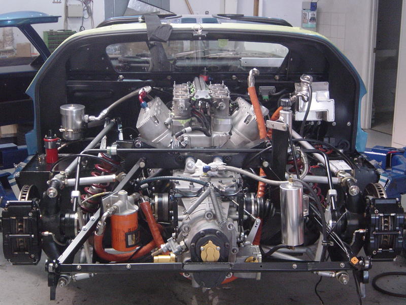

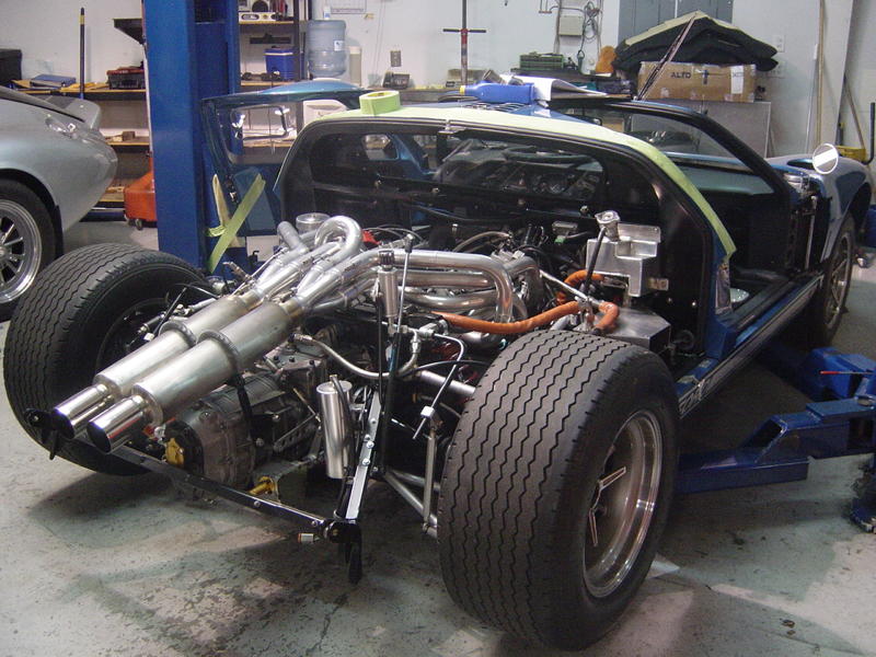

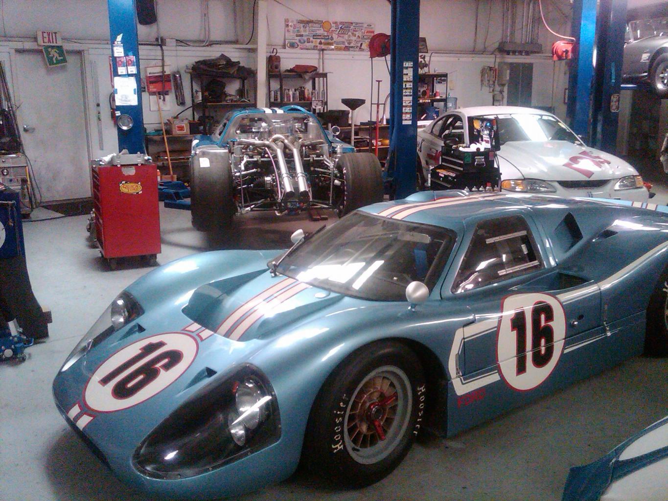

Finally, I was able to wander around Dennis’ shop. I forgot my camera so I only had the cell phone to take pictures with, as a result I only have three. The first one is the truck trailer combo we took, then two very nice looking MK4’s that were being prepped for vintage racing, and finally my car sitting ready. Aligned to a different thread, I did talk with Dennis about a fix for the three reservoirs that sit up under the front shell (this i being discussed in a different thread). He indicated that a solution is not yet complete yet but they are working on something.

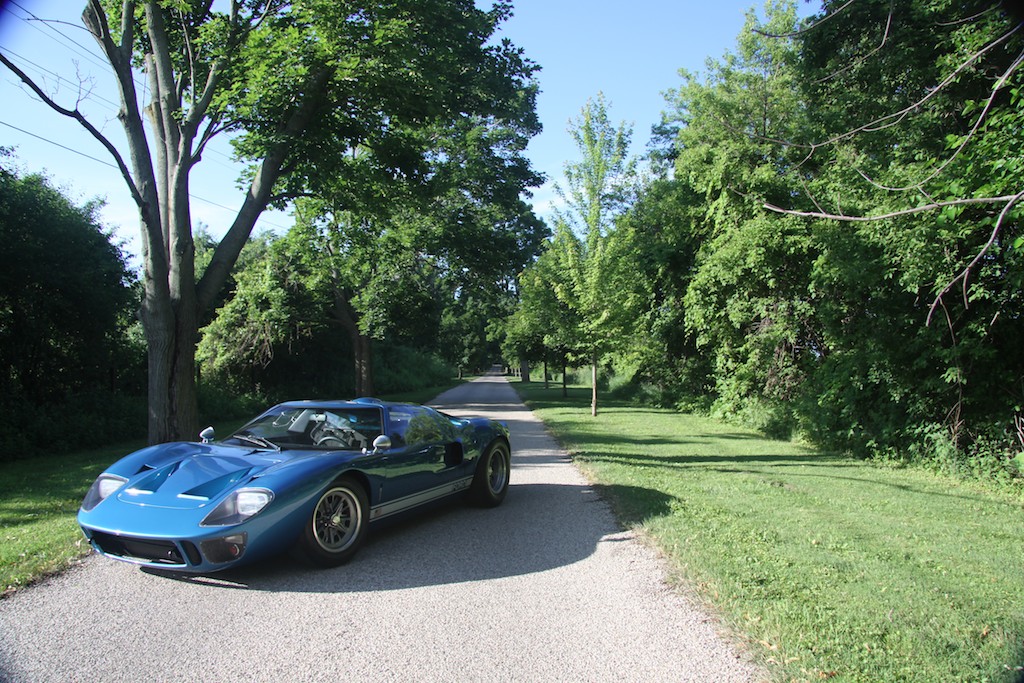

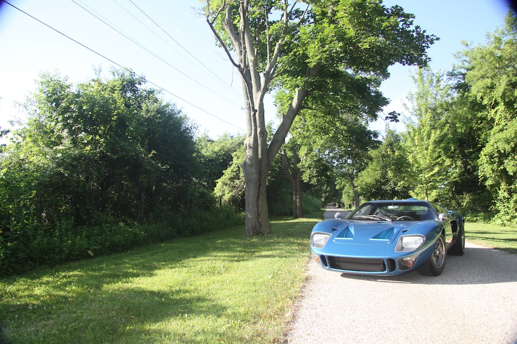

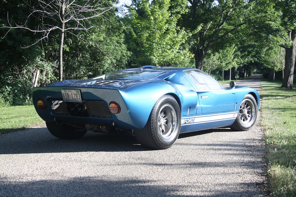

Small update, car has been trouble free since this summer. Have put about 1500 miles on it and it brings smiles to me, all that see it, and most of those that ride in it (if they aren't screaming).
Looking forward to another month or two of driving before she goes up on jack stands for the winter for some upgrades. I am looking forward to spending a bit of time wrenching on it while things slow down after Summer.
