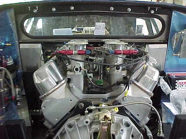

Don't forget Kinsler too.. /ubbthreads/images/graemlins/grin.gif

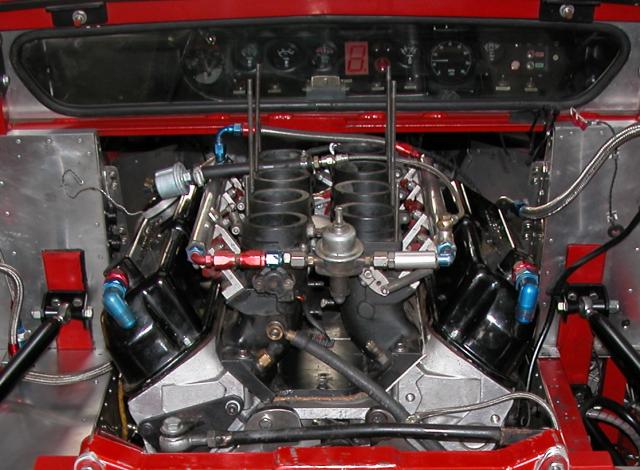

I'd have to agree with Jasper, Jenvey make some bloody great throttle bodies. Check it.. ouch! Nice.... /ubbthreads/images/graemlins/grin.gif
