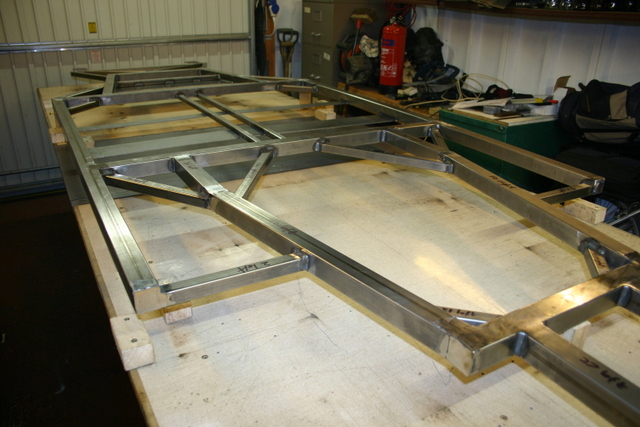

Lathes are great, I spent nearly 4 days straight machining up all the spacers and bushes I needed for my car.
I'm about half way through setting out the lower chassis rails. It's great fun putting all the pieces together - like building a giant Lego set :).

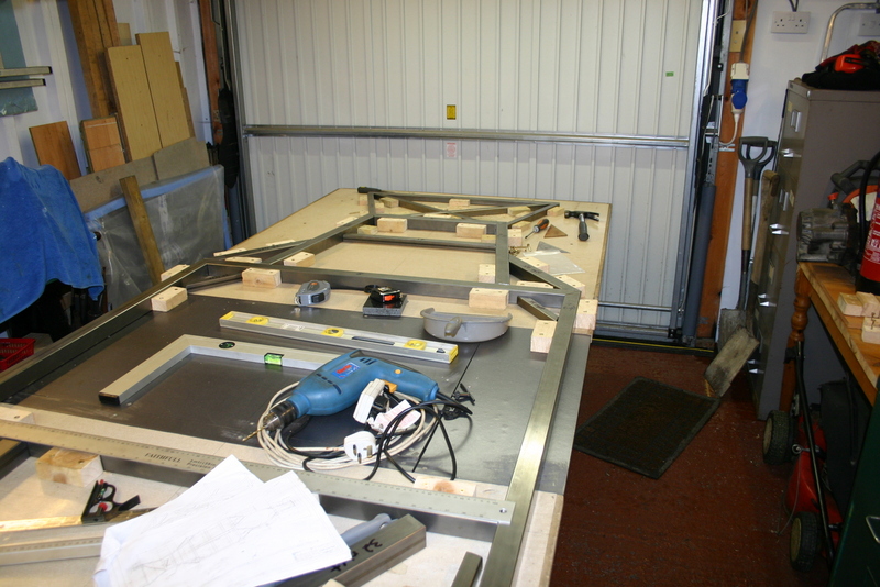

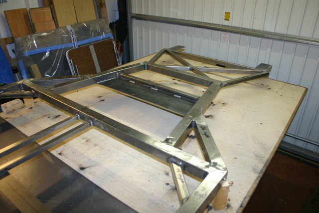

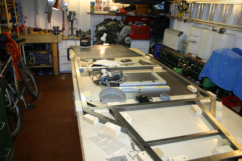

Hi Michel - I'll be MIG welding it.

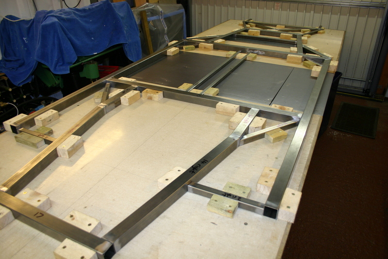

All the lower chassis rails are now in place. I've just spend the evening cleaning all the ends / joints up ready for welding.
The blocks will obviously hold everything in position laterally and I'll put additional clamps down to stop any vertical movement when tack welding each area.

Nice prep !
I did same wood blocks to weld my 908 chassis using laser cut tube and i noticed that after tackwelding no move at all so it's asimpe and very efective system
Only thing I did is once the base was tackwelded form upside , carefully I puul it off and tried to tacweld as much as possible down side to be sure that when welding others step floor tubes will not bend .
Keep on your good work !!
Hi Jem. The plans were from GTS. Darren's now doing a chassis pack which includes all the rails pre-cut with notches / holes so that the chassis can be 'slotted' together ready for welding up, which looks pretty cool. Yep, engine is an Audi 4.2 - got it sitting in my garage ready for stripping down and re-building.

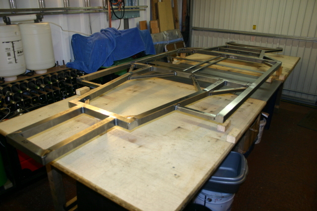

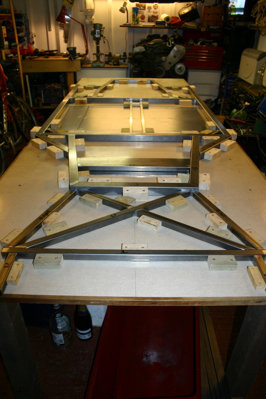

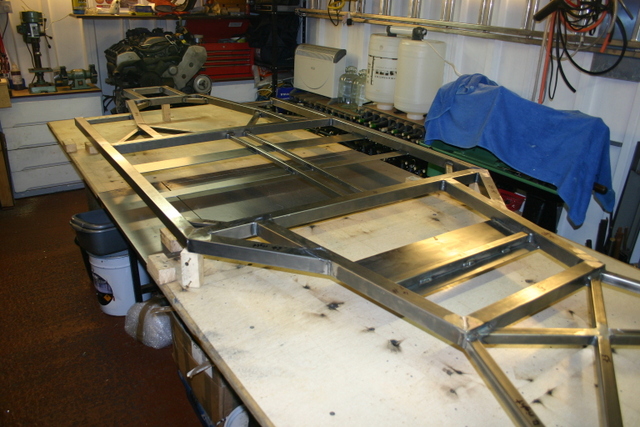

Thanks Michel. I've got it all welded up now. Really pleased with how little distortion there was. It's quite a bit of work setting all the blocks up, but worth it when you take them out and the rails stay where you wanted them! I'll dress the welds next and then add a couple more pieces (flat strips under seats and engine bay cross bracing) then that'll be the lower section all done :).
Hi
Finished the lower chassis section now. Think I'll have a beer or two tonight to celebrate :).
Very neat and nice work !!
Now start's the real pleasant work to do ; welding tubes perpandicularly to a newhorizontal step so the baby will take some volume!!! LOL
Keep on this good work ; congrats
Cheers guys. Bit more 2d work to go first though... I can make the middle rails in one section on the build table separately, then join the lower and middle sections with vertical / triangulation pieces. Then I'll be able to sit 'in' it! Ha :)
