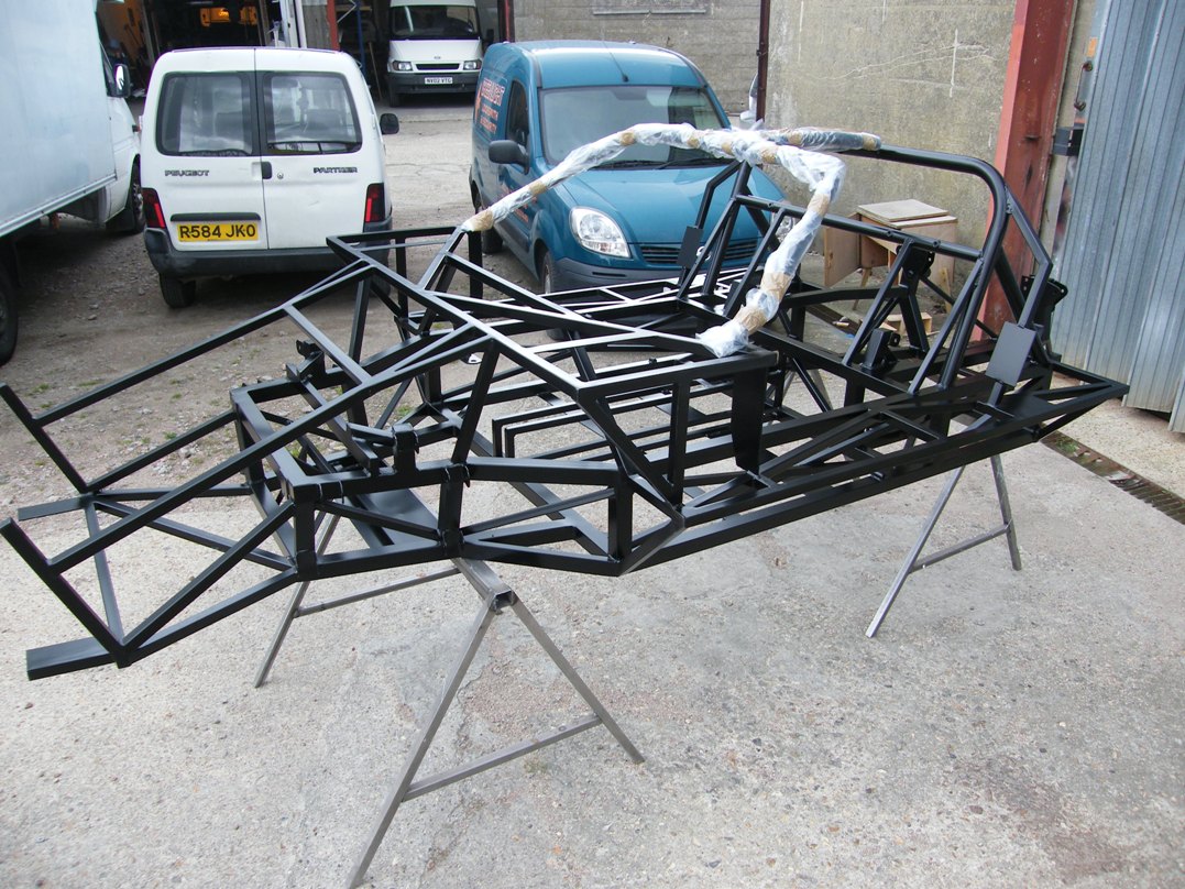

I asked Darren about the GTS chassis. The GTS chassis was developed with more triangulation than the GTD chassis and if you arange the tubes correctly you can pass the loads throughout the chassis and share the load across a lot more material. ie it's not how much material you have that counts, but how you use it. Plus the GTD was probably a bit heavier than it needed to be.

I can see the many extra 25mm tubes, in fact the chassis is different from so many out there.
Darren has kept the basic shape, which of course you have too but changed considerably its structure.
That should keep Tornado off his back... OPPS Sorry
I would be interested to know the chassis weight as in the picture and if the extra tubing adds weight and rigidity.

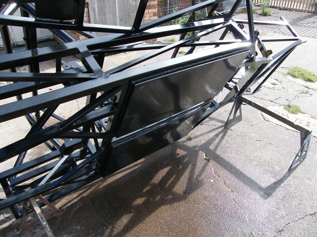

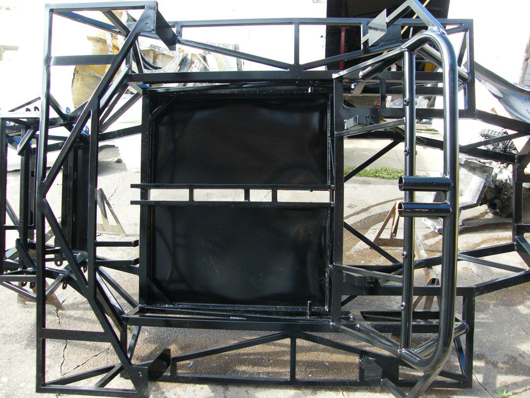

I don't think the extra tubing was to keep anyone at bay as it was to correct some deficiencies found though simulations (side note, he posted an analysis of a lower A arm that showed where it was weak and why their design differed). I also know the thing meets specs for racing some circuits in the UK so that is probably part of it as well.
I'll have one of the chassis in hand by mid December (scheduled to be picked up by the shipper this week I think). Once it's in I'll weigh it and post what I find.
To me, 50-75 pounds is not too much to add for a stronger chassis and I doubt it it adds that much.
Here are a couple shots of mine with a lowered seating area from above and below. Doesn't show the full chassis but it does show the detail a bit better.

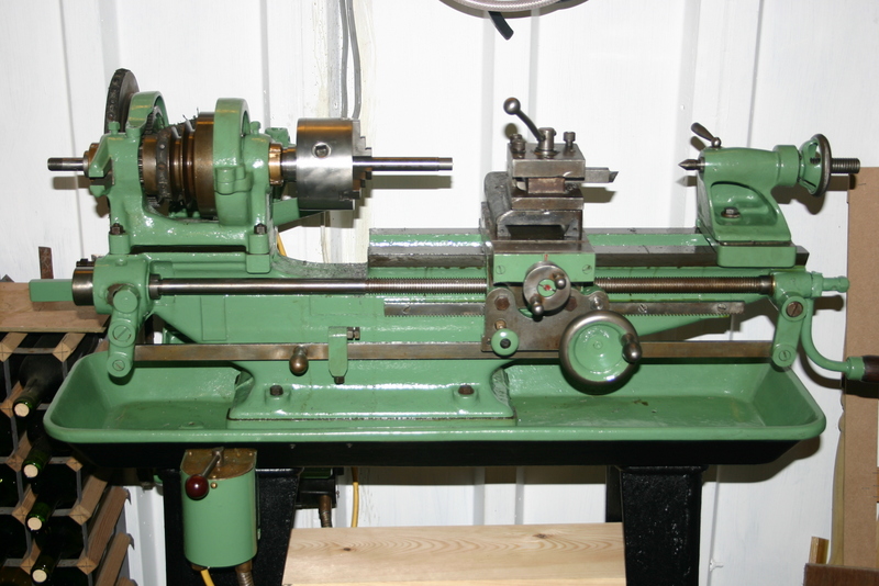

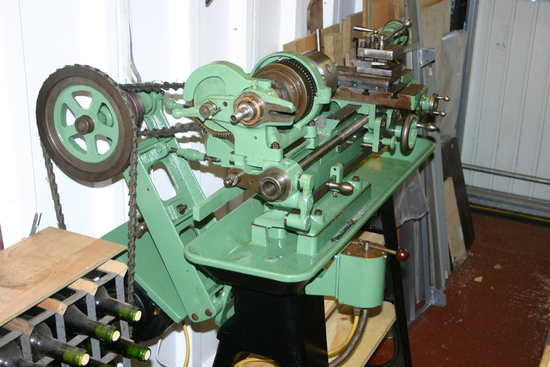

I've got the lathe all sorted now - stripped, cleaned and painted. I've done a few test pieces and think it's working well.
Nice job on the lathe rebuild / cleanup. Nothing beats being able to turn your own little round bits when needed. Looks like you have a good stock of vino to enjoy while turing those bits out. I would be afraid of breaking the bottles with them that close to the machinery... Regards, Bill
