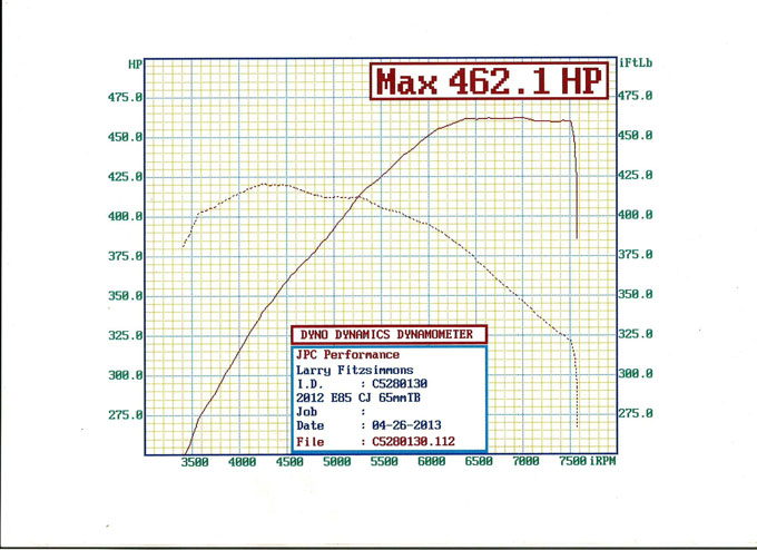

Here is a reference for a stock Boss with the Ford Racing Cobra Jet intake. My guess is that you will see even better numbers from the InnoV8 setup at around the same RPM range once it's all said and done.
Note that I did notice your collector venturi seemed a bit small for the calculations I ran. I'm running 1-7/8" primaries (I think the same as yours) but my collector has a venturi neck down to 2.75" going back out to 3-3/8". Yours appears smaller than that. If you don't get the numbers you want, that's the first place I would look unless it's just the camera angle making it look smaller?
