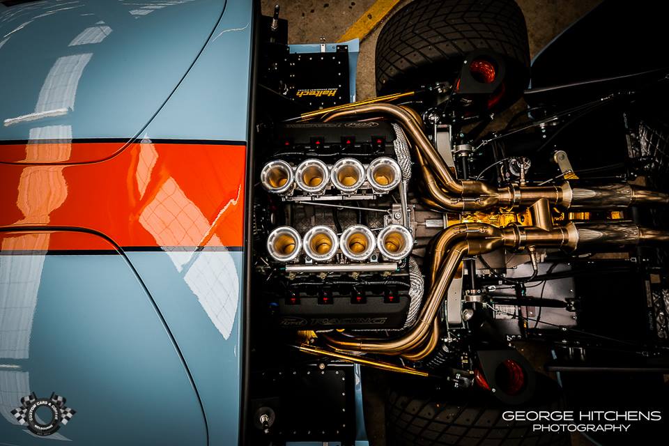

It's clear your attention to detail is righteous. Why no cross over on the headers? How does it sound? Could you fit 16s on the front? Why no side windows?
Hi mike, 16's will require small brakes, the cross over costs too much in performance, primary's will be to long. It sounds really good without it, I cannot wait to share the videos. Side windows are not fitted as it's Australia and hot and I have not charged up the A/C. The side windows do look good though. Driving with open windows is great you hear so much!

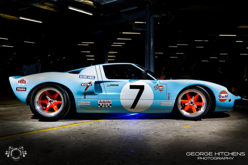

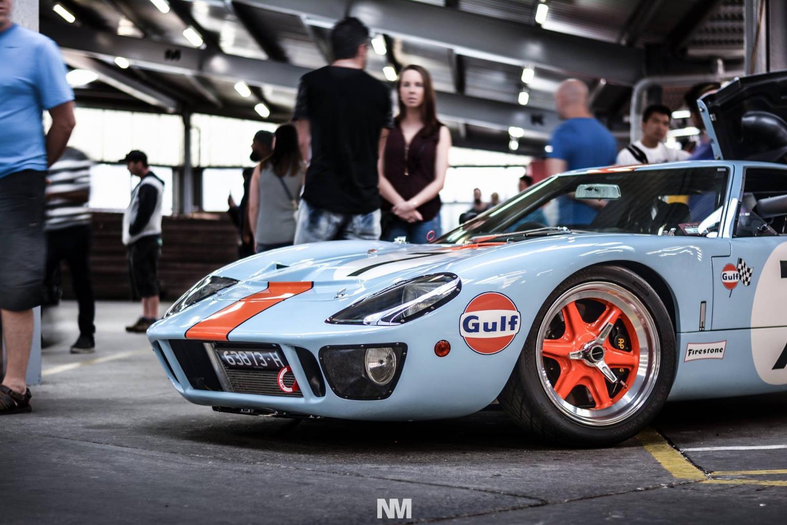

Guys keep building these cars. A good GT40 or similar cars on this forum are really popular at car meets. Kids especially think they are so cool. A short video of one I went to a few nights ago and also a few of the images taken for free! There is some real photography talent at these places.
