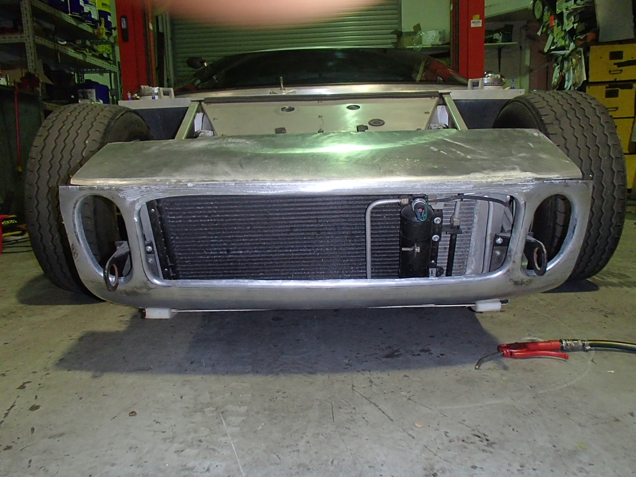

I finished up on Friday so I disappeared for 4 days straight into the shop and locked it up so it looked like I was gone.

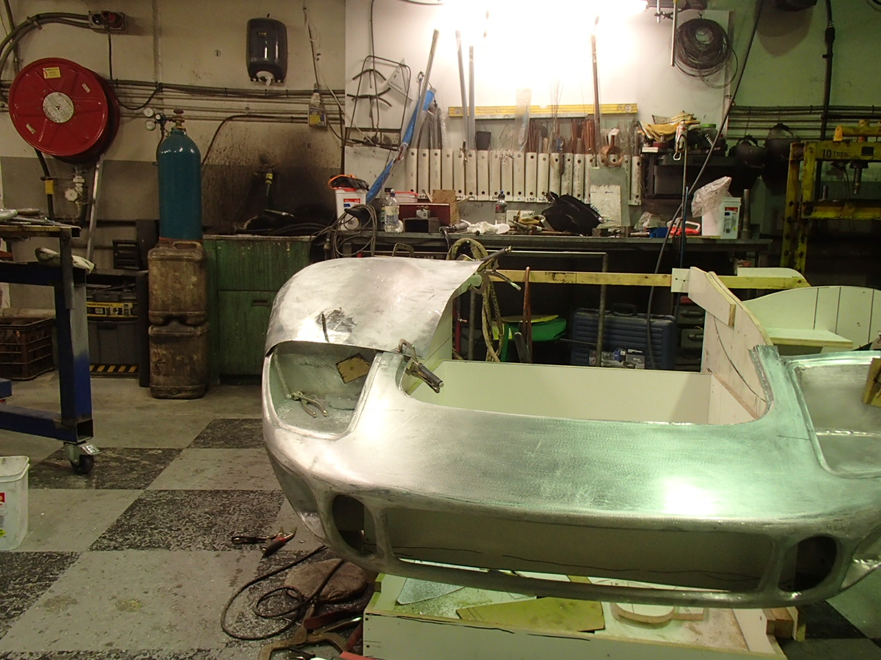

I made some inroads into the front section, it has taken more than 4 days to get to this point ,I dont keep count but maybe 8.

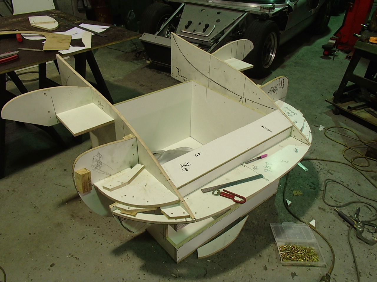

I was not going to make a buck for the front section to mount the panels to but I wasnt to far into it and realized I needed one.
I have some basic profiling tools that I use to get the shapes.
I only use one side of the car then mirror it to the other side.
I use a laser to get heights and datums of the car then check that against the model/buck.
I put in detail areas that are important into the buck and use the car as a reference also.

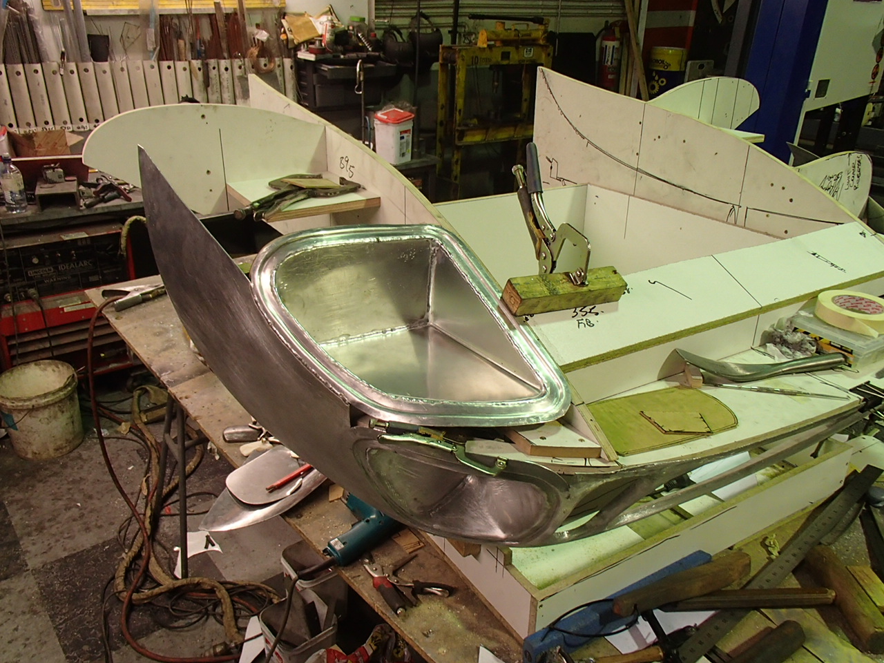

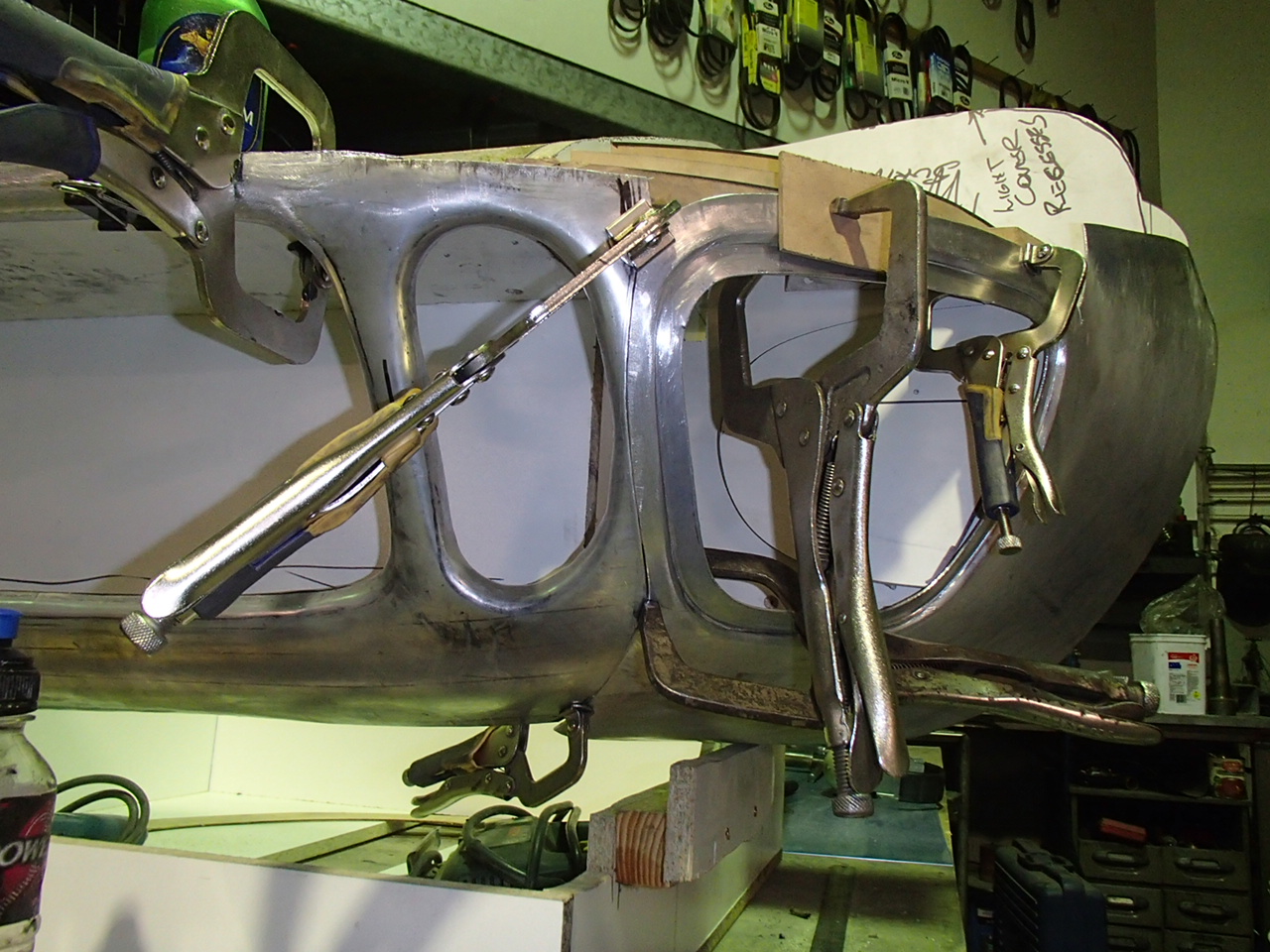

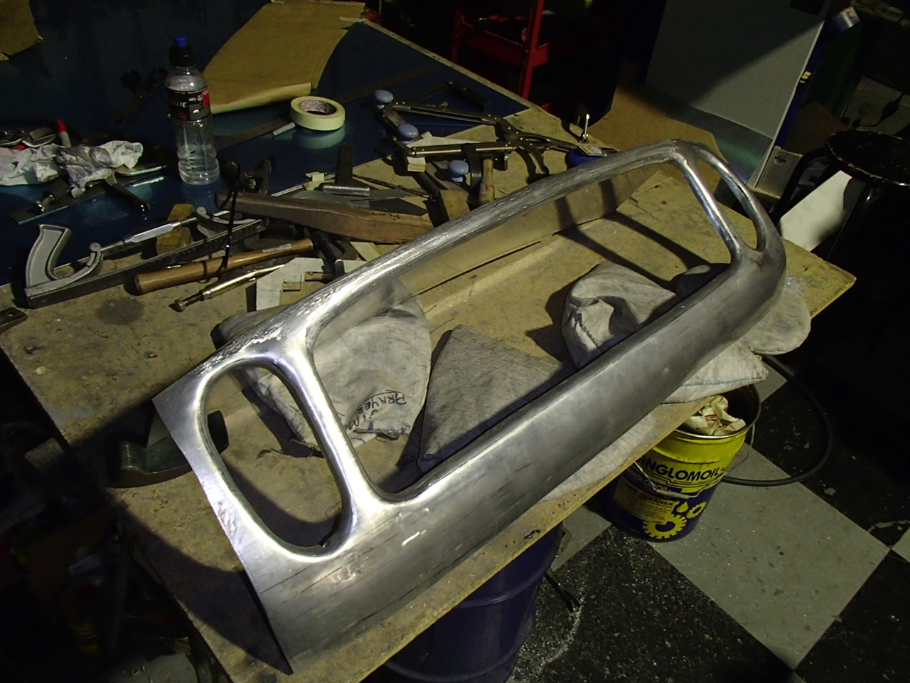

The first piece I made was the grill area and the panel running back to the pop out hood/bonnet.
I cut the top panel off as it was the wrong approach.
I decided to get the lower section together first then move over the top.
The next parts made where the lower guards/fenders at the front, This is where I use the fiberglass body as a guide to get shapes.

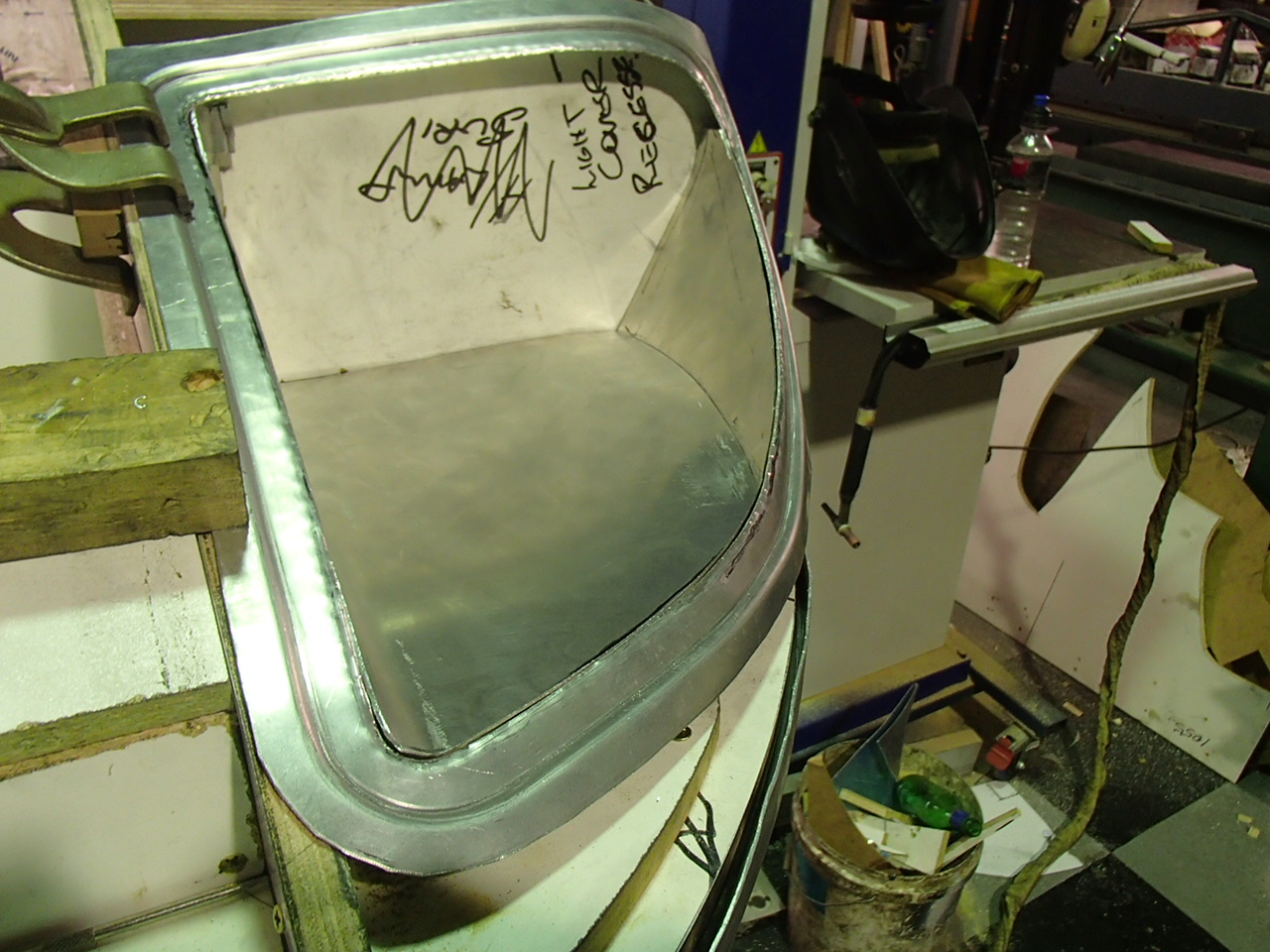

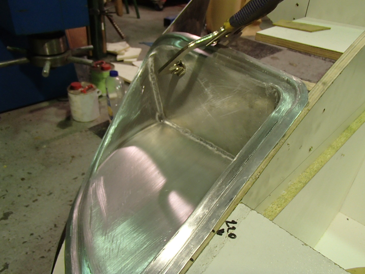

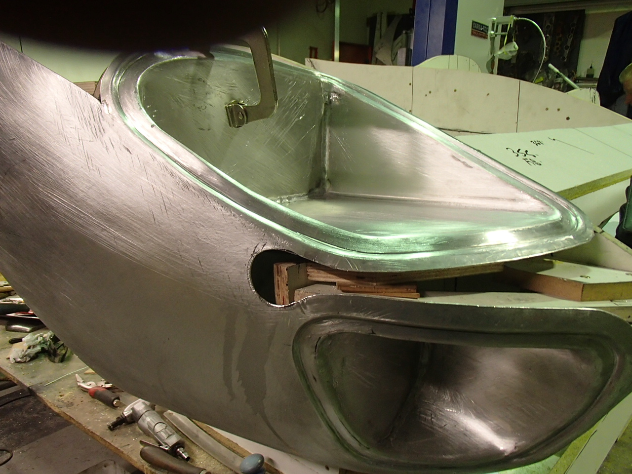

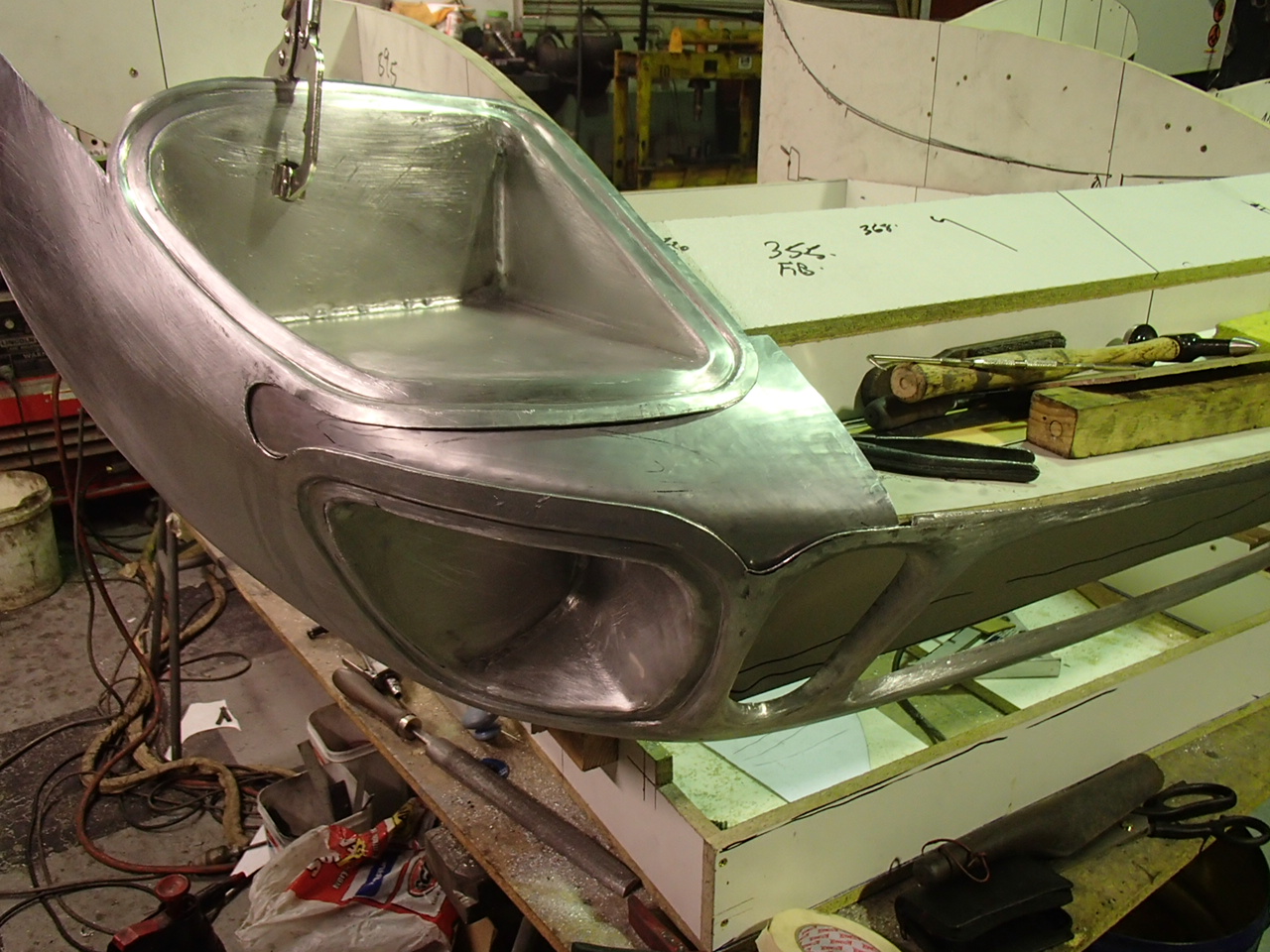

The next parts are the lower lamp assembly as this links the grill and lower guard.
I make the surround for the lamp cover as a separate part.
I made some dies for the bead roller to get the correct depth.
I make the frame with a flange and I make this fit into the other panel.
Its welded in and file finished to tidy it up.

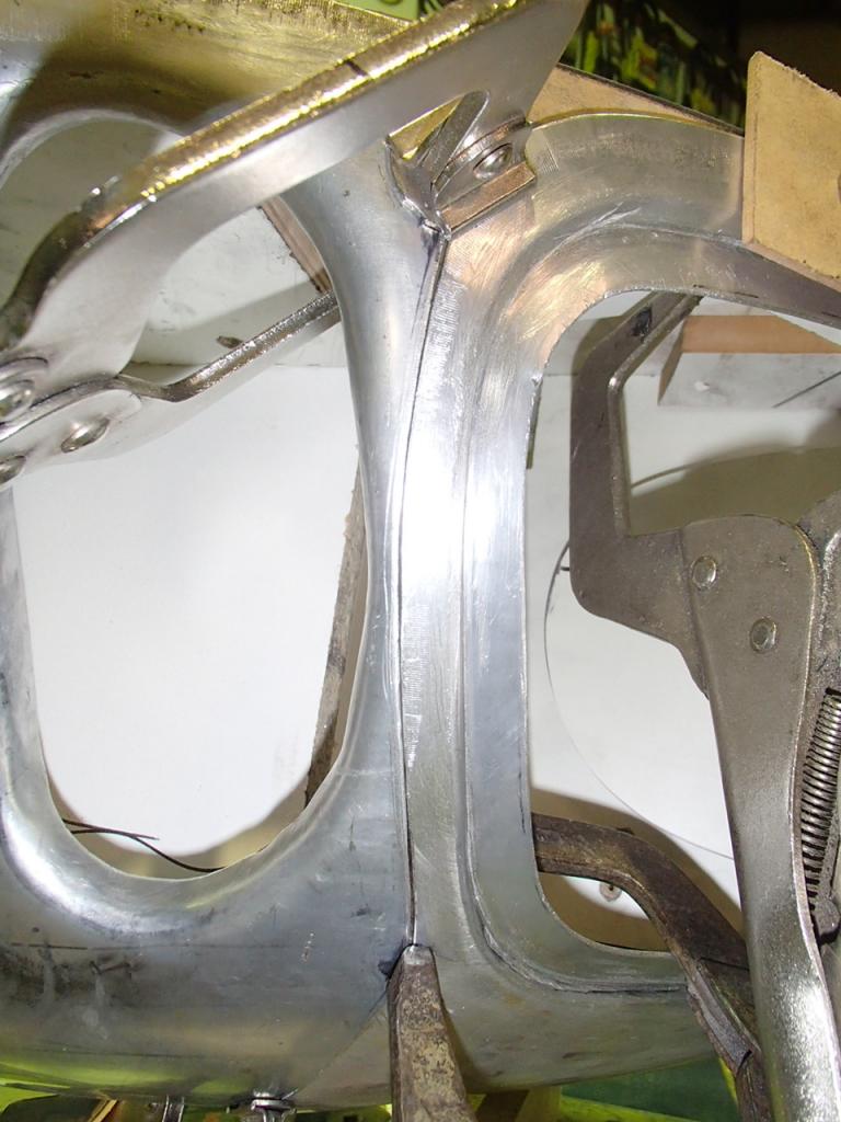

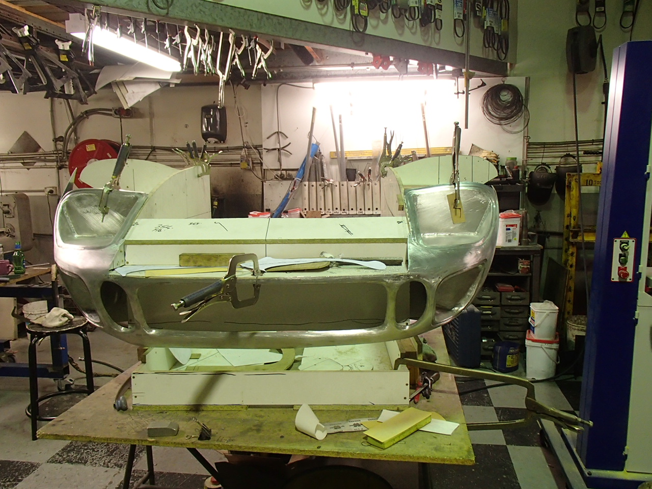

Once the left and right are done I link the both to the center panel.
You spend a lot of time fitting up to get to the weld stage.
The lower lamp pocket is made and welded in.

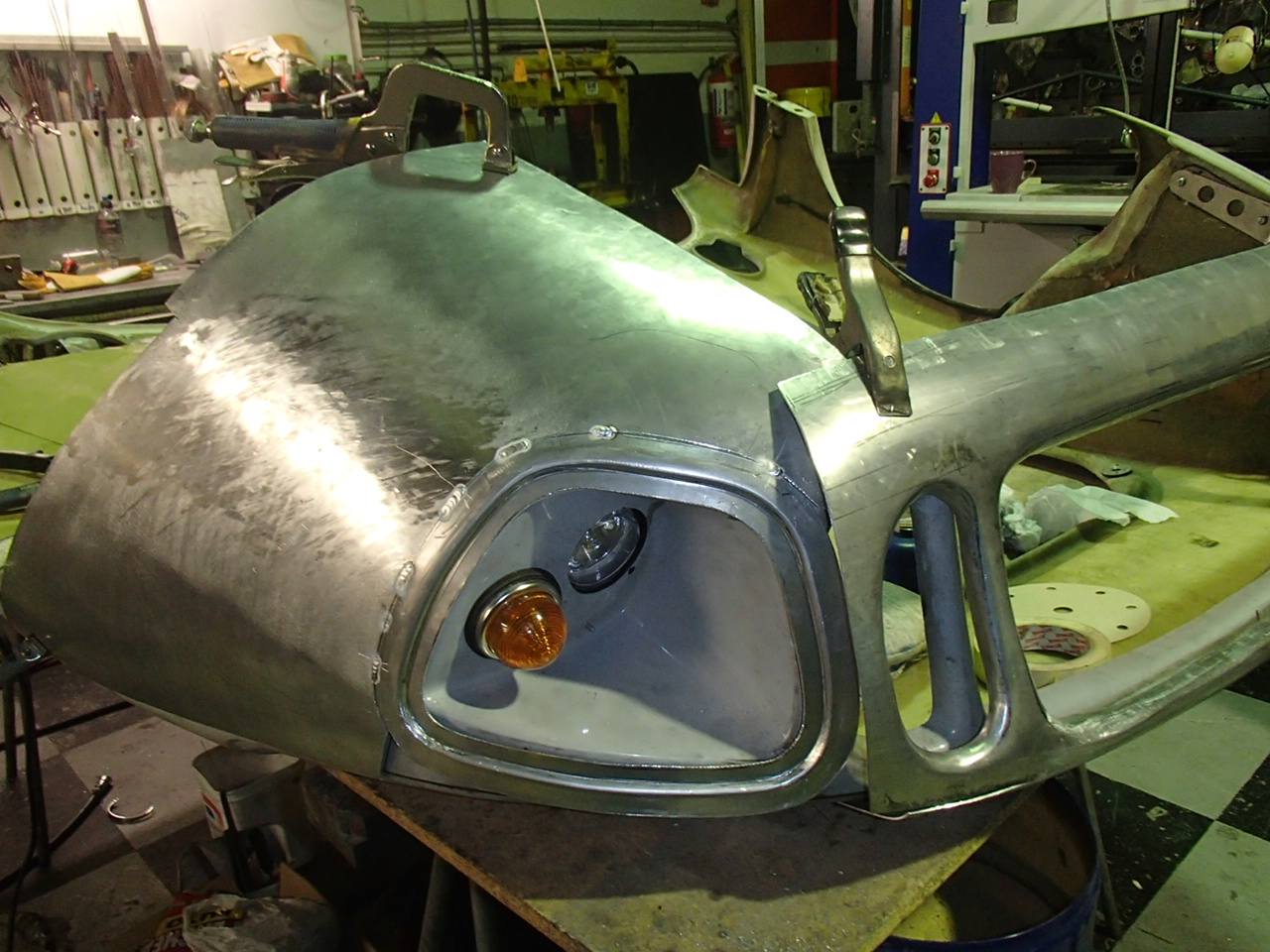

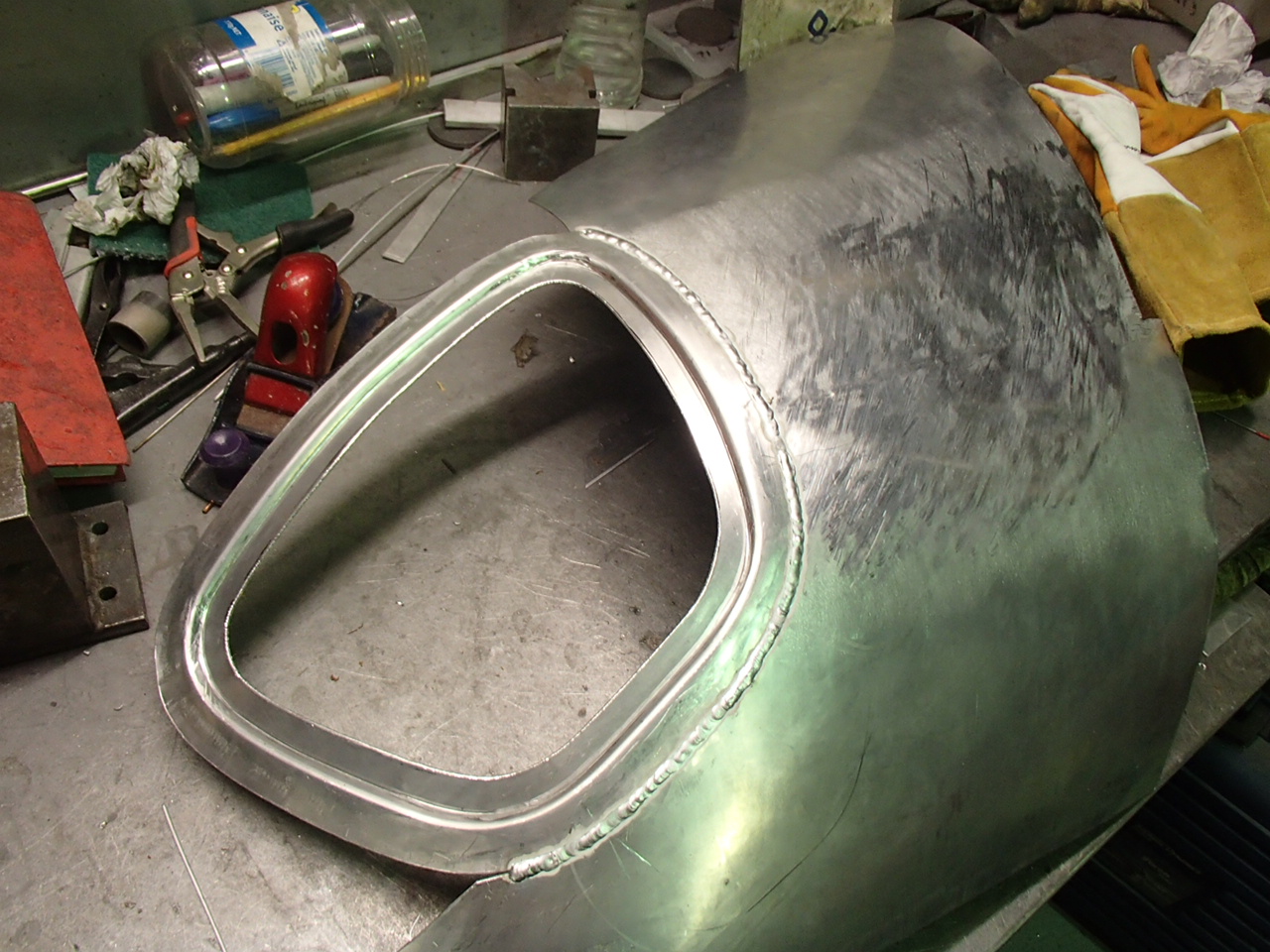

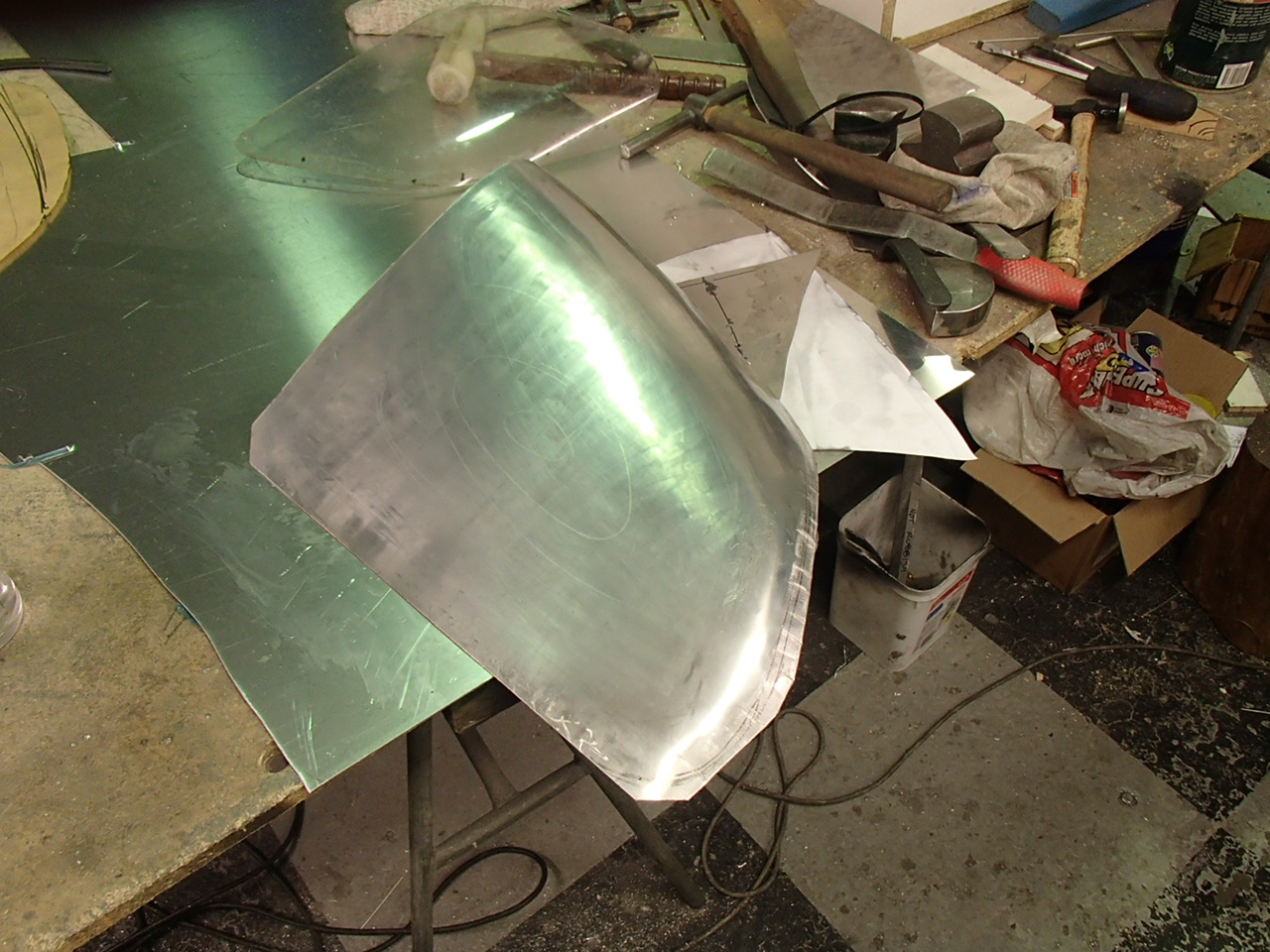

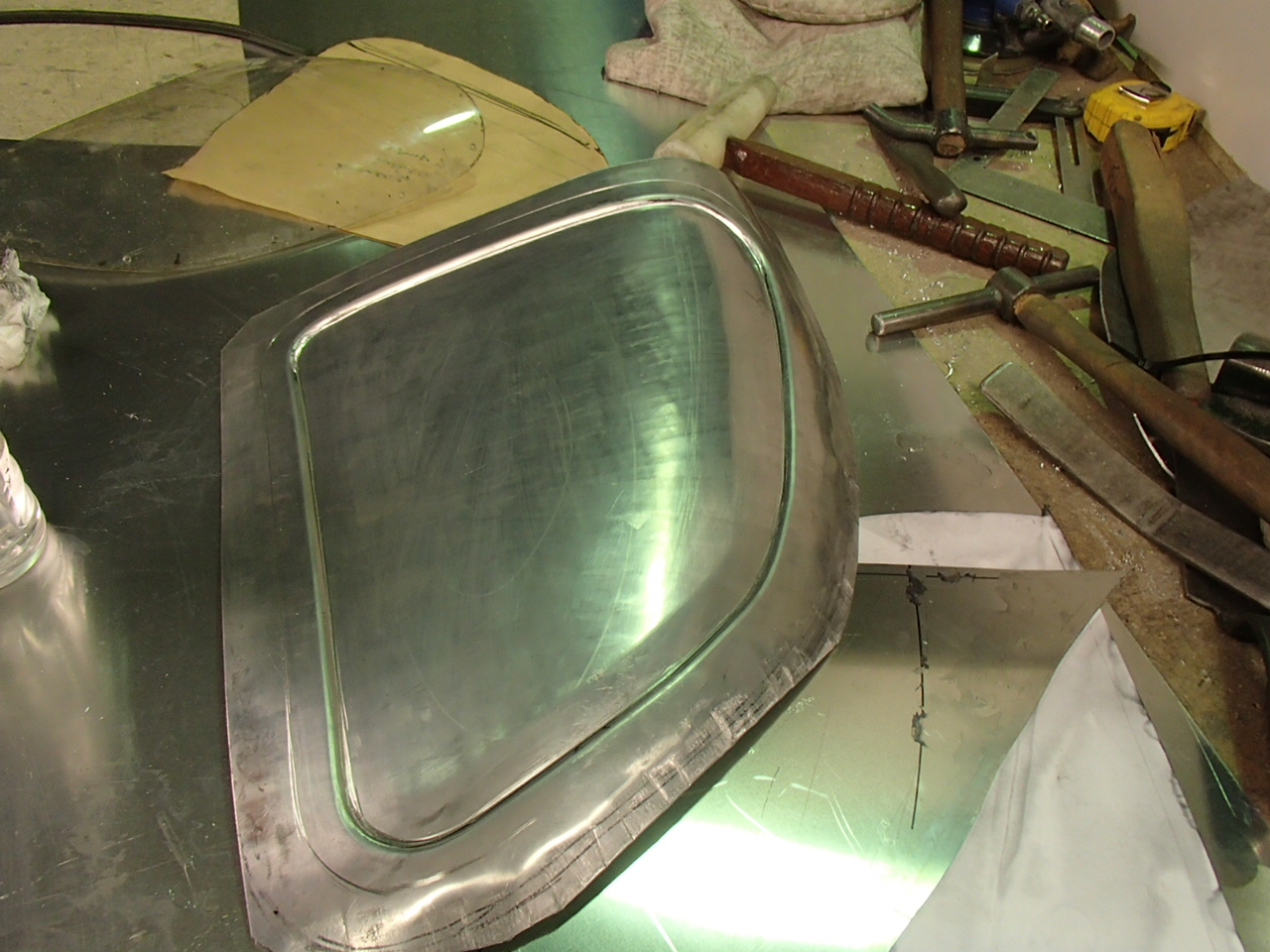

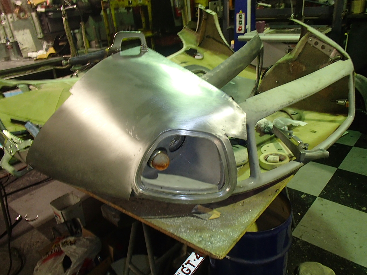

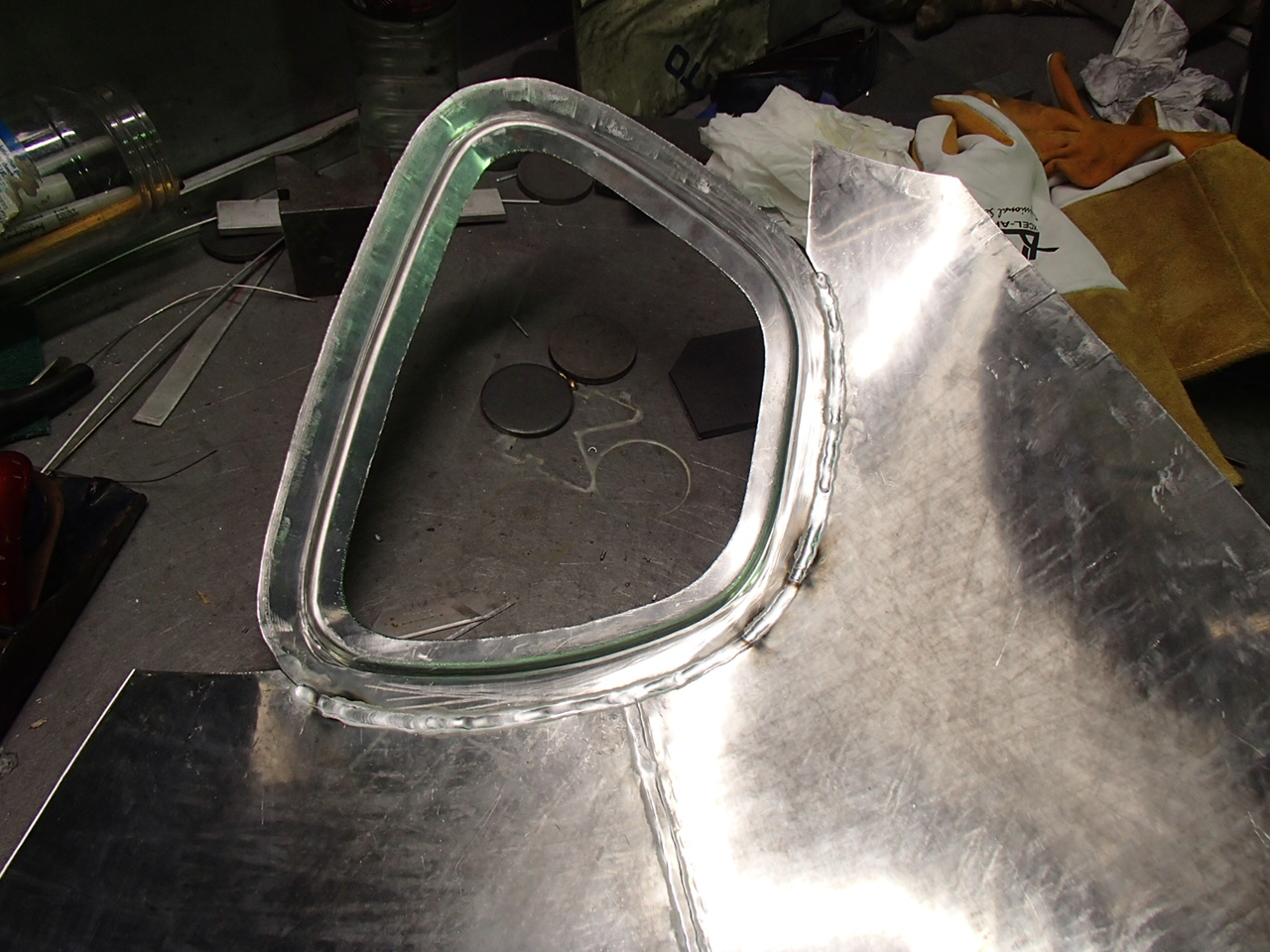

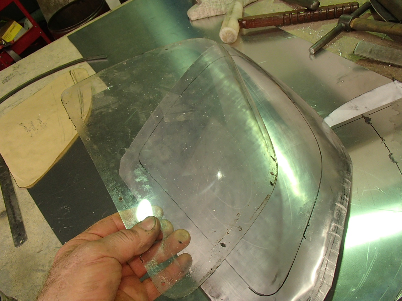

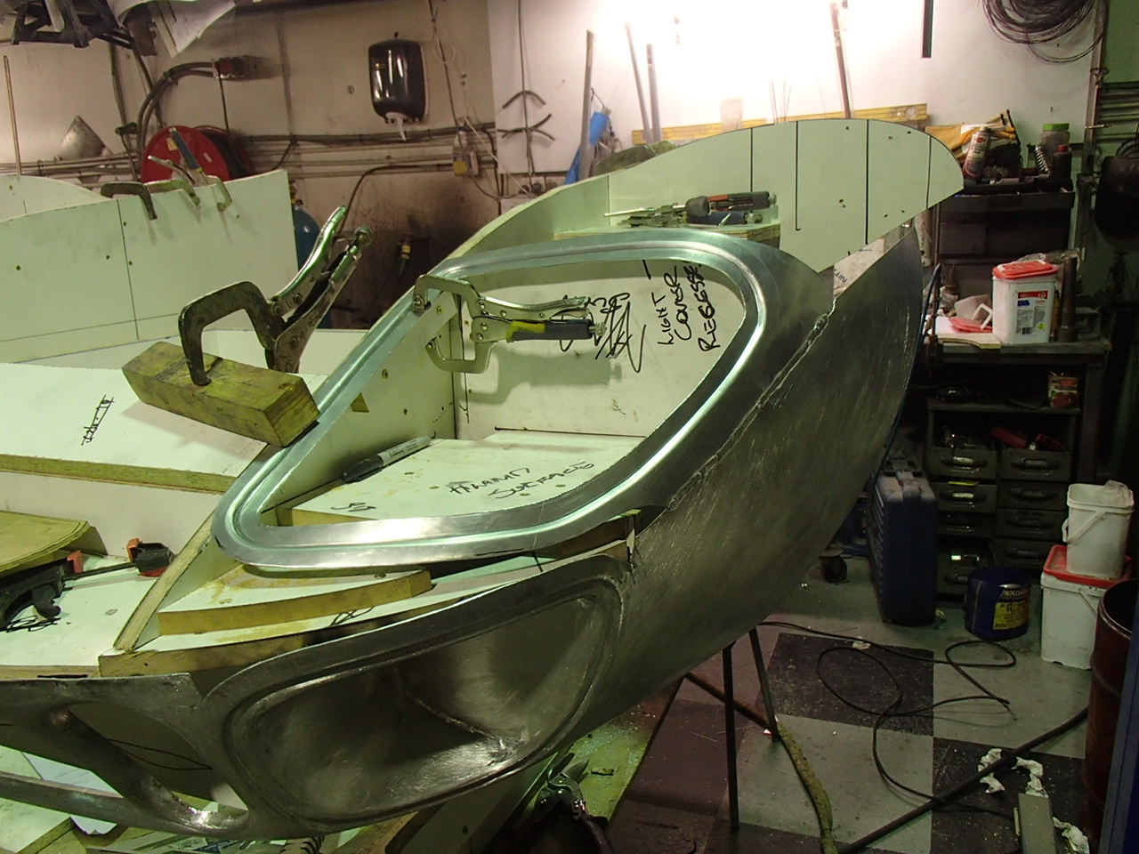

The headlamp assembly is similar in the making.
I used the headlamp cover as a pattern,I made the sheet over size and wheeled up the frame as a cover first.
I then used the bead roller to put a 4mm step for the cover to live in.
Then I cut the inside out and trim the outside to give me the frame.
Fit that up and weld it onto the guard to give it a datum.
The floor and both sides are one piece, the outer fold is curved to follow the outer body line.
The fit up on these take a bit of time as you are working several edges at once and you can easily cock it up.

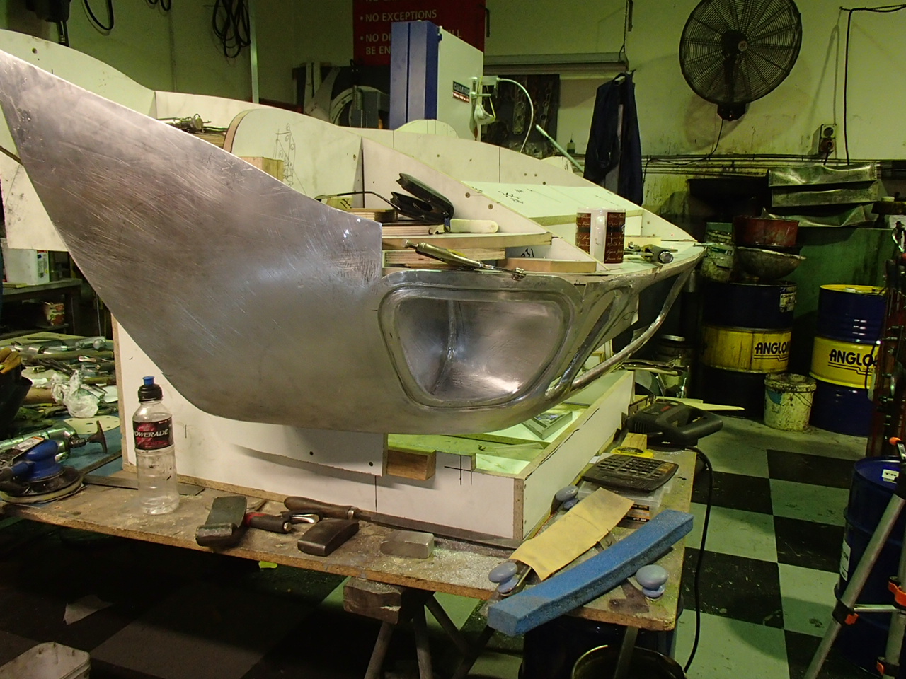

Weld the rear lamp panel the floor and frame in all at once.
Then file it up, thats me filing, I do a lot of filing.
Lamp areas after a file up L/H and R/H

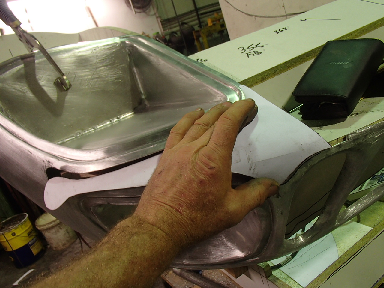

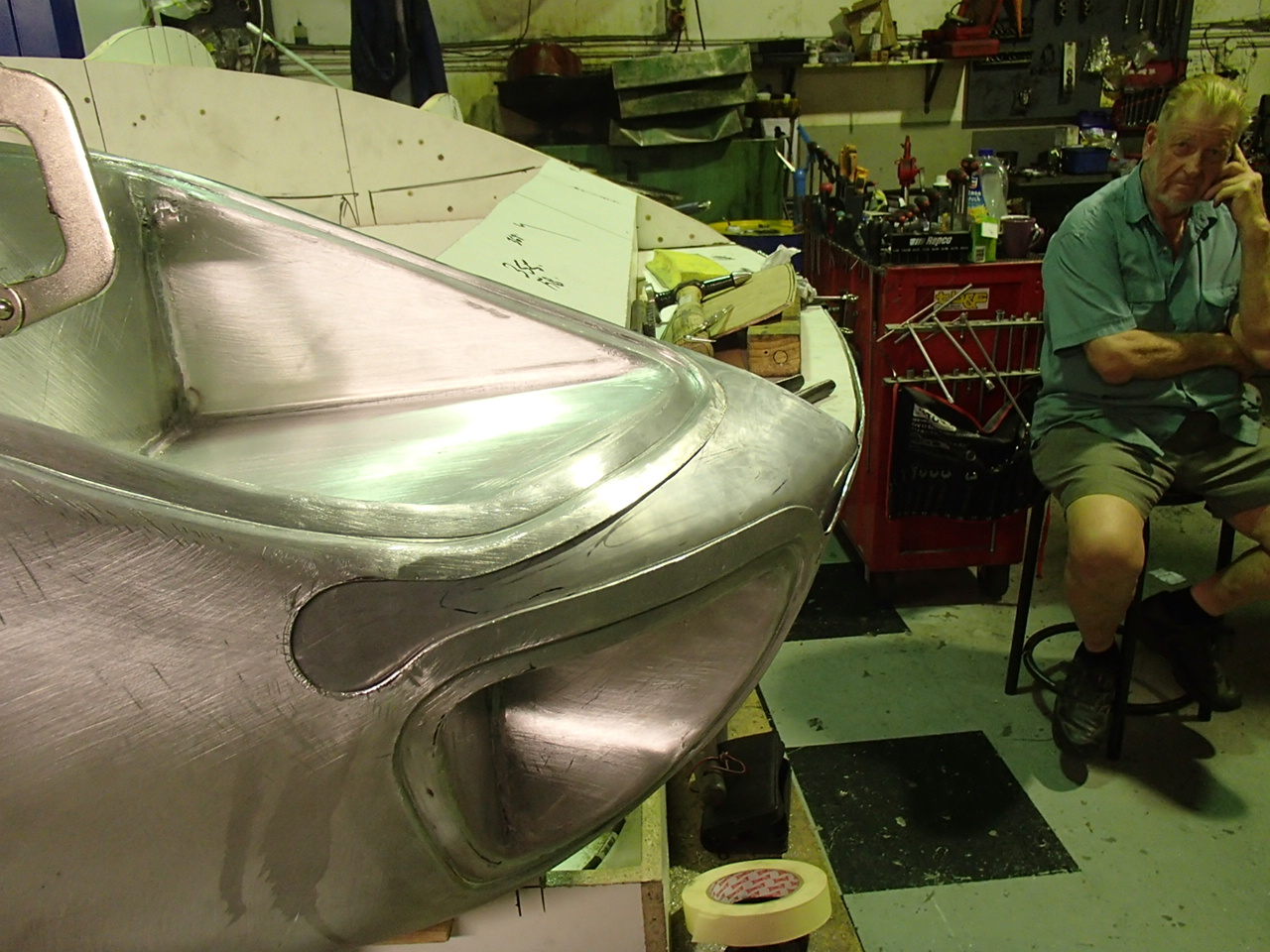

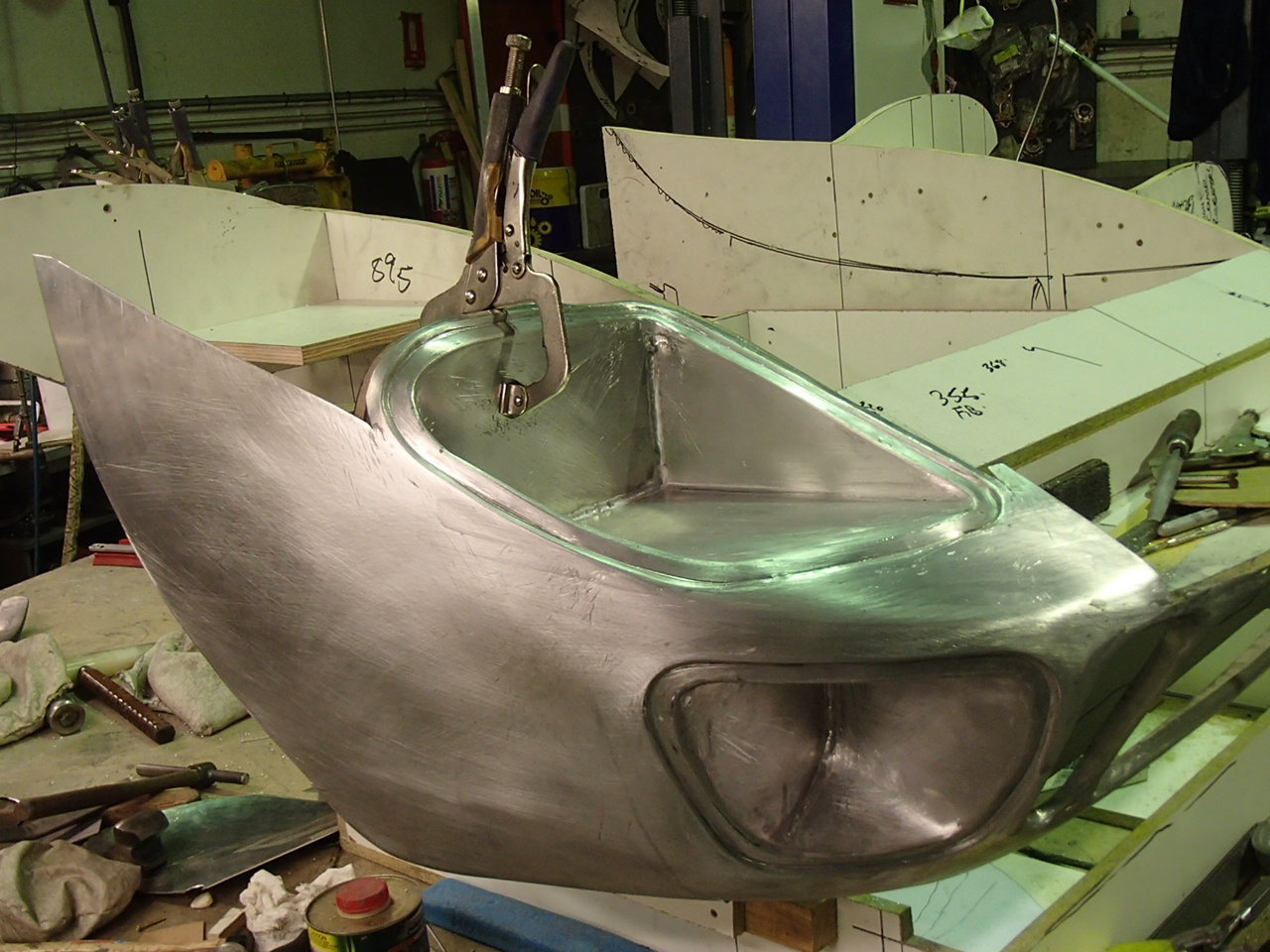

The panel between the upper and lower lamp boxes was very Findley.
You have to get the panel relaxed so it fits, being odd shaped it took some time to get it to fit.
It got a file up after the welding was done, I still need to do a little bumping up of a few dings on the L/H side then give the panel a tidy up with some dolly work but its all good.
Pic 3 is Albert doing his interpretation of an old man sitting on a stool.
I thought he does it very well.

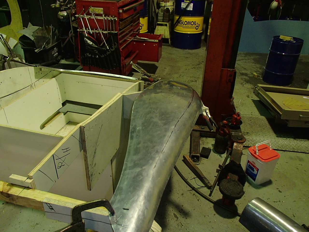

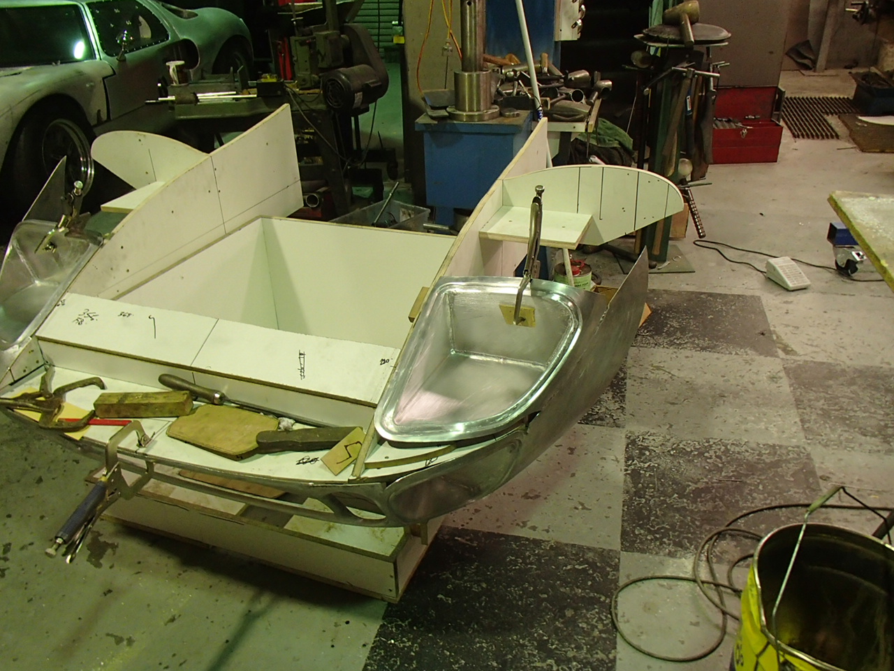

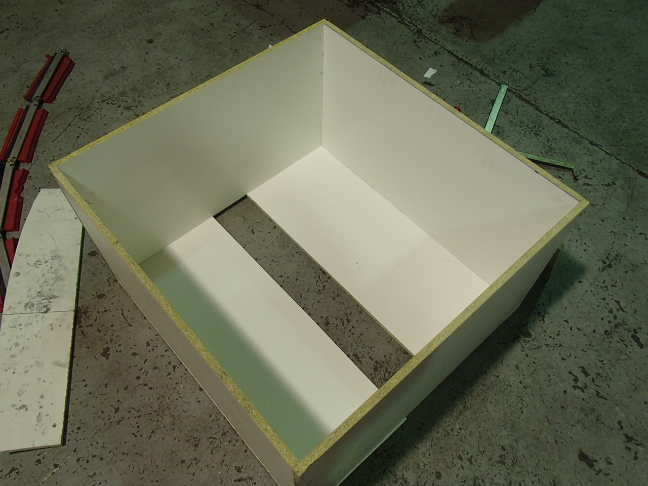

Thanks Gents,kind of you all.

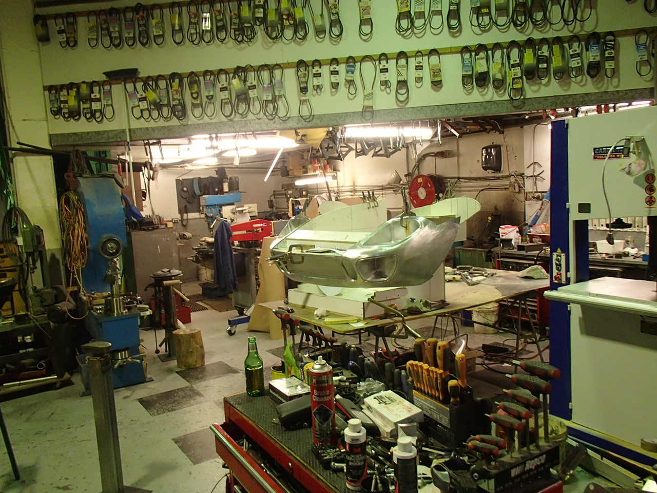

Dalton post 285 is what is called a buck.
It is made out of ply, it has a few important datums cut into its shape.
I make the panels then place them on the buck, I measure and position then trim fit and weld using the buck for this job is paramount.
Their is no frame when finished it will just be a 1.6mm shell, like normal body panels.
Its very strong.
Jim

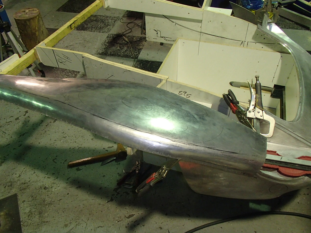

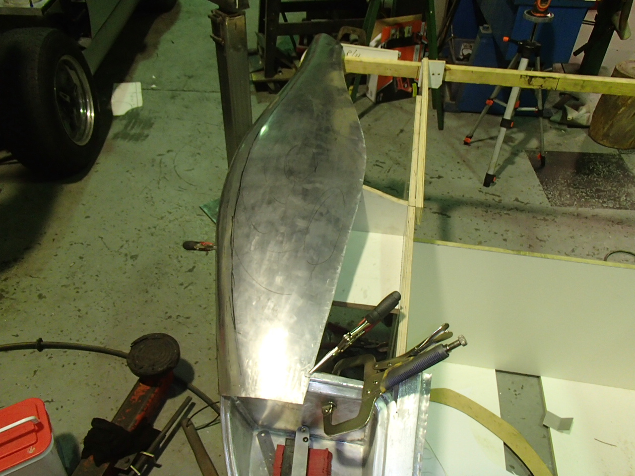

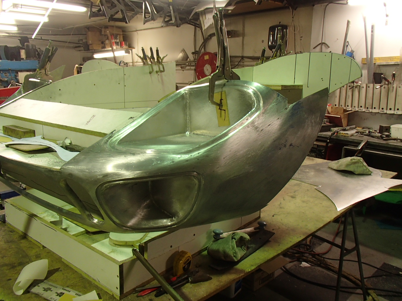

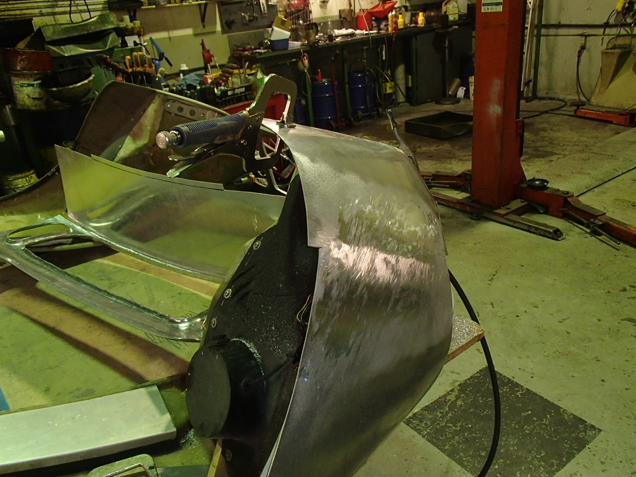

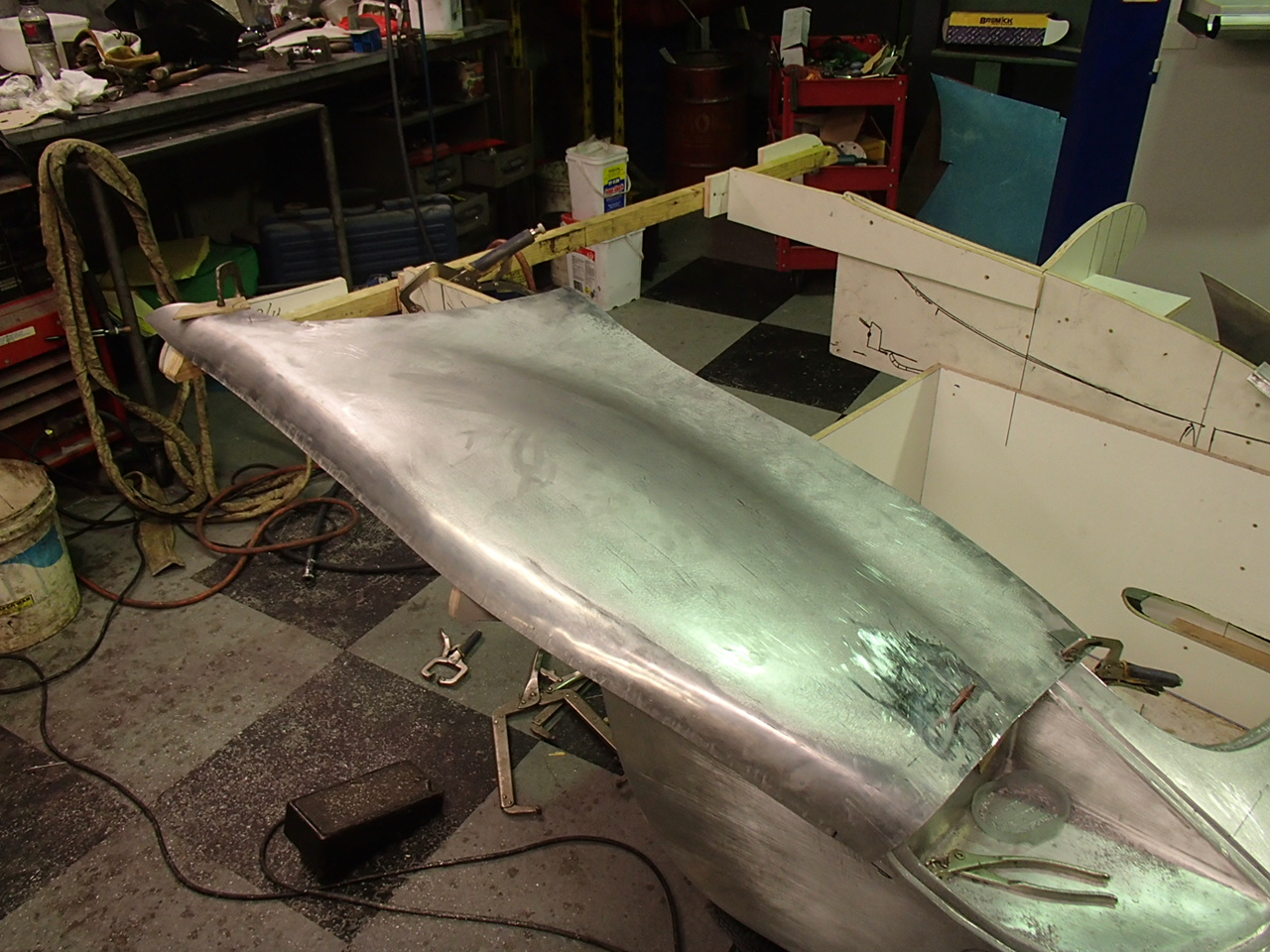

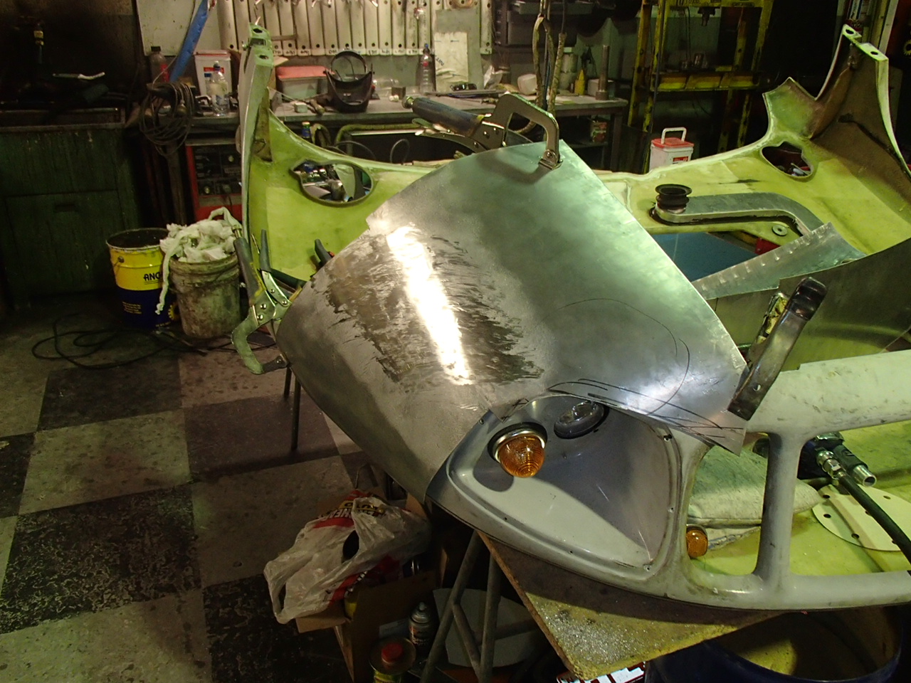

A little update.
Starting the top of the front guards.
I did this in 2 pieces.
I have widened the front guard by about 3/4".
I want the space to be able to pull a bit of neg out when I drive it on the road.

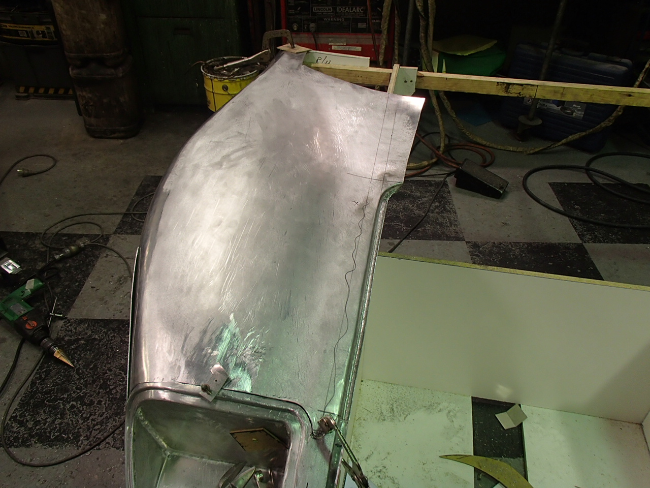

2nd part is the inner.
I formed the gutter into this sheet for the centre bonnet.
Since I took these photos I have made dollies to fit in the gutter to clean up the work.
